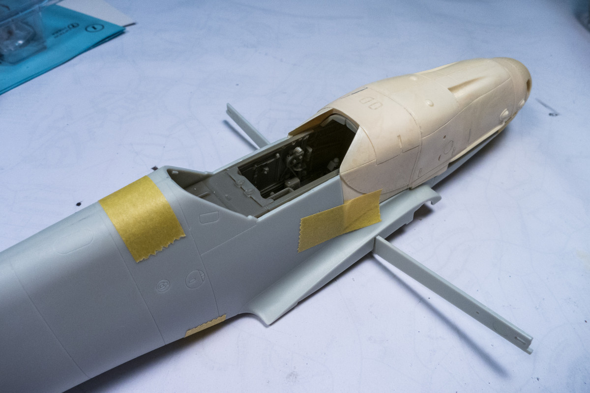

Just a few things to report on... as mentioned earlier, I needed to saw off a portion of the cockpit tub casting block to accommodate the wing spars, which incidentally form the front wall of the landing gear wells.

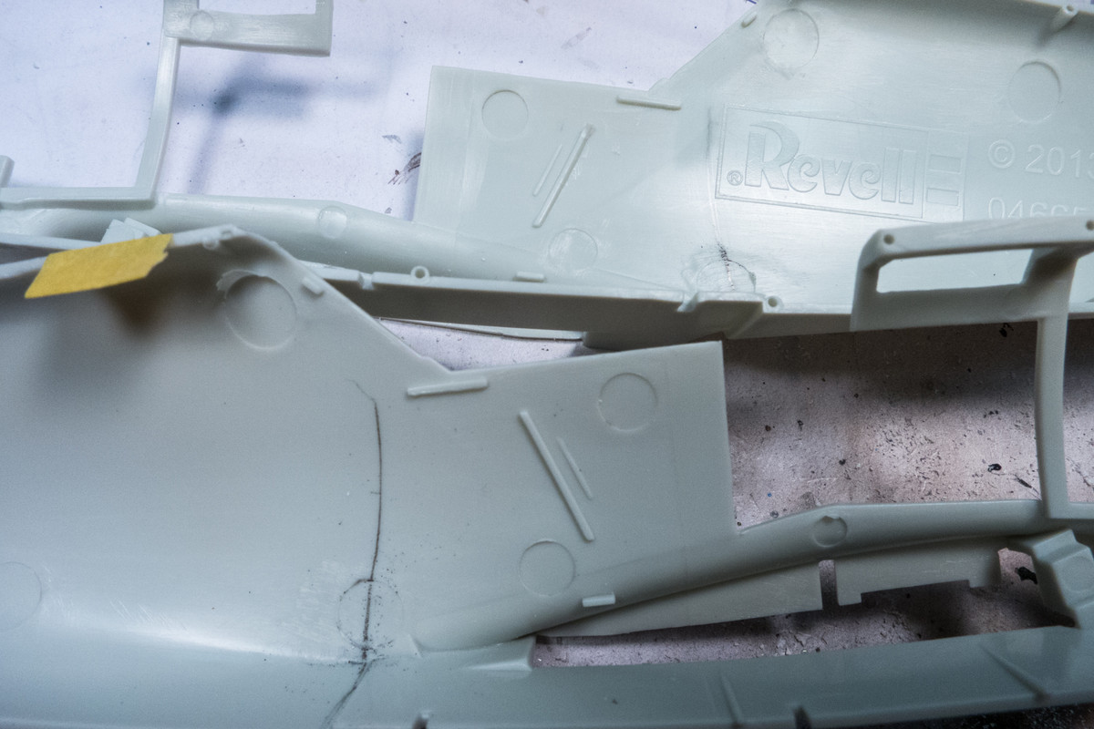

I've been trying to dial in a more exact fit of the resin cockpit and I think it would help if these raised diagonal ridges on the insides of the fuselage were removed.  They somewhat help in positioning the resin cockpit but they also push in the sidewalls.

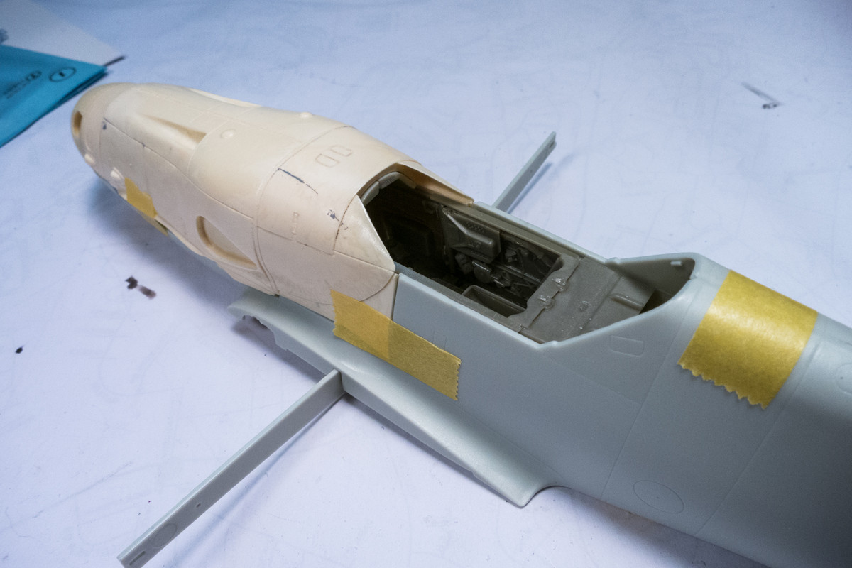

With those adjustments, the cockpit is re-positioned and verified to accommodate the wing spars.

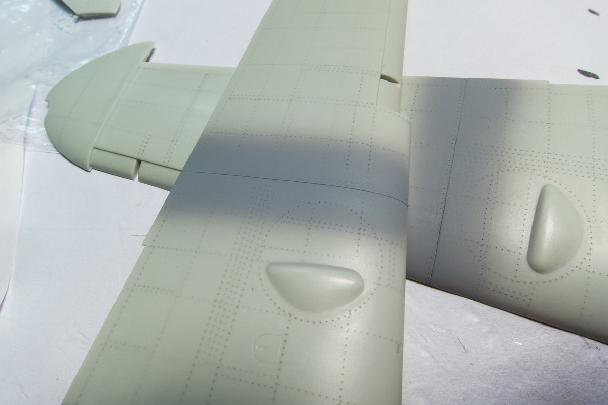

I'm happy with the Aires cockpit so far but not so much with the Barracuda small bulge wing inserts.  Dimensionally, they seem to be a decent fit, although I had to remove a few locating pins to do it.  But they are flatter in profile than the kit wings and given the small amount of contact area between the inner and outer wing panels, it may be a tough to get a solid join.  And I need/desire a stronger than normal join so I can do this...
And I've broken off a small piece from one of the wing bottoms to boot.

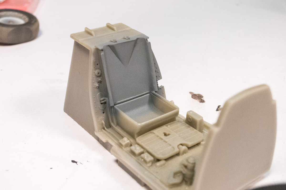

Don't forget to modify the left wing root to accomodate for the displaced engine support lower torque link. The one thing i don't like with the Aires cockpit is that they totally screwed up the seat back rest...

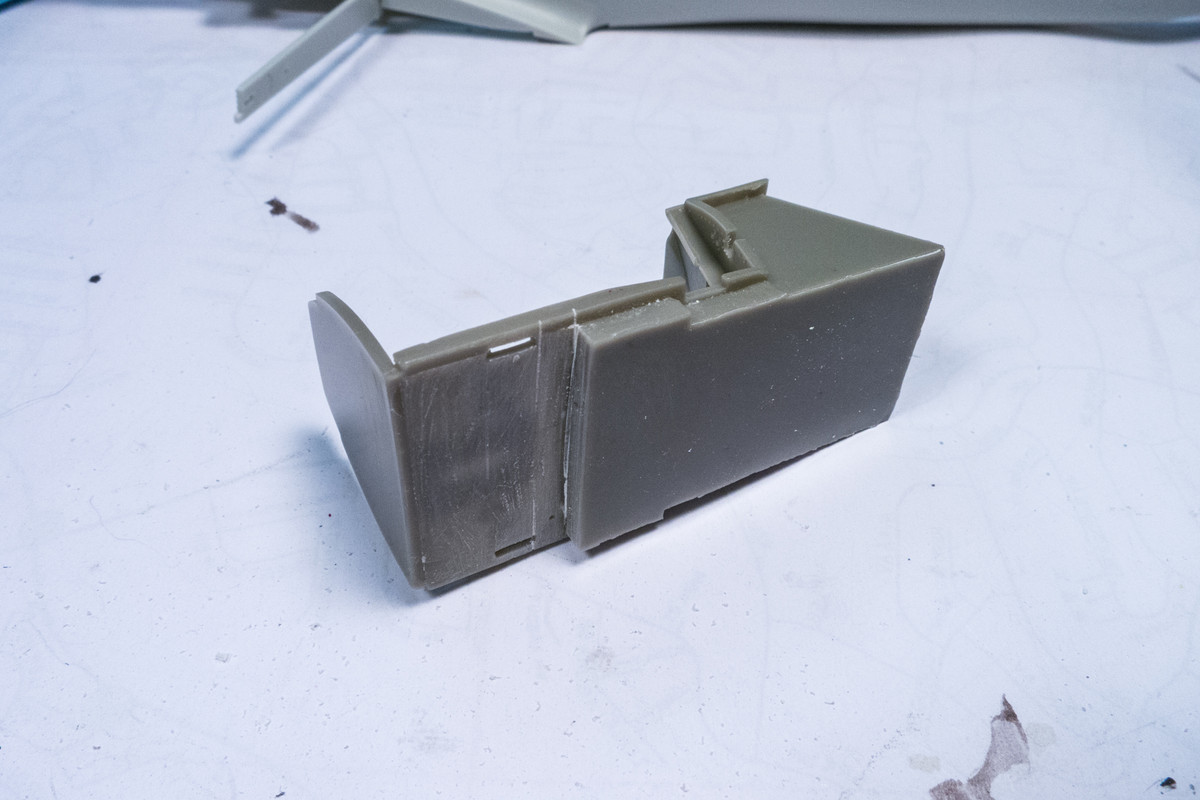

Thanks for checking Vincent!  Do you have an example of that left wing root modification?  And I'm trying to figure exactly what is wrong with the Aires seat without having a good reference photo of a real 109G seat.
Here is the Aires seat...
Compared to the Revell seat and Barracuda replacement seats.
BR32223+Bf-109G-2+Thru+G-10+Seat+-+No+Be
Assuming that the Revell/Barracuda seat backs are accurate, it might be possible to modify the Aires seat to match.

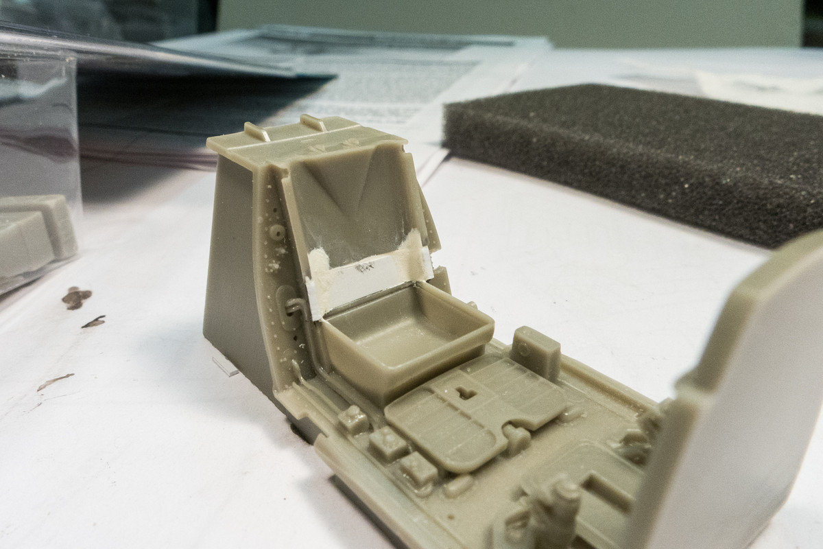

Filling the gap in the Aires seat back.

Here's the seat after modification...

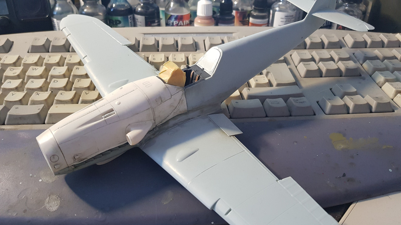

Don't want to high jack your posts...just showing what it looks like after after closing the fuselage. Fitting was not easy but with a lot of dry fitting it finally came out ver nicely...
I know also have the G-10Erla set after it became available again...so that's also on the project list...
BTW...all my reseach on G6AS planes came to the result that those did not have the battery box behind the cockpit yet. Can someone knowledgabe comment or confirm that?
