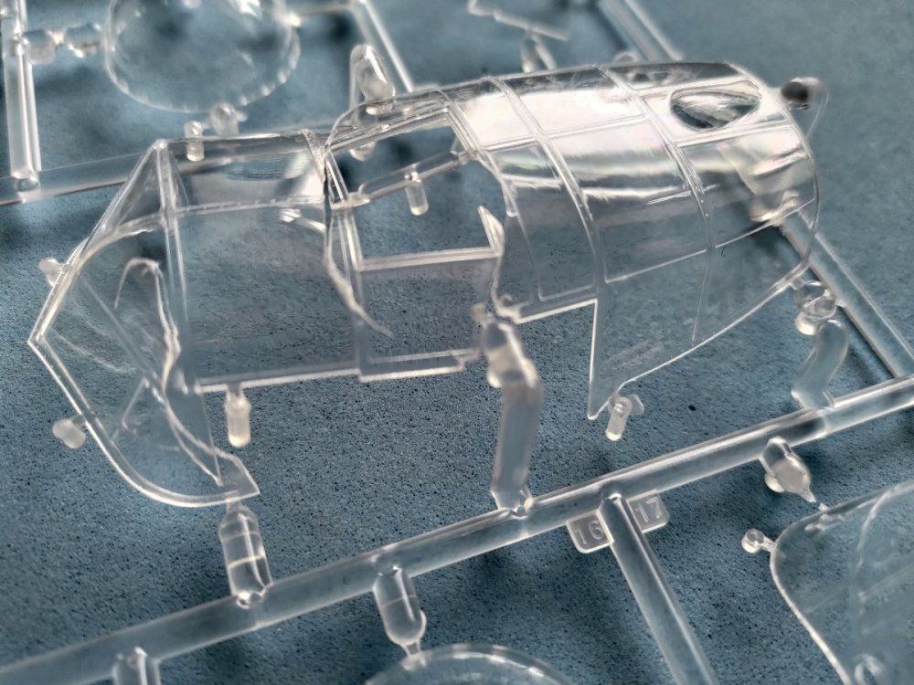

nmayhew Posted May 19, 2022 Posted May 19, 2022 Re the clear parts, a guy on SMCG got his kit and said the clear parts, whilst not damaged, were really of very poor quality and would need polishing. This is not something I have seen elsewhere - anyone seen this sort of issue? Anyway, what’s interesting is that he messaged Border via Facebook and they got straight back to him saying no, he didn’t get a bad kit / one from a bad batch, and that the clear parts had caused them massive issues, and basically sorry that was the best they could do. sorry can’t post a link as it’s a private FB group (which is well worth joining btw), but to re-iterate what others have said, I advise checking the clear parts as soon as you get yours. (mine is on order from Hannants) cheers Nick TankBuster and thierry laurent 2

Kagemusha Posted May 19, 2022 Posted May 19, 2022 Here's my main canopy, and below a part - there are quite a few - with what looks like a stress fracture , they show up better under artificial light... Stevepd, Uncarina, thierry laurent and 7 others 1 1 8

misha71 Posted May 19, 2022 Posted May 19, 2022 I received mine today. Model is packed very tight and clear parts are on top of sprues. Mine has small crack for rear turret. nmayhew and Stevepd 2

Chek Posted May 19, 2022 Posted May 19, 2022 I wonder if it's germain that WNW would have little experience with designing large clear parts? It may be that the tool needs redesigned to eliminate multi gate feeds into certain parts. Soome photos show the feeds haven't fused together the way they should. Not such an issue with ordinary opaque parts, but clearly not working on transparencies. nmayhew, allthumbs and Gary Needham 3
Dave J Posted May 20, 2022 Posted May 20, 2022 7 hours ago, Chek said: I wonder if it's germain that WNW would have little experience with designing large clear parts? It may be that the tool needs redesigned to eliminate multi gate feeds into certain parts. Soome photos show the feeds haven't fused together the way they should. Not such an issue with ordinary opaque parts, but clearly not working on transparencies. I doubt that would be an issue if WNW was still operating and released this kit, knowing the standards we had in place. The kit wouldn't of been released if something was sub-par. nmayhew, KiwiZac, Gary Needham and 1 other 4
Kagemusha Posted May 20, 2022 Posted May 20, 2022 Received an email from Lucky, they've contacted Border, who are sending them replacements. nmayhew, Archimedes and monthebiff 3
