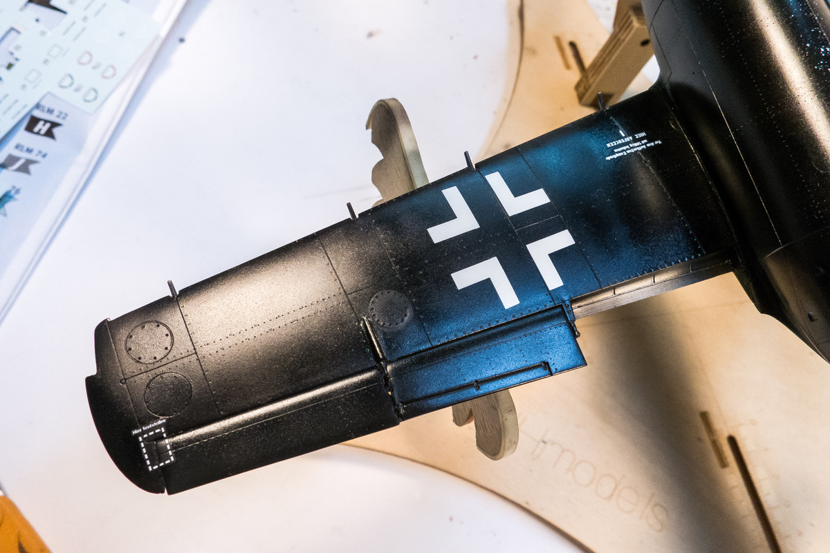

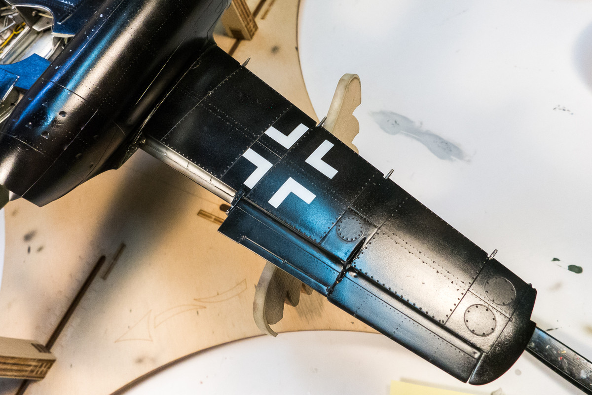

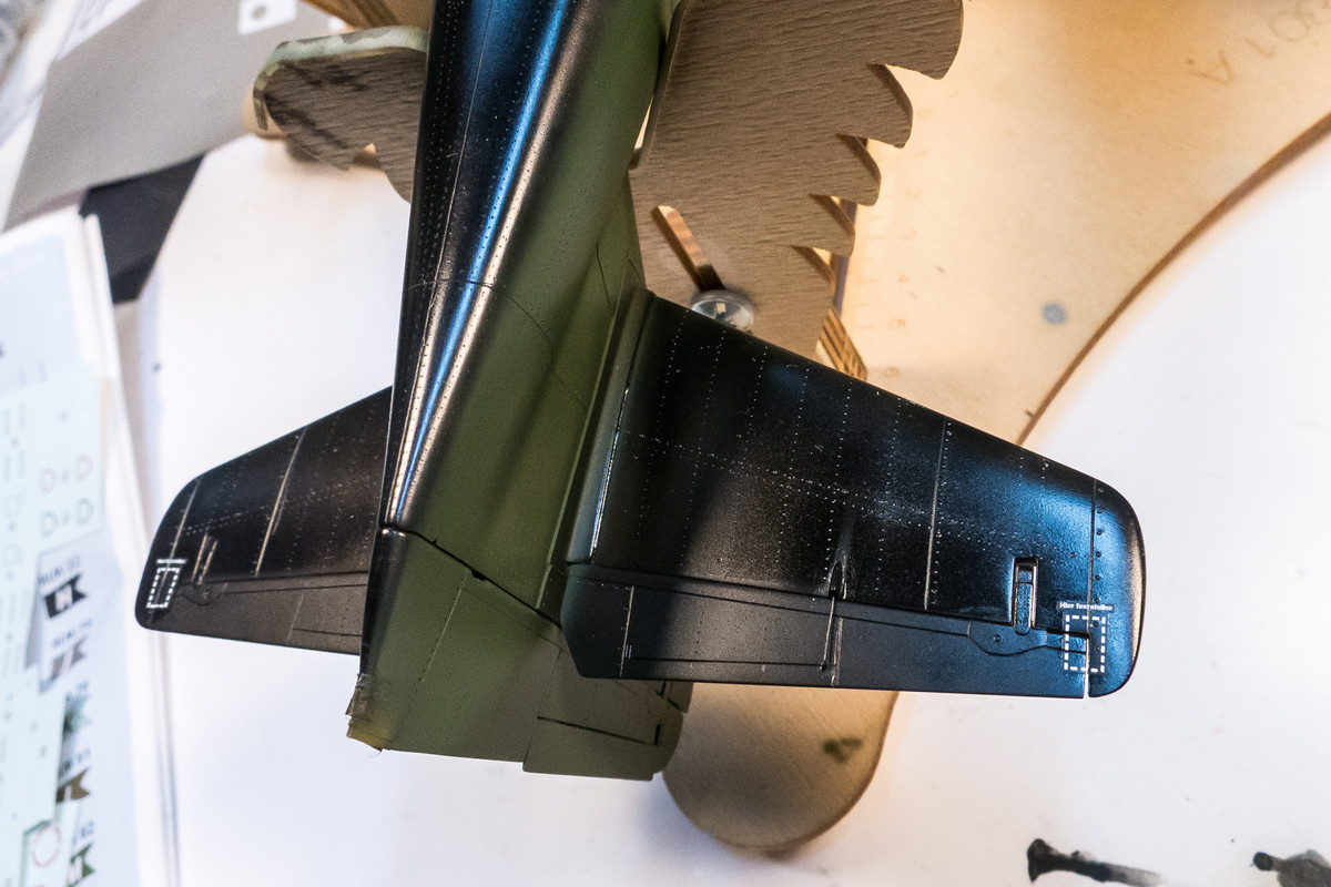

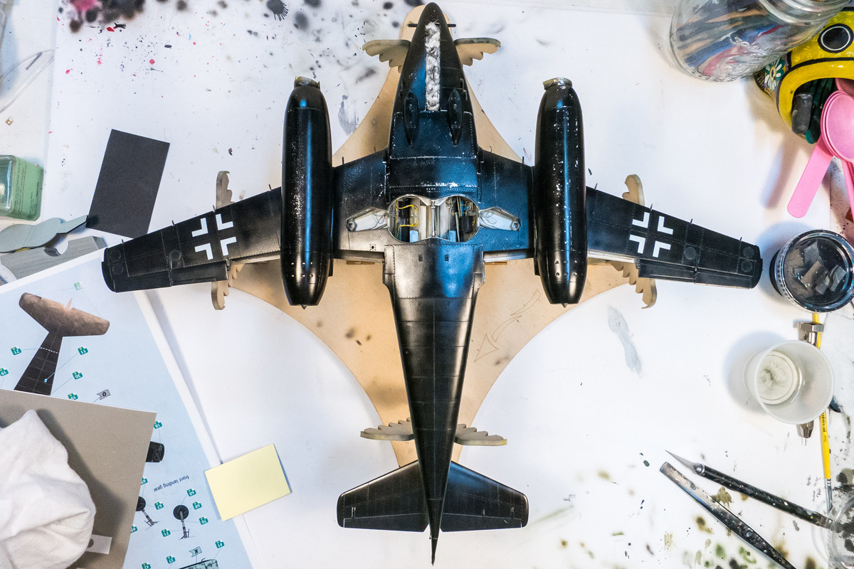

Thunnus Posted January 18, 2021 Author Posted January 18, 2021 The top and bottom are progressing at different rates, which I think is ok until I get to the transitions like the sides of the engine nacelles. I've decided to do the majority of the markings and decal work on the bottom at this stage. The wing crosses are masks from the Silhouette Portrait based on scans of the kit decals. The stencil decals from the kit are used. They are very fine and feature legible text, even for the very small decals. The only thing I don't like about the decals is the flat finish... I prefer gloss or satin. I used Microset to dampen the area of application and once position was finalized, I rolled a clean cotton swab over the decal. Instead of Microsol, I used Walters Solvaset to soften the decal and help it conform into place. Some of the stencils are at the corners of control surfaces, so multiple applications of Solvaset were used and finally a sharp knife run along all of the depressions. I'll give this a few hours to dry and then shoot the decals with a light gloss coat to seal them. Fanes, Paul in Napier, Victor K2 and 13 others 16

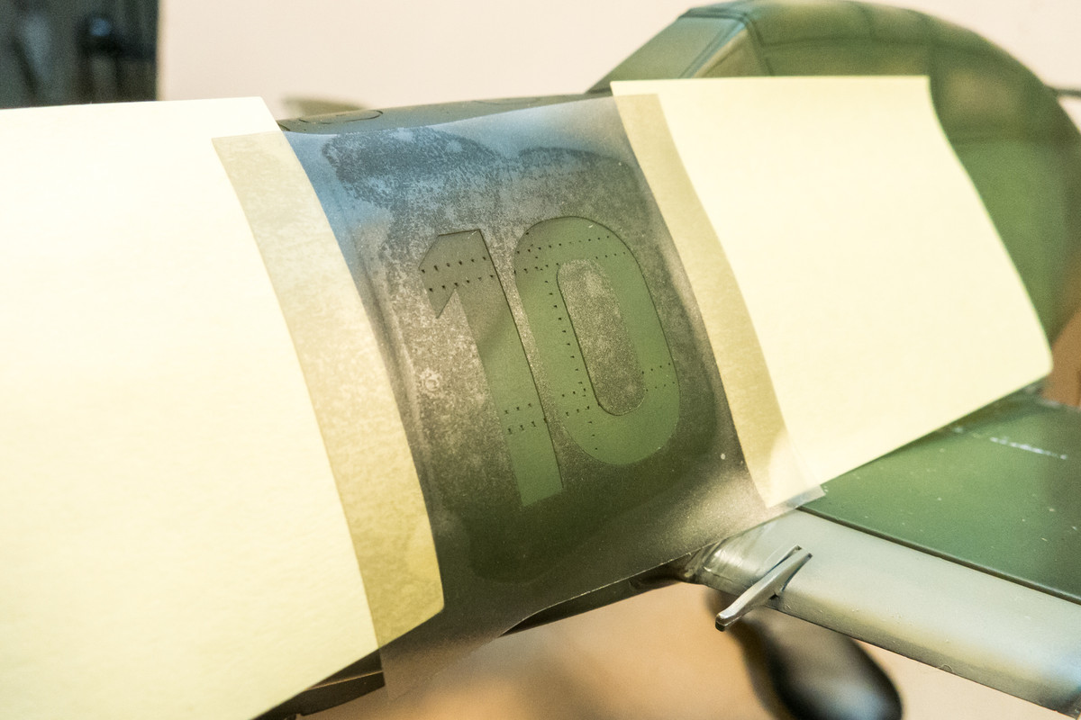

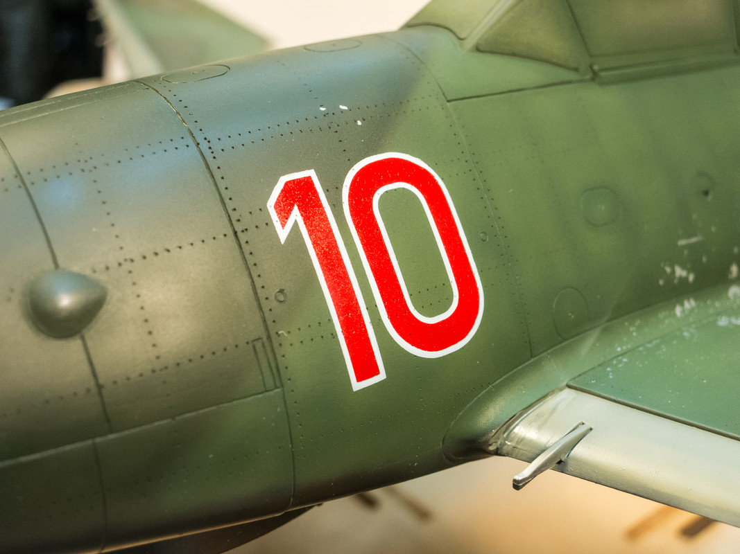

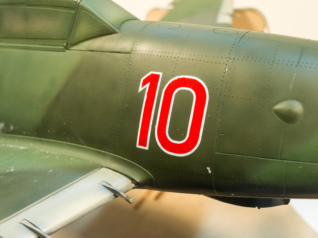

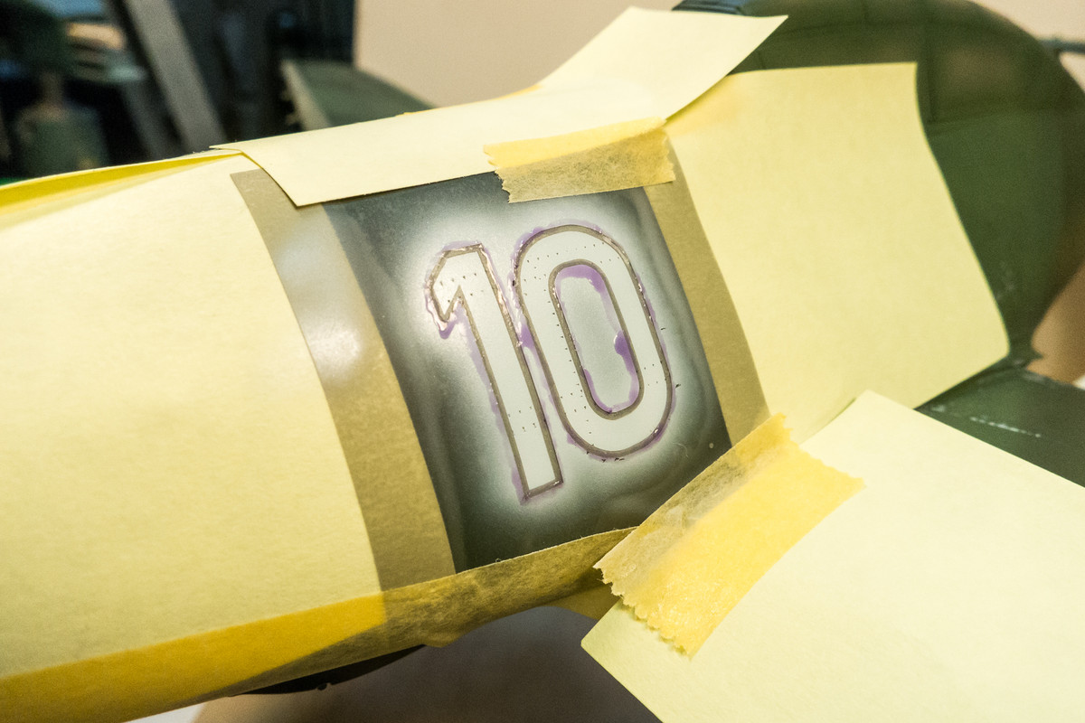

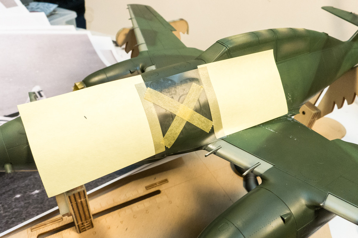

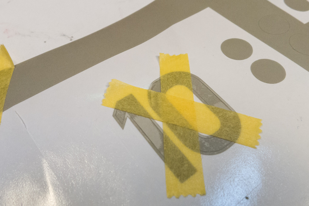

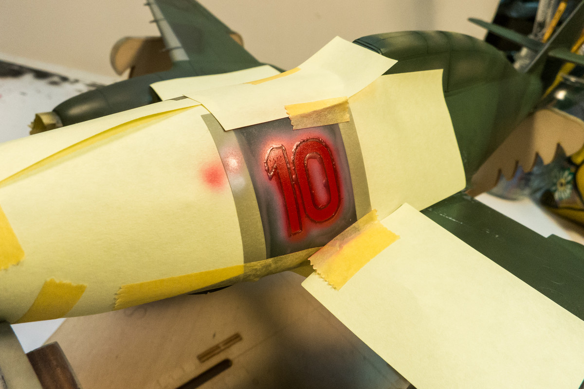

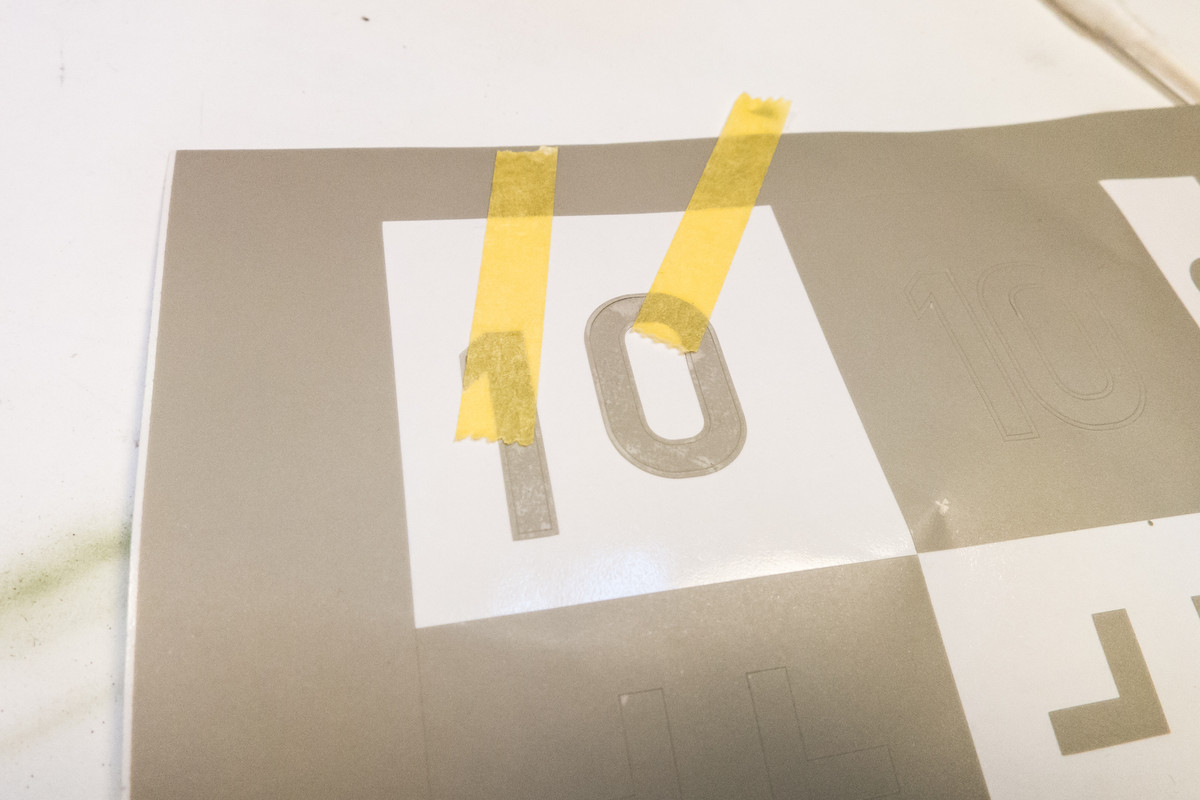

Thunnus Posted January 18, 2021 Author Posted January 18, 2021 Thanks Matt! The black will fade somewhat with the upcoming weathering but that will come later. I'm moving towards applying the Light Blue RLM 76 mottle over the green so... Let's do the red "10" markings! One of the first things that I do when I get a new kit is to scan the decal sheet. The decal sheet for this build was used to create custom masks for the major markings including the "10". Since the numbers have a thin white border, masking is a little bit trickier than single color markings. First, I transfer the entire mask onto the model using tape to hold the different components together. This is necessary since there is a free-floating oval within the "0". The Oramask 810 material is translucent and really helps facilitate the proper positioning and alignment of the marking. Leaving the oval in place, the other components of the mask are carefully removed and saved for later use. The first color, which will be the white for the outline, is now ready to be sprayed. Make sure that the edges of the mask are uniformly flat on the surface. Before I spray the white, I repeat these steps for the starboard side. Upon removal of the inner mask components for that side, a tiny sliver of backing paper got caught on the mask's adhesive. Poking it out stretched the skinny part of the mask a bit... you can see the kink on top of the "0". I could possibly make this work but I thought it would be prudent to cut an identical mask just to avoid any potential issues. The white is sprayed and allowed to dry for a few hours before moving on. The thin border masks are then carefully put into place. This is the most fiddly part of this operation and it pays to make sure that these thin masks butt up nice and tight to the masks that are already in place. Even with magnification, it is difficult to see the fine gaps that might allow some paint to seep through. To prevent this, additional masking is recommended. You can used bits of tape but for this example, I chose to use a liquid mask. It looks sloppy but I've been careful to make sure that the liquid mask stays away from the mask edges. The red is sprayed on. I like to use thin mixes to minimize the paint build-up and resultant edge that might develop with thicker paint. The masks are pulled off to reveal the completed red "10" markings. There were a couple of small spots of paint lift but very minor... a very acceptable result. The lifted paint spots are sprayed with Neutral Grey first, which helps blend in the repair, and then sprayed with the camo color. Landrotten Highlander, MikeC, Pastor John and 19 others 20 2

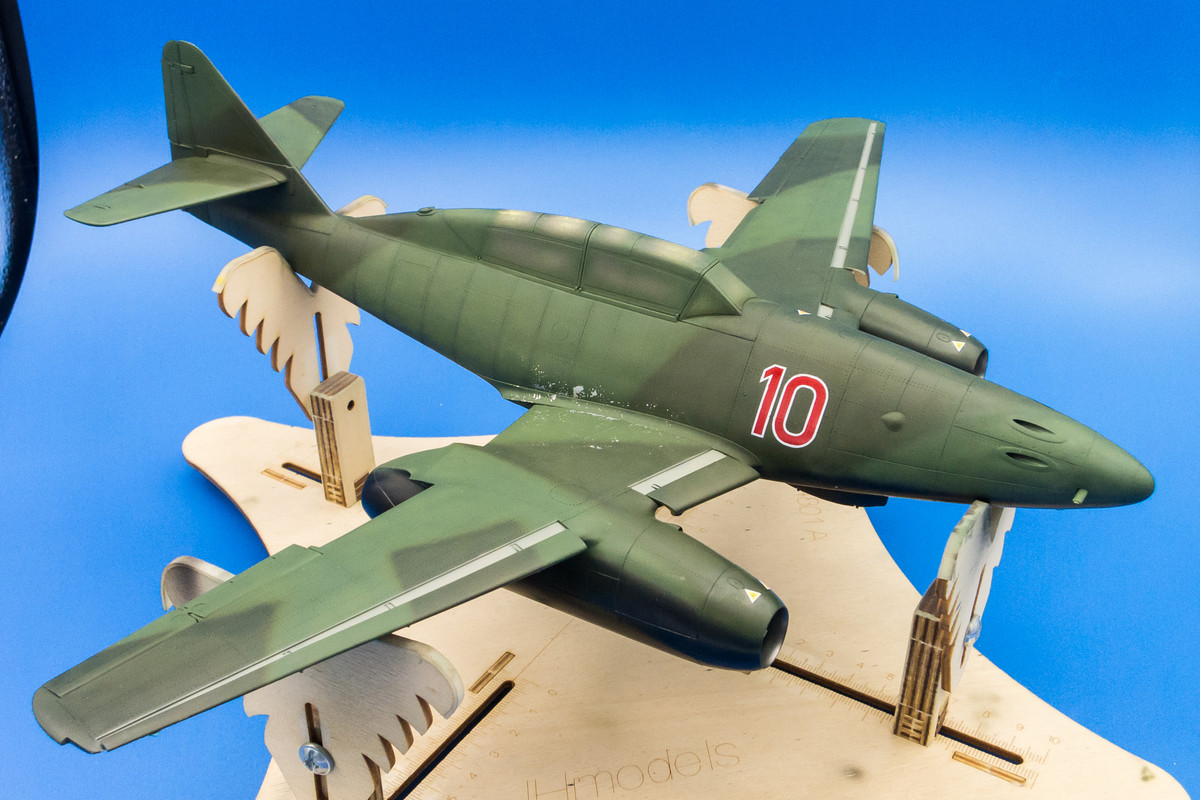

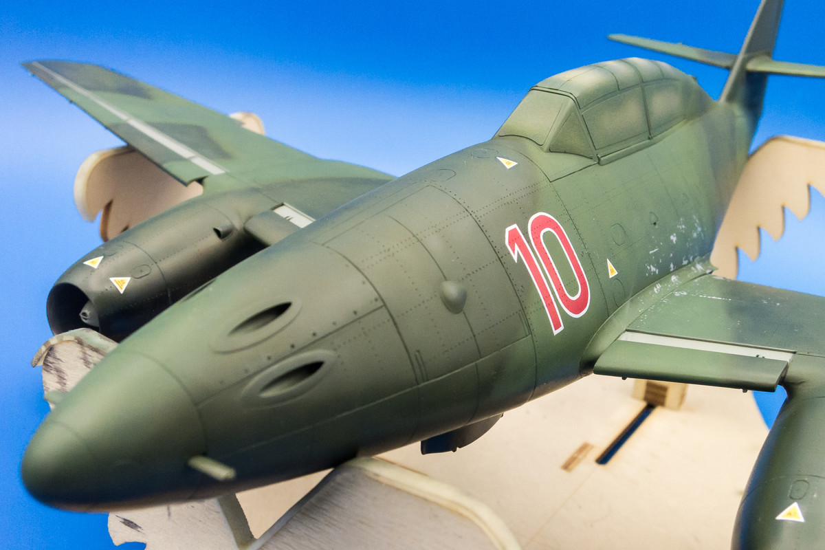

Thunnus Posted January 18, 2021 Author Posted January 18, 2021 A short pause after I've applied the fuel stencil decals. I think I can start on the mottle work soon. ColinR, VintageEagle, LSP_Kevin and 25 others 27 1
monthebiff Posted January 18, 2021 Posted January 18, 2021 Flawless work John, the effort you put on to the awful fit of the nose parts has really paid if!! Regards. Andy Thunnus 1

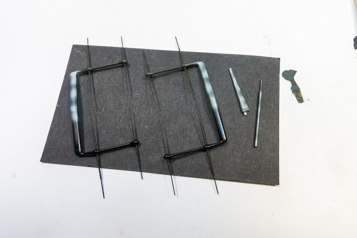

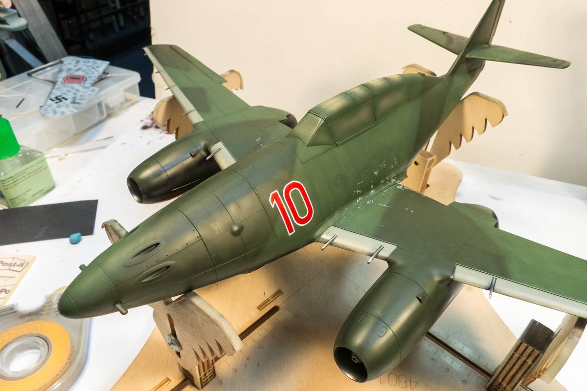

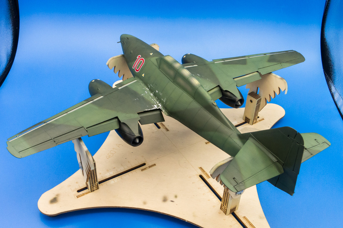

Thunnus Posted January 19, 2021 Author Posted January 19, 2021 Thanks guys! Taking some baby steps toward the next painting phase, which will be the Light Blue RLM 76 mottle over the greens. I've decided to use Mr Hobby Aqueous RLM 76 mixed with white for this shade since it sprays very well. Here are a few of the smaller components with the light blue... Fanes, MikeMaben, Greg W and 13 others 16
