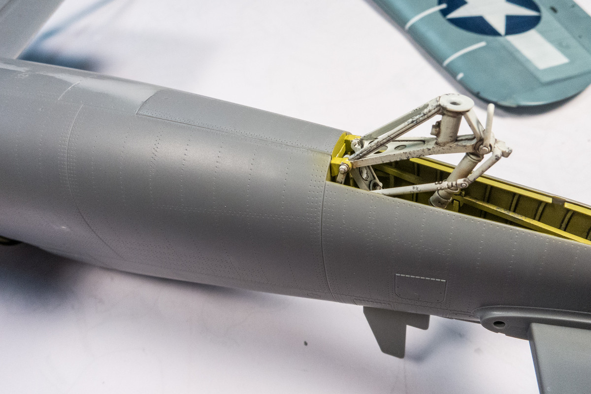

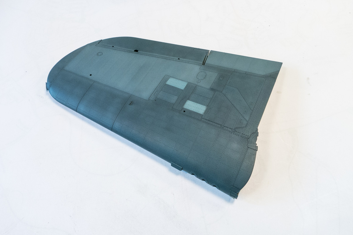

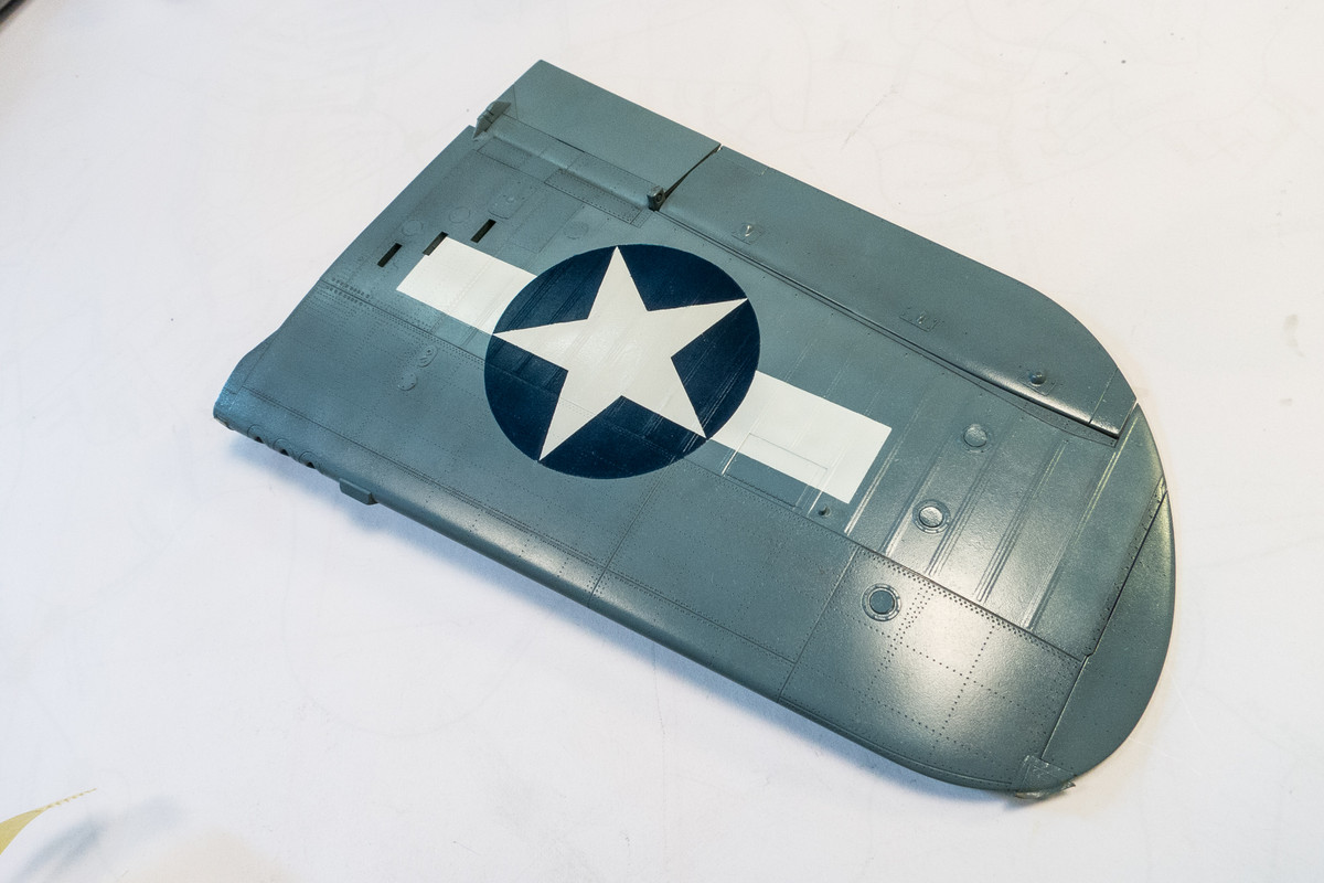

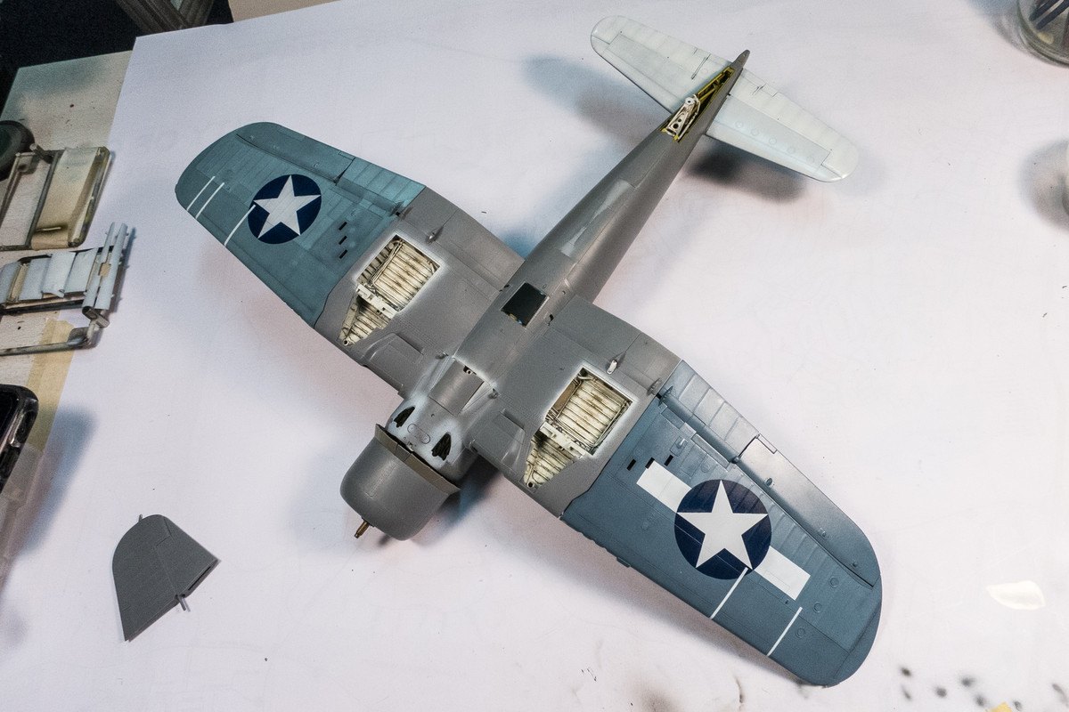

Thunnus Posted December 26, 2019 Author Posted December 26, 2019 Getting closer to applying some paints to the fuselage but I have to complete a few things first. One of them is to attach the tail wheel, which is pinned into place by the a long panel on the fuselage bottom. I'll have to mask off the tail wheel prior to painting. Conveniently, I've run out of one bottle of AK Real Colors Insignia White so I've used that as a container to mix a slightly lighter shade of the Dark Blue (AK Real Colors) upper camo color. I've left the AK Real Colors Intermediate Blue alone. Here is the initial painting of the starboard wing, which features the four-color scheme (which is essentially will boil down to a three-color scheme in this build as I'm not going to differentiate between the semi-gloss and non-specular Dark Blue). I've varied the uppers with a lighter shade on the fabric areas as well mixing up the colors on the interchangeable ammo cans. The bottom of the starboard wing with the insignia painted on. I've sealed this side with a gloss coat. The white taped areas have been painted and I've mounted the wings on the fuselage just to see what the two mismatched wings look like. The horizontal stabilizers have also been painted and have been temporarily slid into place. There is a lot of stencil decaling that needs to go on the wings and I'm taking a look at the Tamiya decals to see if I can get them to lay down properly. Using the standard Microset/Microsol treatment doesn't do much. Walters Solvaset gets the decal to sit into the recessed details but doesn't do anything about the thickness so I'm playing with hot water and possibly Mr Mark Setter and Softer, which I have on order. F-4Phanwell, TenSeven, sturmovik and 8 others 11
