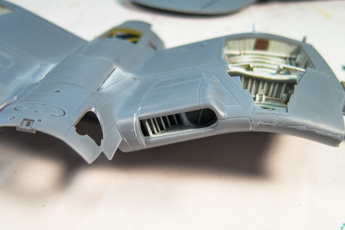

Thunnus Posted May 27, 2019 Author Posted May 27, 2019 Thanks for the comments! Especially the insight about the canvas in wheel well sidewalls. Couldn't respond or update since I was on a trip to Texas over the weekend. Before I left for my trip, I had glued the top and the bottom of the center wings together. There were some tiny gaps around the cooler intakes that I filled with White Milliput. Per the comments by Alfonso, the canvas side panels in the wheel wells were painted in a couple different shades of tan/buff and the square block on the rear wall has been painted brown. TenSeven, Anthony in NZ, Greg W and 9 others 11 1

thammond65 Posted May 28, 2019 Posted May 28, 2019 10 hours ago, Thunnus said: Thanks for the comments! Especially the insight about the canvas in wheel well sidewalls. Couldn't respond or update since I was on a trip to Texas over the weekend. Before I left for my trip, I had glued the top and the bottom of the center wings together. There were some tiny gaps around the cooler intakes that I filled with White Milliput. Per the comments by Alfonso, the canvas side panels in the wheel wells were painted in a couple different shades of tan/buff and the square block on the rear wall has been painted brown. Lovely work! The only time I have seen the colour of the canavas panels is on the Yeovilton Corsair, and then only the inside of the them as the outside is painted the same colour as the wheel well. Your colour is pretty much the same as the inside (maybe a little darker and browner), but I suspect the outside was simply painted, rather than being masked off when the well was painted. I will try an scan the pictures from the Corsair book later. Thunnus 1

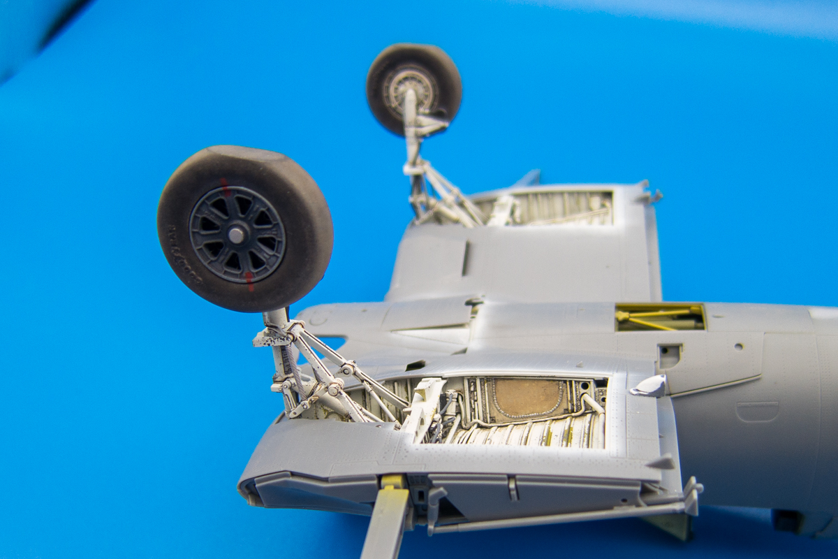

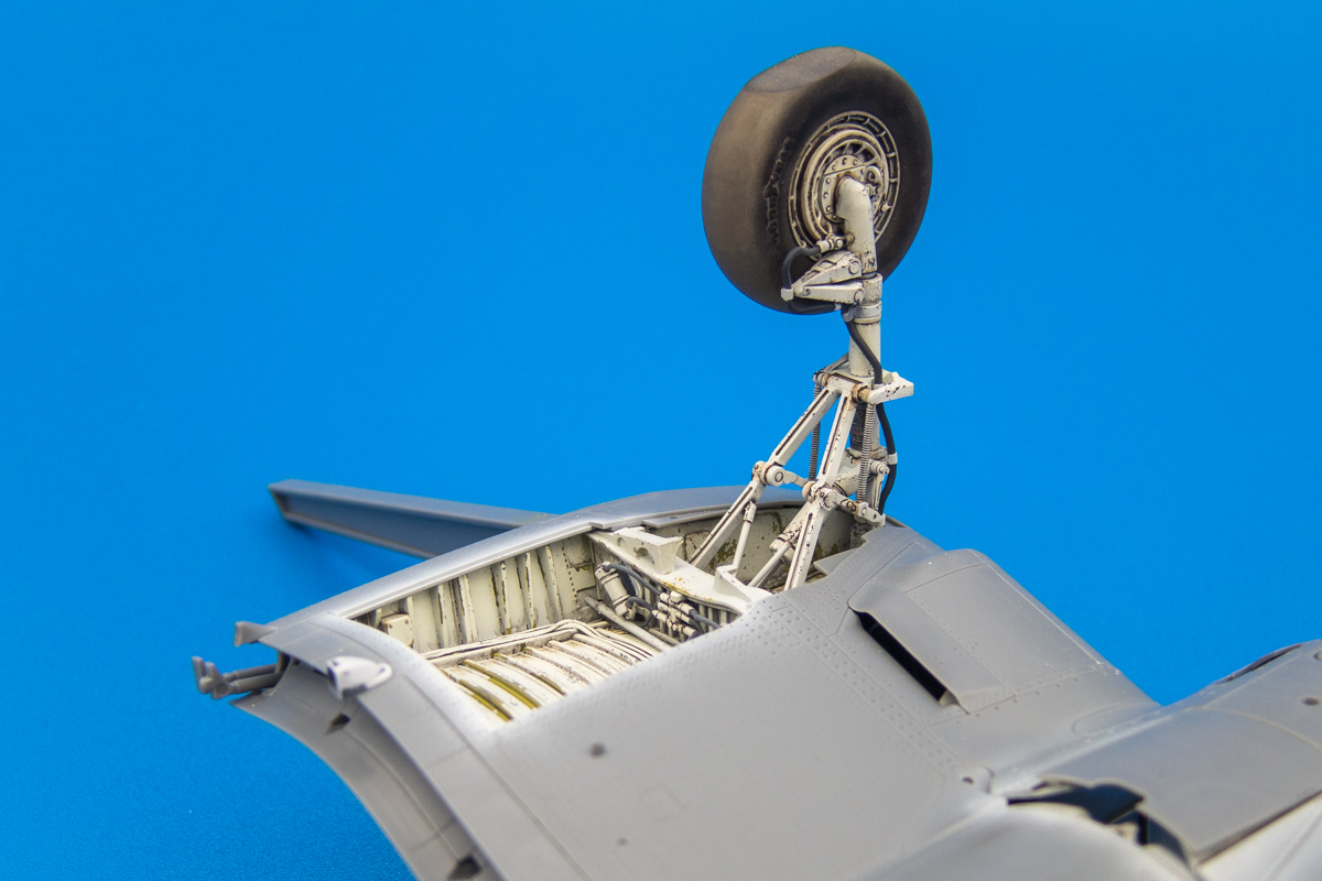

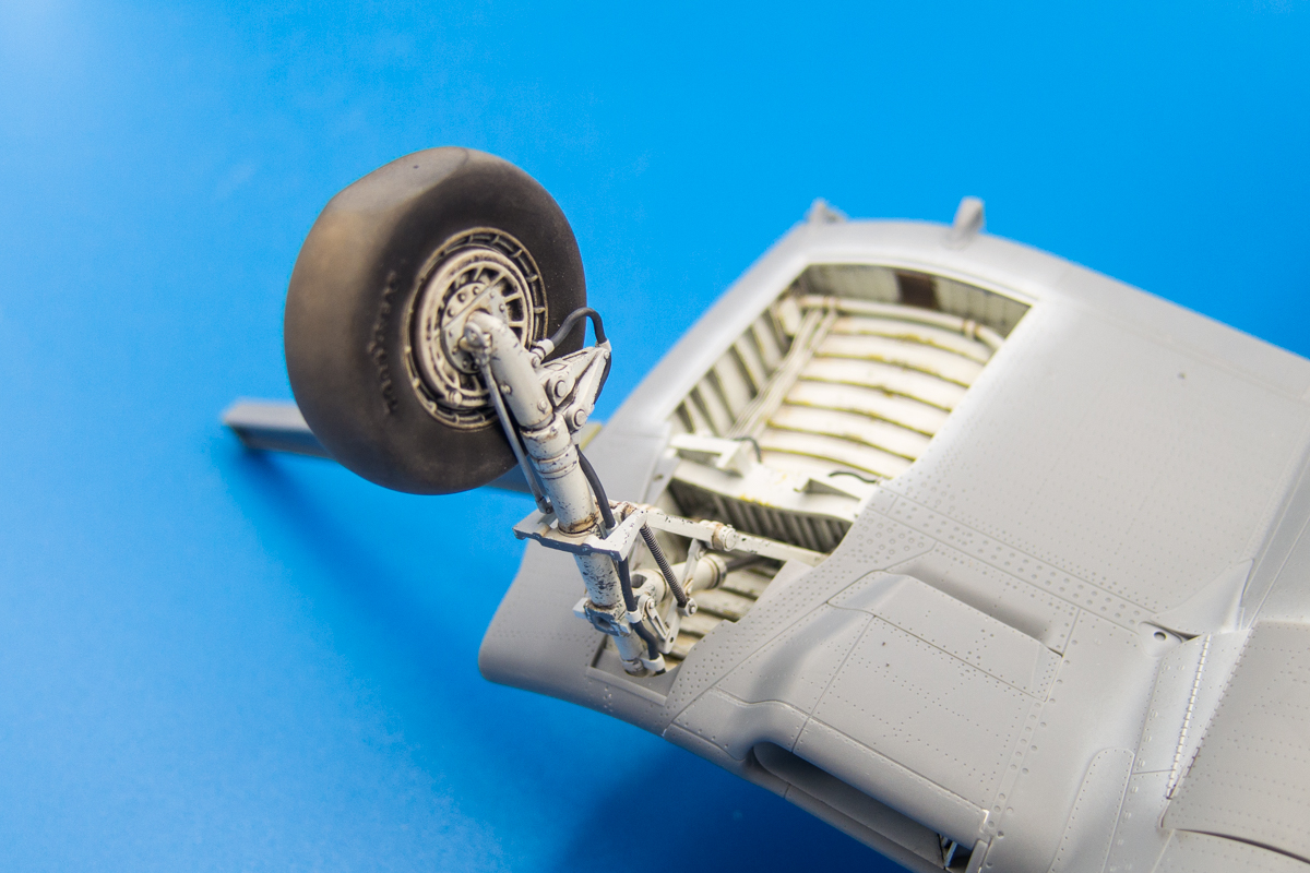

VintageEagle Posted May 28, 2019 Posted May 28, 2019 (edited) The landing gear and gear wells look superb! Would you mind explaining step by step how you achieved this realistic looking weathering? EDIT: Just read the whole thread and realized that you have explained your paint process in detail. Thanks! The tiny stains were added by a sponge. And the chipping was achieved by using chipping fluid. Did you use dry pastels on the tire or was it a wash? Edited May 28, 2019 by VintageEagle
Thunnus Posted May 28, 2019 Author Posted May 28, 2019 26 minutes ago, VintageEagle said: The landing gear and gear wells look superb! Would you mind explaining step by step how you achieved this realistic looking weathering? EDIT: Just read the whole thread and realized that you have explained your paint process in detail. Thanks! The tiny stains were added by a sponge. And the chipping was achieved by using chipping fluid. Did you use dry pastels on the tire or was it a wash? Thanks! Correct on the weathering of the landing gear. I also added some brownish stains very sparingly along various joints and junctions using an AK Enamel Wash (Engine Oil, I think). For the tires, I threw a bit of everything. First, the the tires were sprayed dark brown/grey. I sprayed the contact surfaces a lighter tan/brown color. I then played around with applying some dry pastels to the wear surfaces but I always seemed to be wiping off the pastels whenever I touched the tires. So after sealing with a flat coat, I used a wet pastel wash to further stain the outer rim of the tires.

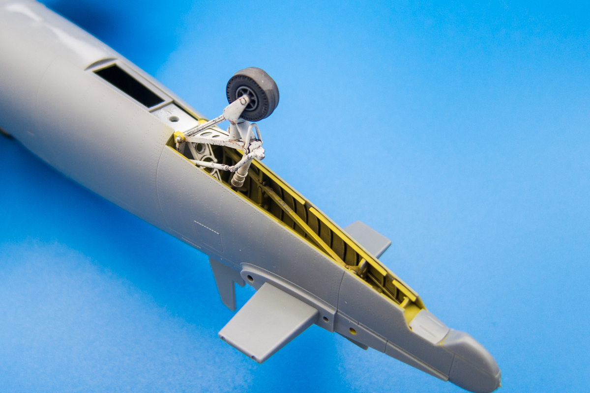

Thunnus Posted May 31, 2019 Author Posted May 31, 2019 The lipped edged around the main wheel wells have been masked off and sprayed Insignia White. I've also added some black staining to the wood block on the rear wheel well wall, although it is hard to see in the pics. Since the wheel wells are complete, I want to see if how the landing gear fits... Michael931080, TAG, D.B. Andrus and 12 others 14 1
