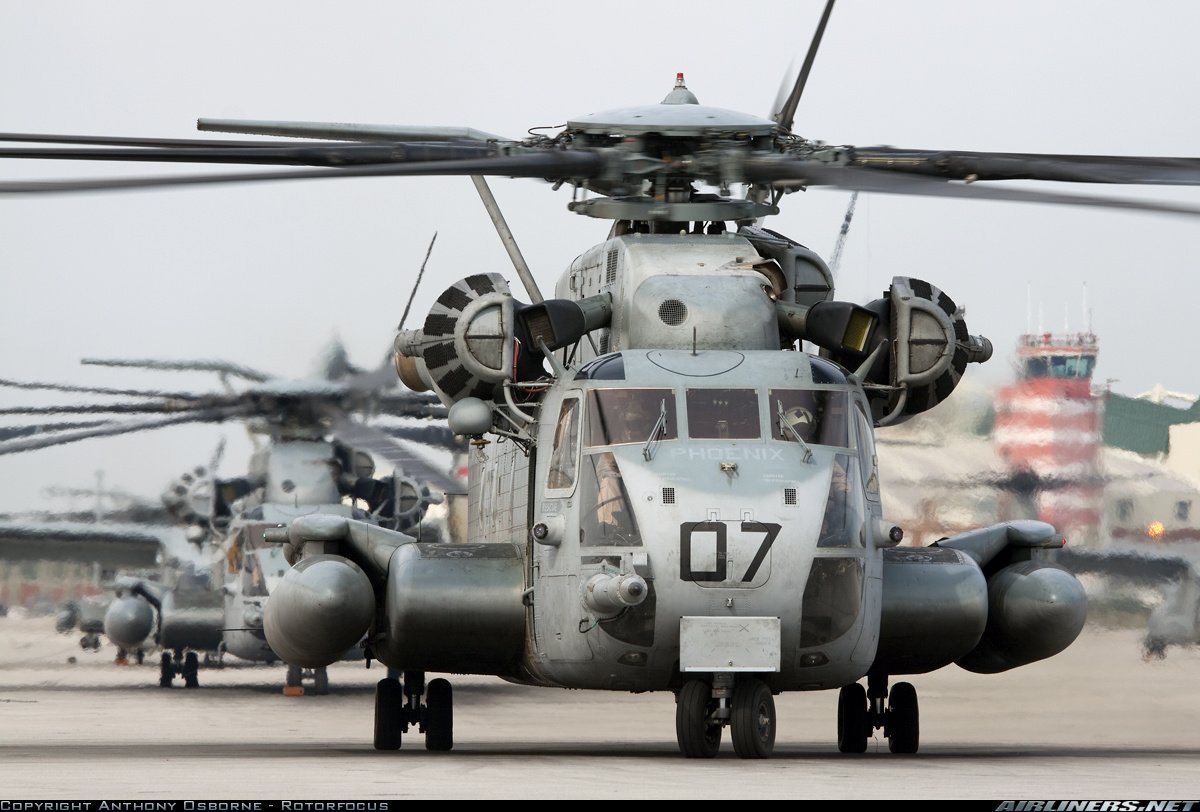

LSP_Paul Posted January 23, 2019 Posted January 23, 2019 Go Ben Go! Man you never cease to amaze and inspire with your subject choices and execution.. Good luck on the new Big 'un , I'll definitely be watching. I second Timmy's sentiments, Ironhorse would be cool =-) Pic included for motivational and educational purposes only =-) Paul Dadeo911, sandokan, D.B. Andrus and 3 others 6
