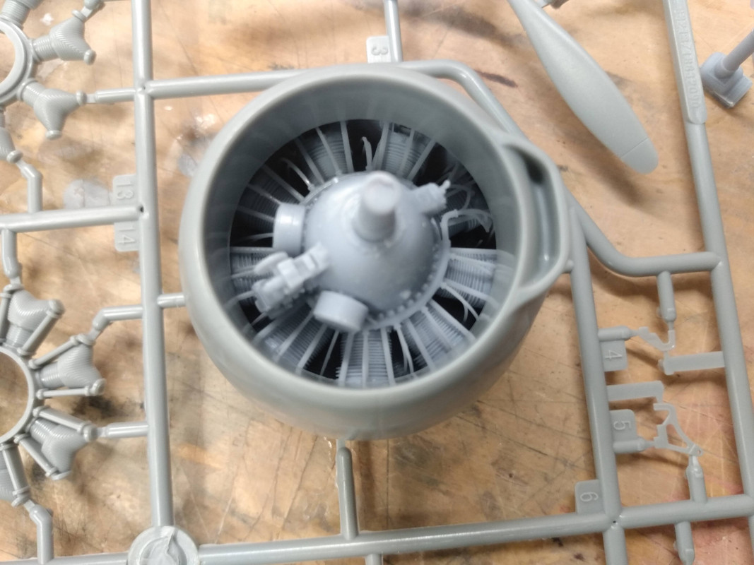

32scalelover Posted August 24, 2020 Posted August 24, 2020 Does anyone have the 1/32 Hobbyboss A-26B and the P-61 or Trumpy F-6F or F-4U where they could check the R2800's in the kit to see if they will fit in the A-26B cowls? If they do, then maybe you can just order 2 extra engine sprues from HobbyBoss/Trumpeter to get the engine corrected for the A-26B a lot cheaper than the resin replacements? Greg Lietsalmi 1
Dave Williams Posted August 24, 2020 Posted August 24, 2020 I’d be curious if very many people could get a hold of the engine sprues from the Hobby Boss P-61. Does HB even sell sprues? Even if they do, are they any sprues available? Not sure the kit is still in production.

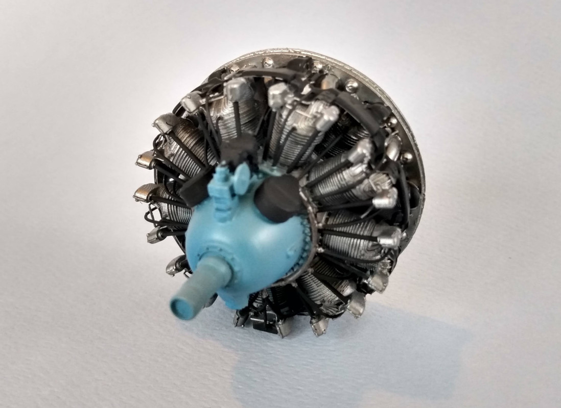

Lietsalmi Posted August 24, 2020 Posted August 24, 2020 6 minutes ago, 32scalelover said: Does anyone have the 1/32 Hobbyboss A-26B and the P-61 or Trumpy F-6F or F-4U where they could check the R2800's in the kit to see if they will fit in the A-26B cowls? If they do, then maybe you can just order 2 extra engine sprues from HobbyBoss/Trumpeter to get the engine corrected for the A-26B a lot cheaper than the resin replacements? Greg I do have the Trumpeter F-6F kit and I am actually using its R2800 engine as a starting point for my A-26B resin engine replacements. Trumpeter actually made the R2800 engine originally for F-4U (written on the sprue) and just added the same engine to the F-6F kit. This engine still needs a few modifications to represent properly the R2800 engine used in A-26B but even without any modifications it is way better than the kit engines. alanash1963, Rick Griewski, Learstang and 4 others 5 2

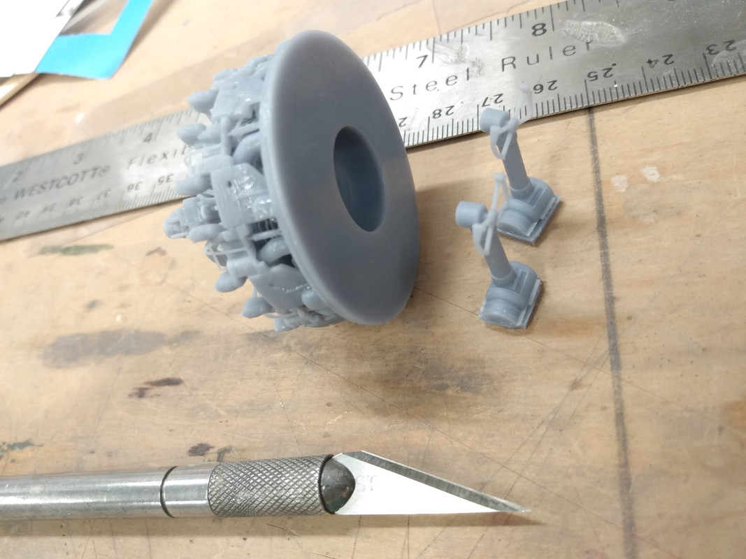

Dennis7423 Posted August 27, 2020 Posted August 27, 2020 Just saw a fella over on Facebook that got the Resin2Detail engines "not" intended for this kit. They fit like a glove (no mods needed), and they look fantastic, even if they aren't the exact right type of R-2800 for the A-26. I just might spring for them at $40 a piece. - Dennis S. Thornton, CO USA Learstang 1

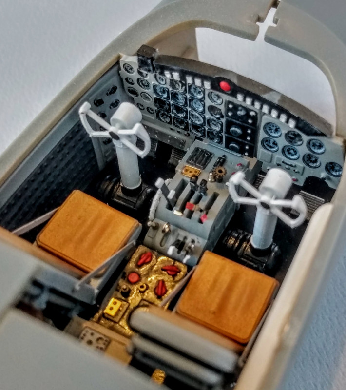

John Everett Posted October 4, 2020 Posted October 4, 2020 (edited) Can confirm the wholesomeness of Resin2Detail. He makes good stuff. I’ve used their “quick fix” engines and upgraded control columns in my version of the kit. Edited October 4, 2020 by John Everett Nailcreek, Harold, dutik and 11 others 14
