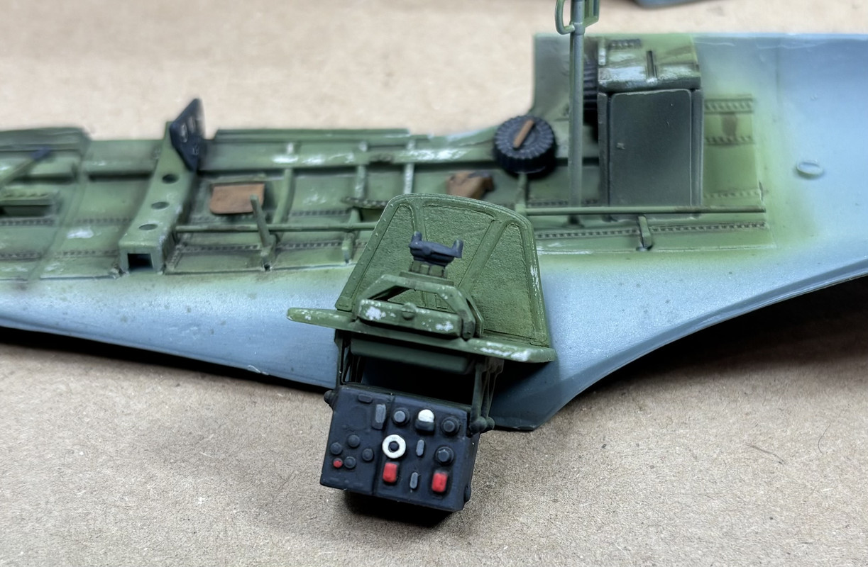

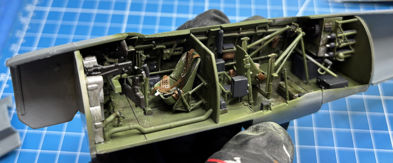

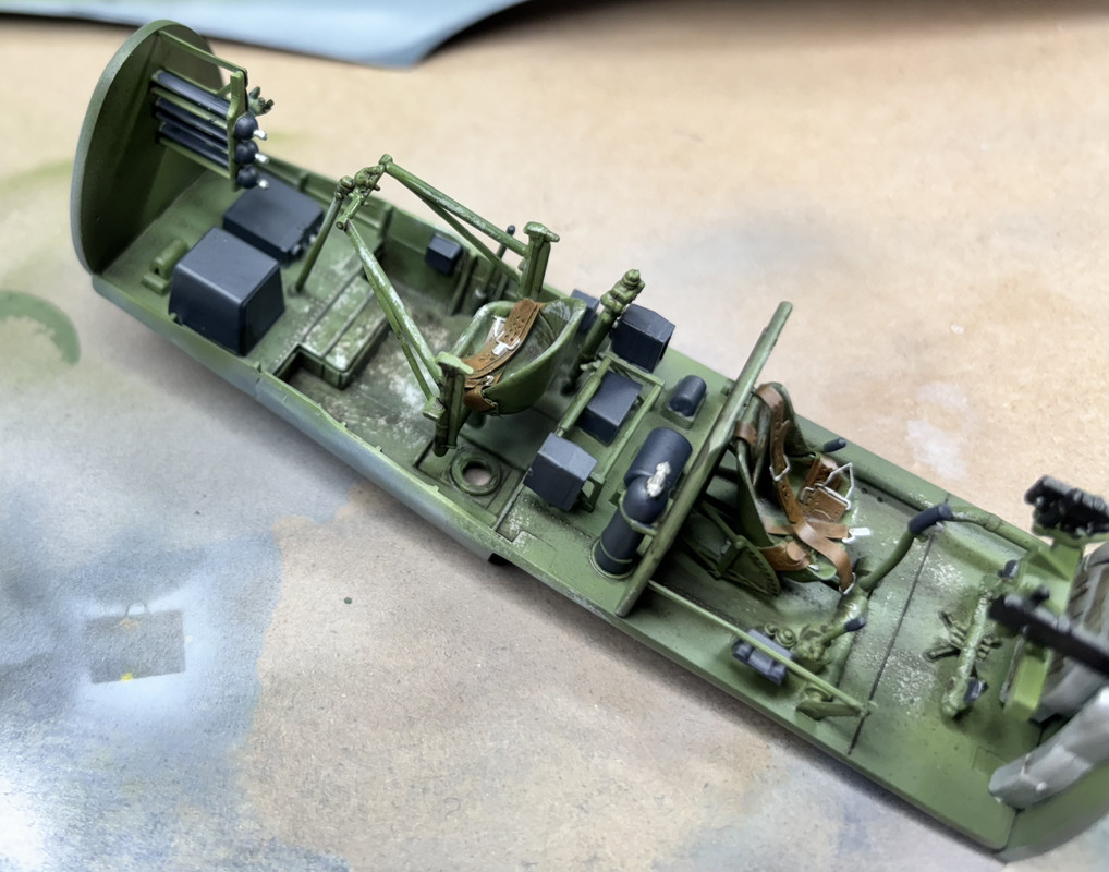

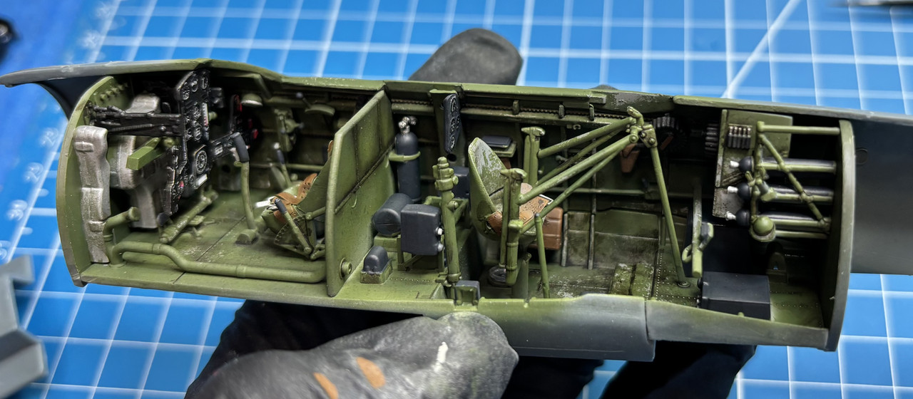

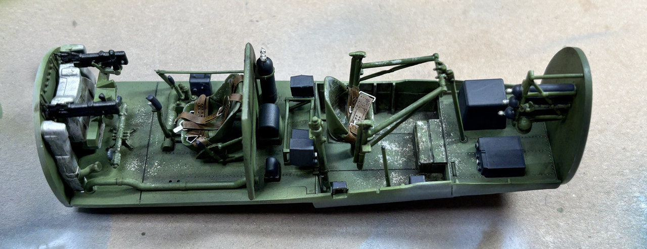

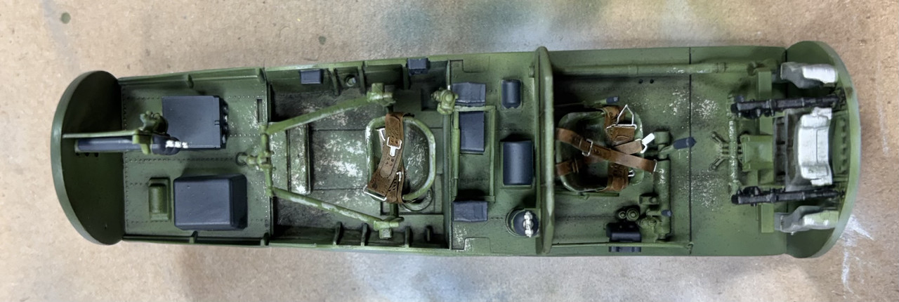

    Anyhoo, join me on this next and final chapter of this Infinity Val journey.  The interior finish went pretty well.  I started with an aluminum undercoat, hair spray, some preshading, then the interior green.

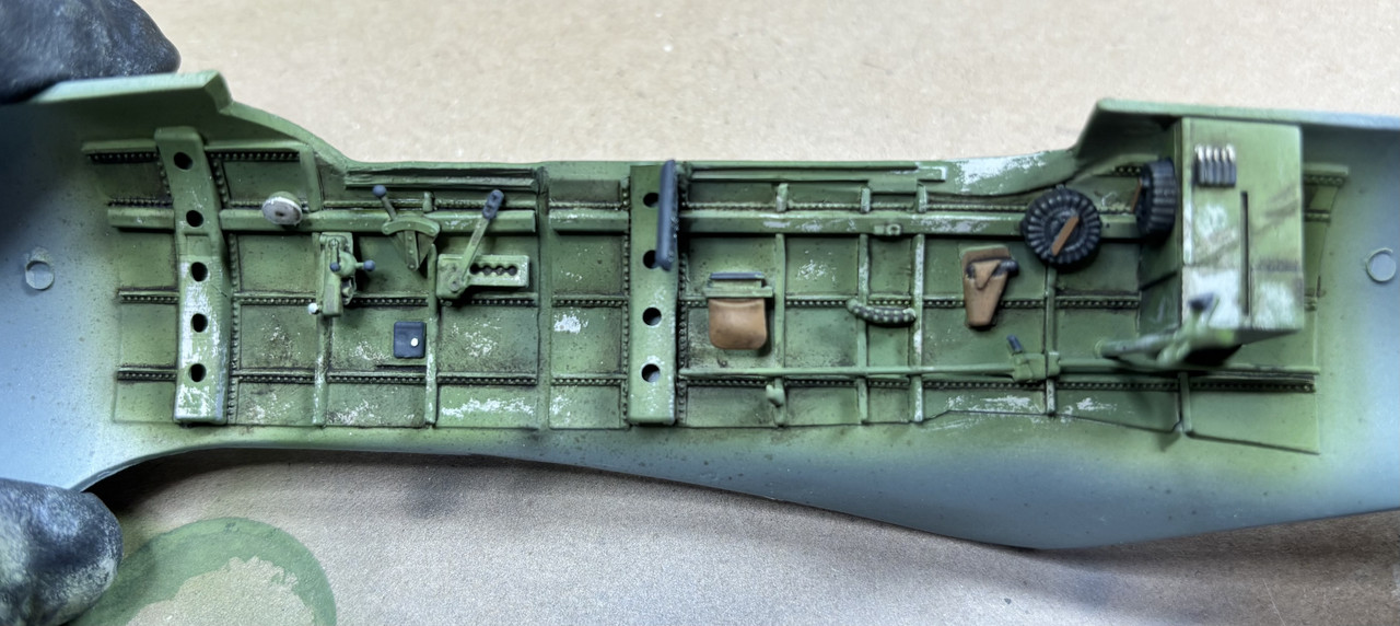

    Detail painting and weathering went pretty well, all told.

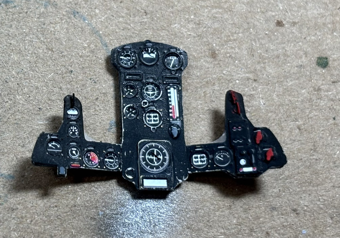

    The decals for the IP went pretty well too.  I cut them into 5 different sections to help them settle better and, in the end, I was pleased and naively optimistic.
    Putting it all together yields pretty pleasant results.

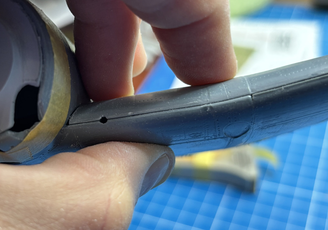

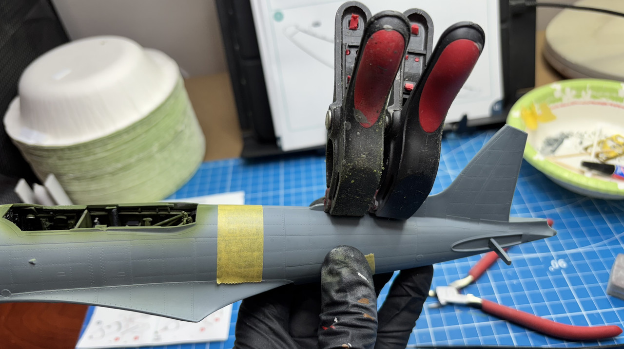

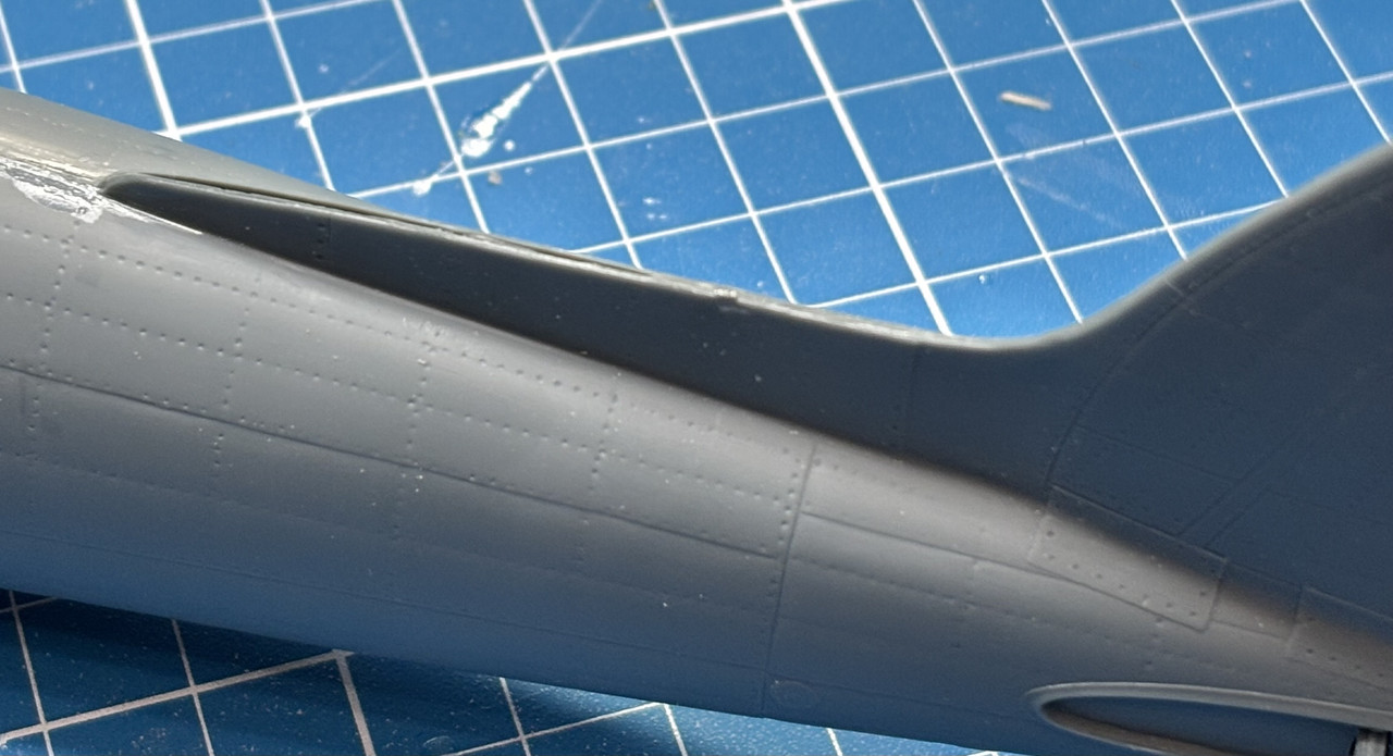

    Absolutely nothing else fits well on this kit.  Nothing.  Everything has been a fight.  Even after careful sanding to smooth out the mating halves and clamping it heavily, the vertical stab's spine still has 1mm gap along most of its length.  The cockpit to fuse fit required more superglue than I care to mention and it still wasn't enough to give a clean fit.

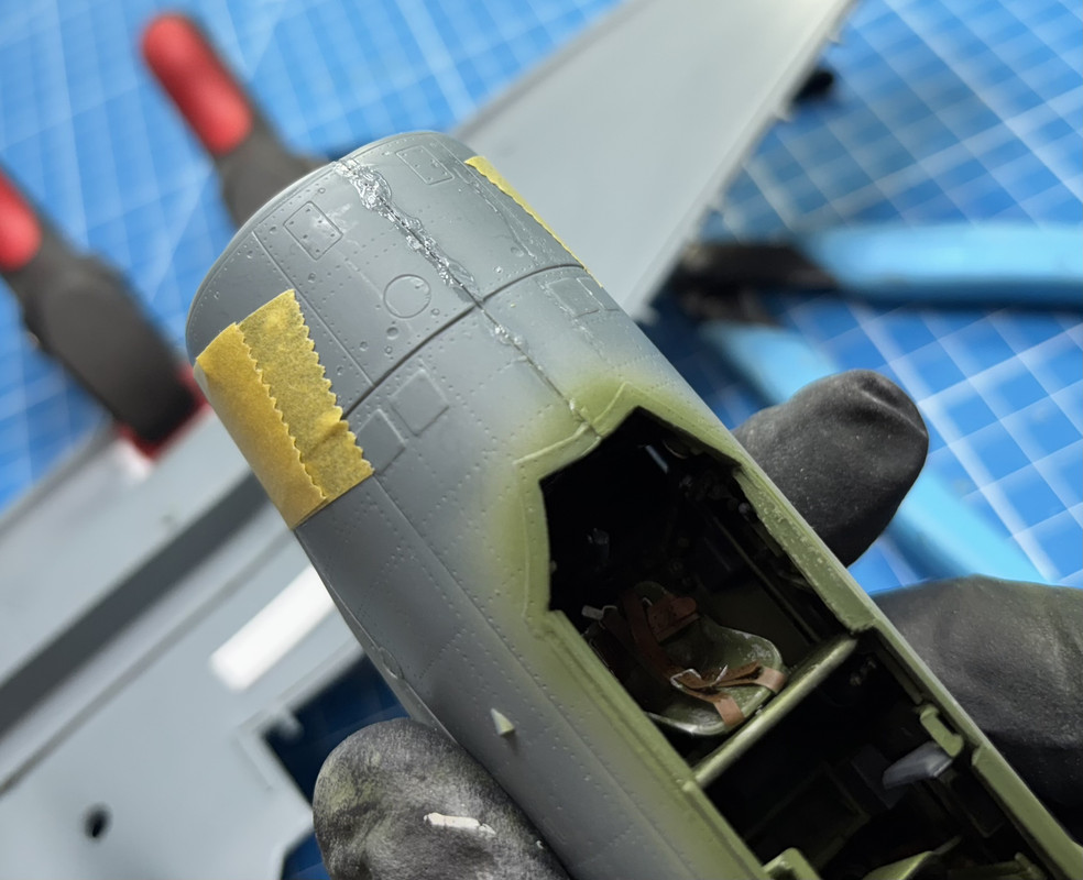

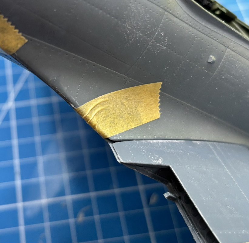

    The curves of the fuselage halves fit neither the contour of the cockpit tub or the firewall itself.  This mess is what is left after copious amounts of cement, superglue, and tape were used to try to get the front of the fuse around the firewall.  If left to its own devices, the fuselage halves wanted to spread out 3-4mm further than what you see here which would have left a huge step between the fuse halves and the bottom of the wing's center piece.
    Despite filing all the interior bulkheads down to try to avoid this issue, the fuse halves had large gaps forward of the cockpit.

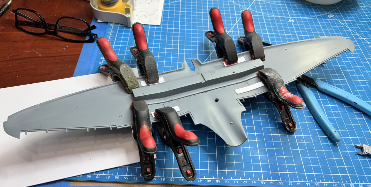

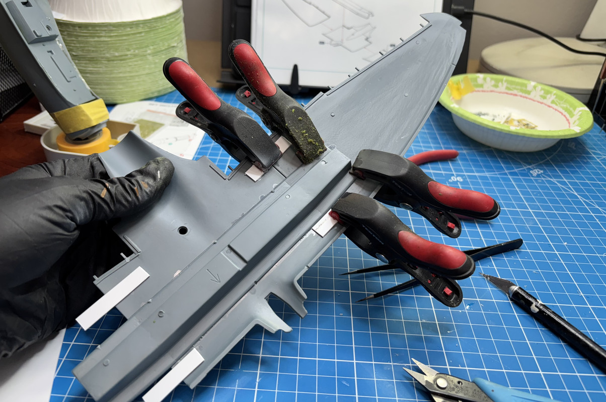

    I bolstered the wing joins with extra tabs because they are just simple butt joints.
    I ended up having to shave down the top of the main spar quite a bit because it was too thick to fit between the wing halves.

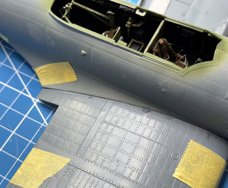

    I attached the lower wing assembly to the fuselage first, then worked to try to contour the wing root mating surface on the upper wing parts to get everything to line up.  Here is the result of about a half hour of careful sanding, testing, and repeating.  Looks good, right?
    Erm...

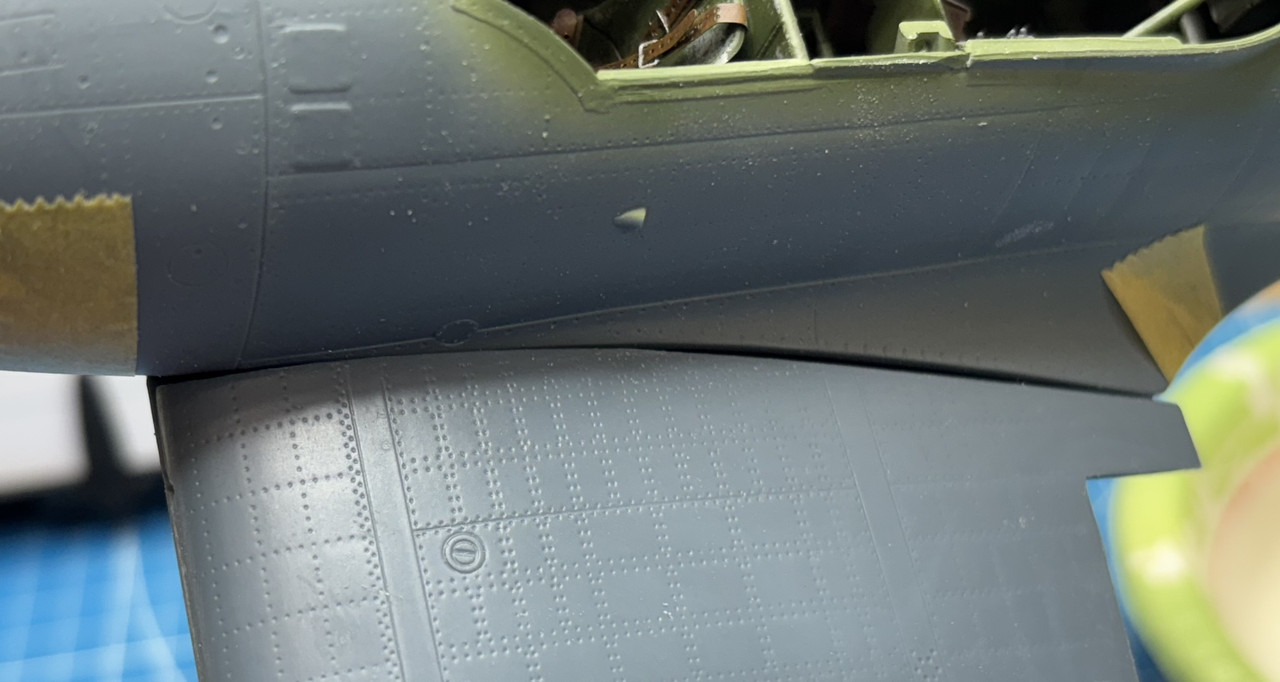

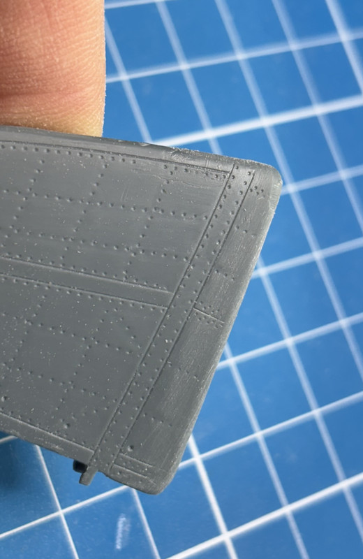

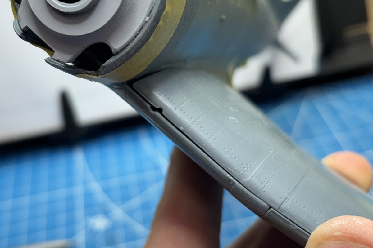

    Here's the left side before any sanding or fitment work.
    That's probably a full 3mm offset there.  :BANGHEAD2:
    This took about 45 mins of work to get it here.
    Notice the lip of plastic on the lower outboard leading edge.  That's a running theme throughout every single piece of this dumb kit.

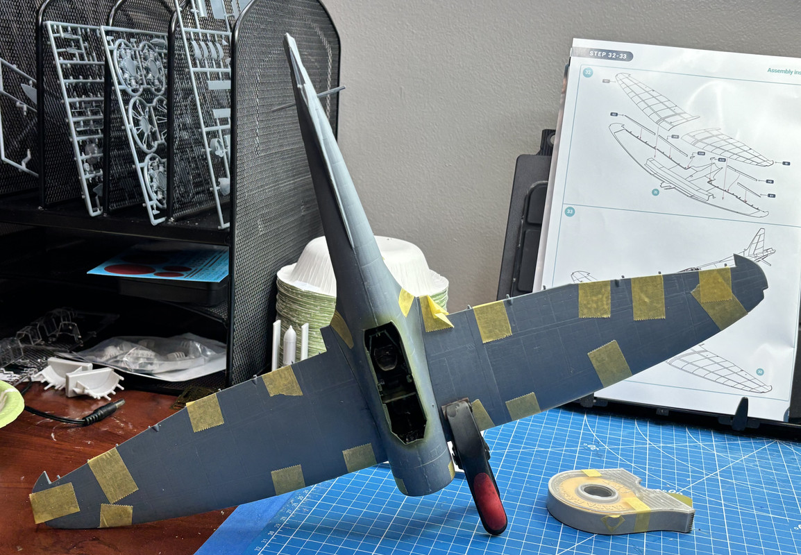

    The whole mess glued together.

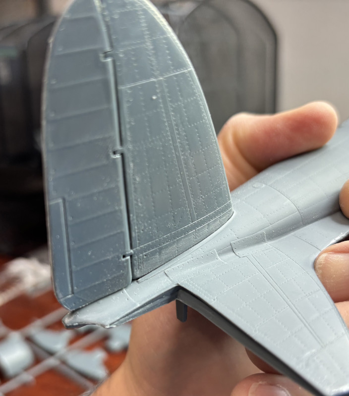

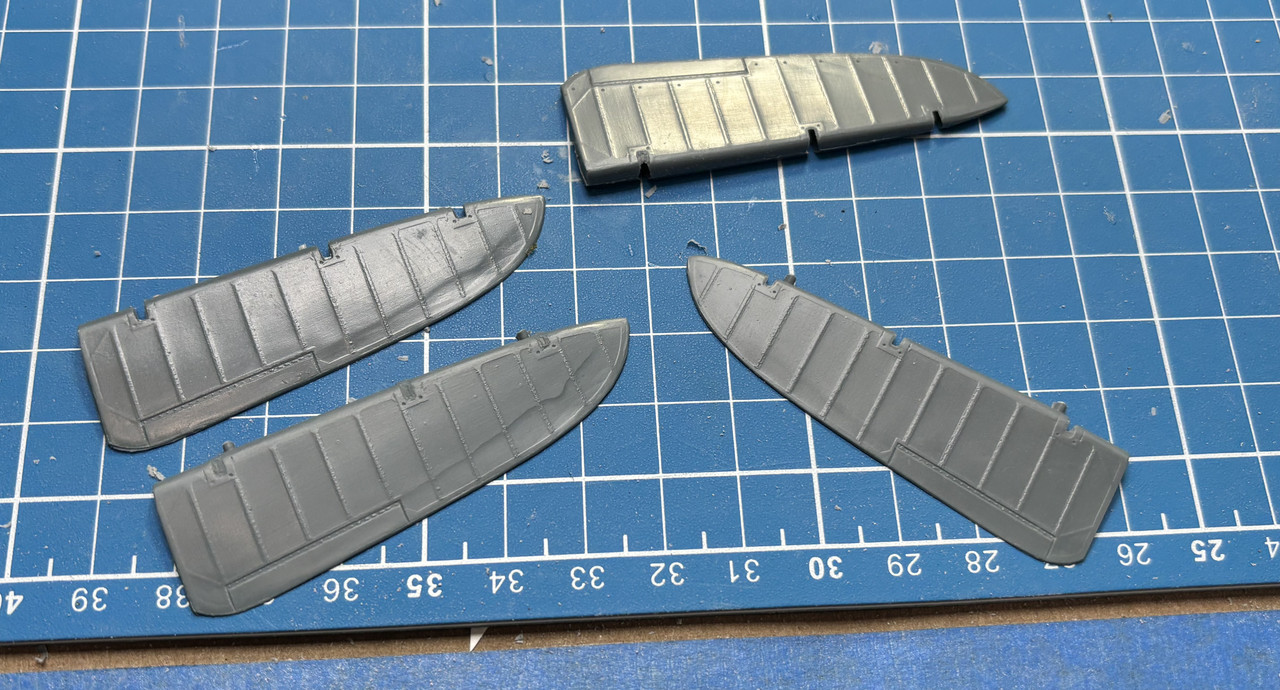

    Why not include 5 elevator halves in a single kit?  Seems reasonable.  Also, be sure not to number any of them; gotta keep that builder guessing.

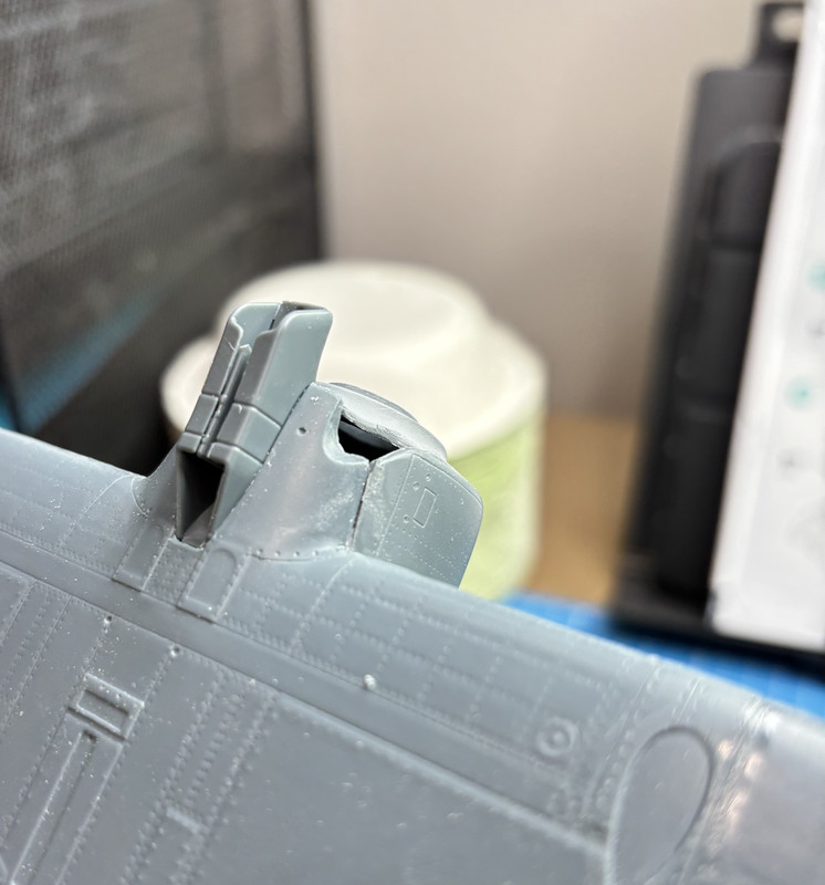

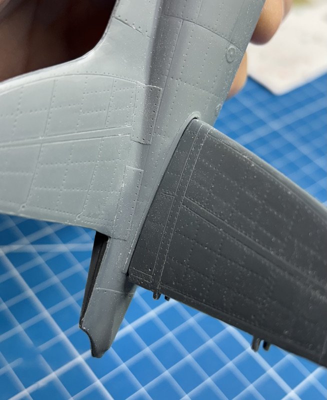

    You want the h-stab to fit inside that little fairing?  Right.
    Sand the bejeezus out of it and scrape it till it halfway fits.

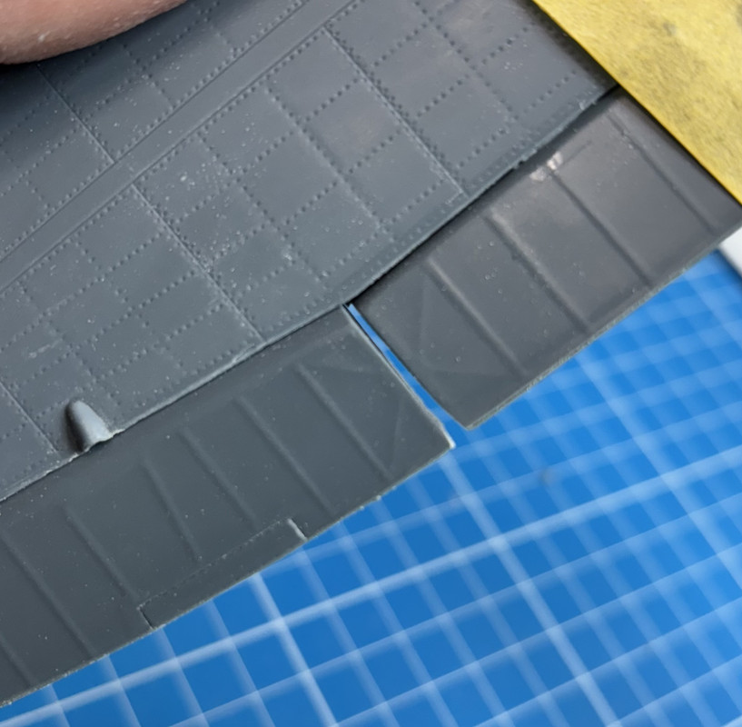

    On to the ailerons.  Guess what!  They don't fit!
    "I'm shocked!"
         - No one
              - ca. Ever

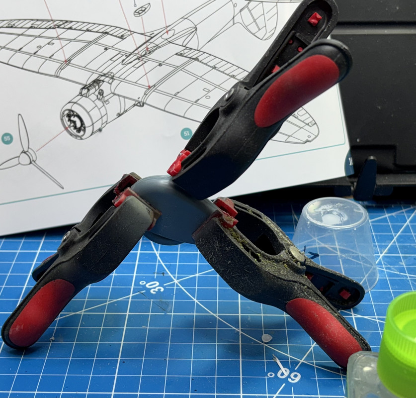

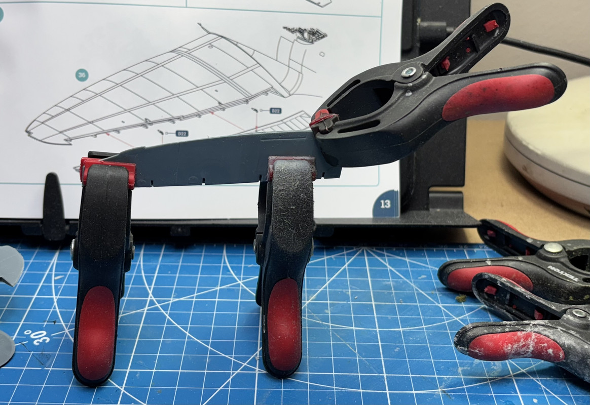

    Even after sanding the mating surfaces smooth (again), there's still a significant gap at the trailing edge and a lip at the leading edge.  For crying out loud.
    At least I got to make a cute little horsey figurine with the clamps.
    After much fiddling and fussing, I got them installed only to find that there's a significant gap between the elevator and the flap.

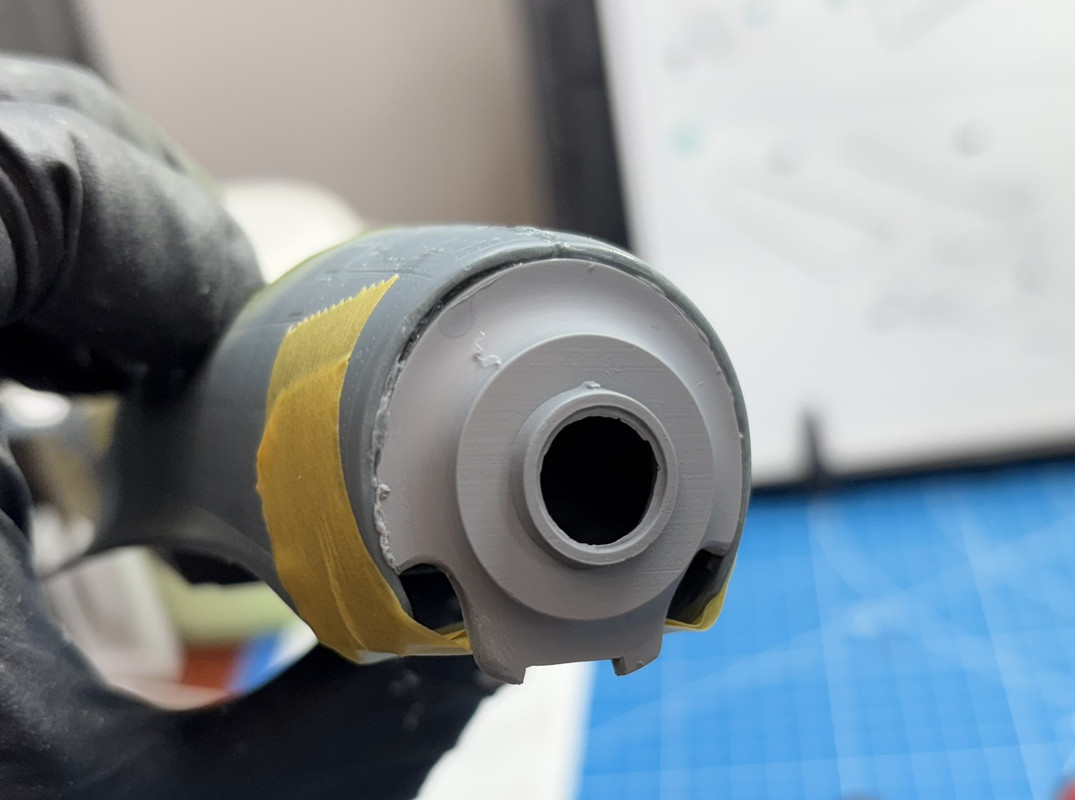

    I didn't even take pictures of the unmitigated disasters that are (yes ARE) the engines.  I believe the instructions call out the wrong part numbers so that by the time you try to fit the two banks of cylinders together, you end up with two parts that with male to male connection surfaces.  Plus, none of the alignment keys actually align anything and not one part - case, push rod tubes, cylinder banks, intakes, or exhausts - want to align properly.  In the end, I just cut off the intakes and exhaust and just stuck the engine on the firewall, resigning myself to the fact that no one would see the back of the engine anyway.  Ridiculous.
    The resin engine requires you to sand off a huge pouring block in a recessed area that is nigh impossible to reach, least of all without destroying detail on the part.  To add insult to that injury, the detail on the resin engine isn't that much better than the plastic offering, so it's not even worth the time.

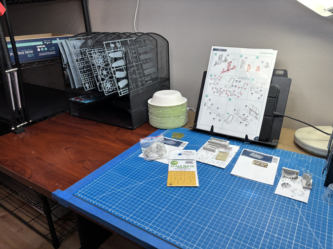

    The workbench, all neat, organized and ready to go.  Not pictured: mouth guard, spit bucket, and referee.

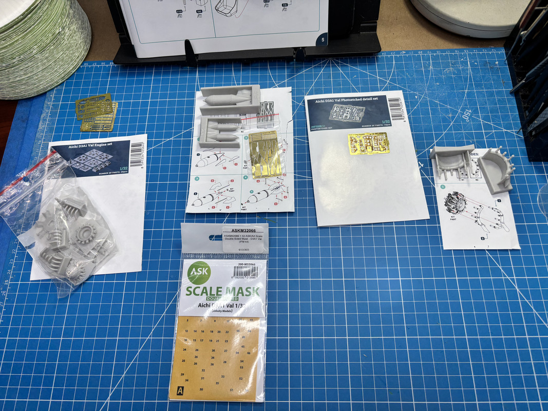

    Here are the add-on parts I bought back when the kit first came out.  All except the mask set are from Infinity directly.  It kinda chaps me that they'd put out a kit with a high price tag, then charge more for these add-on items, but they're not the first and they won't be the last.  And hey... it didn't stop me from buying them.

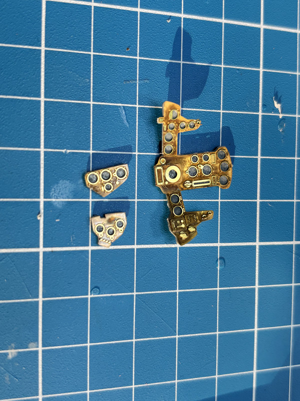

    Anyhoo, we have the engine set, bomb set, instrument panel "set" (one tiny fret of PE), and exhaust set.  The PE frets in the top left are included with the kit and have things like seatbelts, gunsights, and arming propellers for bombs.  These all look pretty nice, so here's to hoping they're worth the investment.

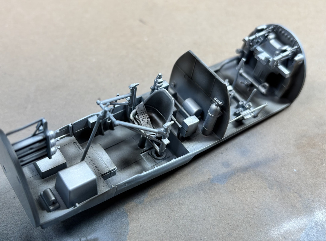

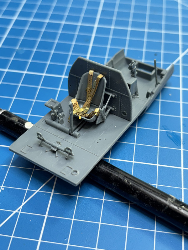

    The first step has you build the IP.  Miraculously, I was able to shave off the raised plastic detail without winging my thumb in the process (an altogether too common occurrence).  Later, I'll punch out the individual decals for the gauges and install them that way.  Should be a hoot.  At least the IP went together well, though there's really not that much to it.  Just a few knobs and such get added to give the final piece some 3D relief.

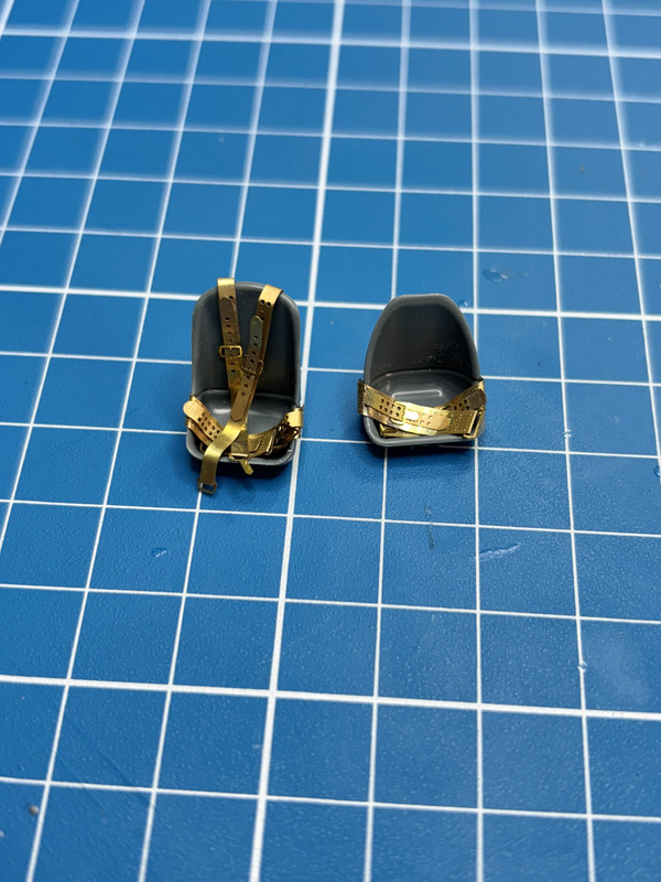

    The PE seatbelts went together remarkably well and actually look pretty good.  They'll be a challenge to paint in their current positions, but I actually prefer painting them in situ, so I'm used to that method.

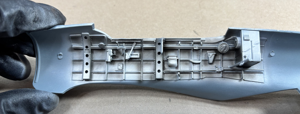

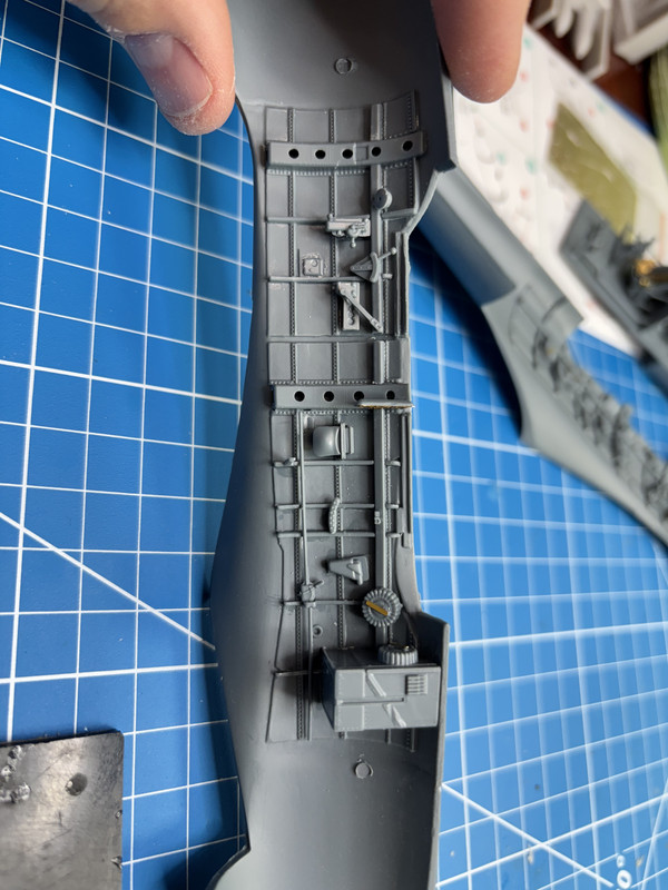

    Generally speaking, the detail on plastic parts is soft, locator pins are more an idea than reality, and in many cases you're left scratching your head about how things are supposed to fit together.  Then, when you do figure it out, it turns out the mating surfaces of the two parts are roughly the size of a pin head.  In short, there is currently equal parts superglue and plastic cement holding this thing together.

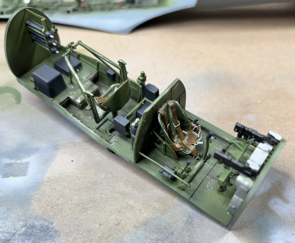

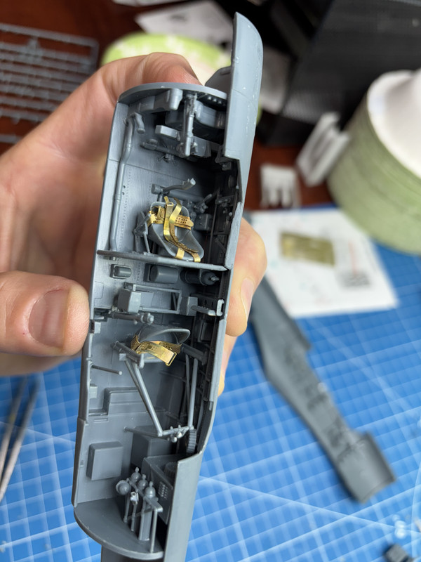

    Here the pilot's seat is installed and the bulkhead in place.  Nothing is dry fit.  If you see two parts together throughout this build, they'll either have tape, my fingers, or glue holding them together.  Dry fitting isn't a thing here due to the aforementioned lack of locator pins.

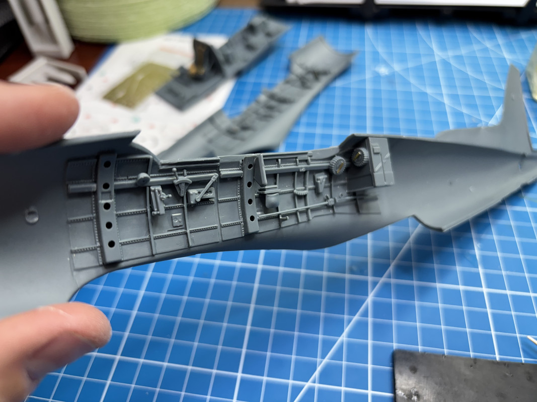

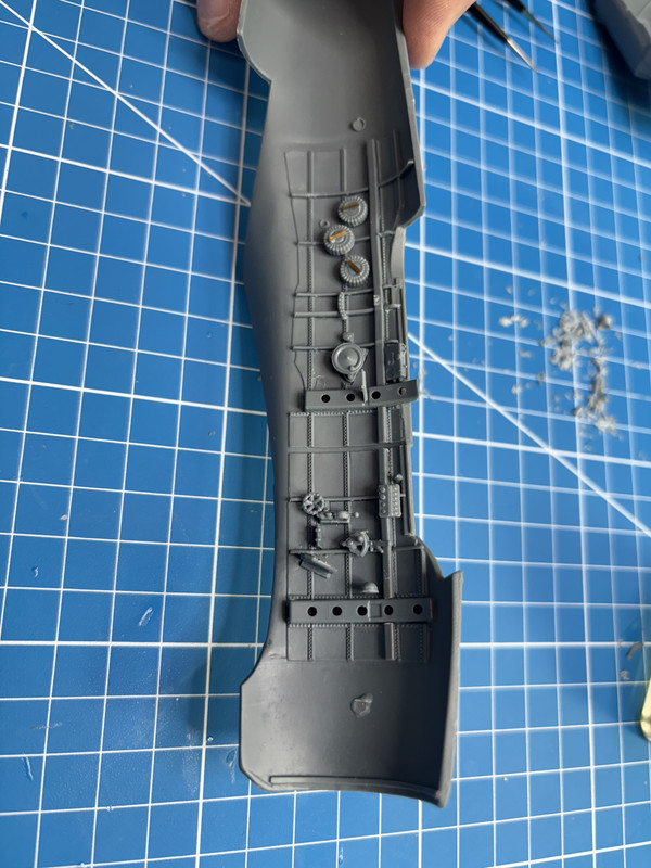

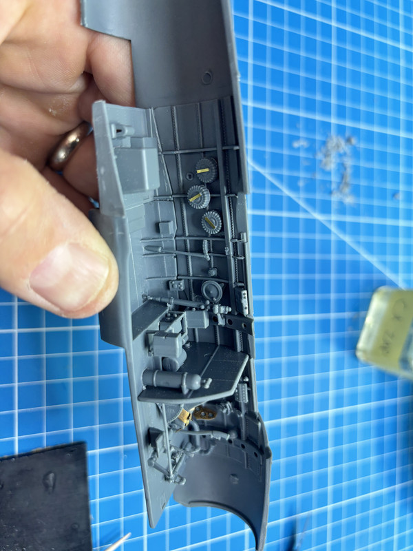

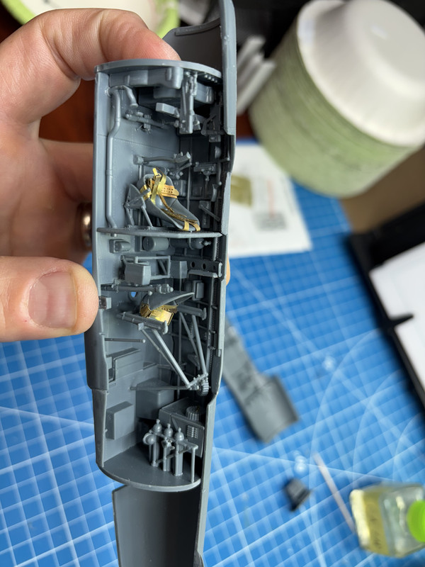

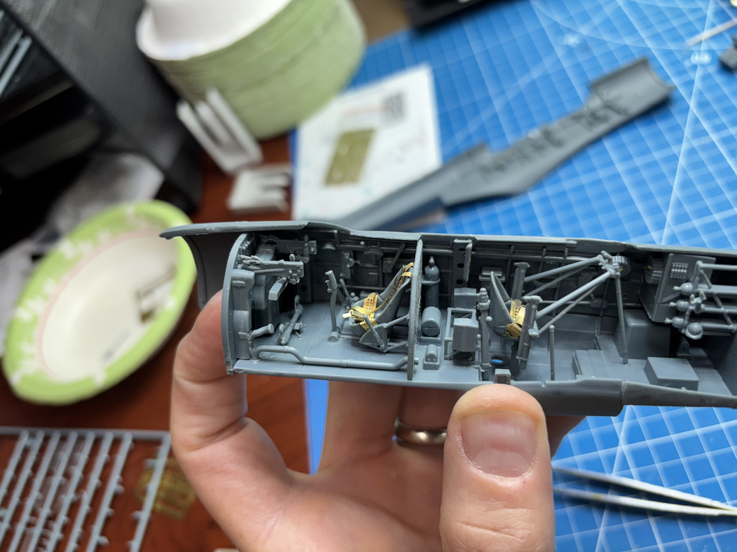

    I spent a good chunk of the morning getting the interior around.  You have to place each of the ribs individually and none of them fit all that well, so that was a bit tedious, but not overly challenging.  Oddly, the curve of the rib doesn't match the curve of the fuselage.  So, I had to tack one end down with superglue, set it with accelerator, then run more superglue under the other end of the rib so that it would conform to the fuselage.  I realized later that the vertical brace (horizontal in this pic) roughly amidships is glued on too high.  Its base should sit flush with the raised detail just forward of it.  I ended up having to nip off the part that sticks out the top.  In retrospect, my placement idea was dumb, but in my defense the instructions are... less than clear here.  😕  Either way, test fitting proves that my gaffe isn't visible with the fuse halves together.
    I was actually pleasantly surprised with how well things went together.  Make no mistake about it, I had to shave off things here and there to get stuff to fit or to sit flush, and there was judicious amounts of superglue and accelerator applied, but it was more or less straight forward so far.  Not "kit for beginners" straight forward, but if you've got some modeling moxy, you should be able to tackle this.
    Test fitting the cockpit to the sidewalls shows a fairly decent fit.  That gap between the floor tub and the sidewall will be impossible to completely hide, but it likely won't be very visible with the thing buttoned up.  I did have to shave the sides of the rear tub piece a lot to get them to fit against the fuselage side cleanly.
    Same pieces, but from forward.

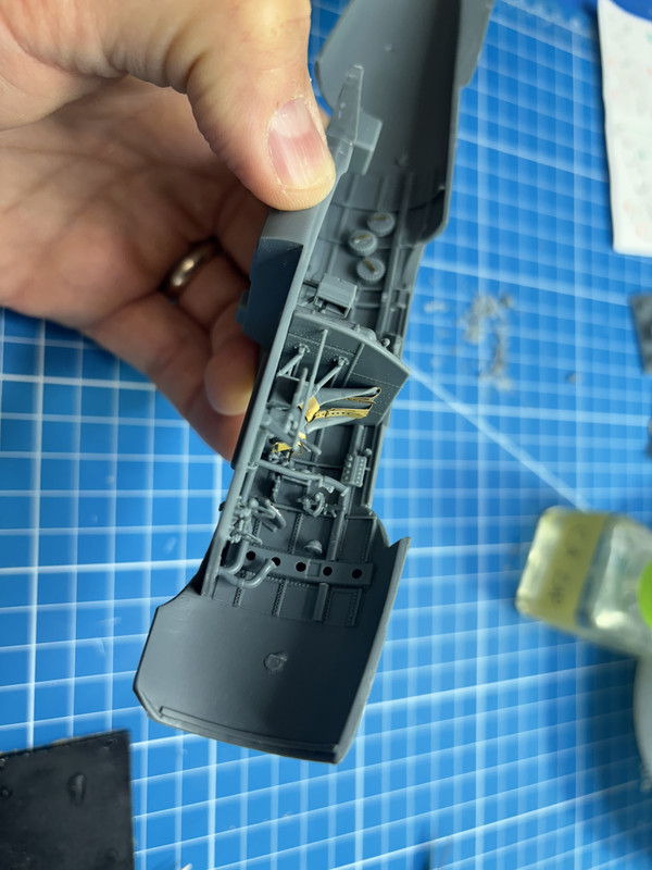

    I finished out the night by installing the gunner's seat and test fitting the fuse halves together.  Like some others who have built this model, I added a small support to the underside of the gunner's seat because otherwise, it is only held in place by the single vertical strut that connects to the two arms that project from the seat frame.  If that's the way it was in the real airplane, that strut must've been made of titanium or there was a really low weight requirement on gunners because that was just ridiculous.  Anyway, you can see it fits fairly well and there's a decent amount of (admittedly soft) detail here.
    Sorry these are vertical.  I'll adjust them before I upload them next time.  In any case, they give you a feel for how things go together.  Before I get too much further, I'll likely add some small tabs below the cockpit floor to help stabilize it, then add some tabs to the fuse halves so they'll line up somewhat cleanly.
    That's where we're at today.  I did test fit the fuse halves and was, again, pleasantly surprised with how well they fit together.  That's (emphatically) not to say that they fit well, they just fit better than I expected.  It looks like the spine for the vertical stabilizer will require a ton of filling and I'm only partly convinced that the firewall will go in with anything resembling accuracy, but that's future me problem.

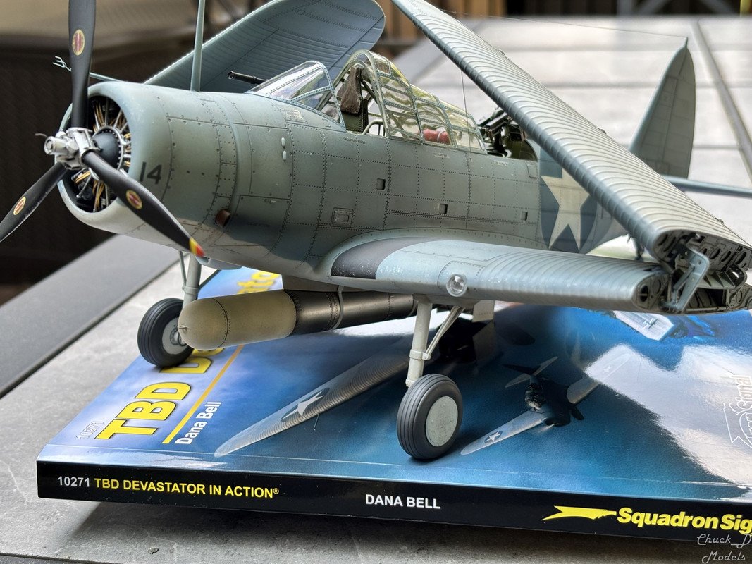

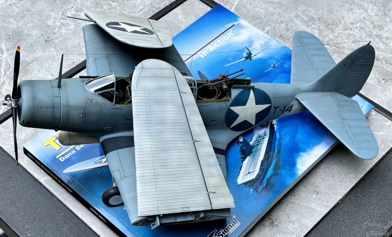

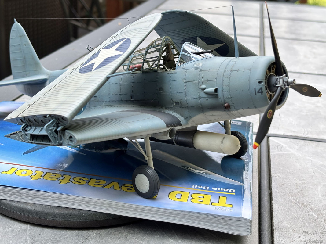

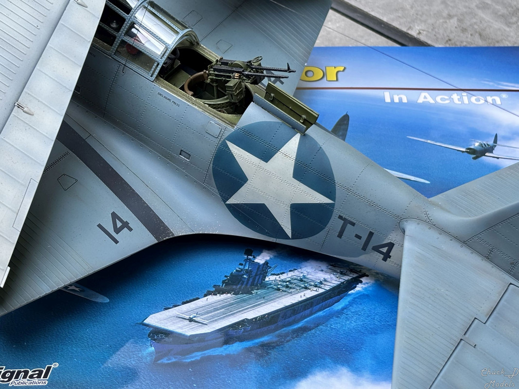

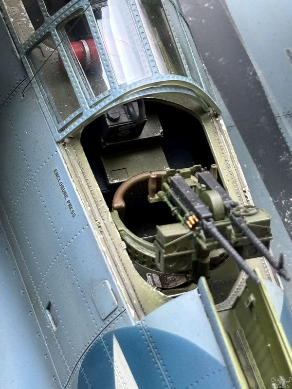

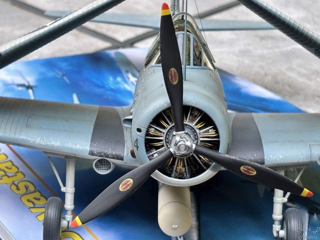

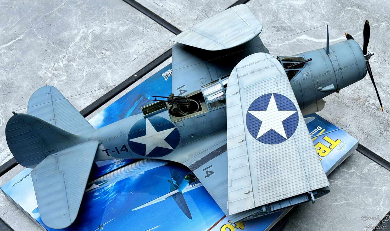

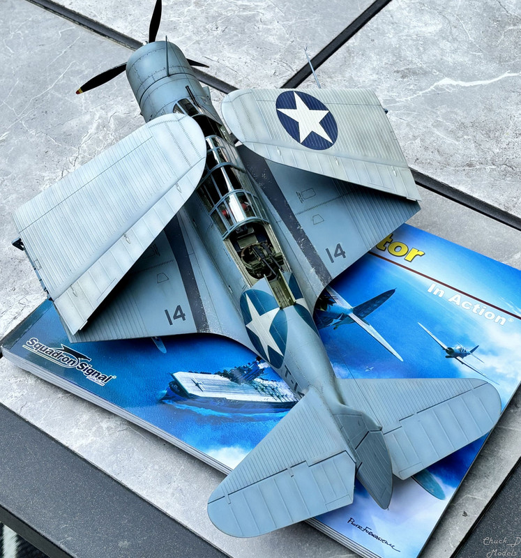

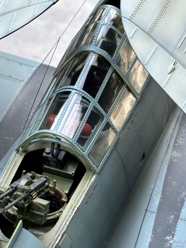

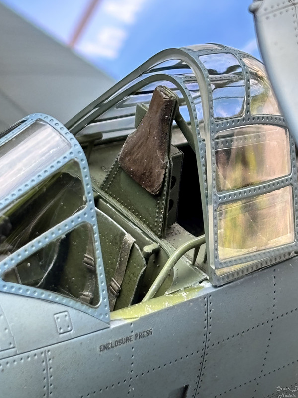

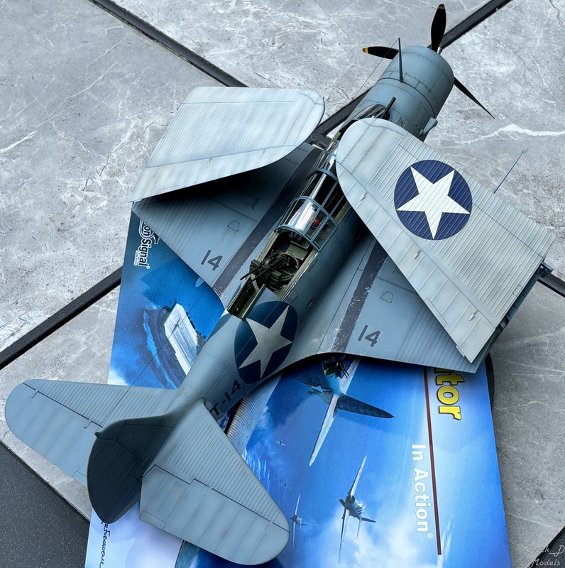

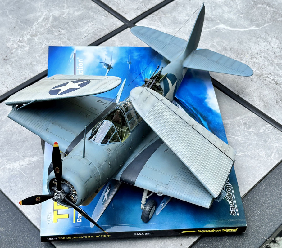

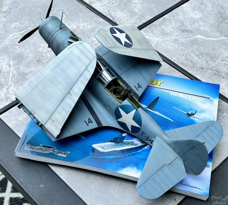

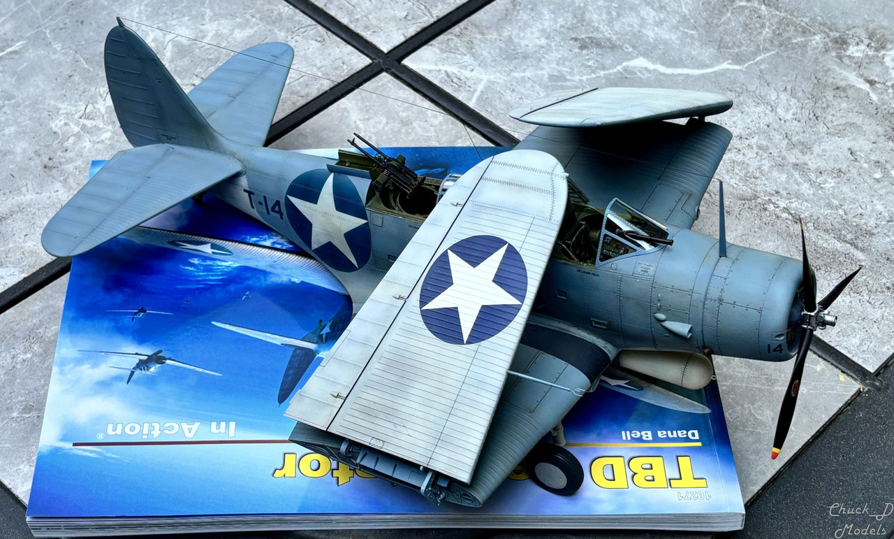

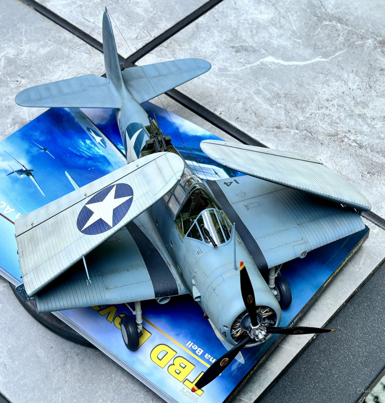

  4. Hello, everyone!  Long time, no post.  After completing the "panzer of the river" dio back in February, I've started a few things but struggled to get anything across the finish line.  Happy (very) to report that this one is done.  It fought me most of the way, but by the time I'd gotten really frustrated with it, I was too far along to pitch it.  That said, I'm more or less happy with the result.  The decals have me fits and you'll see quite a bit of silvering which is just super frustrating.  I opted for decals as I wasn't confident that I would be able to get masks to lay down in the wing corrugations.  Turns out the decals didn't feel like doing it either.  Oh well.
    I was really geeked about the Devastator kit when it came out, but in my opinion, Trumpeter managed to put out an aggressively mediocre kit.  In that regard, I guess Trumpeter managed to capture not only the form of the real airplane, but it's whole vibe too.  So, kudos to them on that front, I guess. (?)
    Anyway, the fit was okay in general, but I had it in my head to really detail up the interior, only to find that it's really really spartan.  The whole bomb aimer's area is just pure fantasy and doesn't line up with any of the reference photos in @Dana Bell's recent book.  So, it made it a real challenge to want to try to do any extra detail work on the interior.  I suppose in the end absolutely none of it would be seen anyway, especially with the wings folded, but I would have known.  :D
    That said, I did use @airscale's PE and 3D printed products to add detail where I could.  I can't recommend these highly enough and they're almost a requirement in my opinion.  Off the top of my head, I used the interior set, the prop, wheels, gunsight, wing fold, and twin .30 mount.  All fit pretty well without having to do much fiddling with adjacent parts and the added detail was/is lovely.  Thanks @airscale!
    I ordered the ASK stencil set as the kit-provided stencils are ridiculous.  However, I would also suggest that the ASK set is only slightly less ridiculous as they are rife with spelling errors and their instructions seemingly have you placing them randomly around the airplane.  Weird.  I used the Gold Medal decals for the aircraft markings and, fortunately, they came with stencils and much more plausible placement instructions.  Any issues with them laying down on the model are mine, not theirs.  Highly recommend the Gold Medal set.
    Also, if you don't have Dana's recent TBD reference book, just buy it.  It's a fascinating walk through a really weird, esoteric, and utterly mid aircraft.
    I digress.  This is my rendition of T-14, George Gay's aircraft from VT-8 on the day he became the sole survivor of his group's attack on the Japanese carrier fleet at Midway.  If anyone's not familiar with it, here's a short primer on the whole thing.  https://en.wikipedia.org/wiki/VT-8  Enjoy! :)
