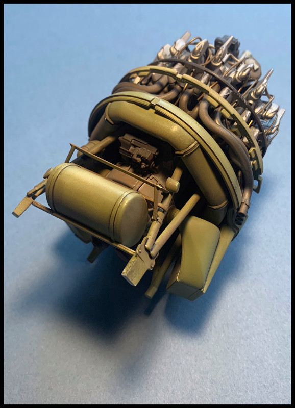

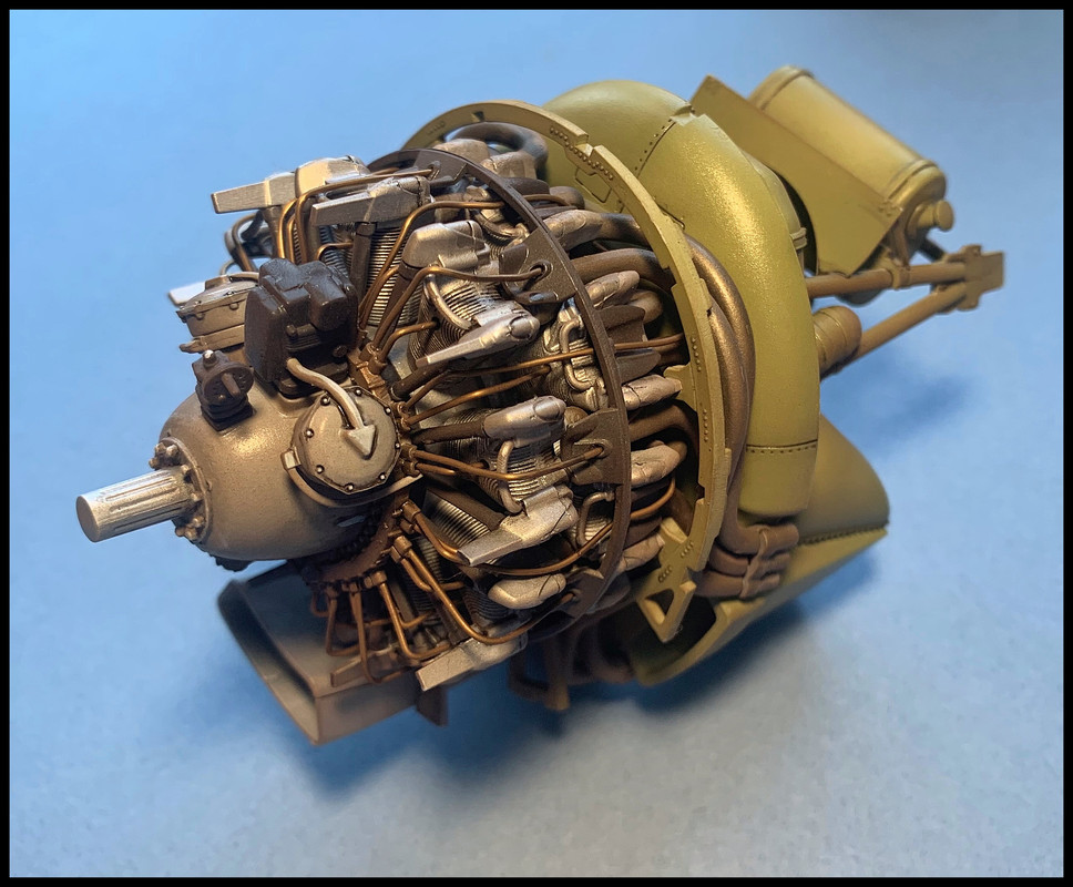

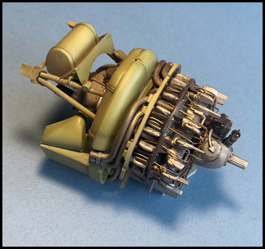

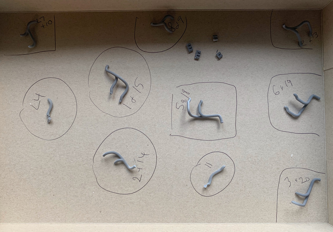

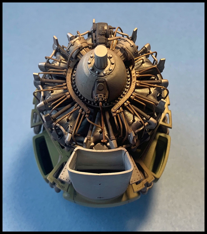

Gisbod Posted August 2, 2019 Author Posted August 2, 2019 (edited) So, I think I’ve just about finished the engine! I painted all the components separately, then pieced it all together - this ends up being a serious chunk of plastic! The fit is super tight, not in a bad way, in fact in all just clicks together. I hardly used any glue at all. It is, however, a complex structure and some thought and dry runs don’t go amiss. The wiring was easier than I imagined, as the pipe work is very well detailed in the instructions (and colour coded), even giving you the lengths you need to cut for each section. They advise the use of 0.7mm (22 SWG) copper wire. I used coloured Artistic Wire to this diameter and it worked just fine. The holes are all there ready to accept the wire. This is even an improvement on the Tamiya kit for the Corsair - same engine near enough, where it was a pain in the **** to fix the wires to the central section. But no such issues here! An over spray of a warm brown wash tied it all together. Hats off to Airfix for this section. Guy And a point for the multiple sections of pipe - it’s worth noting which are which during painting, as they all look very similar! I used my Gisbod Parts Separating Device (Patent applied for)... Edited August 2, 2019 by Gisbod nmayhew, daveculp, sandokan and 17 others 14 1 4 1
Bstarr3 Posted August 2, 2019 Posted August 2, 2019 Very nice work on the engine painting and wiring there Gisbod 1
Vynce804 Posted August 3, 2019 Posted August 3, 2019 Hi Guy, what a fantastic result, the engine looks stunning!. cheers Matt Gisbod 1

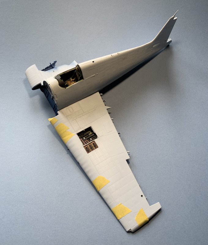

Gisbod Posted August 4, 2019 Author Posted August 4, 2019 Thank you I’ve finally got to that stage where I can get the major components together. This is a serious chunk of plastic! Fit is, again excellent. I had a couple of warped pieces (top wing) - but clamping sorted it out while fitting. I managed to break off one of the machine guns within minutes of fitting the top wing but that’s just par for the course.. This picture highlights the stressed skin very nicely. The leading edge of the wing in particular. The wheel wells are Dark Sea Blue and for this I’ve been using Mr Paint Blue FS15050 - just because it’s what I’ve got and it looks about right to me (maybe a tadge light?). Before I spray the whole airframe - any recommendations for a technically correct match for the Sea Blue? Tamiya, MRP, Mr Colour etc Are the FAA Hellcat’s that are dark blue, the same Sea Blue as the US versions? Thanks, Guy Uncarina, Gazzas, Victor K2 and 8 others 11
shark64 Posted August 4, 2019 Posted August 4, 2019 (edited) Did u do the stressed look on the wings or the kit comes that way? Edited August 4, 2019 by shark64 Gisbod 1
Out2gtcha Posted August 4, 2019 Posted August 4, 2019 Looking great Guy! I'm personally partial to MRPs DSB, but that is just me, as I like the look of the color and it sprays excellently. 11 minutes ago, shark64 said: Did u do the stressed look on the wings or the kit comes that way? Comes OOB that way. The actual end result of the stressed effect looks good to me, but just a bit too consistent, and evenly spread out IMHO. This is going to be one big birdy when done! Gisbod 1
Gisbod Posted August 4, 2019 Author Posted August 4, 2019 2 hours ago, Out2gtcha said: I'm personally partial to MRPs DSB, but that is just me, as I like the look of the color and it sprays excellently. Great, thanks Brian 2 hours ago, Out2gtcha said: The actual end result of the stressed effect looks good to me, but just a bit too consistent, and evenly spread out IMHO. Yep, I quite like it - you have to bear in mind that it’s exaggerated somewhat from the light above casting shadows.. it’s quite hard to see in a flat light. 2 hours ago, Out2gtcha said: This is going to be one big birdy when done! It’s a beast with just one wing on! Guy Out2gtcha 1
