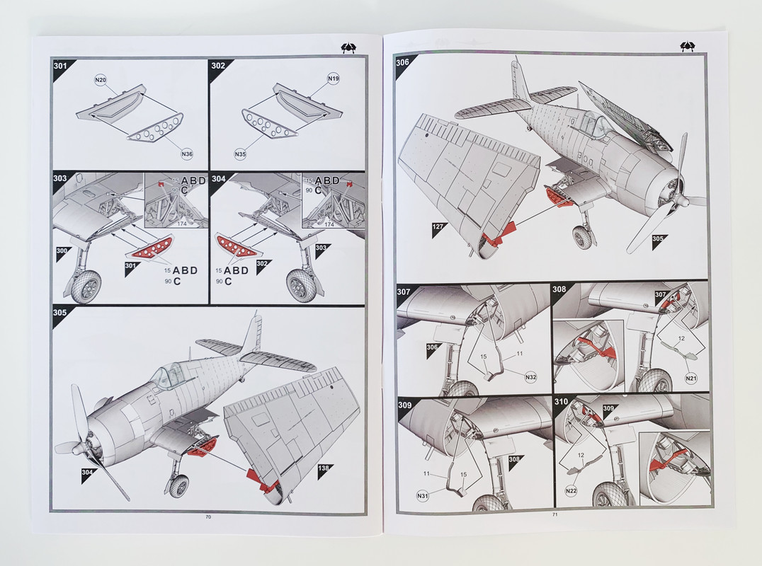

The instructions have 310 stages! 600 parts, so not a weekend kit...

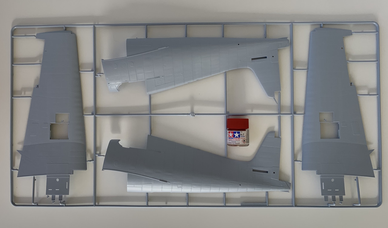

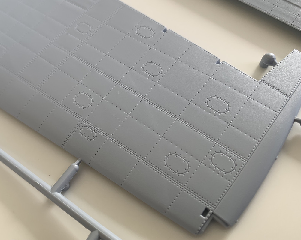

The stressed skin effect:
7969-A267-F8-E0-4-A24-9-FC6-1-A670-A62-E

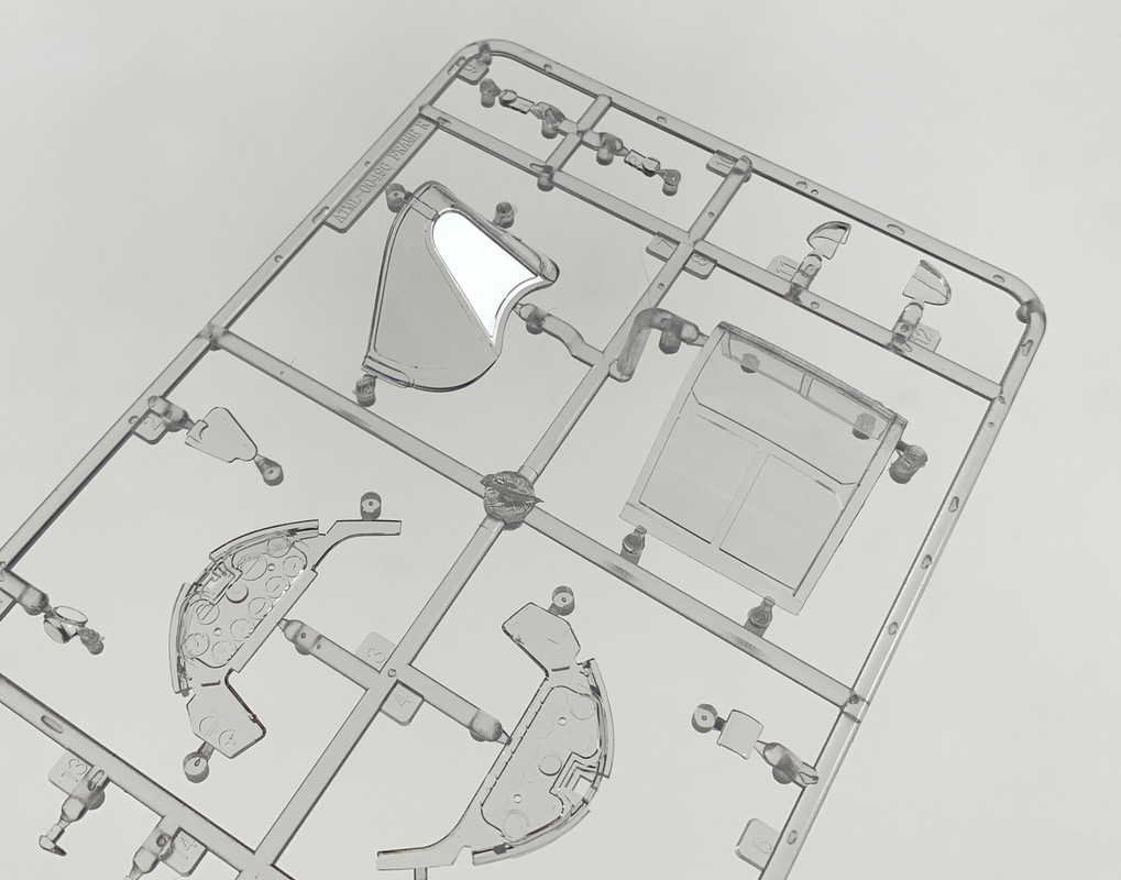

The clear sprue looks good:
3753479-F-9-D0-E-4-F90-8189-F4-DD115-C50

It certainly does look impressive! I agree with your assessment of the kit but you have some great after market to help in the areas that will need more work to look nice.
In the photo of the clear sprue, I seem to detect a bit of tint. Is this correct?
Great project!

Posted (edited)
Thanks Alain,
Yes, it does look tinted in the shot, but rest assured it’s not at all, just sunlight effect I think.
I’m sure it’s lovely, it just has a certain retro feel to it compared to the very latest offerings I’ve seen from other manufacturers. Nothing I could really put my finger on, but I’ve just started a Wingnuts DH.9a kit and that oozes quality.

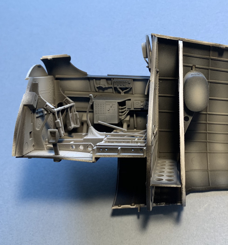

I’ve made a start this morning and it’s going together surprisingly quickly. I’m getting as much sticking together done on the interior as I can before paint.
As mentioned before, the plastic is fairly soft, the cockpit floor seems a teeny bit warped - but should squeeze into shape ok. I’ve done a test fit of the fuselage halves and it goes together - with the internals fitted - with some pressure. I’ll have to keep an eye on that as I progress. Not quite a snap build.
That said, it’s a fun build already - it’s a lovely scale to work with ie it’s not too fiddly.

ECF4-DF8-E-1884-417-E-9-DCB-AC932738-C73

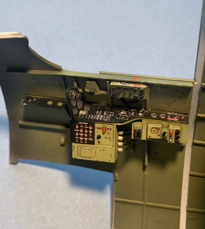

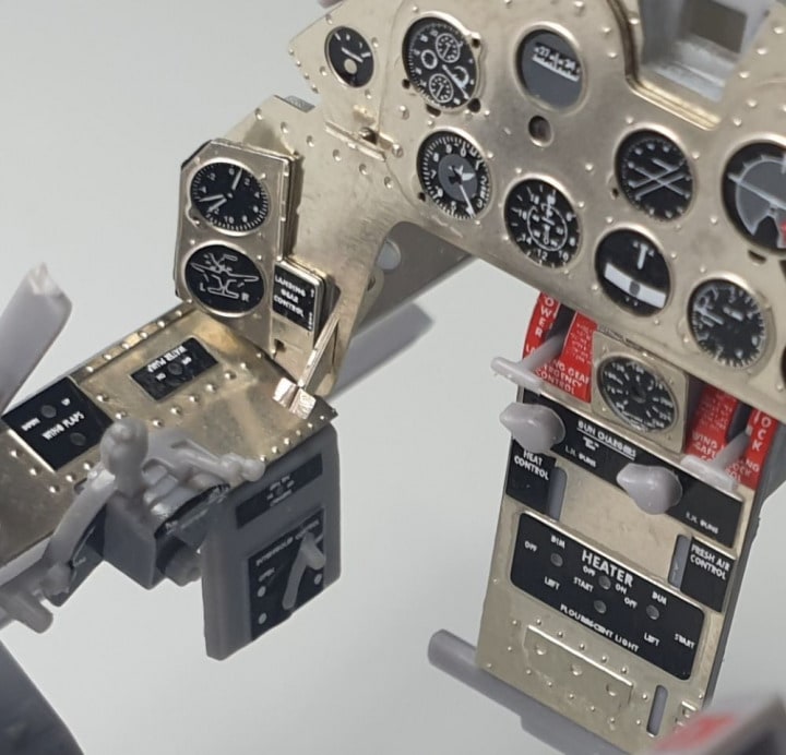

The first part of the Airscale set fitted (kit detail sanded off)

Thanks for looking,
Guy

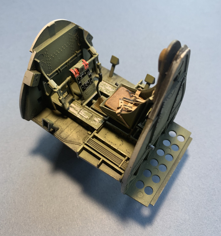

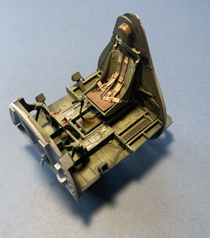

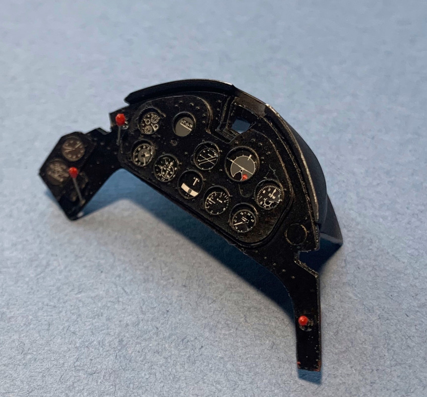

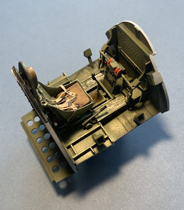

Evening all,
I think I’m calling the cockpit done. Not my best effort, but looks ok. I’m not really adding a great deal in terms of detailing, I haven’t quite got the enthusiasm somehow. The Airscale set is great as are the ‘wrong’ seat belts. They really lift it a notch. I’m looking forward to seeing what the master builders do with this kit though - it has great potential.
Note the masked areas on the mating surfaces.
Thanks
Guy
