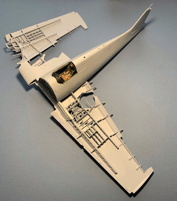

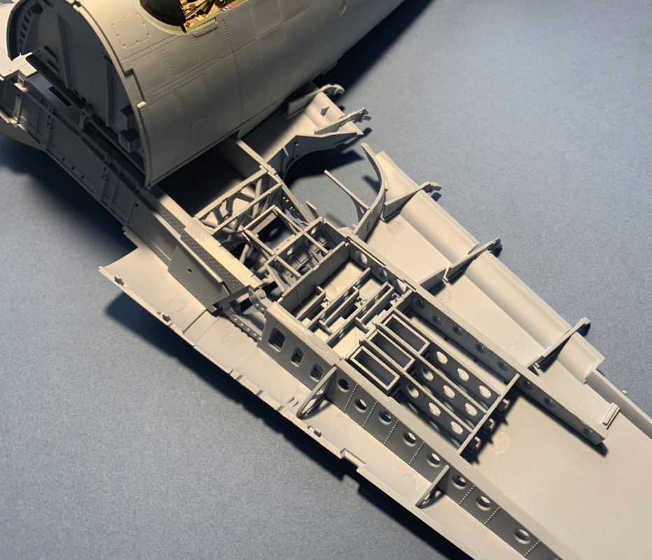

Gisbod Posted July 19, 2019 Author Posted July 19, 2019 (edited) Hi All, Thanks for the great input. I think my idea of a 3 tone is dwindling, but the midnight blue will be a challenge which could be interesting , and still the option of the FAA scheme. Back from Holidays, but away this weekend then straight back into a 5 day work trip, so this won’t be an overly quick build. I have, however, completed most of the internal structure of the wings, most won’t be visible and credit to Airfix for the level of detail here. It is though, fairly complex, compounded by having one wing folded - it’s a bit of a nightmare flicking back and forth through endless instructions to accommodate this, it was for me at least! Everything has fitted very well, although a few parts have come slightly warped, so a bit of gluing & clamping required in places... Guy Nice view of the stressed skin effect: Edited July 19, 2019 by Gisbod AlbertD, Gazzas, sandokan and 7 others 9 1

Alain Gadbois Posted July 20, 2019 Posted July 20, 2019 Hi Guy! Very nice progress on this impressive kit! The lighting shows the stressed skin very well and it appears very realistic. Alain Gisbod 1

Thunderbolt Posted August 1, 2019 Posted August 1, 2019 (edited) On 7/7/2019 at 7:07 AM, Madmax said: Looking good Guy! I think the debate over stressed-skin is going to become a matter of taste. Depending on light source, period photo's do seem to support Airfix's approach... Sean the skin was definitely stressed out of the factory. it's just that Airfix has overdone the effect by making it too uniform and ubiquitous. it's a great first step on their part and the kit seems excellent overall Edited August 1, 2019 by thunderbolt1988 Gisbod, Out2gtcha, sandokan and 1 other 4
