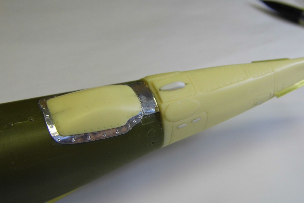

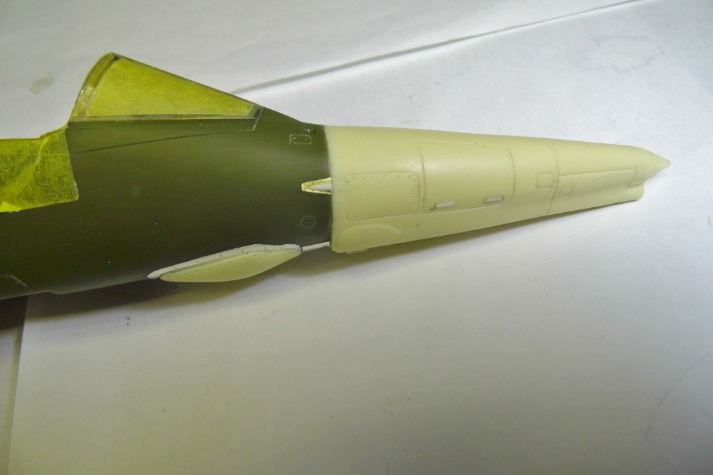

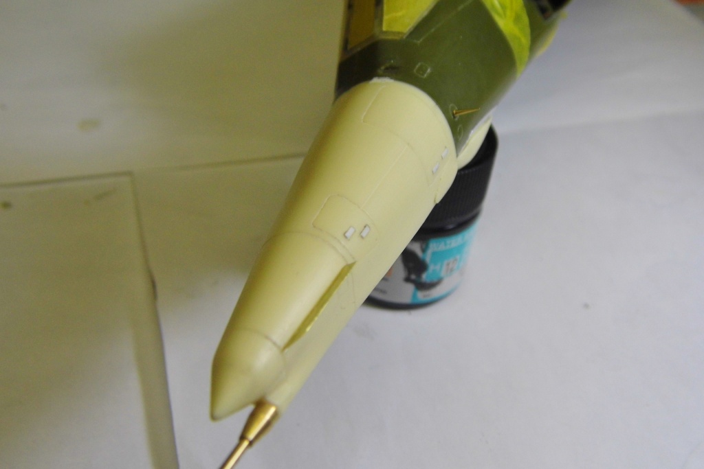

alain11 Posted December 4, 2015 Author Posted December 4, 2015 now , let's go to the other tip , the nose cone .. I think , it's the most tricky , random , risky part of the build .once the sprue cut off , as well the fuselage tip , we have to find the right place . not pointed upward , or downward , not turning to the right , or to the left ,anyway ! in all directions . after several tries , I think i managed to give the good profile to the " lion" the antenna , and some stuffs are glued this closed the fuselage construction . I hope I have been clear in my explanations .thank you for your interest Alain mywifehatesmodels, tucohoward, Zero77 and 7 others 10

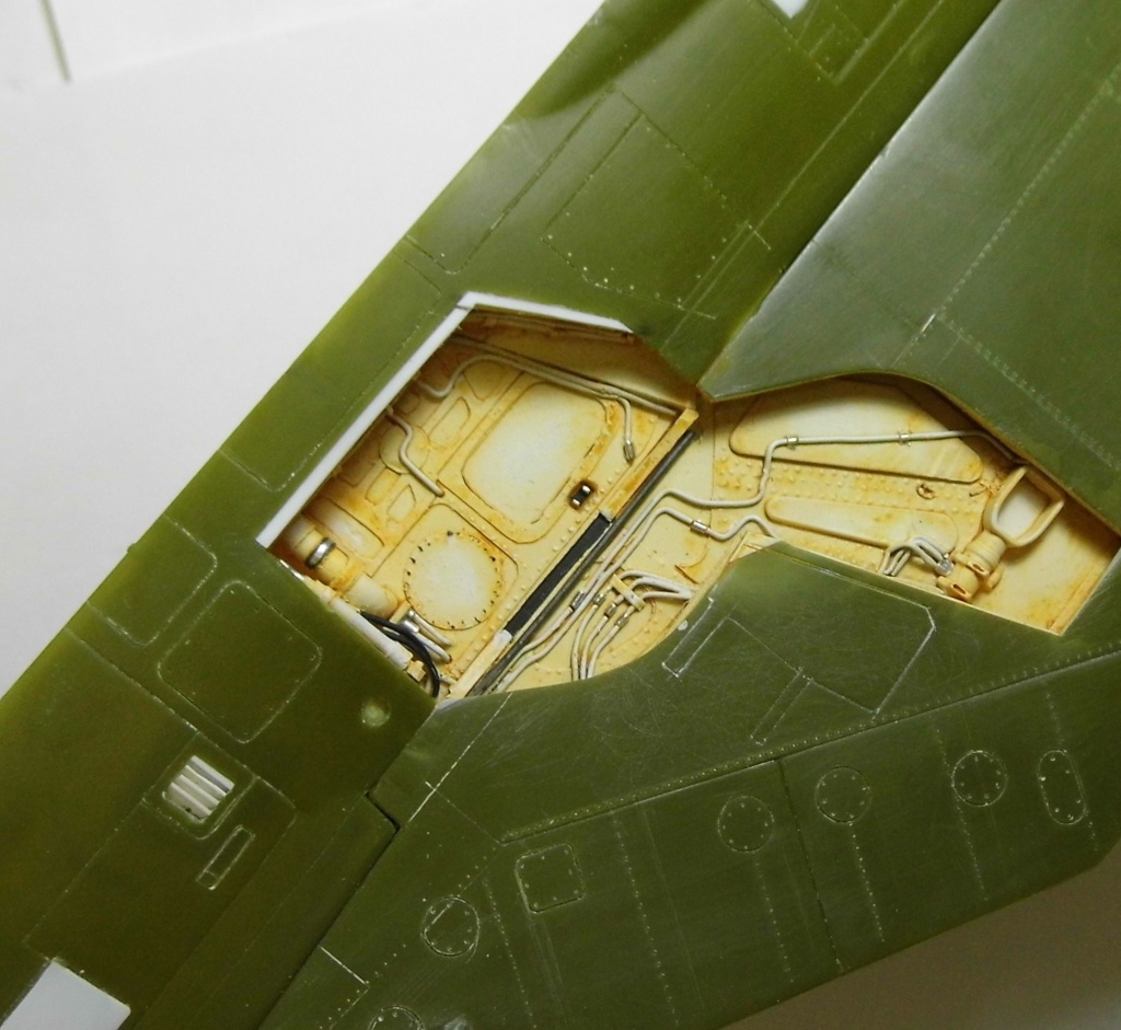

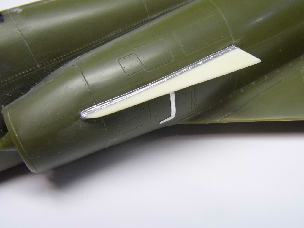

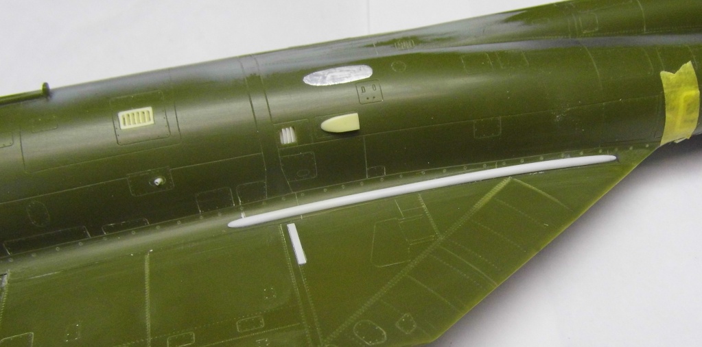

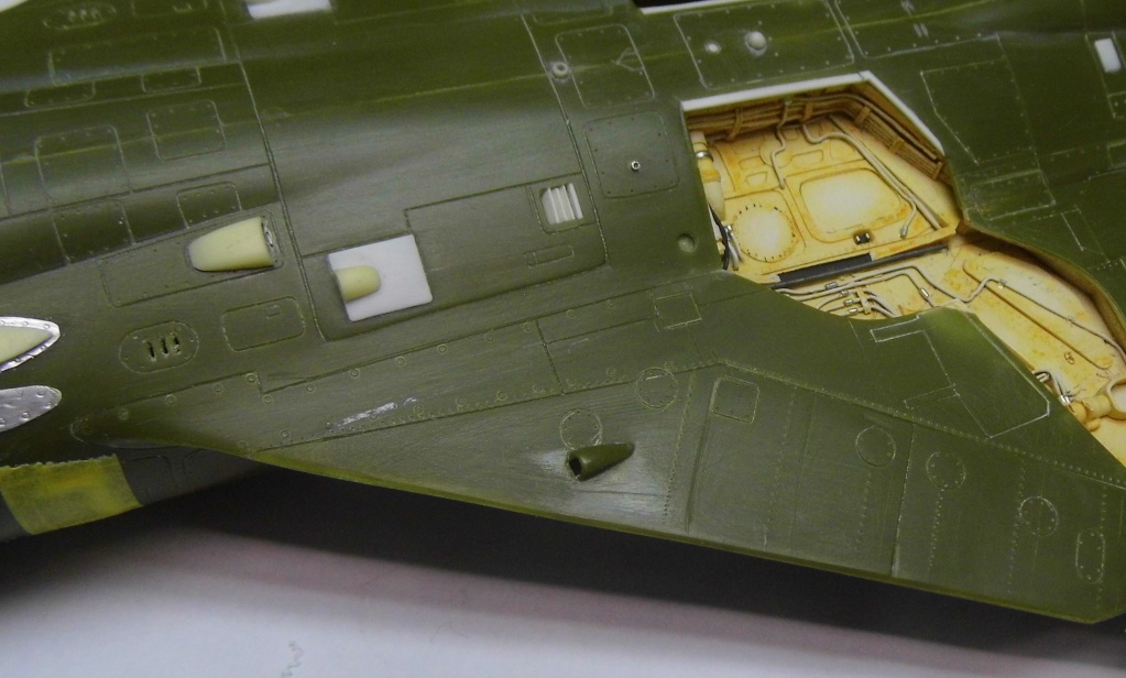

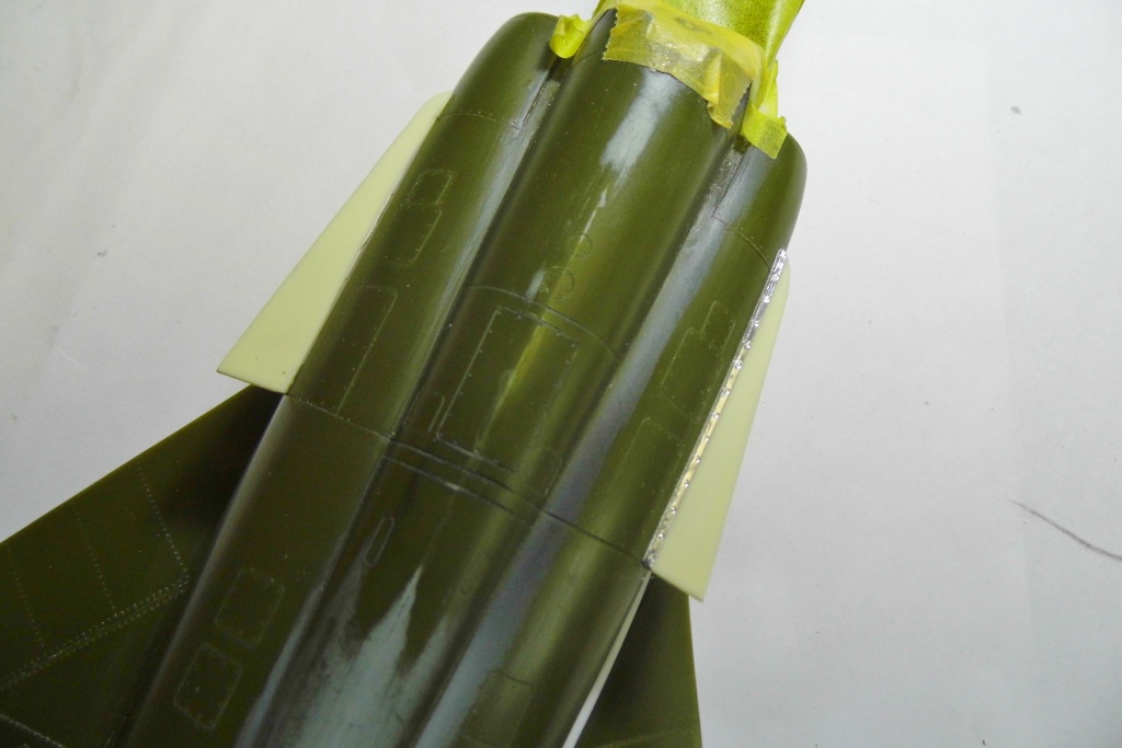

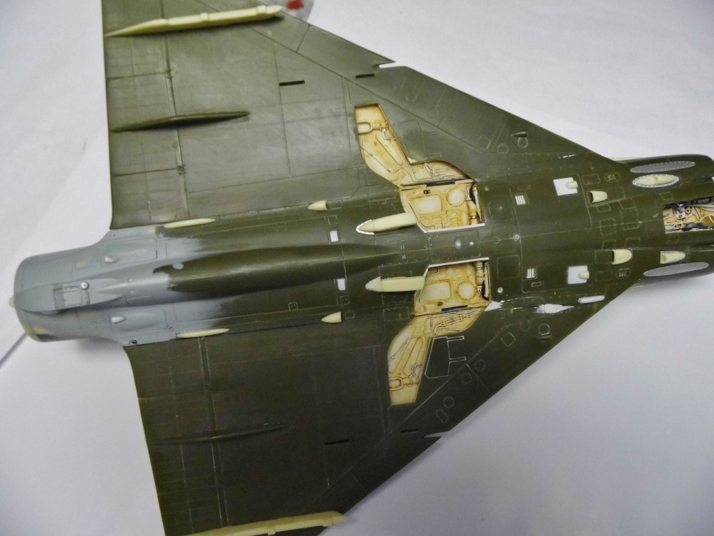

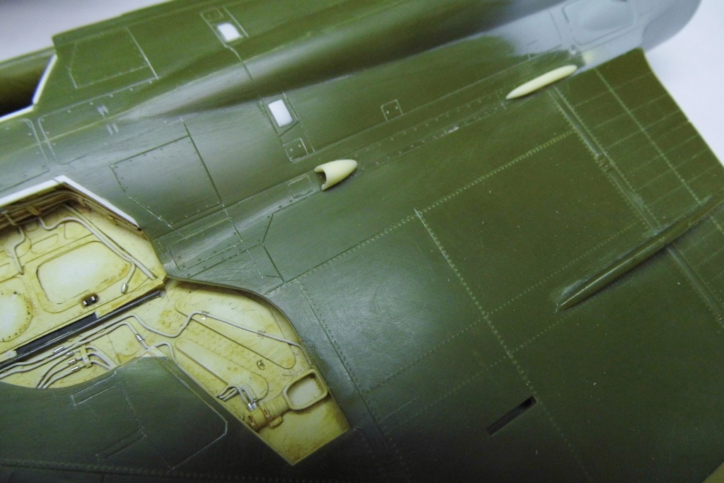

alain11 Posted December 7, 2015 Author Posted December 7, 2015 Hi I often say and repeat ; things are easier with an urge .... thank you for your interest , and kind words Today , I have to glue the wings to the fuselage . here is how the right wing fit to the fuselage .. not too bad , considering the Revell kit age ( I remember , I had much worse fits one my first Mirage build) .....It would seem that the new Italieri Mirage kit doesn't have better fits on some areas here is the result after a while .. front , and rear ... I had more issues with the left wing , a bit of putty was needed . new panels are engraved ....again Isracast provide a semi cylindrical rod for the long fairing along the wing / fuselage root , I had to only shaped the tips ... and glue now , the "canard" I don't know why it's called " canard" ( weird) any clues ??? their position on the intakes are not obvious , here again the instruction sheet doesn't help .... I just added the reinforcement plates at the root with self adhesive aluminium Okay , now , the big air inlets are glued in place on the back , and lower fuselage .... no doubt , the Kfir is not a stealth fighter and at last for ending this step , I added what looks like drains on the rear end to be continued Alain Zero77, mywifehatesmodels, Whitey and 5 others 8

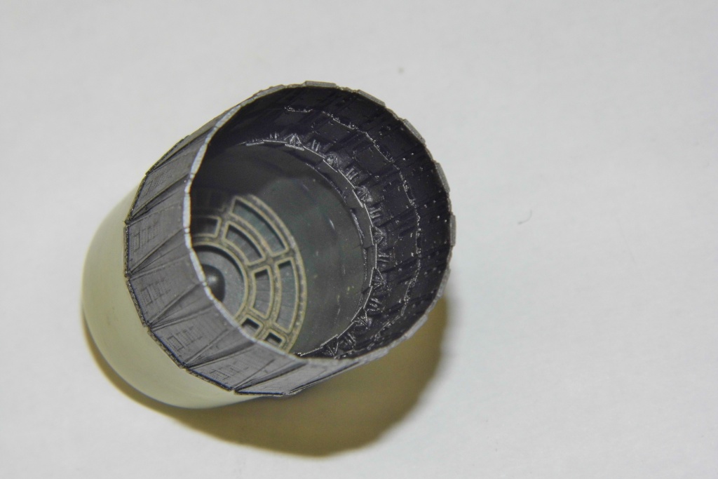

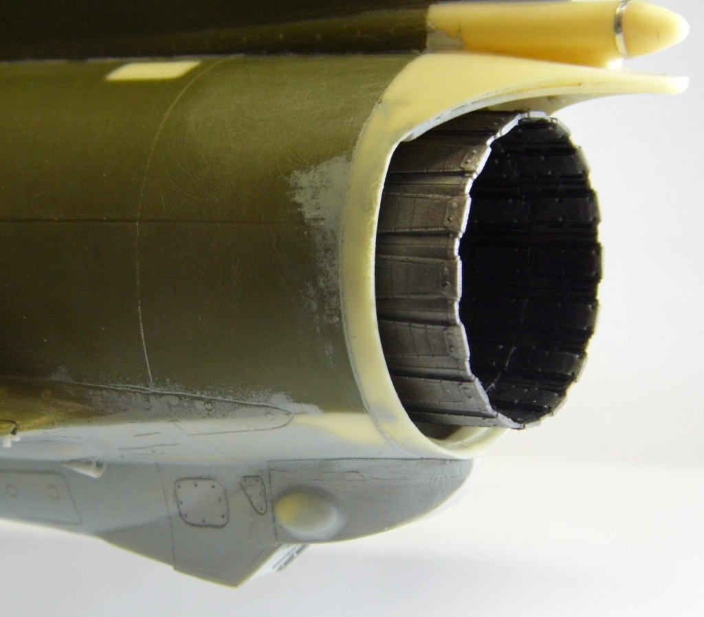

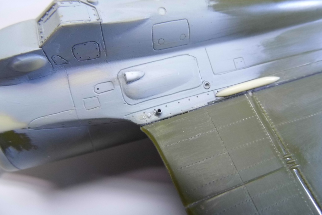

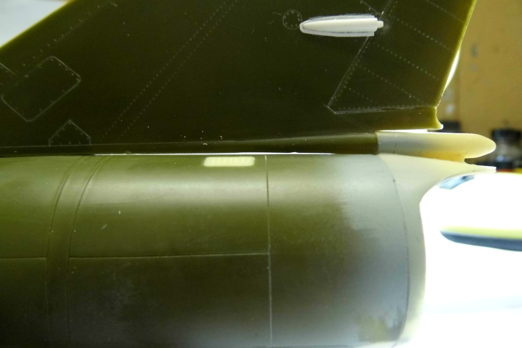

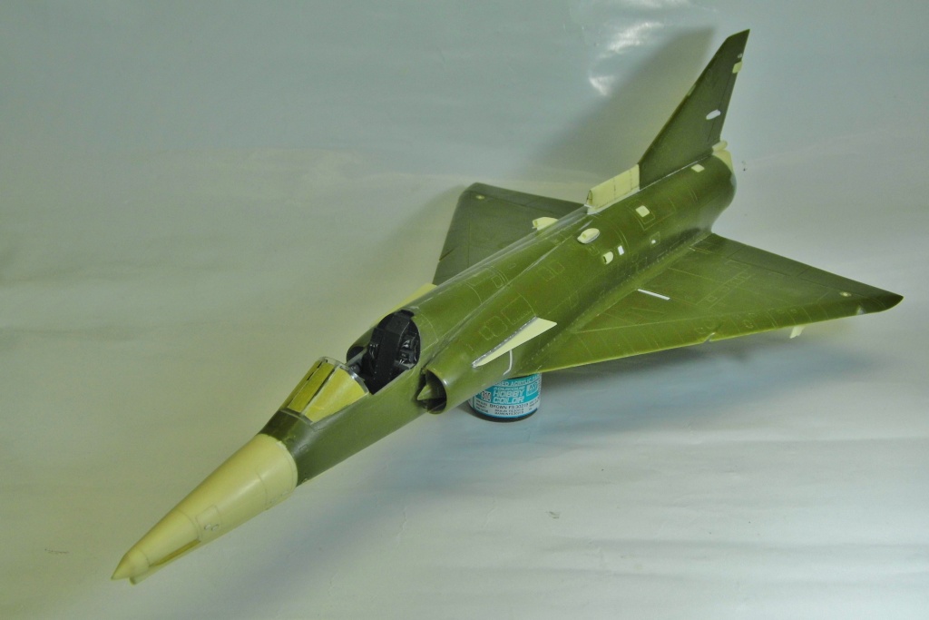

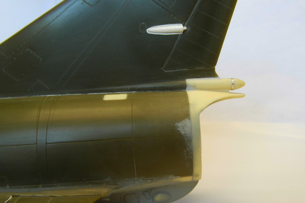

alain11 Posted December 11, 2015 Author Posted December 11, 2015 hi thank you for comments ... today ,just a little step forward ... let's care to the vertical fin . despite trimming , some gaps still remain at the base , and under the rudder ....no problemo , Tamiya putty is my friend fixed!!!!!! and now ladies and gentlemen , here is what looks like from far or close to the Kfir alias F 21A ....from now , the fuselage work is over , I have to care now to all the peripheral components .....gear legs , seat , etc..... as i am at this rear tip , let's see how the jet exhaust looks like ??.the resin part from Isracast is not so bad , but in my opinion lack of sharp details , I think we can find something better . Aires exhaust set for the F4 Phantom ( if I remember , the Kfir was powered by the same engine as the F4 ) is a nice option , .....I only keep the exhaust . the"pipe" provided by Aires is too long to fit into the kit .... the kit fuselage is empty !!! so why it doesn't fit ??? Isracast have moulded into the rear end fuselage resin part , what looks like a shim on which their exhaust set must be glued , and their exhaust set is rather short compared to the Aires set ....too bad , once painted , it works as well .... A picture from the instruction sheet is better than words ......If I haven't been clear on the left side , the Aires part ......no need to say more !!!!!!!! once painted ................ dry fit into the fuselage ........ that's all for now , to be continued ......thank you for watching Alain Lars Befring, Zero77, tucohoward and 3 others 6
