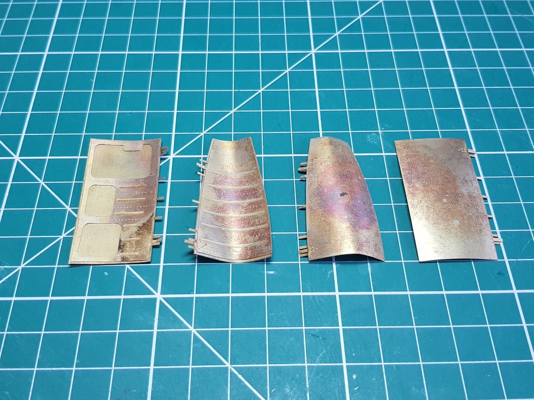

Pastor John Posted December 27, 2021 Author Posted December 27, 2021 (edited) Well good news and bad news - good news - I managed to saw off cleanly enough a section of the rear which allowed with only gentle flexing the PE floors to slot in. Bad news - I was so focused on making the door skins as real as possible with 2x layers of 0.2mm brass followed by a half etch layer to show the raised rivets for the inner skin with a half etch outer skin to allow the rivets around the edge and cut outs - looks fantastic but for one simple problem - it is impossible to accurately mould to shape. The doors might not look too bad when open but they can never be conformed to the gear bay shape. Have to re-think the product when my hands can use the design program again. Edited December 27, 2021 by Pastor John monthebiff, Greg W, kkarlsen and 7 others 10
monthebiff Posted December 27, 2021 Posted December 27, 2021 Great progress Jhn, your gear Bay set looks superb and a step up from the Profimodeller set. Have you tried annealing the brass prior to starting to form them to the correct shape. O did this with the Profi set which is thicker brass and worked well. Regards. Andy Pastor John 1
monthebiff Posted December 27, 2021 Posted December 27, 2021 This is what I managed, took a little time but was pretty happy with the results Never used them but managed to get the shape after heat treating the brass. Regards. Andy Landrotten Highlander, scvrobeson, chukw and 1 other 4
