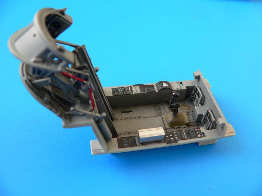

Crazy good stuff here! You’re really doing this kit justice.
are you going to tape the inside of the canopies or brush paint the components on the inside rails? I gotta say I’ve been wondering how you were going to do that with everything glued in place :lol:
Posted (edited)
Thanks for the question.
In the last photos, all this is assembled without glue.
Therefore, everything will be unassembled and painting by airbrush.
The inner and outer transparent surfaces of the canopy will be covered with masks.
Edited by Seversky
Posted
Stellar modeling!  Really, really nice.
Question:  On the E version of this kit the right cockpit console is backwards, so it needs to be flipped.  Is this F version OK?  I just thought I'd ask, just in case it was wrong and it's still fairly easy to fix before paint.
Cheers,
Chuck
Posted
Cheers,
Chuck
Thanks Chuck!
In the kit of version F with consoles everything is fine, I checked. Apparently they fixed the error.
The only thing, they forgot to make the boxes for the maps
on the right consoles. I made them, it's not difficult.
