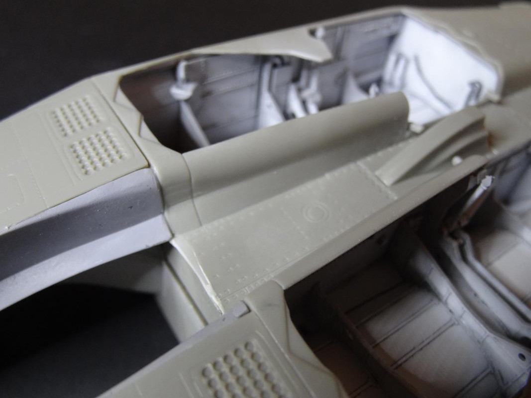

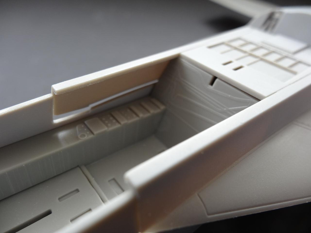

hpetiers Posted April 13, 2019 Author Posted April 13, 2019 hi Mark M, yes this is no Tamiya but having started the Heller/Airfix E-3 Sentry in 1:72 until I started this one, I must say that this is an easier build, I am enjoying this one really. Once you overcome the stupidity of the inner parts 1 mm higher than its outer skin, then it something that can be solved. Thanks Markjames for the encouragement, I have to agree that once completed, the gear bay is the most elaborate of any kit I ever built. having put also the sides onto the structure, I wish I had sanded the sides of the front and rear faces of the wheel bays a bit more to ease the mounting of these plates, but in the end it has come together: around the wheel bay there is now just a small gap to deal with: also the bottom plate between the intakes now almost fits without a step, I think just a little more sanding of the surfaces of the intakes will solve this. Gazzas, D.B. Andrus, Greg W and 9 others 12

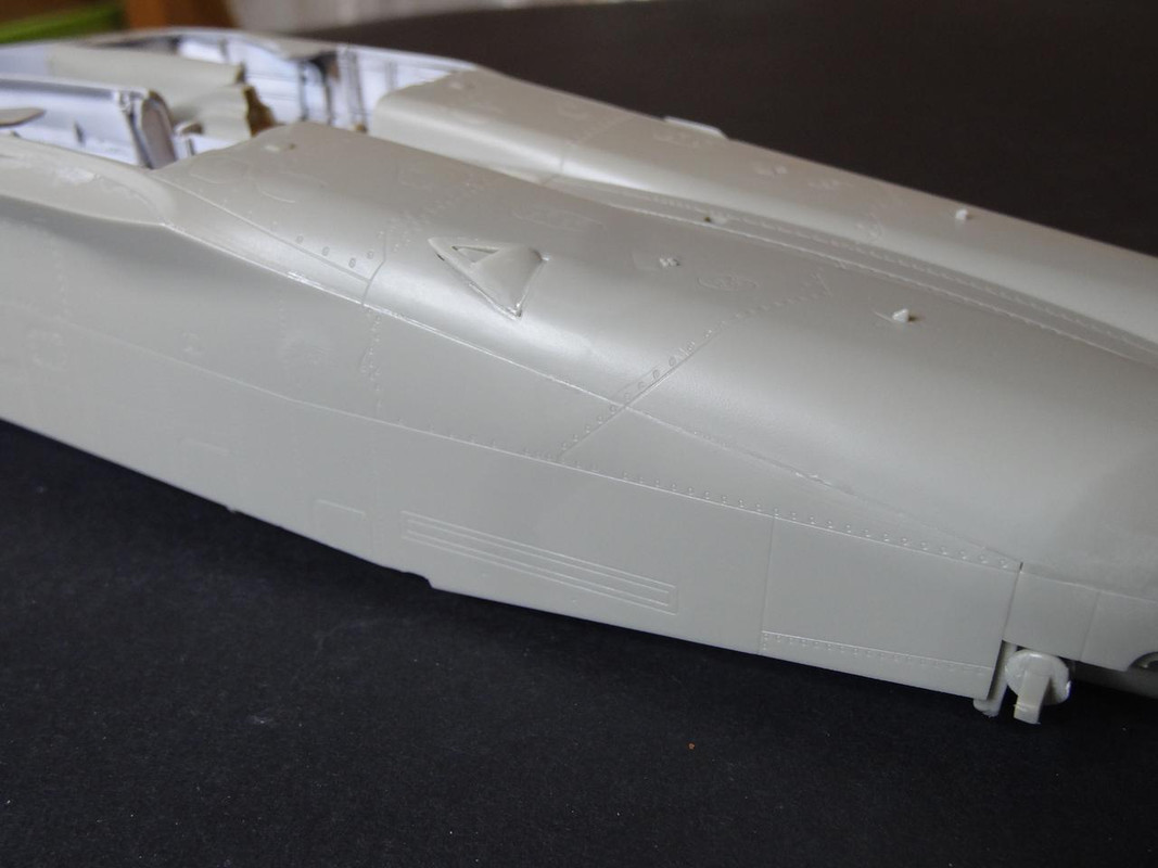

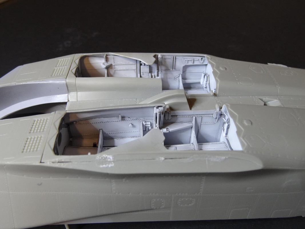

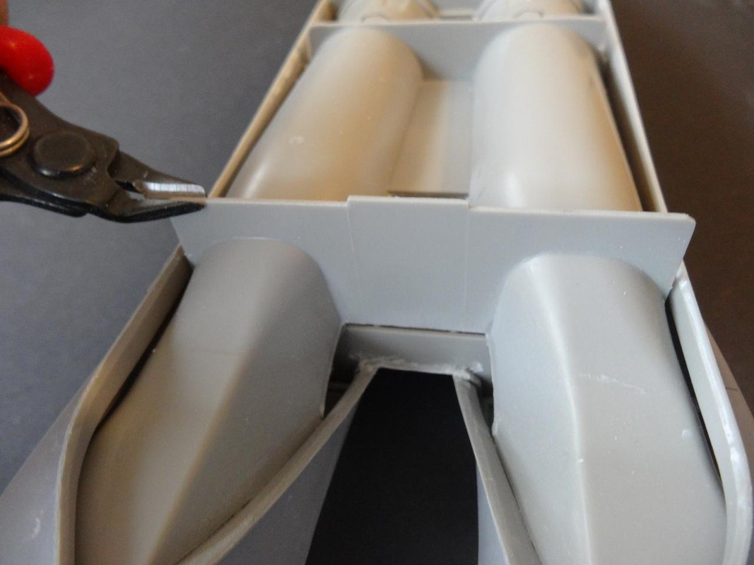

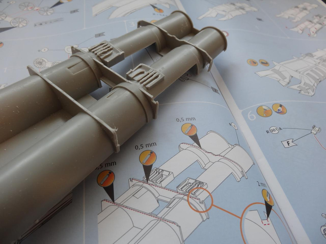

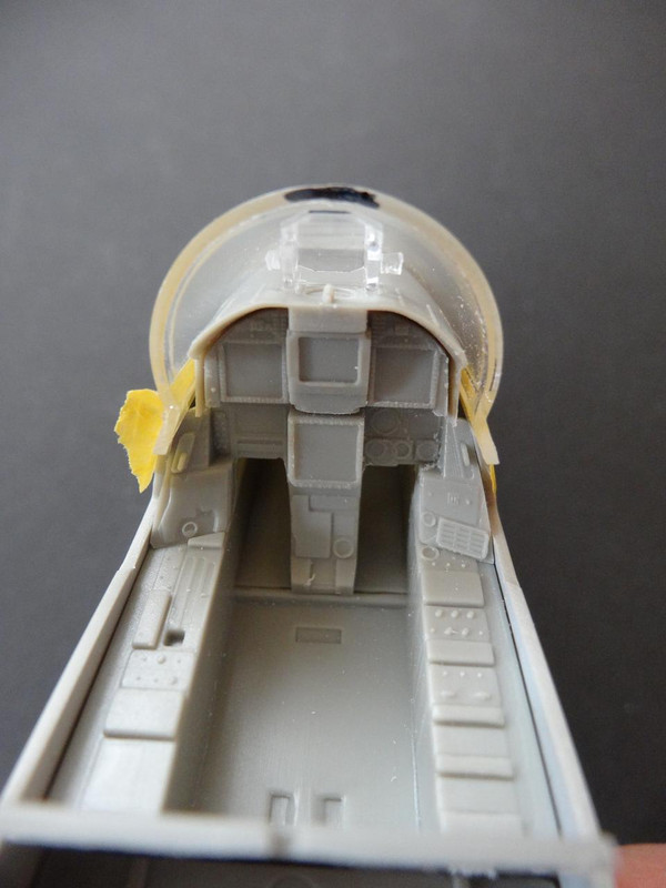

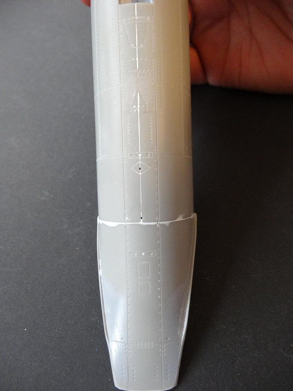

hpetiers Posted April 17, 2019 Author Posted April 17, 2019 (edited) Gentlemen, what grumpiness on this forum! Believe it or not I am having quite a lot of fun with this kit. Is it a stupid mistake to enigneer the insides 1 mm higher than the outer shell? of course! but if you take that for granted the parts are not that bad (yet) and the surface detail is quite good. And I have come to the conclusion that the height mistake is consistent over the whole length: So like Mark already posted, also the cockpit needs work: The canopy will conflict with the HUD, it is easiest to win this mm in the instrument panel. here the panel before: by splitting up panel in between the screens and putting it back together again, most of the issue is solved. HUD and canopy frame made black to show: also behind the ejection set you end up with a 1 mm gap on the outside. By reducing the rear wall this is easily solved: oh yes, and do not forget to reduce the same mm of the ECS exhausts. This is not depicted in the manual: call me what you want, but I also reduced the foremost bulkhead, while not depicted in the manual: I scraped a bit of plastic from between the intakes to fit the front hull, which I glued to the front halves: some small clean up of seams.. and then everything fits quite well. Later I discovered that the centerline fueltank will completely make this seam obscure, I would have been easier off. also smoothened the intakes with Miliput. this is the seam on the inside of the intakes, it takes a bit of work but it is doable. I am glad by the way that I mounted and smoothened the intake plates before the intake tunnel was complete! still need some sanding paper to smoothen the inside corners: Edited May 21, 2019 by hpetiers LSP_Kevin, rafju, HerculesPA_2 and 9 others 11 1

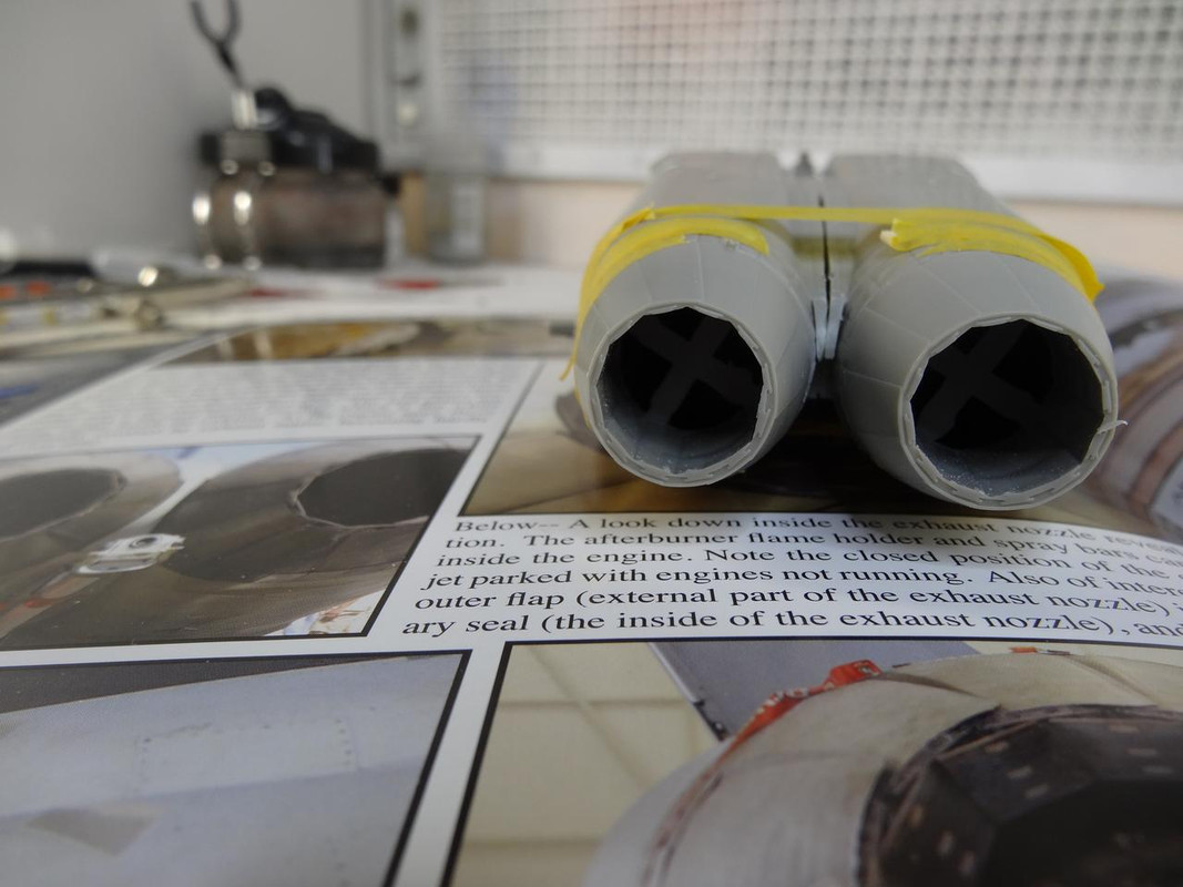

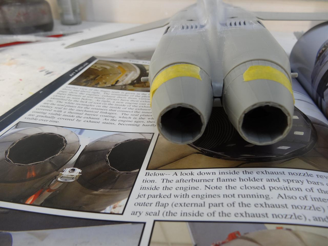

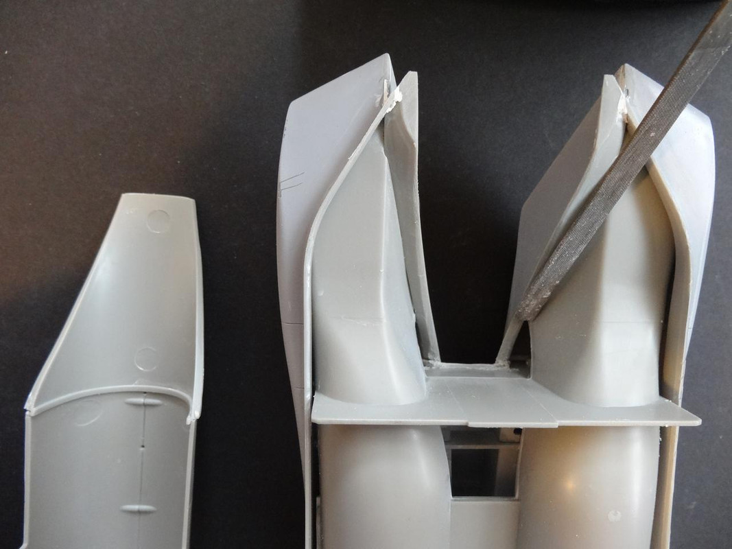

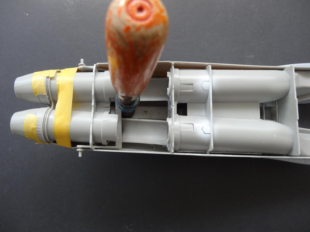

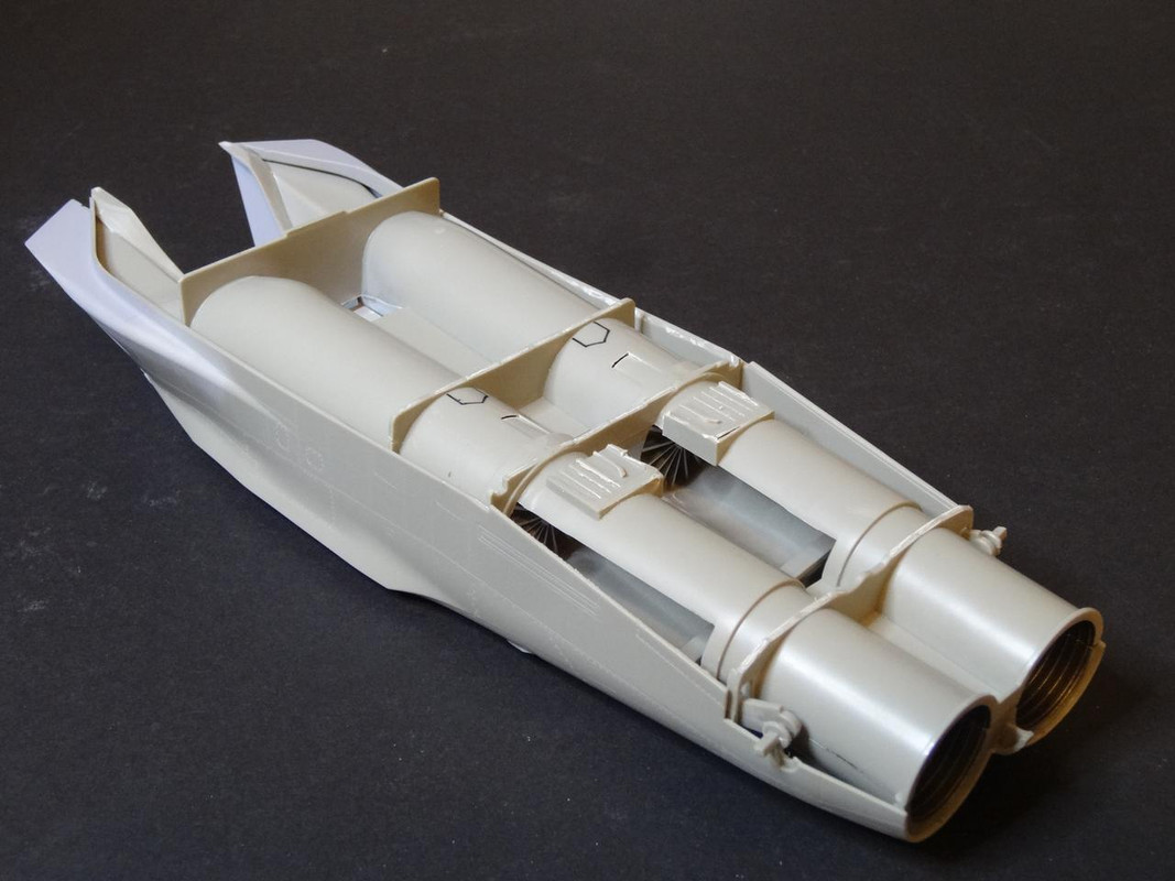

hpetiers Posted April 18, 2019 Author Posted April 18, 2019 (edited) hi Starfighter, I can relate to your feelings, this is why I had a good look at the rear end of my project tonight. and hopefully with the permission of mr. Melampy´s awesome book about the super hornet, I can show you what it is about the distance between the engines: so Mark, call it mad, call it overconfidence, but I´m sure that in your business they have a scientific word for it...I decided to put the engines closer together. So our came the iron saw and I started to... this gave me 2 mm in width reduction between the exhausts. Some part of the engines had to go in order to be able to clean up the newly made cuts: then the whole was glued together again after tidying up of the seems. to align the bottom plate parts I clamped a piece of styrene strip on the inside: I think I got away clean with it! just some gaps to fill now. though it is just a few mm's, the difference is easy to see And yes, still enjoying this kit! Edited April 19, 2019 by hpetiers dmthamade, johncrow, HerculesPA_2 and 12 others 15
