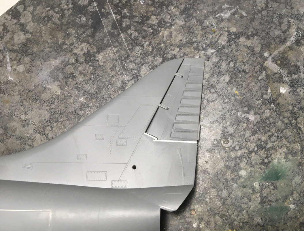

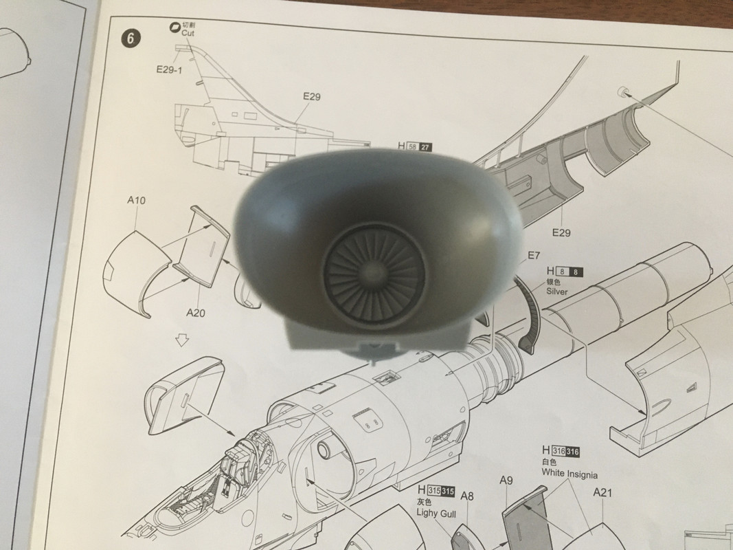

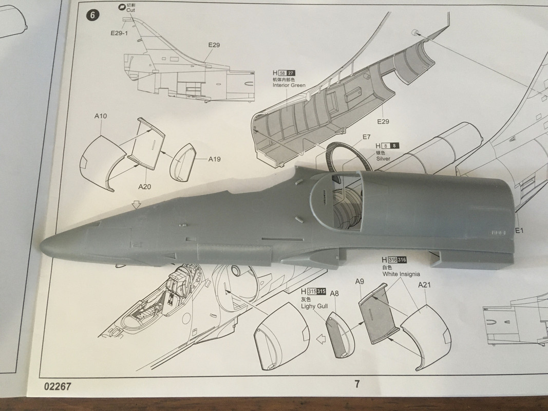

Cheetah11 Posted November 16, 2023 Author Share Posted November 16, 2023 While waiting for paint to dry on the Tomcat I started gluing the main parts together on the Skyhawk. The kit has much the same building "problem" as the KH Mirage 200o in that all panels are designed to be build open. This is great if you want to display an aircraft being serviced but not on the ramp ready to fly. The panels needed quite some adjustment to fit in the closed position. I was impressed by the fit until this popped up. I know there is a gap below the rudder but this is a bit extreme. Plastic strips to the rescue. The Colt 20mm guns will have to do as Defa 30 mm guns but I removed the stagger as the Defa guns were not staggered. Once the lower panels are in place very little will be seen thru the wheel bay so this should do. More trouble. Undersized and incorrect fan details. If you can get the Barracuda replacement. I printed a new inlet for the J52 engine with inlet guide vanes. A bit rough but after clean up and paint and it should look better than the kit parts. In the mean time I have written to Santa for a resin 3D printer but I am not too hopeful that he will get the message. Cheers Nick. SwissFighters, LSP_Kevin, dutik and 14 others 17 Link to comment Share on other sites More sharing options...

Stevepd Posted November 20, 2023 Share Posted November 20, 2023 Can you put a bit of angle on the rudder, or is it self centering at rest?. Cheetah11 1 Link to comment Share on other sites More sharing options...

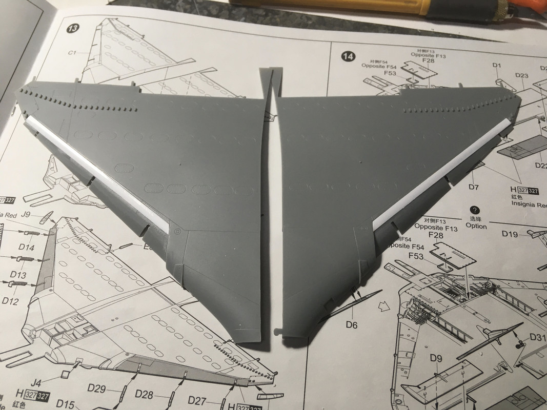

Cheetah11 Posted November 29, 2023 Author Share Posted November 29, 2023 On 11/20/2023 at 8:26 AM, Stevepd said: Can you put a bit of angle on the rudder, or is it self centering at rest?. Hi Steve all the photos I had a look at the rudder is centred, so I will try and fix it. A bit of filling and sanding should fix it. In the mean time I added plastic card to the slat cut outs. I will shape them when the glue has dried. Cheers Nick. LSP_Kevin, mozart, themongoose and 13 others 16 Link to comment Share on other sites More sharing options...

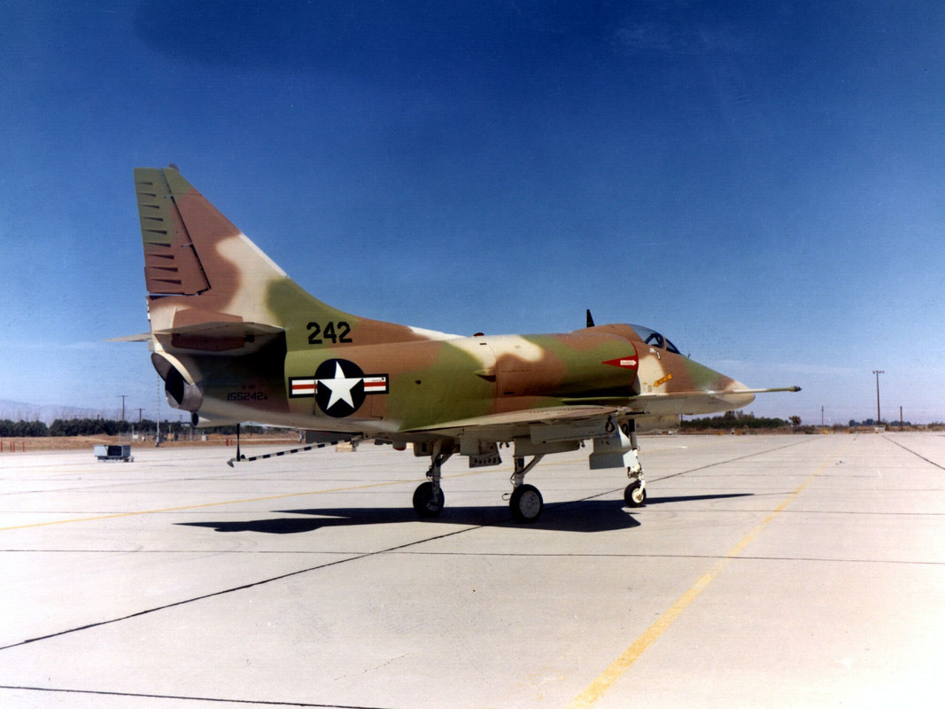

Cheetah11 Posted December 7, 2023 Author Share Posted December 7, 2023 3 hours ago, alain11 said: Hi Nick I see, you don't let your mojo cooling down , it's a ...cool project !! I don't know the IAF A 4 , especially the H version , but , if my memory isn't playing me a trick , this version had a special "rump "..............and then???? happy modeling Alain Hi Alain The A-4H was a simplified version developed for Israel with many US Navy sensitive equipment not installed. Externally it can be recognized by a squared off fin and a brake parachute as well as no avionics hump on the back. From 1970 DEFA 30mm cannon were fitted replacing the 20mm Colt weapons. Here is a photo of one prior to delivery. 8 hours ago, mozart said: Two builds in the GB Nick….ambitious! Hope the Skyhawk goes well. Hi Max On these two builds I will focus on colour and markings and not on too much detail. If all goes well maybe a third Cheers Nick mozart, BiggTim and MikeMaben 3 Link to comment Share on other sites More sharing options...

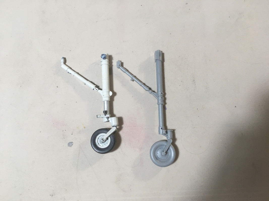

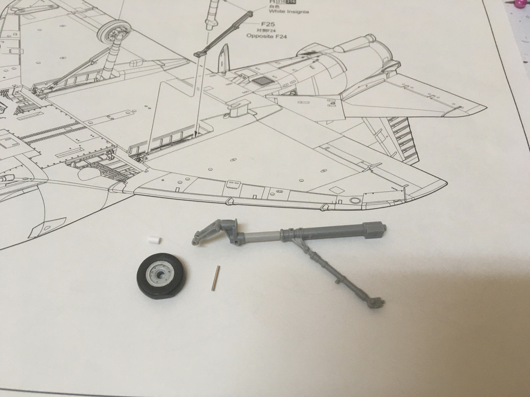

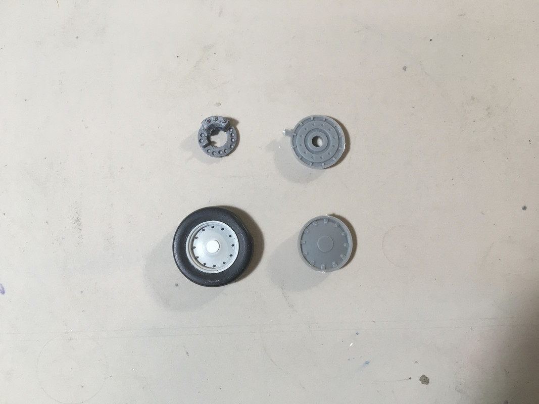

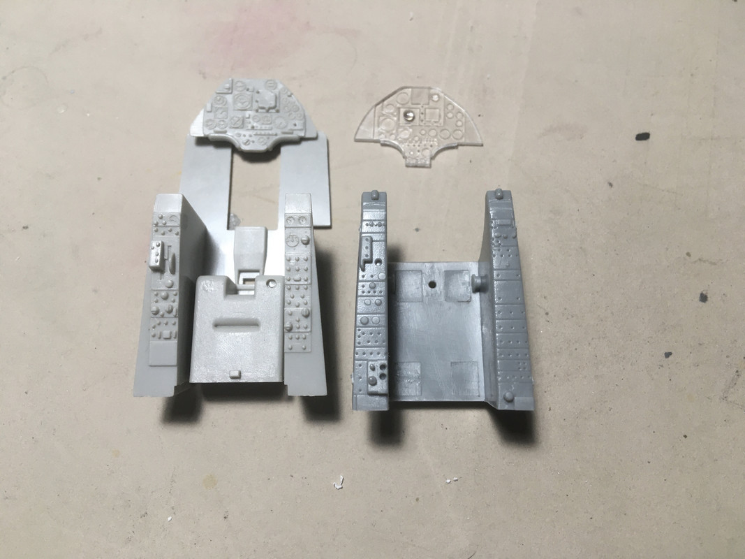

Cheetah11 Posted December 10, 2023 Author Share Posted December 10, 2023 (edited) I wanted to do this out of the box but there are a few things that are open for improvement. I fortunately have spares from two Hasegawa kits which were binned. I build one as a Kahu in 1999 but an accident involving the falling of a shelf in the display cabinet wrecked it. The second I had an over ambitious plan to do a A-4M from the two seater in 2002. I could never find or make a satisfactory canopy. The first thing to fix was the solid nose wheel. One almost gets the idea this kit was badly copied from the 1/48 Hasegawa kit. After a bit of work using the Hasegawa wheel and shortening the oleo a little. I also had a look at the cockpit. The side consoles and IP are flat. Here is a comparison with the Hasegawa kit. 2011 kit versus 1976 kit. Really Trumpeter. The solution was to fit the side consoles of the Hasegawa kit to the Trumpeter cockpit. Slots in the fuselage sides needed to be enlarged. Thanks to Proxxon a quick job. Last thing while the paint is drying on the Tomcat is to paste Hasegawa wheels onto the Trumpeter U/C legs. The Trumpeter legs are 3mm longer but the wheel well is 3 mm deeper so not a great problem. I like the Has wheels more and the brakes are more detailed. The Trumpeter kit has a lot going for it but just a frustration on some of the details are compromised. Cheers Nick Edited December 10, 2023 by Cheetah11 Out2gtcha, BiggTim, mozart and 10 others 13 Link to comment Share on other sites More sharing options...
mozart Posted December 10, 2023 Share Posted December 10, 2023 What an incredible difference in those nose wheels Nick! Your new one is light years ahead, the original is truly shockingly bad! Link to comment Share on other sites More sharing options...
Cheetah11 Posted December 11, 2023 Author Share Posted December 11, 2023 Thanks Max. The trumpeter kit has some nice features compared to the Hasegawa kit but one gets the idea the ball was dropped five yards from the try line. Cheers Nick mozart 1 Link to comment Share on other sites More sharing options...
