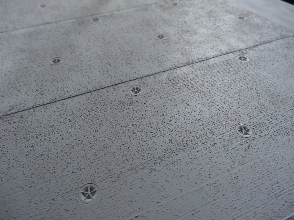

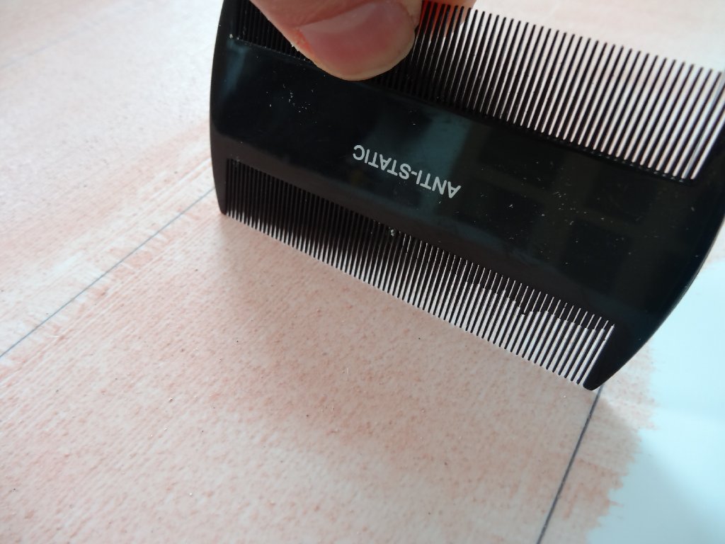

hpetiers Posted February 29, 2020 Author Posted February 29, 2020 (edited) Hi Chrish, neither can I! I am indeed postponing this build quite a lot my my plan for a piece of carrier deck. But nevertheless making good progress: Put the lines on the deck and pre drilled the tie-down holes. tie downs have been printed by Shapeways in the mean time. The weld seams between deck plates were made with Vallejo putty: Then I used a yoghurt-like primer to glue tiles onto tiles. I had that stuff as left over some years ago, already then I saw how there is very fine sand particles in there and how its structure would make a good anti-slip coating. By combing it with a very fine comb I made the orientation as you see on carriers: structure is accross over the seems, and length wise on the rest of the plates. after a successful test I put the stuff on the piece of deck, half an hour later this was the result: anti-slip coating on the deck! Edited March 14, 2020 by hpetiers Landrotten Highlander, Dany Boy, johncrow and 9 others 12

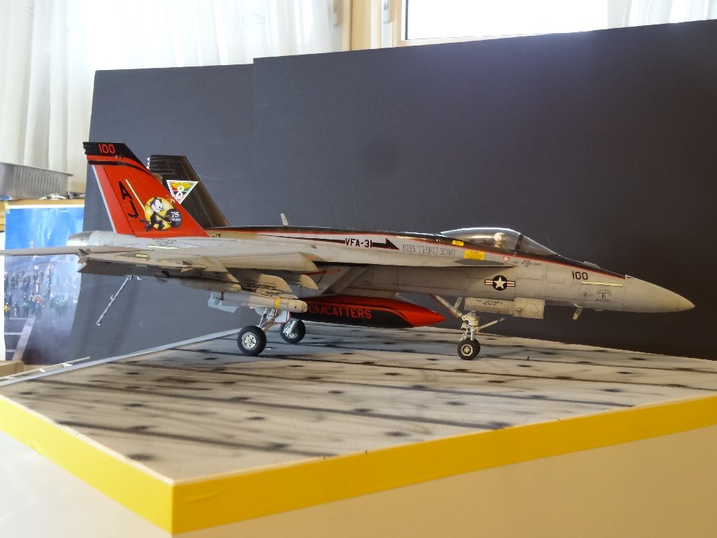

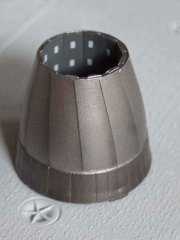

hpetiers Posted March 18, 2020 Author Posted March 18, 2020 hi Chrish, thanks for sticking around this far into the build. I don't know about Canada, but over here they call it social isolation. I call it more time to do model aircraft building. My project is coming along a bit faster than in the last months. I finished the inlets with use of some small plastic parts to imitate the retraction mechanism: then mounted it on my Rhino: Sprayed the burner cans with Vallejo metallic steel and with Tamyia smoke on each edge of each blade: then mounted them, after which I could also glue the ailerons. the carrier deck has been primed with Tamyia primer, the anti-slip coating came out quite well, as did the tie-downs that I had printed by Shapeways: Derek B, Victor K2, LSP_Kevin and 13 others 16

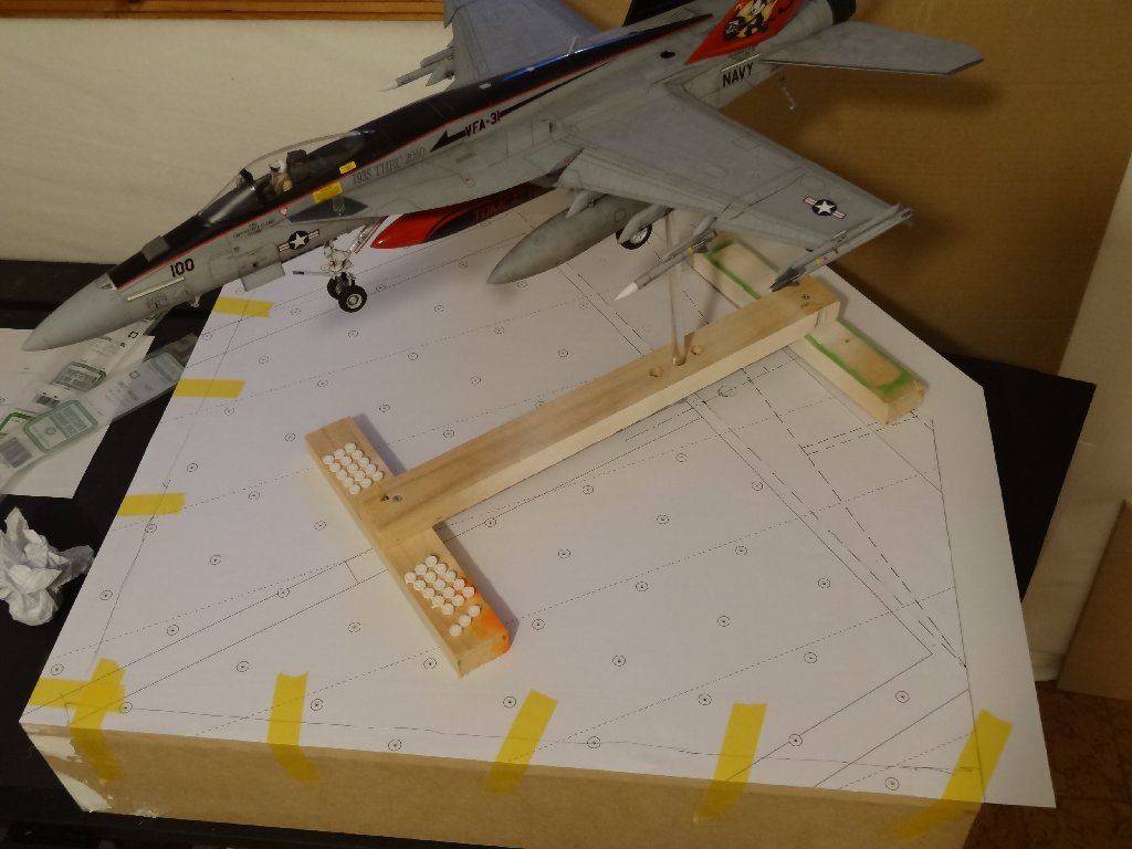

hpetiers Posted March 21, 2020 Author Posted March 21, 2020 (edited) in the mean time I have made the frame for catching crew members if they get blown off the deck. On this frame I will apply netting by means of some medical gauze. Also did some pre shading on the deck: I dared to put my Rhino on its feet. It is almost a tail sitter! Edited March 21, 2020 by hpetiers Fanes, Starfighter, Landrotten Highlander and 9 others 12
