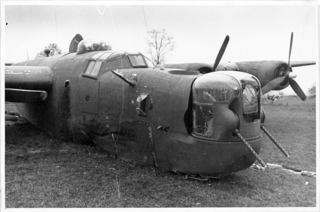

109ace Posted March 12, 2019 Posted March 12, 2019 (edited) I have a feeling the Emerson turret is hosed up way worse then just the frosted plastic. I think the damn thing is grossly undersized in comparison with the Consolidate A6 unit. Correct me if I'm wrong. But isn't the Emerson supposed to be taller then the Consolidated? The Emerson that sits in front of the plane and sits proud of the area in front of the windscreen? Picture provided of the Consolidated on the left and Emerson on the right. Thoughts? The Emerson in the 1/48 Monogram is taller then the Consolidated. Edited March 12, 2019 by 109ace Smokey 1

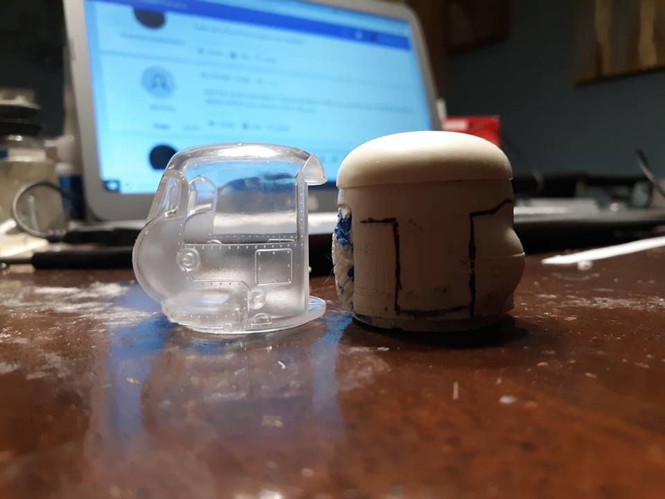

109ace Posted March 14, 2019 Posted March 14, 2019 I think I have the two turrets correctly proportioned. Consolidated on left, and Emerson on right and in first cast resin. I will fill in the seam between the new top and the turret bottom. Then make a new mold. from there I will cut, chop, and grind the upper and lower dies, then make molds. I hope to have the Emerson done tomorrow. Then on to the Consolidated. That should not be too difficult to get into production. This weekend is looking better for release. Dennis7423, Out2gtcha, Big Tony and 2 others 5

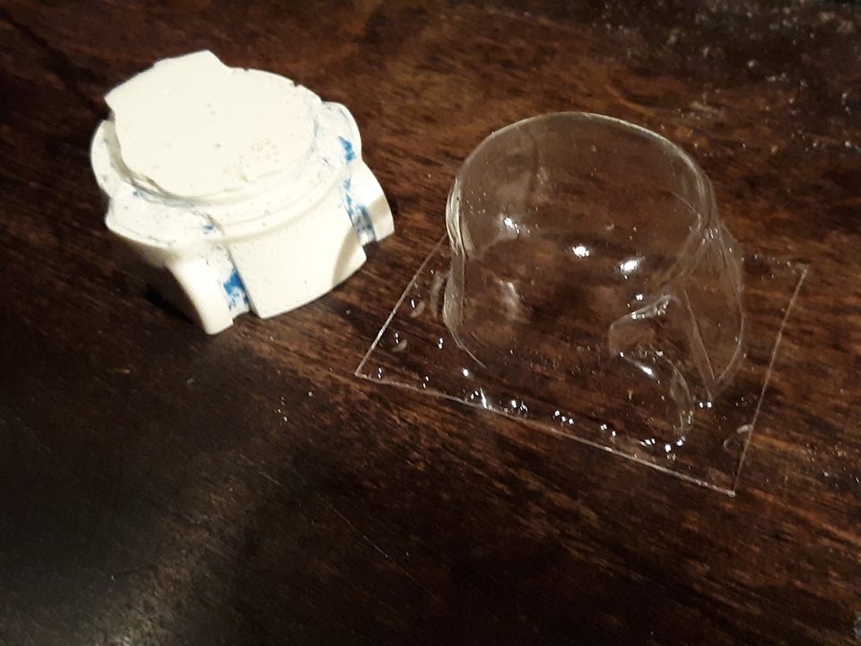

109ace Posted March 15, 2019 Posted March 15, 2019 The first pressing of the replacement Emerson Turret for the Hobby Boss 1/32 B-24 Liberator is a success. Next up I will continue work on the Consolidated turret. I am working on the Consolidated unit and will have it ready tomorrow 3/16 and available for sale om Sunday 3/17. They are being sold individually for $15 each. LSP_Ray, Wackyracer, Lee White and 4 others 7

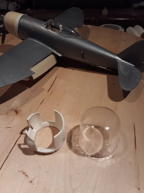

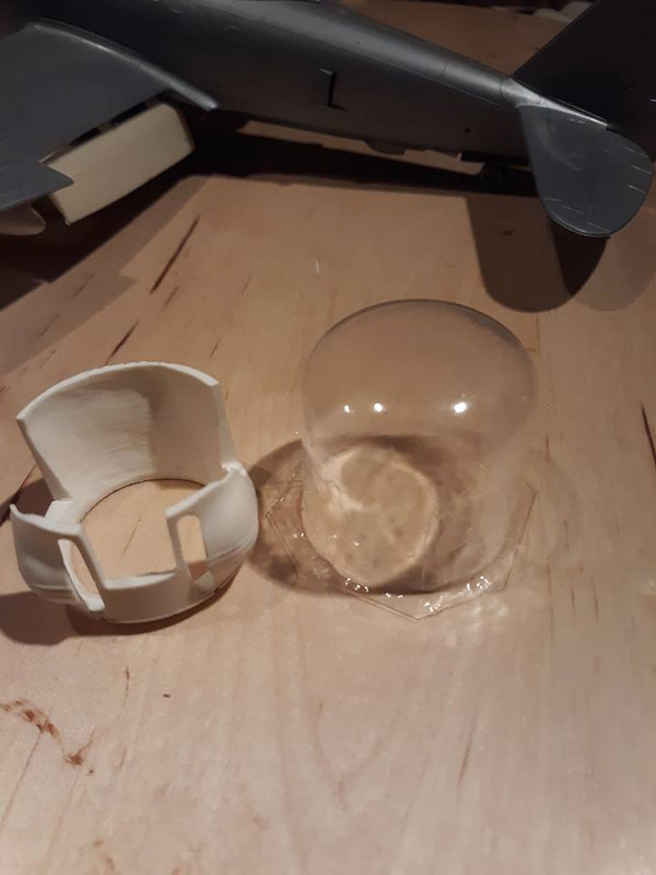

109ace Posted March 16, 2019 Posted March 16, 2019 The vac top for the Hobby Boss 1/32 B-24 Liberator Consolidated turret is real close to where I am happy with it. I need to polish the resin die a little more. Outside of that, I'm really happy with the fit to the bottom. I have to grind out the inside of the bottom to allow fitment of the kit interior. LSP_Ray 1
