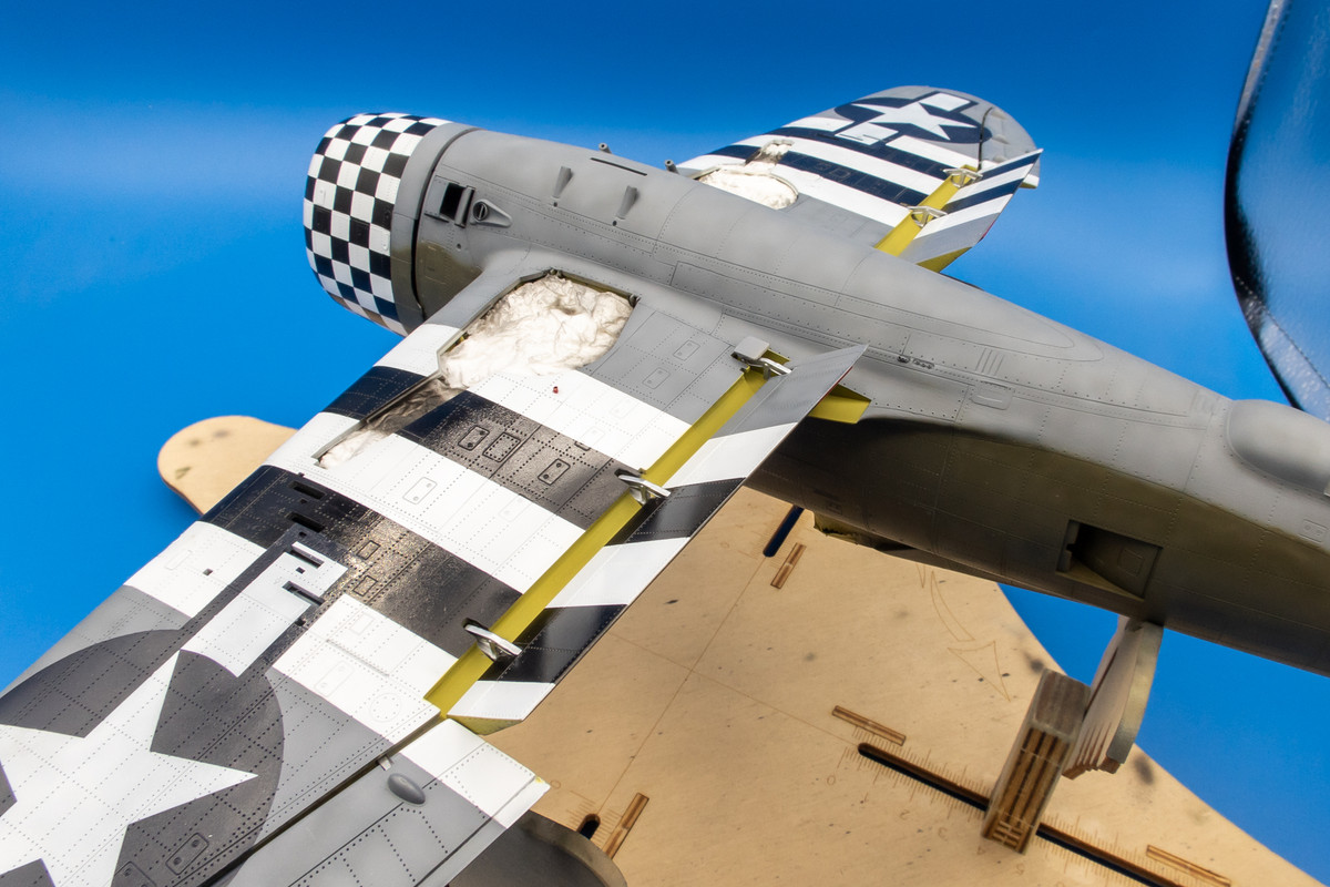

Thunnus Posted February 20, 2023 Author Posted February 20, 2023 Thanks everyone! I forgot to show the bottom images from the last update. You can see that I painted the recesses for the flaps in Zinc Chromate Yellow. The fuselage star was masked off and the bottom fuselage stripes were painted. Dennis7423, JayW, TAG and 10 others 13

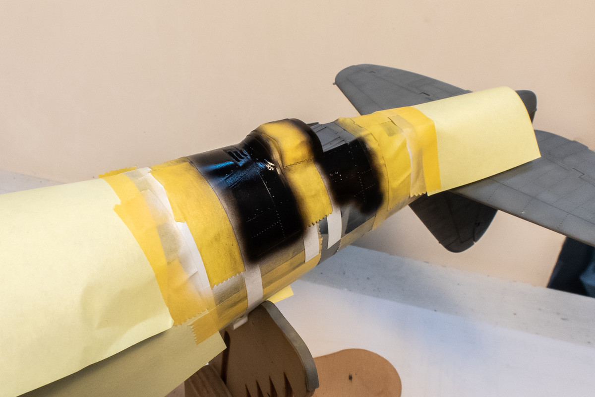

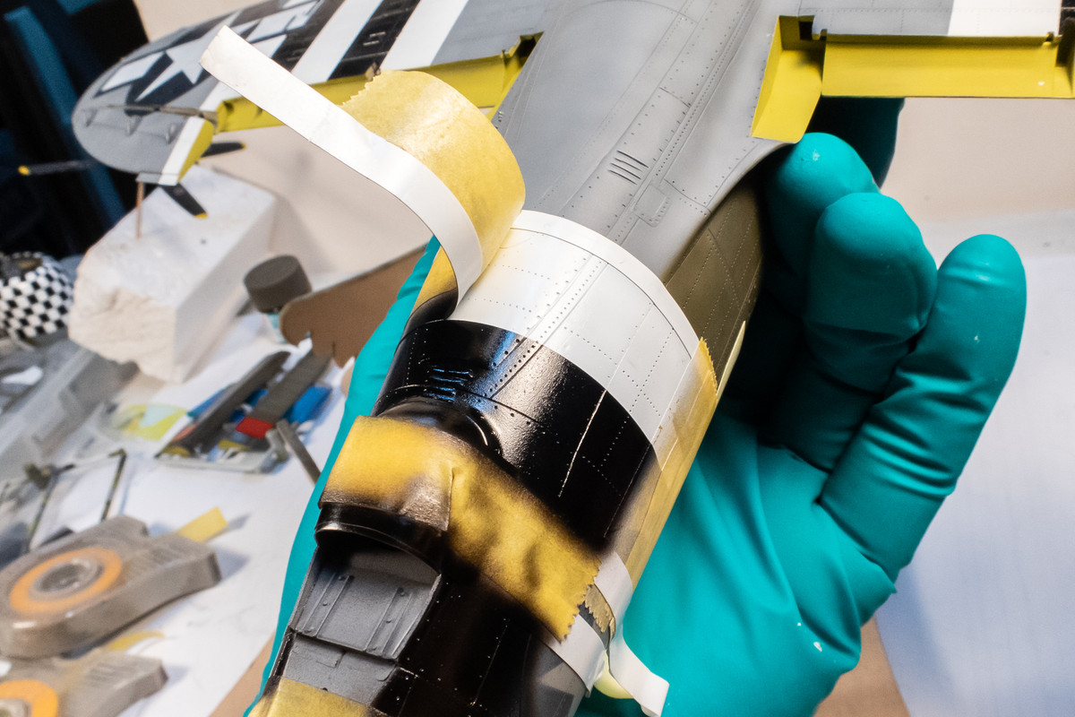

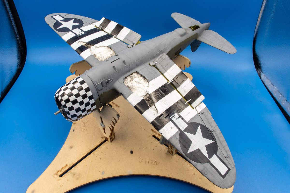

Thunnus Posted February 20, 2023 Author Posted February 20, 2023 The insides of intercooler exits and the intercooler louvers have been painted. A view of completed fuselage invasion stripes. denders, Gazzas, zaxos345 and 27 others 30

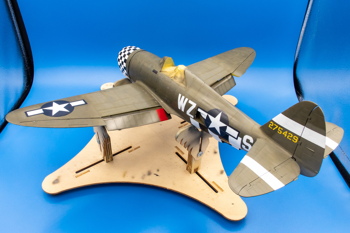

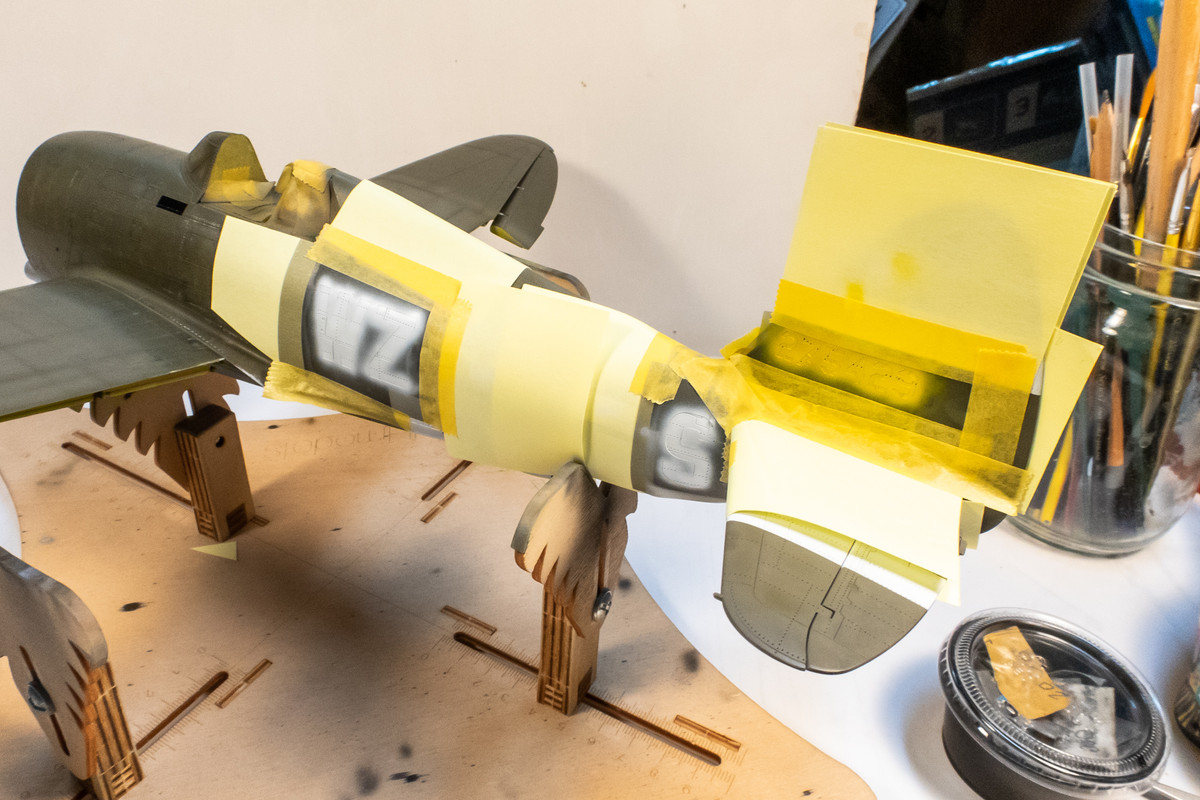

Thunnus Posted February 21, 2023 Author Posted February 21, 2023 Thank you Jay and Ernest! Painting of the markings continue... the white stripes on the tail are masked and sprayed. After the white stripes dried, I applied the masks for the aircraft codes and numbers. Now that the major markings have been completed, we put the model in the light box to capture progress of the build to this point. There are some differences in sheen as some parts have been given a gloss coat (i.e. flaps, fuselage stars and bars). Woody V, Troy Molitor, mc65 and 24 others 27

clioguy Posted February 22, 2023 Posted February 22, 2023 Beautiful! Did you cut your own masks or are you using AM masks? Thunnus 1
Thunnus Posted February 22, 2023 Author Posted February 22, 2023 Thanks guys! Appreciate the comments! 23 hours ago, JayW said: What a beauty! I look forward to your weathering (weathering-lite, right?). I know you will make that just as convincing as what you have done so far. Thanks Jay... I still haven't thought too much about the weathering but it won't be too heavy. Anyone got a good reference pics of the underside of an operational Jug? 21 hours ago, LSP_Kevin said: Really looking the business now, John! Kev Thank you Kevin! I still need to blend in the paint between the forward and rear fuselage but the markings help to mask any obvious indications of the previous paint repair. 5 hours ago, clioguy said: Beautiful! Did you cut your own masks or are you using AM masks? Thank you! The masks were cut on my Silhouette Portrait cutter using AutoCAD and scans of the Barracuda decal sheet. JayW 1
