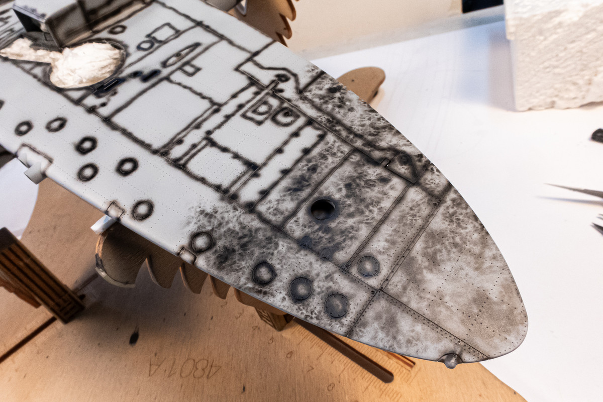

alaninaustria Posted June 4, 2025 Posted June 4, 2025 Beautiful build John! I enjoyed my walk down memory lane! Outstanding!! Ive noticed in your builds you use some sort of kitchen scrubbing foam to get a mottled preshade - what exactly is that? I would love to know! Great idea! Cheers Alan Thunnus 1

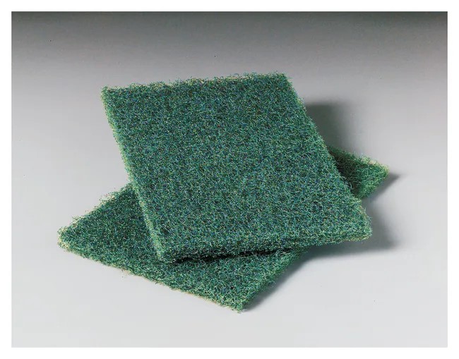

Thunnus Posted June 4, 2025 Author Posted June 4, 2025 Hi Alan! Thanks for the comment! I use a scrubbing pad to serve as a mask for my mottle pre-shade. A product like this... Out of the package, one piece is too thick to spray through so you have to thin it, which easier said than done. It's a tedious and sloppy process to cut these pads using a combination of scissors and a sharp blade but it gets usable once you start to be able to see through it. HB252, Castor, Landrotten Highlander and 10 others 11 2
