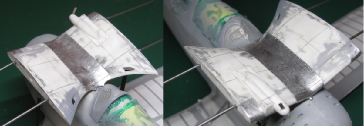

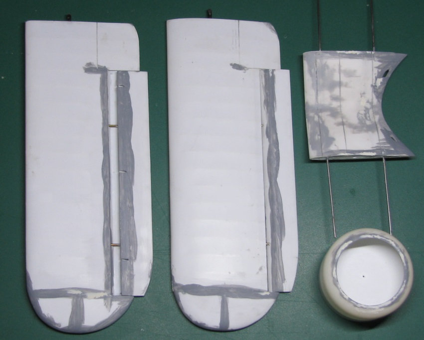

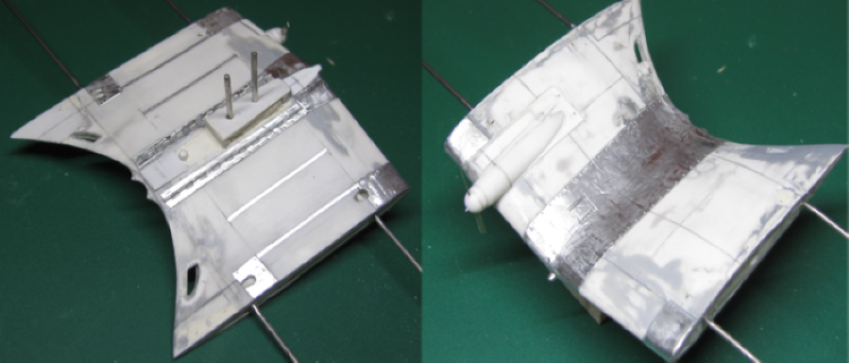

baffozac Posted August 5, 2019 Author Posted August 5, 2019 Not here quite a while, sorry. Wing tips added, correction of the front of the cowl (too large) and beginning of the engraving of the central part of the upper wing. Grey Alclad primer is used to see where Milliput is required. Landrotten Highlander, Gazzas, LSP_Kevin and 4 others 7

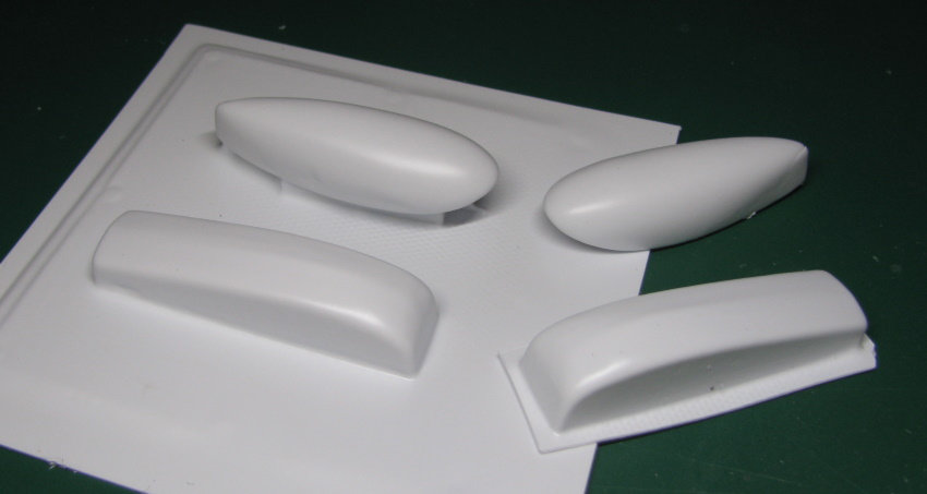

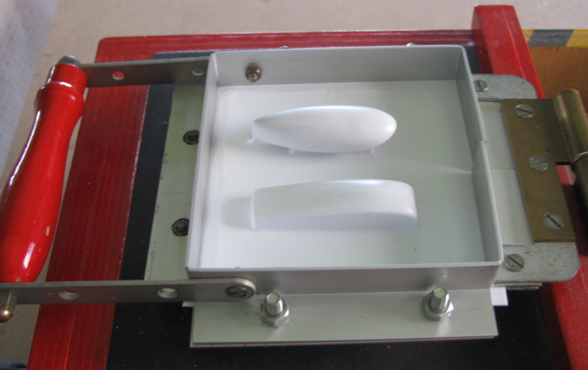

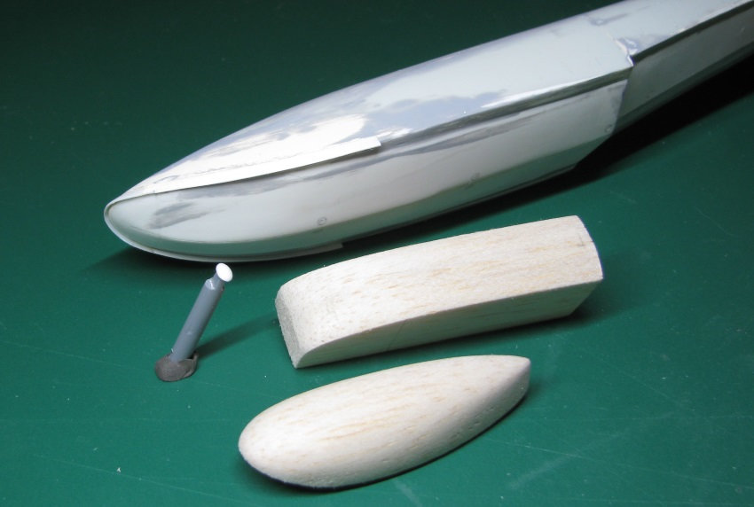

baffozac Posted August 23, 2019 Author Posted August 23, 2019 Hello, a little tired with the wings : The floats. The largest come from Arado 196 B by Revell. It has been shortened reduced in height but widened and the bottom vacuformed. Thanks to Revell France after sale service. For the small floats, plugs in balsa. 1 mm plastic card is used. To follow............ scvrobeson, patricksparks, Trak-Tor and 13 others 16

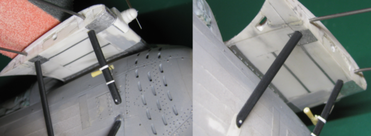

baffozac Posted September 26, 2019 Author Posted September 26, 2019 Tests for attaching floats : The small The big. I used Contrail profiles reinforced with a stainless steel tube Since nothing is stuck, it may seem wonky........ The engine cowl support must take into account that the propeller axis is shifted up and left. Starfighter, Out2gtcha, scvrobeson and 12 others 15

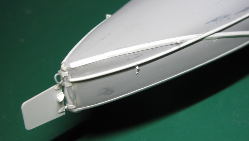

baffozac Posted October 16, 2019 Author Posted October 16, 2019 Hello gentlemen, Sme details on the masts of the central float, always renforced with inox tube Contrail profile. Rhodoid square is only there for the photo.......Six hatches are missing and will be cast in resin. At the rear of the masts the "big" pulley where the rudder cable runs. Here, two small pulleys on each side. Landrotten Highlander, Kagemusha, patricksparks and 12 others 15
