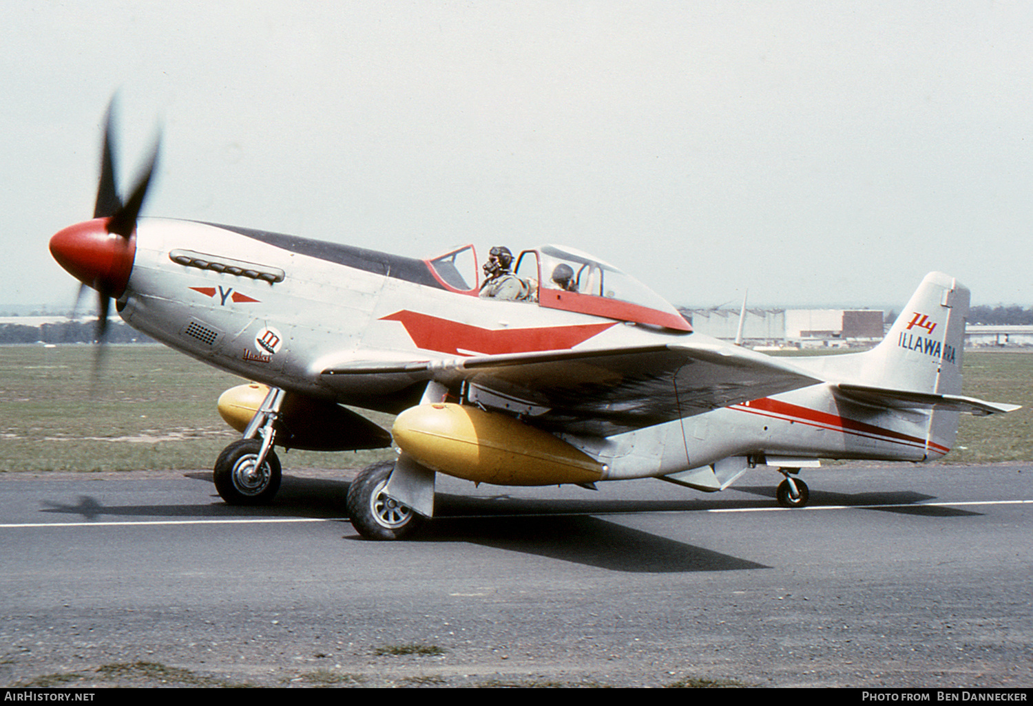

DerekB Posted July 3, 2018 Posted July 3, 2018 (edited) While searching for wheels for a CAC Ceres build I picked up a Hasegawa Mustang kit quite cheaply. I was originally just going to use the kit's wheels, but then I thought it might be fun to build the Mustang as A68-39, VH-BOY, known as "Yankee", one of the target-towing aircraft flown by Fawcett Aviation out of Bankstown in the 50's. Fawcett's two Mustangs (VH-BOY "Yankee" and VH-BOZ "Miss Zulu") wore many colour schemes during their careers, but I quite like the early silver and red colours carried by "Yankee": This build will be mostly OOB (a few small changes for the target towing gear), but since the interior of the Hasegawa kit is such a "blank canvas" I'm in dire need of pictures of the interior of a two-seat Mustang... can anyone help? The fuselage fuel cell was removed and an observer's seat was installed behind the pilot, facing rearwards, to assist with target deployment and retrieval activities. Here's a shot of Fawcett's "Miss Zulu" in the same red speedbird colours (slightly different spinner) and showing the starboard-mounted propeller to power the target towing winch: I have David Muir's excellent (but costly) Southern Cross Mustangs book for reference, but sadly no interior photos... Edited September 9, 2020 by DerekB photos went missing MikeMaben, KiwiZac, R Palimaka and 4 others 7
