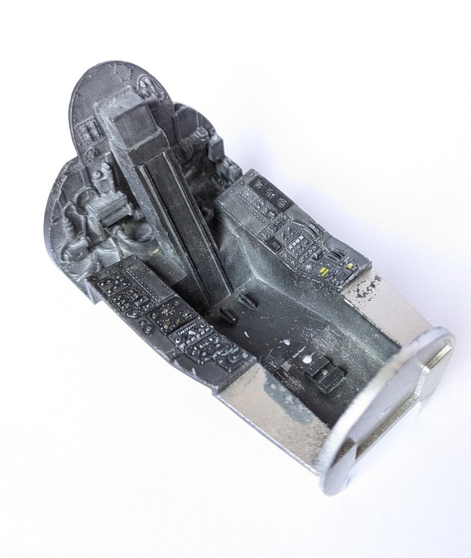

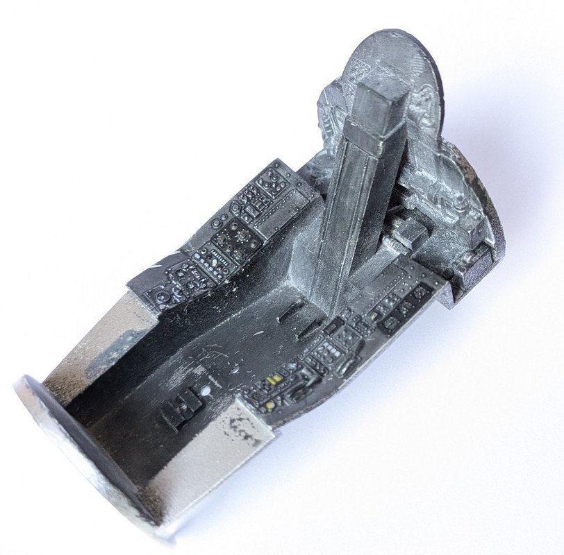

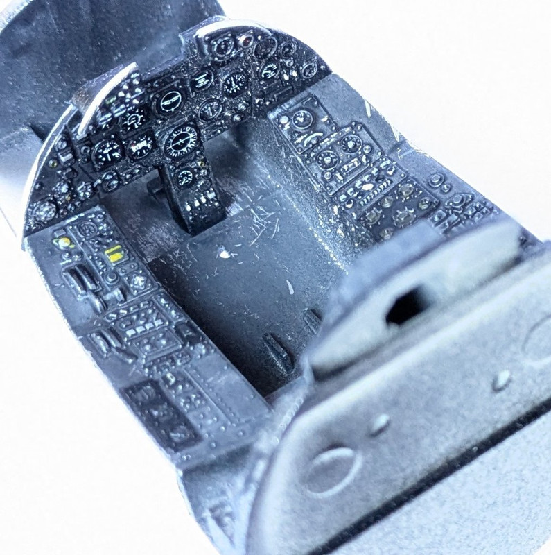

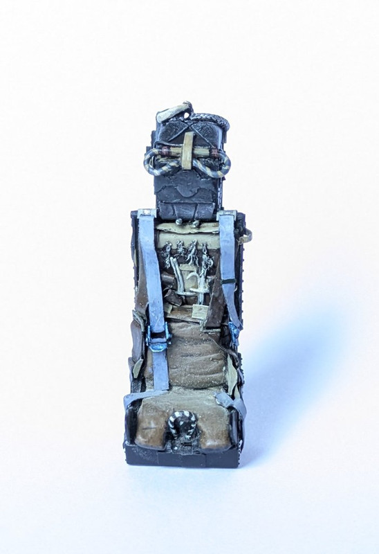

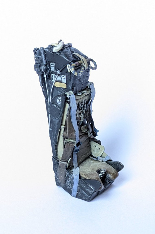

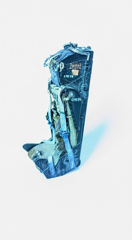

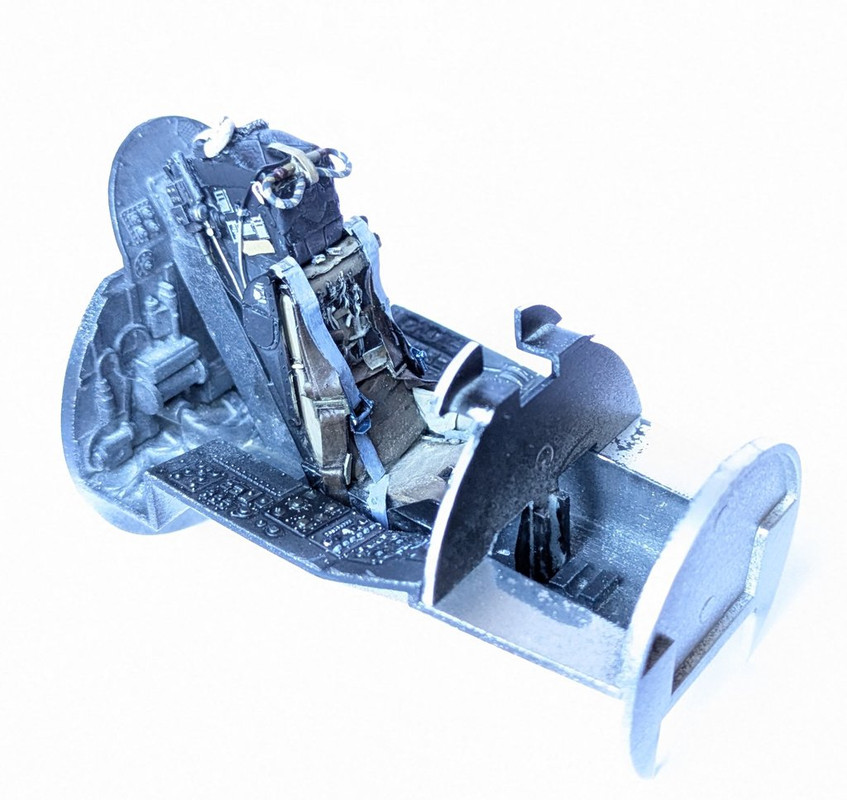

  4. Hello everyone. Hope you're all doing well.
    It's been a while but work has continued gently amidst life stuff.
    I got the seat painted and after studying @Madmax (Sean's) build I added more detail to the head box.
    I've aimed for a faded, dusty look.
    Next up is the cockpit.
    Revell have done a reasonable job on the tub for the most part but the detail is a little low relief.
    Nevertheless, since very little can be seen I just tried to pick out the molded in detail.
    Detail behind the seat is pretty good but it's virtually invisible once the fuselage encloses the tub.
    A couple of obvious features need adding though.
    Aft of the seat on the starboard side is a red wheel and cable mechanism that's strangely missing from the kit. On the port side there's quite a large cylinder and cables on a shelf alongside the back of the seat that are suggested in the kit but they need beefing up.

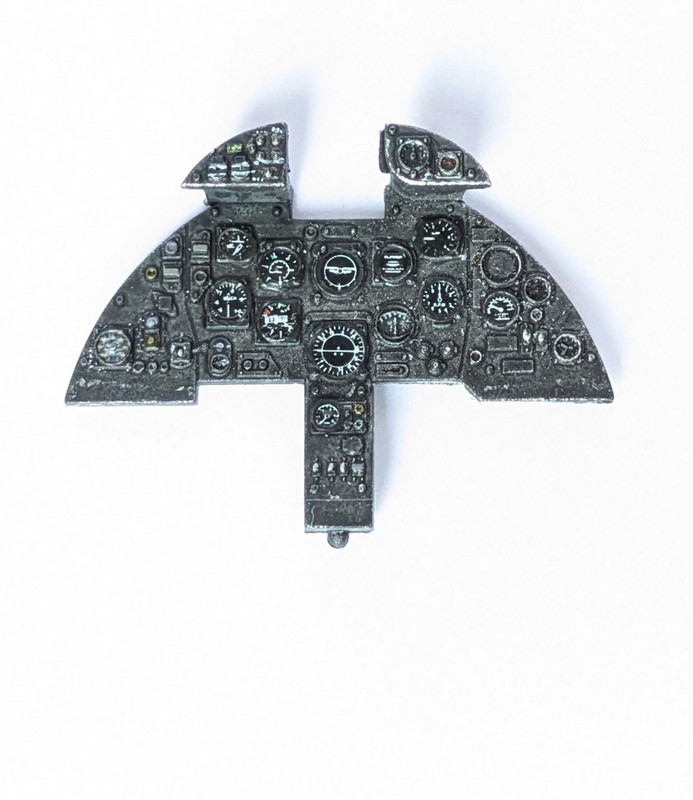

    I used Airscale instrument decals on the IP
    Not absolutely accurate but given what will be visible eventually, good enough.
    Control column and pedals next.
    Cheers,
    Guy
