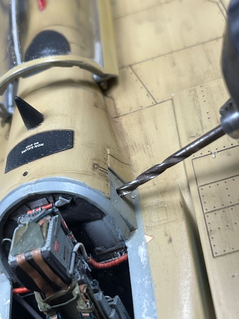

mc65 Posted May 26, 2023 Author Posted May 26, 2023 oh, how long! sorry for the absence, I haven't had much free time in the last two weeks. let's see what I've done lately... little stuff: I've added the white and blue straps that connect the ejection seats to the crew's limbs, so as to automatically recall them to the body in case of ejection. having done this, I definitively positioned the autarkic canvas screens that keep the navigator displays in the shade. starboard side and port side then, since I'm a genius at self-harm, I decided that I wasn't convinced by the pin I had inserted at the base of the canopy to keep it in place (I remimd you that Italeri didn't think of anything for this eventuality, except a strut ugly and out of scale, imho). so I cross my fingers, uncrossed them, and took the drill. on the apex of the fuselage you can see the hole previously foreseen for the pin. I then glued three magnets of 150gr of attraction force. in this photo you can see, on the bulkhead behind the headrest, also the right air vent redone with tin and copper, as the resin arrived damaged at that point. in the previous photo you can see better the left, original of the Aires set. in the canopy's corresponding points, after making housing using the considerable thickness of the transparent, I placed two 33gr magnets on the sides and one 110gr in place of the pin seat. While I was there, I completed the interior with the air ducts and relative vents which in reality match those on the bulkhead behind the navigator headrest. you can see (out of focus) the handles added during the locust operation, afterwards added on all the Italian Tornados. to determine wich was the optimal angle to position the canopy, and consequently the magnets, I made a slightly longer (and to scale) brass tube strut than the one supplied in the kit. normally on a pre-flown aircraft this strut was removed, together with most of the external covers/RBF flags. also, as you can imagine, the navigator must be a kind of eel to access his own place. marked the correct height and position, I glued (in two sessions) the apical magnets, the ones that govern the angle of the open roof, in two-components. using the already known kitchen foil technique: inserting a piece of film between the two magnets avoids the possibility that the epoxy ends up between the two, permanently gluing the canopy in position. et voila. now even without the strut it remains opened, with the advantage of having tje option to may remove it for better access to the cockpit, but above all making the joint shock-proof: the pin, although solid, was too rigid, and was anchored to the roof on too small a surface to keep me calm. along the way I added some weathering with pastels, in this photo you can see the marks left on the front fuselage by the ladder and boots, or at least this was the intention. and finally I placed it definitively on its base, it is finally safe from my clumsy hands in the various movements. now I can install the last more fragile details such as pitot on the radome, fuel probe, and retouch different color points, as well as giving the transparent glossy and matt according to the points. cheers, Paolo chrish, Fanes, LSP_Kevin and 12 others 15
Bstarr3 Posted May 26, 2023 Posted May 26, 2023 Che bella, Paolo! This really looks incredible, and the Tornado kit looks like a nice one. I'm still trying to figure out exactly what you did with the magnets on the canopy, but it looks ingenious. I'm trying some magnets on my current build so looking out for all the different ways people utilize them. mc65 1
scvrobeson Posted May 26, 2023 Posted May 26, 2023 Fantastic progress! I really like the idea of using magnets on the canopy to hold it open Matt mc65 1
