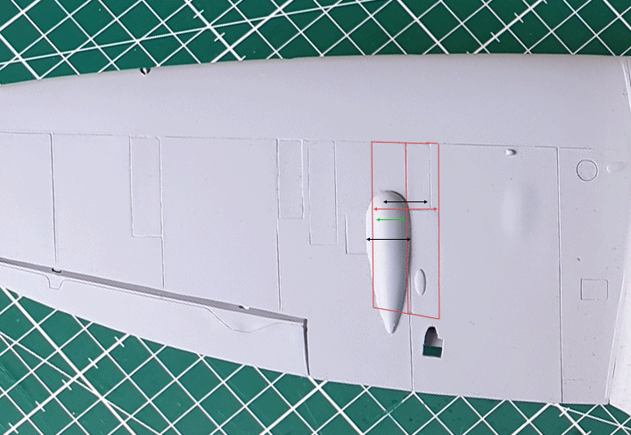

red Dog Posted August 27, 2019 Author Posted August 27, 2019 (edited) While sanding and priming the wings, these canon blisters on the top of the wings of the airfix model became more and more of a concern Airfix probably wanted to depict the two cannon larger blister. That blister was abandonned pretty quickly as they realised that the two cannon per wing were too heavy and field mounted one canon only. So the bulge was changed to a narrow one. Only a very few early MkIX flew with the large bulge (those converted from MkVb) and it's definitely not the case of the aircraft I am representing. But the Airfix blister is nowhere large enough to represent that large blister and it's nowhere narrow enough to be the later narrow blister either. It seems to be molded somewhere in the middle of the two blisters dimensions… On top of that it's placed way too far back. This is what itched me when I was looking at it. I didn't really realise until I saw the MkVb tamiya in 1/48 of the same aircraft. As you can see the blister is as wide as the door, that's the large early blister and is accurate for that MkVb trop which is the same as the airfix model. On the Following picture, it is clear that the blister is actually coming lower than the flaps down panel top edge and it shouldn't be. I also traced in red the rough shape of the double cannon door of the C wing and you can clearly see that the default blister is not only mishapen, it's outcentred. The black arrows illustrate the width of the airfix blister (not wide enough) The red arrow illustrates the width that the large early blister should be the green arrow illustrates the width the narrow late blister should be It took a while to summon the courage to do it, but there is no doubt anymore: That default blister needs to go and be reshapen to a narrow blister and replaced at the correct position. Other things needing to be done, but much easier, will be to relocate the inner .303 gun bay just outboard the panel line (and delete the extra one closest to the gun blister) and correct a lot of panel lines to actually convert this to a decent C wing as depicted on the following picture: I also read that some field mods of the C wing removed the short cannon plug completely. That may explain the Reason why I Don't see them on the real aircraft pictures posted above. I haven't decided yet what to do there. I'll attend that problem later on... The only doubt I haven't cleared about the wings is the slight possibility that this aircraft actually has the E wing installed with no .303 in the outer wings. Ultimately, that won't change much to the blister and panel lines. As I continue my investigation and if it's Indeed an E wing, then all it takes from that C wing conversion is to fill the gun holes on the outer leading edge. I really doubt it's the case because the official nomenclature of these spits in the 349th squadron is "LF MkIX Merlin 66" And that should correspond to a C wing with (initially) 2 hispano cannon (one installed in the field only) and 2 .303 guns. The E wing should only have one gun and one cannon. So at this time, I'll stick to my C wing conclusion. I also read that the C wing had no gear down Indicator. But I wasn't able to confirm that yet... Edited August 27, 2019 by red Dog Greg W, Fanes and LSP_Kevin 3

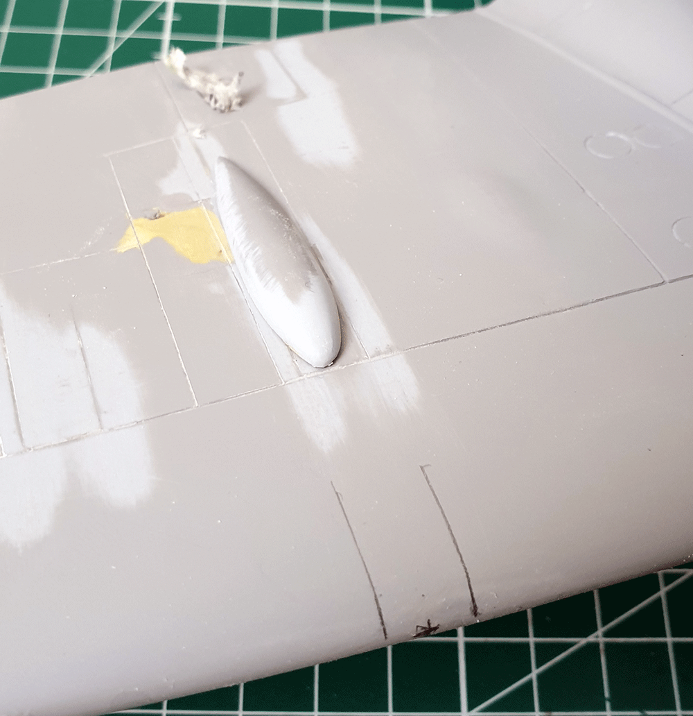

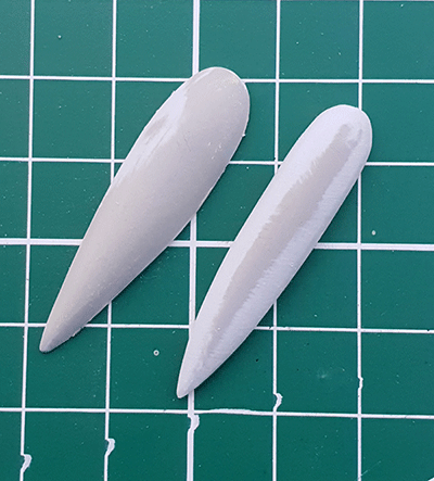

red Dog Posted August 30, 2019 Author Posted August 30, 2019 (edited) I cut both blisters from the wings with precision saw (one of them with a field modification specially for this operation) You could say that i could have done that before actually gluing these blisters on the wings, and you'd probably be right, but it was one piece with some panel and I'm not sure the modification would have been any easier earlier. Then the wings were sanded off once again Milliput was used to fill the gaps before sanding again. The removed blisters were filled with milliput as well as they need to be sanded thinner later on. After a coat of Mr Resin primer, the wings are smooth again (except for a few defaults remaining) and a good base for engraving and rivetting. Thinning the blister to the correct width was easier than expected. I still need to work a bit the symetry and probably reduce the height a bit, but this will be good enough. The marks on the left picture are the dimensions I need to end up with according to the tamiya blister adapted to 24th scale. Next step will be to engrave the wings with panel lines and subtle rivets line. Edited August 30, 2019 by red Dog Alain Gadbois, Lothar, Fanes and 7 others 10

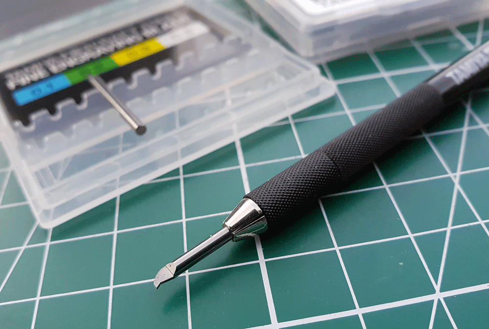

red Dog Posted September 1, 2019 Author Posted September 1, 2019 Another tool that I tried lately was the Tamiya scriber. Being Tamiya I tought it would be a no brainer and with my favourite squadron tool getting old it would be a perfect replacement It comes with 4 sizes: 0.1, 0.2, 0.3 and 0.5mm I initially made the mistake to get the 0.5mm tool and I tried it on a 1/32 model. The result was way too large for a panel line, IMHO. So I got the 0.2mm and tried again, saving the 0.5mm for the future 1/24 project. The 0.2 proved to be much more difficult to master. Compared to the squadron tool (or a very simple needle) it is prone to slip and go all over the place when you use it freehand. The solution was to learn again to use a ruler of dymo tape. The result is then better but it still requires practise and getting used to which I still lack at this time. For engraving I always have been using the old squadron tool and a simple needle in a large X-acto With this project, I took the new tool again for a spin but even for 1/24 the 0.5mm tamiya still is quite large, but acceptable IMHO Some lines below were engraved with different tools and i must say I still prefer the needle and the squadron tool over the tamiya tool. As I said, the issue I have is probably lack of experience with that tool, but at this time, I still prefer the very light first passage with the needle and then the second passage a little bit heavier before finsihing with the squadron tool. I very often trace the first passage freehand (unless it's straight long lines), with the grip of the needle, it usually remains precise and dig into the plastic just enough to guide the following passage. I wasn't able to get the same kind of precision with the tamiya tool. Although very thin, the point is still flat and OHMO much less precise than the needle. On the contrary, the tamiya tool saves the extra sanding I usually have to do after engraving with the needle (but the squadron tool comes equally clean on that one. So I'm not fully convinced of that tool use, and it's price is steep. Maybe I need to get the 0.3 to finally come to grip with it and I certainly will try. But considering the overal price of this one with different sized blades, I can't say I'm fully happy with this purchase. In any way, engraving the top of the wings is in progress: Still some lines to correct and pencil marks to erase, The next step will be rivetting. Greg W, Fanes, MikeMaben and 5 others 8
Biggles87 Posted September 3, 2019 Posted September 3, 2019 I have been using an Olfa scriber for 30 years or more, which has a blade very similar to the one in the old Tamiya scriber. It only comes in one thickness so you have to vary the pressure to achieve different depth/widths of panel lines, which takes a bit of practise. I did buy a Bare Metal scriber but it only lasted a year before the tip broke off! John nicolas96 1

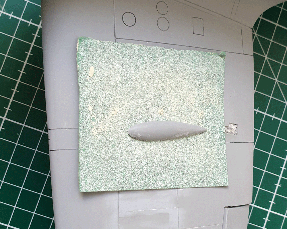

red Dog Posted September 10, 2019 Author Posted September 10, 2019 Thanks for your input Don, black seems the more logical choice, still haven't decided though In the meantime I'm slowly getting to the point where I will be able to paint after very long multiple sessions of sanding and engraving and correcting panel lines But before doing that I first needed to attend the final placement of the canon and their blisters. The blisters are flat on their bottom and the wing is slighly curved. So if I place them like this I will endup with more sanding and putty duty. Shaping these has Always been a problem for me but this time I decided to use a KISS (keep it simple stupid) technique and Simply placed sanding paper on the top of the wing and slided the blisters on the sanding paper at the level where they should be placed hoping the surface of the blister would take the curvature of the wing. It didn't work too bad so hopefully I won't need to use putty gluing these to the wings Deciding to place the cannon in the outer or inner bay was also a long process - you can see spitfires Mk9 with the canon either on the inner or other bay. Eventually I decided to place them in the inner bay. The shaped blister can now be glued in place and the position for the (Master) turned cannon tube is marked Greg W and LSP_Kevin 2
