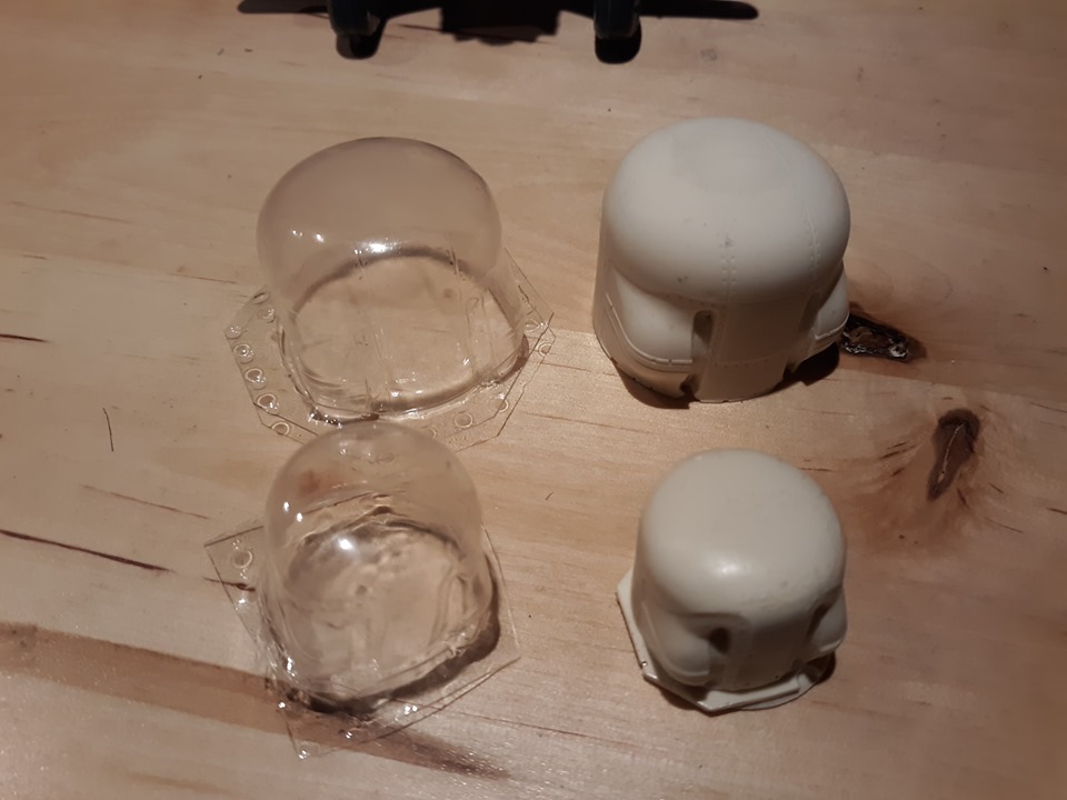

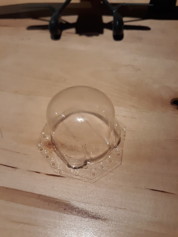

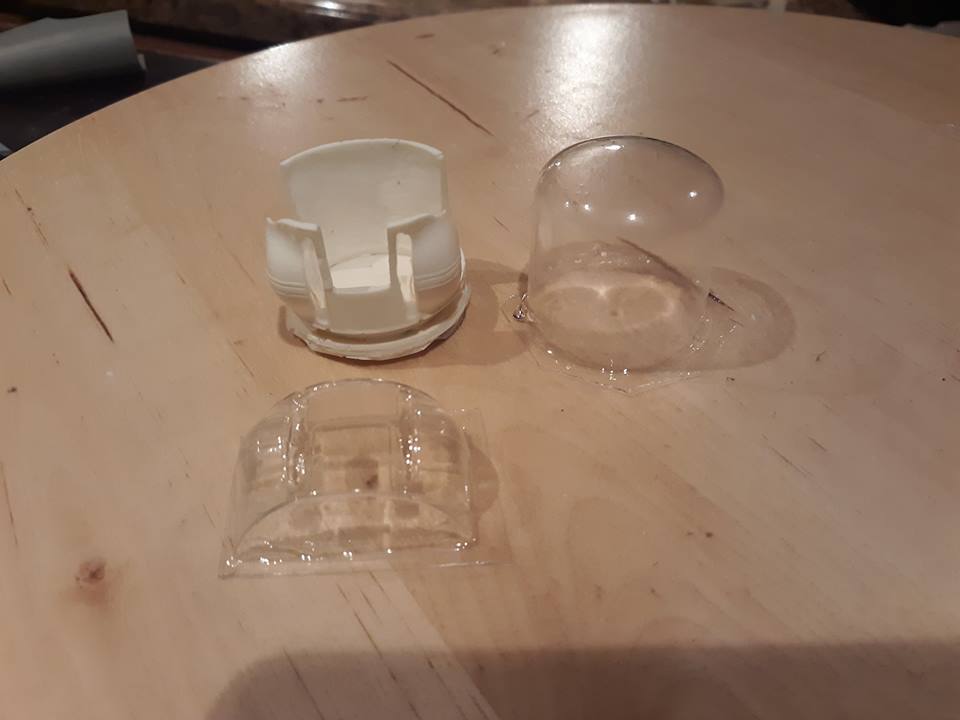

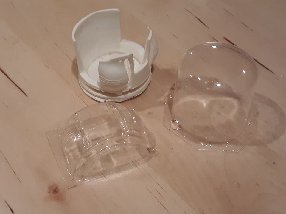

109ace Posted April 29, 2019 Posted April 29, 2019 (edited) I'm just gonna leave this here. This is not fantasy. It is real, and available.I have sold over 100 of these. It has been modified from the kit original to be taller.Further the side glazing area has been enlarged by shrinking down the machine gun wind deflectors. They simply are not as big as Hobby Boss has made them. There are two or more ways to assemble. I provide two. Edited April 29, 2019 by 109ace Wackyracer and Lee White 2
32scalelover Posted April 29, 2019 Posted April 29, 2019 Has anyone assembled one of 109ace's turrets, as I would like to see what they look like with the kit interior and guns installed. Thanks, Greg R Palimaka 1
1to1scale Posted April 29, 2019 Posted April 29, 2019 Yes, I would really like to see some photos of the clarity of the turrets.
thierry laurent Posted April 29, 2019 Posted April 29, 2019 Why not sending one set to LSP for review?
Cees Broere Posted April 30, 2019 Posted April 30, 2019 How do you make the clear part fit the resin part? Any dimensions given in the package? Cees R Palimaka 1
Propwash Posted April 30, 2019 Posted April 30, 2019 I received two of these replacement turrets yesterday. They look good but some instructions would sure be helpful. Been comparing these parts to the kit instructions, and have to admit that I'm slightly confused. As for the B-24 kit, in spite of its problems, I really like it, and looking forward to the D. Just wish Hobby Boss had done a better job, even if that would had added significantly to the price. I've heard talk that Eduard has some aftermarket in the works and scheduled for release in May. Here's hoping! Paul2660 1

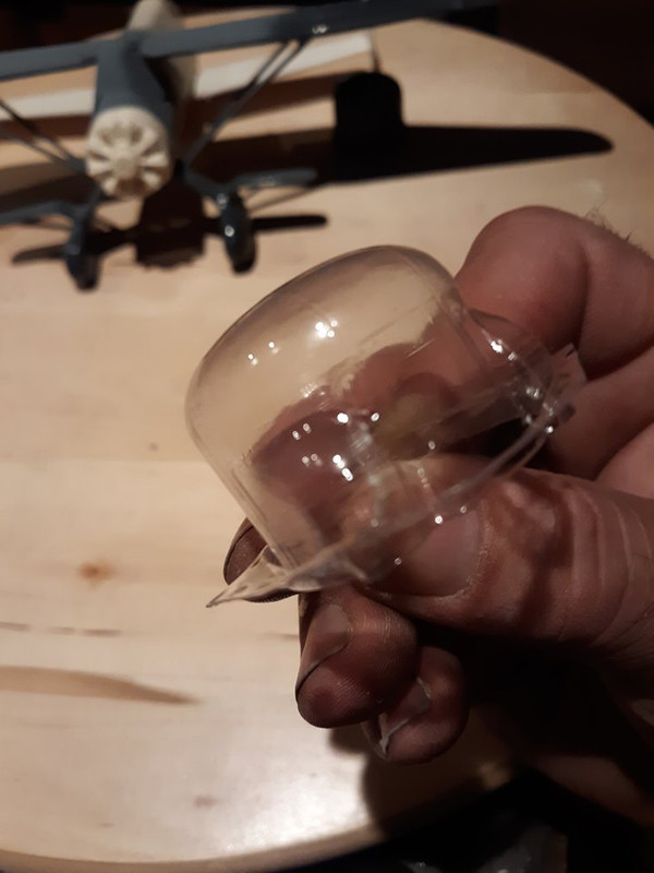

109ace Posted August 9, 2019 Posted August 9, 2019 I wasn't going to give up on the Emerson Turret for this kit. After a lot of trial and error, I have found the path to vacuforming the full Emerson dome in one piece. Just cut the excess sheet away and you have it. Lee White, Jan_G, TimW and 1 other 4

109ace Posted September 13, 2019 Posted September 13, 2019 (edited) I am currently working on a new Emerson turret for this kit, to replace the old set I had been selling. I'm trying to make these as easy as possible for you guys. I'm taking some inspiration from Bill Koster and they way he solved the problem of the parts seam running over the top of the Monogram 1/48 B-24 turrets. I'm working on a three clear pieces ( Left and right sides with wind deflectors, and a center) that follow the actual two joints used in the real turrets. But I will be adding two inside resin formers that will make combining all three parts easier. I'll post pictures when I have all the parts ready. The one piece vac formed Emerson has become hit or miss for producing. It is a time consuming process that involves freezing before extracting the die. The failure rates were unsustainable , and I discontinued sales. Edited September 14, 2019 by 109ace Uncarina, Paul2660, nmayhew and 1 other 4
