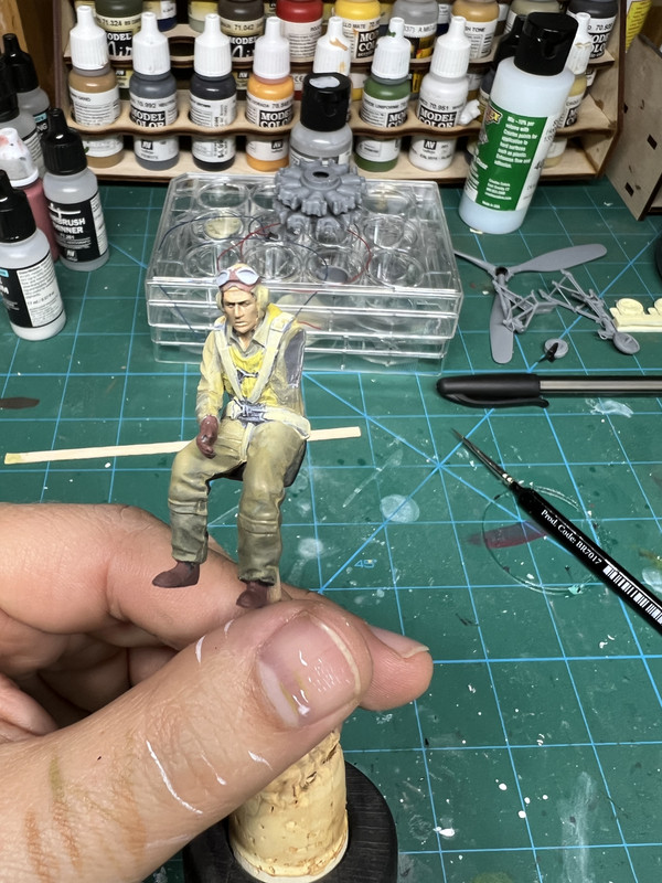

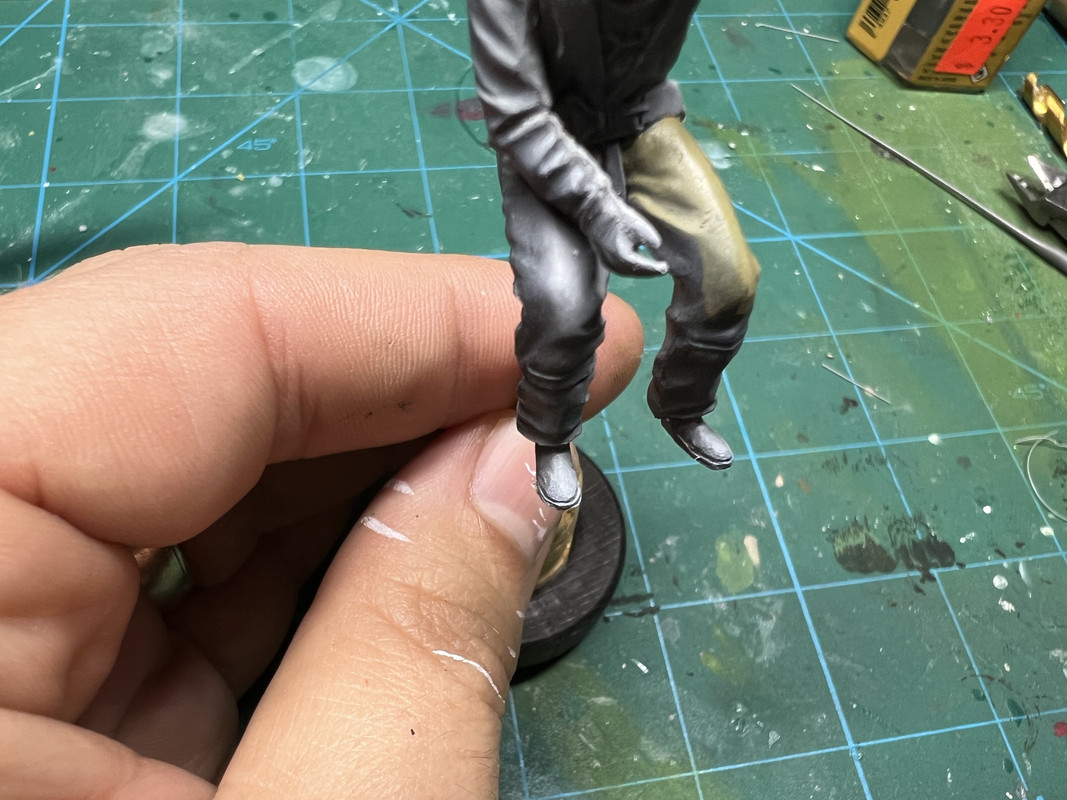

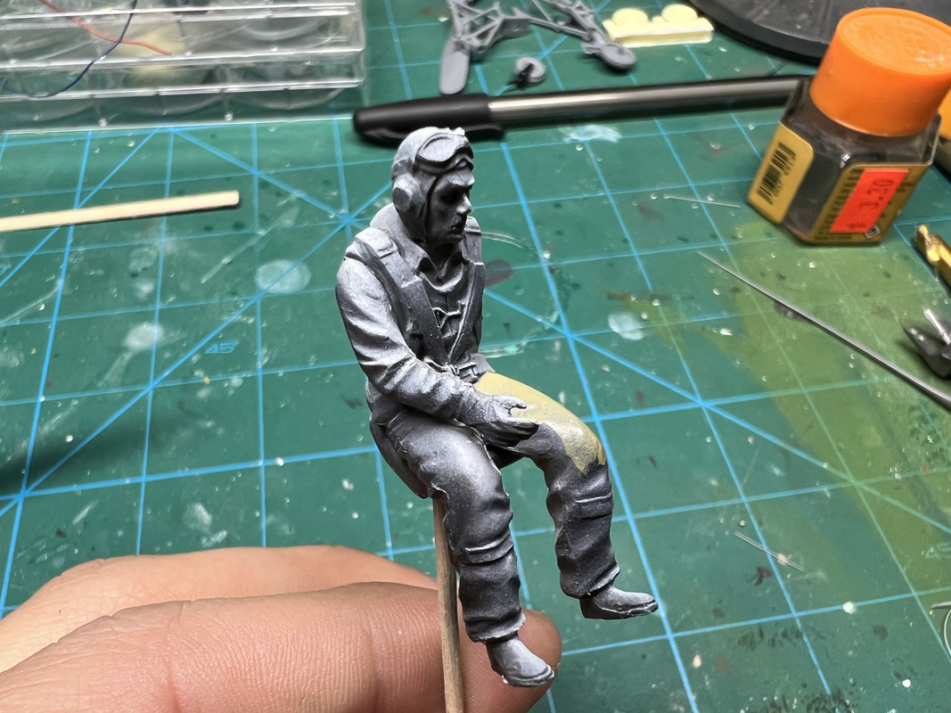

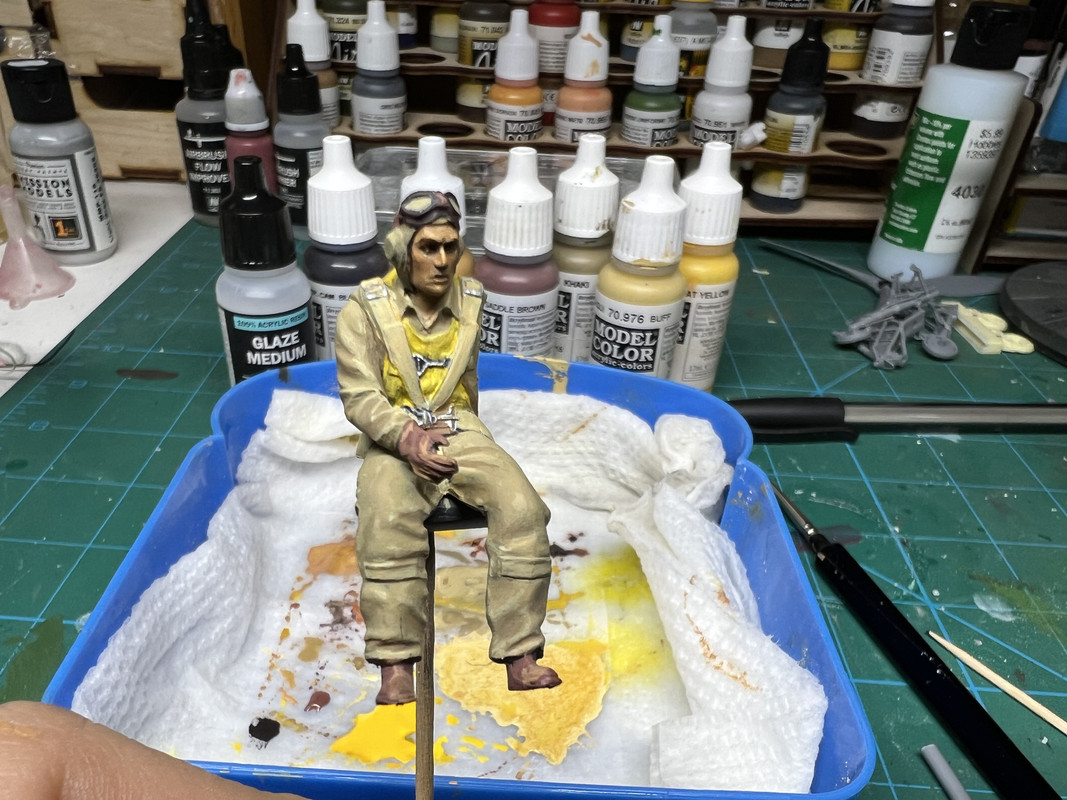

Bstarr3 Posted May 28, 2023 Author Posted May 28, 2023 (edited) While I was puzzling about this motor issue and waiting for suggestions from the peanut gallery, I set about some figure painting yesterday. The kit pilot figure is actually pretty well molded for what it is. The detail is not as great as a resin figure, but looked like the face was well-sculpted enough that I could get a decent result with painting it. I’ve used this technique for my last few figures and been happy with the result. First I prime with Mr Surfacer 1500 black, then do zenithal highlights by spraying a light color - in this case MRP clear doped linen - from an angle above, creating highlights where they would naturally fall, and leaving shadows elsewhere. Then, I brush paint with Vallejo Model Colors, mixed with glaze medium. This creates a thin but even layer of color, through which the shadows and highlights show nicely. Here are the basic colors blocked in: I start with a base layer of brown sand on the face, then mix up a wet palette with sunny skin tone, brown sand, and buff, blending shadows and highlights between these three colors. that one brush is what I use for the whole figure, although irises of the eyes were done with a toothpick. here’s the finished work: Edited December 8, 2023 by Bstarr3 chukw, HB252, Landrotten Highlander and 11 others 14

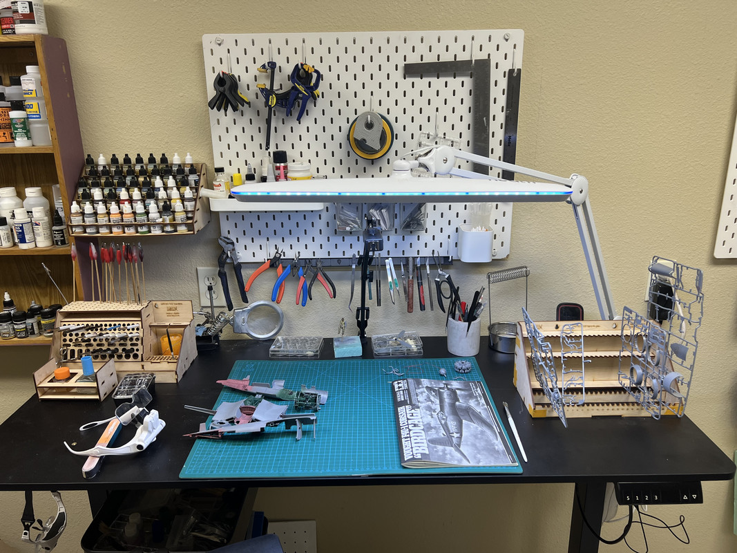

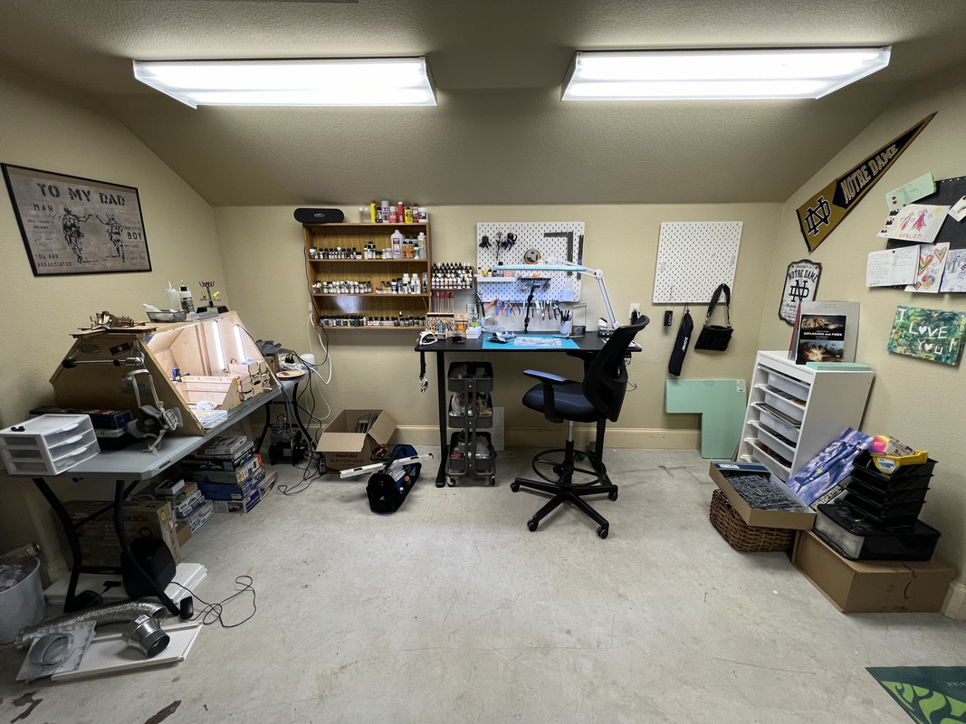

Bstarr3 Posted December 8, 2023 Author Posted December 8, 2023 I'm back!! It took much longer than I wanted to get the new workshop space set up, but I finally did. Great spot in the detached garage, and now that it's less than 1,000,000 degrees in Texas, I can use it! (Plan to put a minisplit AC in before next summer). First a couple pics of the new work space: I've been updating my progress on Instagram, but I will get some of the photos in postable form for on here and let you all know where we are. Getting close to finished! TankBuster, BiggTim, Shoggz and 12 others 15
MikeMaben Posted December 9, 2023 Posted December 9, 2023 Very nice B, a comfy chair and good lighting is a must.

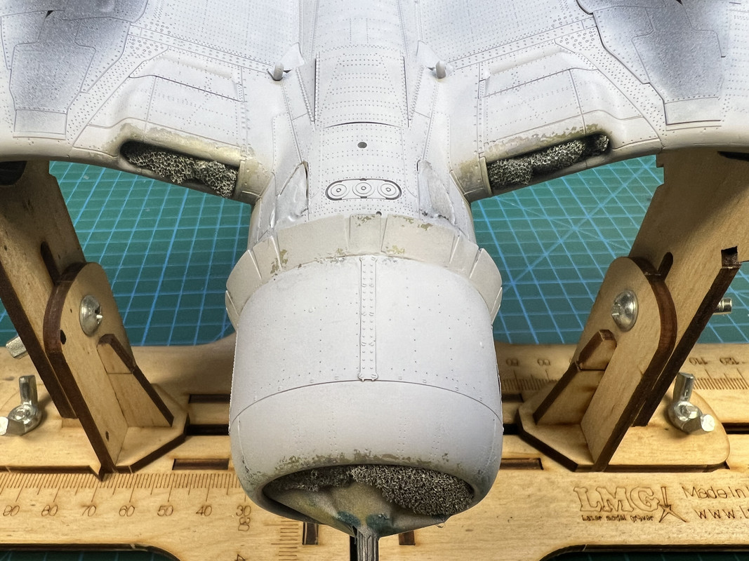

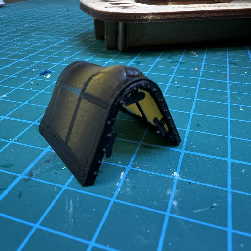

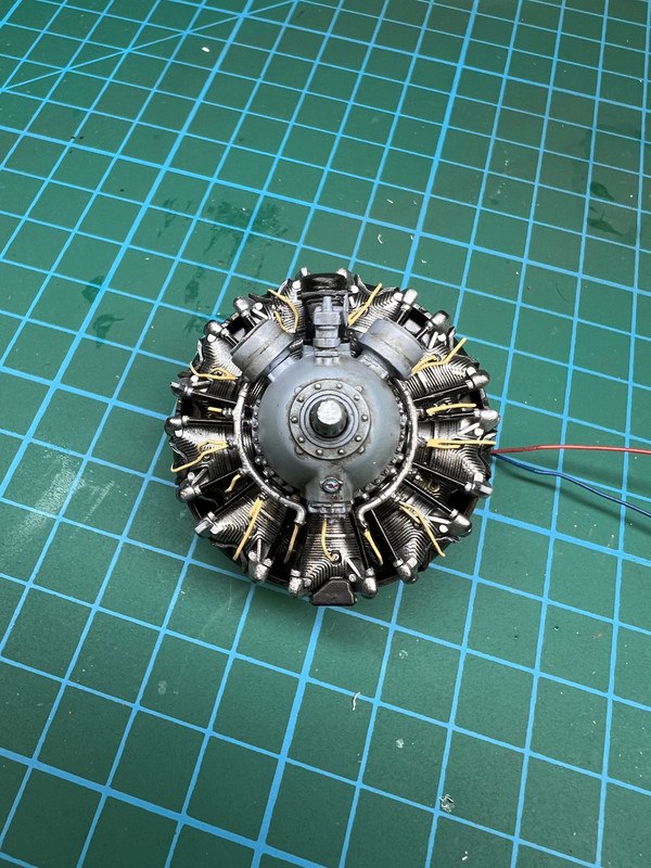

Bstarr3 Posted December 13, 2023 Author Posted December 13, 2023 Finally some photos of plastic! Here is the finished engine. Remember, inside of gear reduction housing is a small DC motor attached to the propeller spindle, so we will have an actual spinning prop on this bird! Did a little scratch building on the canopy, added some framing and a canopy release handle: Did the two layer chipping technique here, using MRP for both the metallic and the ZCY: I am using mostly Mission Models paints for this project, but I felt like the MRP is a little sturdier in response to future chipping layers, so I knew that, even though it's harder to get a good chipping effect with this paint, I had no concern that it would ever chip through to bare plastic, which I have had happen with MM. mywifehatesmodels, MikeMaben, Furie and 14 others 17

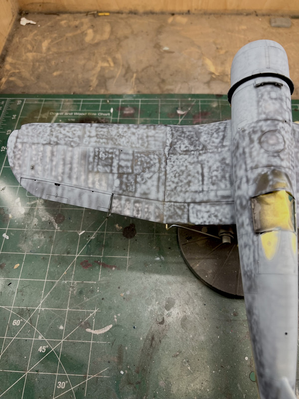

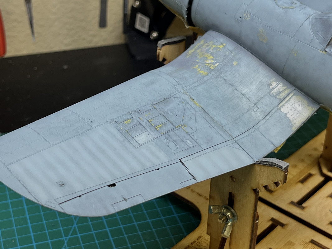

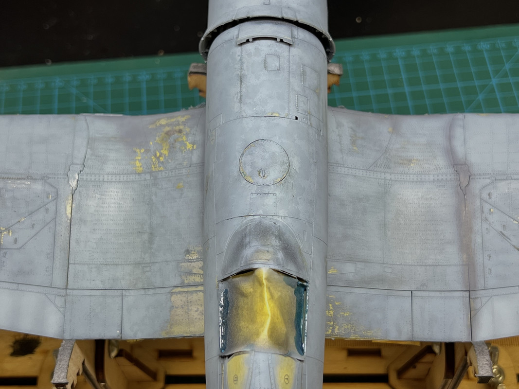

Bstarr3 Posted December 14, 2023 Author Posted December 14, 2023 Here's some paint on, and the results of the two-layer chipping. As I said, I'm using Mission Models paint for this project. It is finicky to work with, compared to "pour it out of the bottle" ease of MRP. But it's so great to be able to spray at my bench without a vent hood or mask. I have my spray booth, but don't have the external ventilation hooked up yet (planning to vent it into the attic here in the garage). When you get the thinning dialed in with their thinner and polymix additive, it really does spray nicely. It's just an added step that's sometimes a pain. On the upper surfaces, you can see where I did black basing, and used white instead of blue-gray for my marbling coat over the fabric areas. Then sprayed some lightened blue-gray over those panels as well. Chipped pretty extensively on the wing root area, especially on the port side. This Corsair is part of VMF-213 on Guadalcanal in July of '43. Although not as dire as things were in late 1942, this was still an austere airfield, and the planes were in a high rate of operational use, so things got dirty and weathered. Also at this point, the three tone camo was in effect, even though planes using the old two-tone camo were still being used. I have seen photos of planes - though not this one - touched up with whatever paint was available, so I used some artistic license and sprayed a little intermediate blue in a few high wear areas to indicate repair. I tried to mess with the Tamiya decals for a few seconds, before deciding to spray on the walkway lines and anti-skid. MikeMaben, ARay87, Landrotten Highlander and 16 others 19
