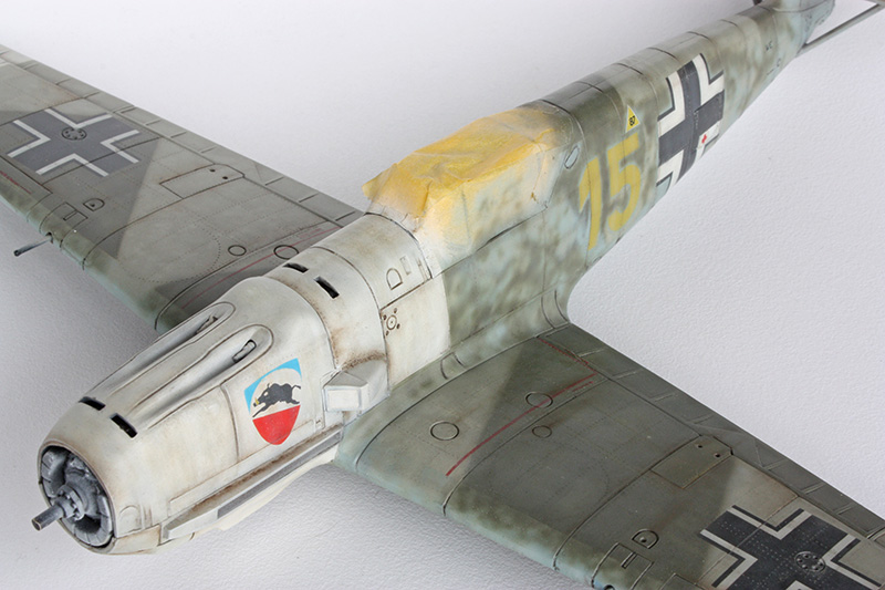

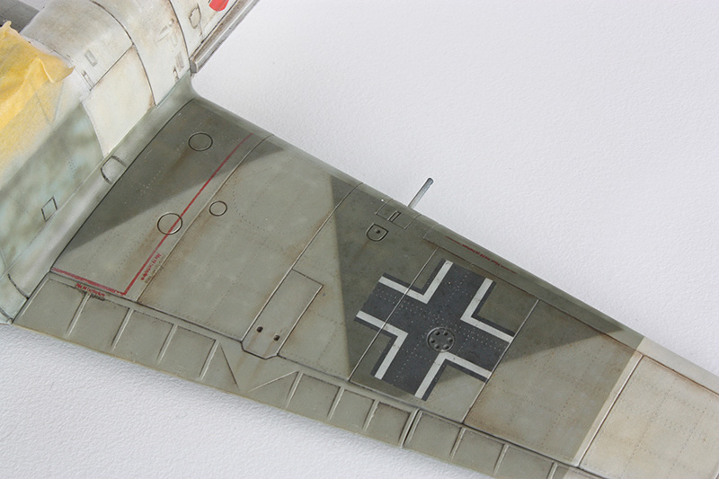

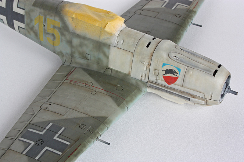

turbo Posted June 22, 2020 Author Posted June 22, 2020 Howdy folks, back with pics. Some staining and streaking and general grime on the upper side with oils and enamels. She's about ready for a flat coat now then the final layer of weathering and assembly. Thanks for stopping by! Paul in Napier, Landrotten Highlander, scvrobeson and 8 others 11
turbo Posted July 15, 2020 Author Posted July 15, 2020 Been busy the last few weekends and lost a bit of momentum with this one, so time to make a lunge for the finishing line. I applied a flat coat to seal the weathering so far and get the model towards its final finish. Despite washing the model with soapy water before flat coating, the next morning I was greeted by the dreaded salt re-crystallisation. It was even worse on the port wing where I was obviously slack in drying off the model after washing it. This is an occupational hazard of using the salt fading technique. I still don't quite understand why it happens, but fortunately there is a relatively simple fix. I moistened the affected areas with soapy water and gently buffed with a soft sponge to resolve the problem. Having averted that mini disaster, I proceeded to the next layer of weathering with some chipping using a silver prismacolor pencil. I still have some other parts of the airframe to do with a darker shade, The prop blades were painted black by the original owner, so these were stripped and repainted RLM 70 and weathered by salt fading and sponge chipping. I've found this is a good combination for weathering props and I'm fairly happy with how it's turned out. Into the home straight now - just exhausts, some final weathering bits and pieces, and final assemby and she'll be done. Thanks for stopping by! TAG, Trak-Tor, MikeMaben and 9 others 12
