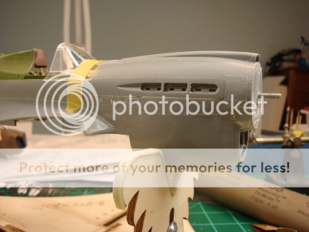

More updates.
This past weekend was spent mostly sanding, filling, and more sanding. YUCK. But, its in integral part (to me anyway) of any really good build so it just took awhile before I was happy. Still not 100% there but this kits is a GEM, and the fit is really good actually, so im just making sure I do it justice.
Got all of the misc engine and cowl pieces that Hasegawa includes glued on. The fit is these eshaust and other panels was EXCELLENT and only took just a minor bit of finishing to bring them round to the contour of the rest of the fuse. STILL a bit more sanding work to be done here for sure, but fit is still excellent.
Mounted, glued and weathered the rear pinched area behind the pilot. I also dipped the rear cover pieces over this area in Future and primed the gap in the fuse, but I really dint think that stuff was really photography worthy.

Next I set in with the filling, then sanding, then filling again. This area under the spinner probably needed the most attention as it had the intersection of points lining up with the tri-sected interior of the air inlet.
After some minor work, the contours started coming around. The fit of the spinner is great, an is just resting on here
More sanding, then Mr Surfacer 500, then more sanding
Finally after some Mr Surfacer 1000, more sanding I ended up with this
I still have much more fine tuning to do on some joints but I have test fit the wings and they are great as well.
