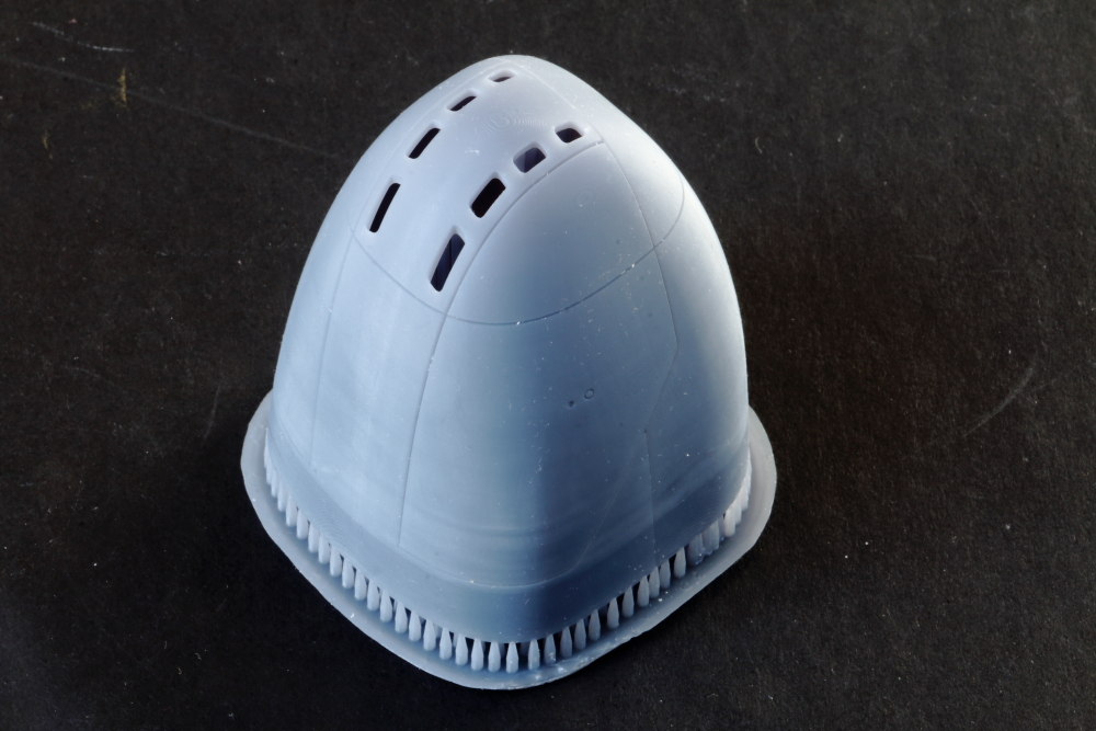

Nose print - this is was designed in 1:48 to correct the nose on the ICM kit.
48b427_632a80b43d72435faf09246e1073353c~
it's an easy job to scale 150% to get to 1:32...
48b427_35f24304f18d4effbf2e85a9214df011~
Bearing in mind the cross section is designed to match the ICM kit - but it was based on measurements taken from a real nose - and has to be a reasonably close starting point.
We'll come back to that shortly...
My thanks to @Rob Colvin for the heads-up in the 3D Printing section, as it was his post that re-ignited some enthusiasm.
STL file is available here: https://cults3d.com/en/3d-model/game/1-48-invader-8-gun-nose-correction-set
