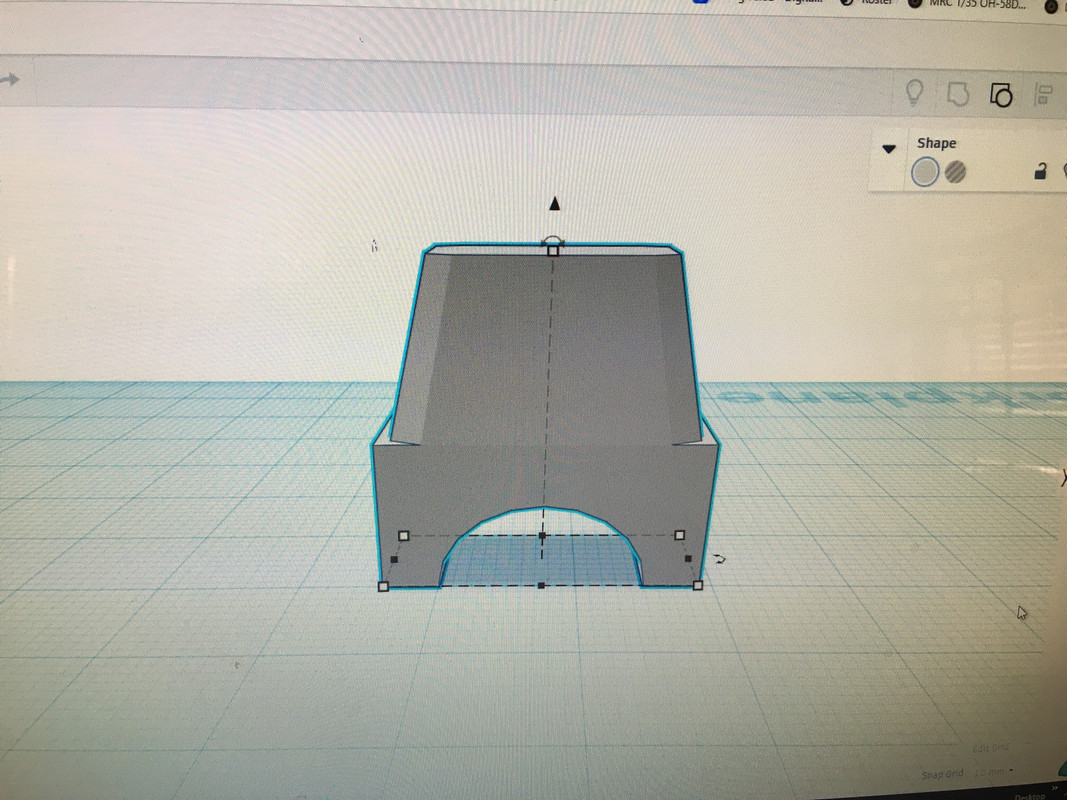

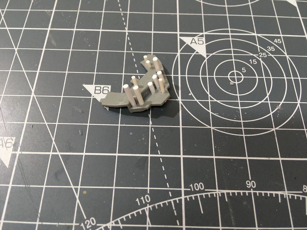

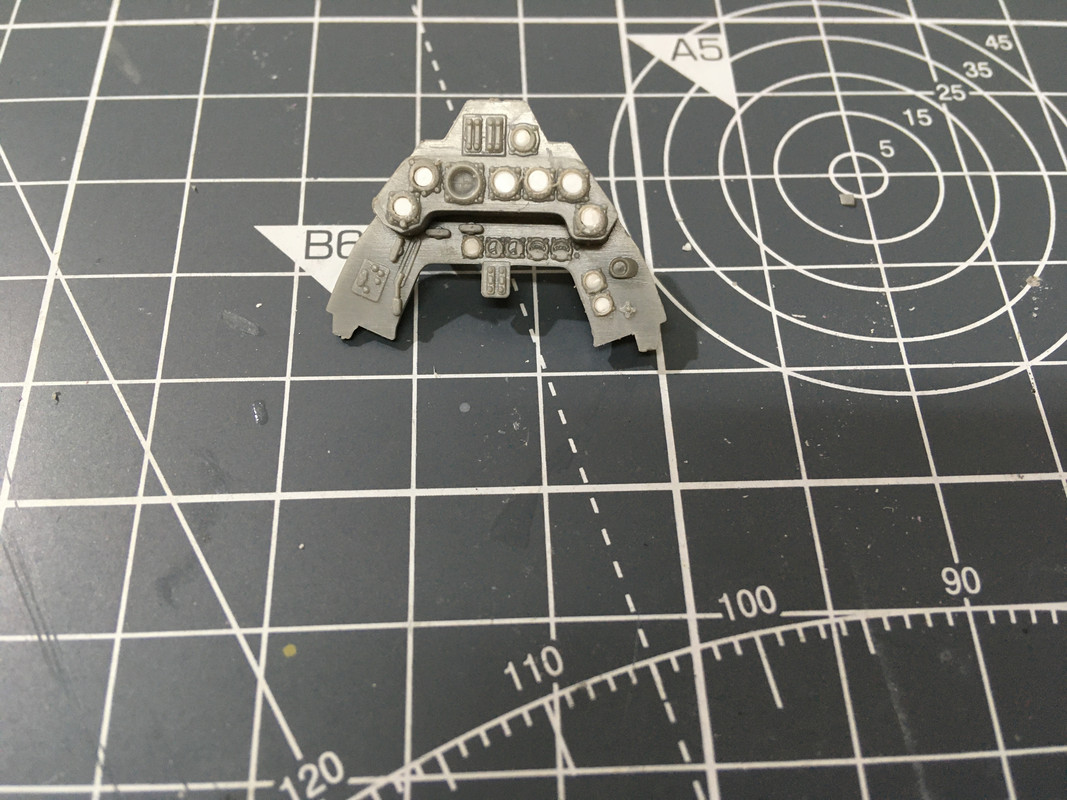

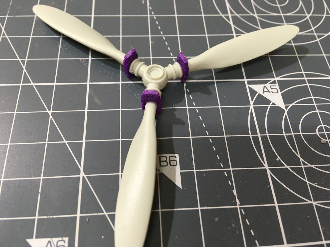

Cheetah11 Posted January 5, 2020 Author Posted January 5, 2020 I decided too try and fit the Hasegawa IP. Dials drilled out and filled. I will make a copy tomorrow. The subject I want to do has propeller weights fitted. In the mean time, while waiting for the glue of the IP to dry I designed propeller weights on Tinkercad and printed them. I could only find a fuzzy picture and used the relative size from the prop blade to get an approx size for the weights. Enjoy Nick Azgaron, Landrotten Highlander, JefH and 6 others 9

Ralph-D Posted January 6, 2020 Posted January 6, 2020 Nice project. have a look on the link for Propeller weights image for the Fw190 Propeller & weights Cheers Ralph Gazzas and Cheetah11 1 1
Cheetah11 Posted January 6, 2020 Author Posted January 6, 2020 5 hours ago, Ralph-D said: Nice project. have a look on the link for Propeller weights image for the Fw190 Propeller & weights Cheers Ralph Thanks Ralph It looks like I need to round the edges a little more. Nick

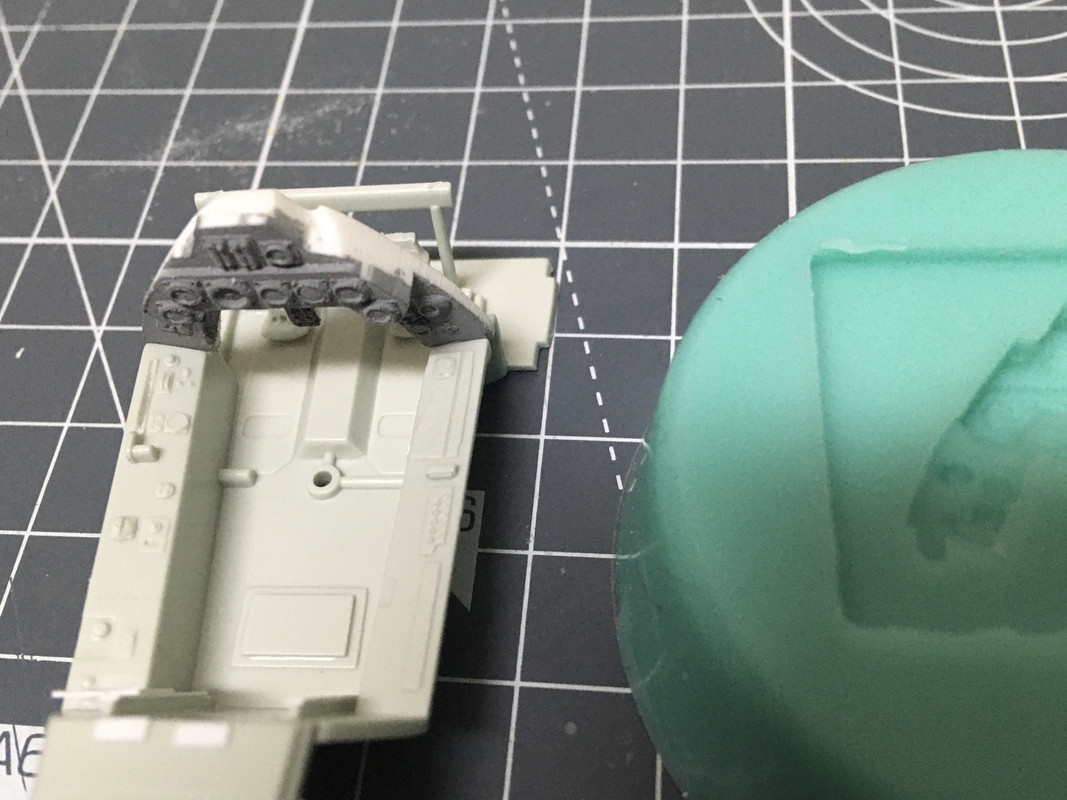

Cheetah11 Posted January 7, 2020 Author Posted January 7, 2020 (edited) I copied the Hasegawa IP and trimmed it a bit to fit the Revell cockpit Worked surprisingly well. Now just for painting and a bit more detail. Enjoy Nick Edited January 7, 2020 by Cheetah11 TorbenD, Alain Gadbois, JefH and 9 others 12
Gazzas Posted January 8, 2020 Posted January 8, 2020 The FW Really cheats ya when it comes to showing your IP once the kit is finished... unfortunately. But keep up the great work!
Cheetah11 Posted January 8, 2020 Author Posted January 8, 2020 3 hours ago, Gazzas said: The FW Really cheats ya when it comes to showing your IP once the kit is finished... unfortunately. But keep up the great work! Hi Gazzas Yep, not much will be seen after the cockpit is in the fuselage, but I have an ulterior motive. I have 4 Hasegawa kits in the stash and can now use instrument decals for them as well. I also need to practice for my 1/24 Trumpeter Fw 190 D as I would need to do as least the IP from scratch. Nick Gazzas 1
