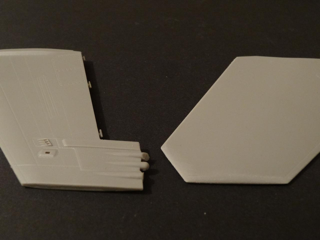

hpetiers Posted April 29, 2019 Author Posted April 29, 2019 (edited) hi gentlemen., thanks for the encouragement. By the way the sawing into the fuselage turned out not as bloody as it looked, the whole construction was quite stiff so it was easily put together again. So all in all not undoable corrections, but most of them quite unnecessary really! Speaking of unnecessary corrections, did some work on the model after the Easter holidays when I stumbled on the shape of the stabilizers. top one is in the right position, with hole and locator pin aligned. Bottom one is aligned, based on the curved shapes of the stabilizer and fuselage. This way the whole stabilizer is at least 5 mm too far to the front! Other way around: mount the stab as indicated by Revell and you end up with a huge gap which must not be there...sigh! Looking at photo's I can only conclude that te fuselage shape is not correct here. Nope not going to correct that! Thinking about adding some strip to the stab, let's see. btw see where I indicated with a cross where I will add a plastic bar to hold the plane in the air, like it is doing a deck landing with landing gear and tail hook lowered. I do not trust that all-plastic landing gear for one centimeter! Yet another one: the tips of the tails and of the stabs are not sharp, but end like they have been cut off. Stabilizer has been sanded sharper in the photo, tail is still blunt. Come on Revell, this kind of inaccuracies is really unnecessary! And yes I am still enjoying this build! Edited April 29, 2019 by hpetiers LSP_Kevin, Trak-Tor, Starfighter and 5 others 8

1to1scale Posted April 30, 2019 Posted April 30, 2019 5 hours ago, hpetiers said: hi gentlemen., thanks for the encouragement. By the way the sawing into the fuselage turned out not as bloody as it looked, the whole construction was quite stiff so it was easily put together again. So all in all not undoable corrections, but most of them quite unnecessary really! Speaking of unnecessary corrections, did some work on the model after the Easter holidays when I stumbled on the shape of the stabilizers. top one is in the right position, with hole and locator pin aligned. Bottom one is aligned, based on the curved shapes of the stabilizer and fuselage. This way the whole stabilizer is at least 5 mm too far to the front! Other way around: mount the stab as indicated by Revell and you end up with a huge gap which must not be there...sigh! Looking at photo's I can only conclude that te fuselage shape is not correct here. Nope not going to correct that! Thinking about adding some strip to the stab, let's see. btw see where I indicated with a cross where I will add a plastic bar to hold the plane in the air, like it is doing a deck landing with landing gear and tail hook lowered. I do not trust that all-plastic landing gear for one centimeter! Yet another one: the tips of the tails and of the stabs are not sharp, but end like they have been cut off. Stabilizer has been sanded sharper in the photo, tail is still blunt. Come on Revell, this kind of inaccuracies is really unnecessary! And yes I am still enjoying this build! So, let me ask you this question, if you could go back to day one, would you choose this kit or the trumpeter? If they both were equal cost and both sitting there for you to chose one?

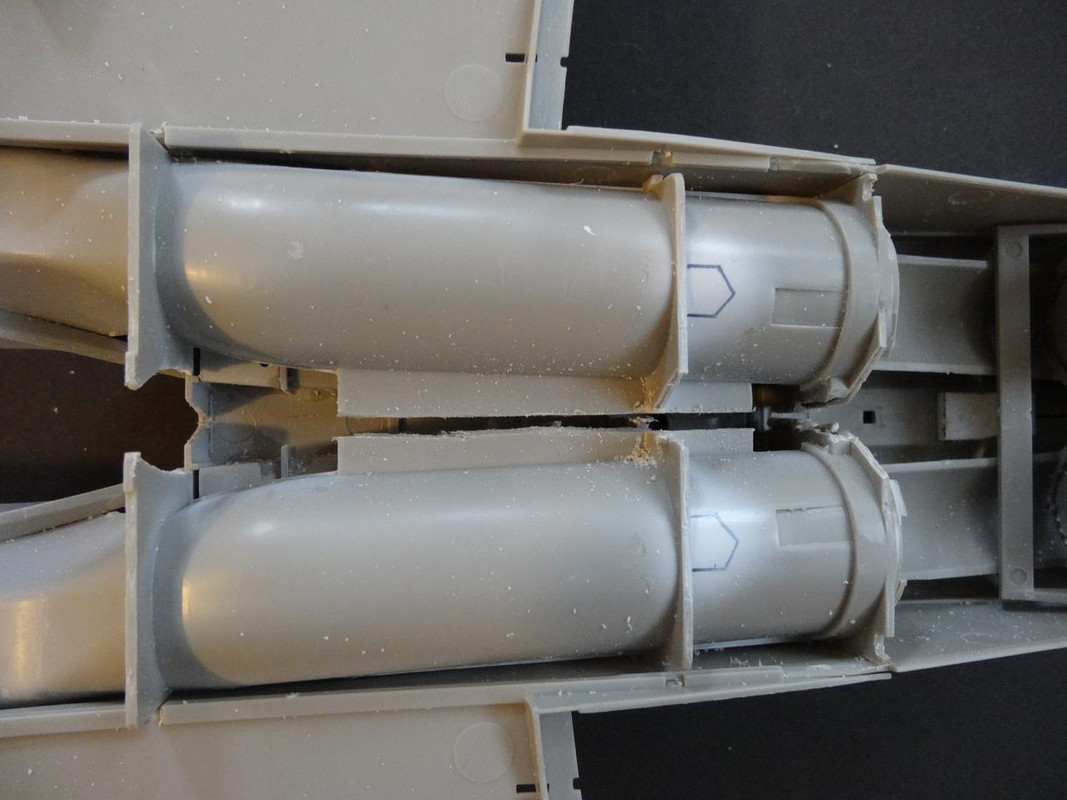

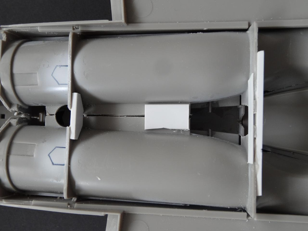

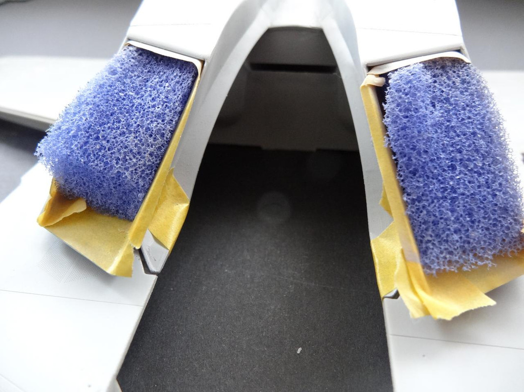

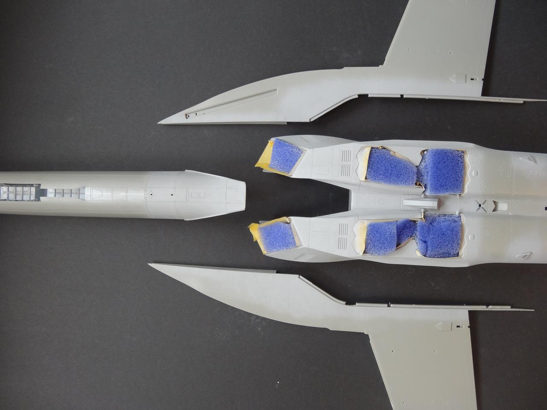

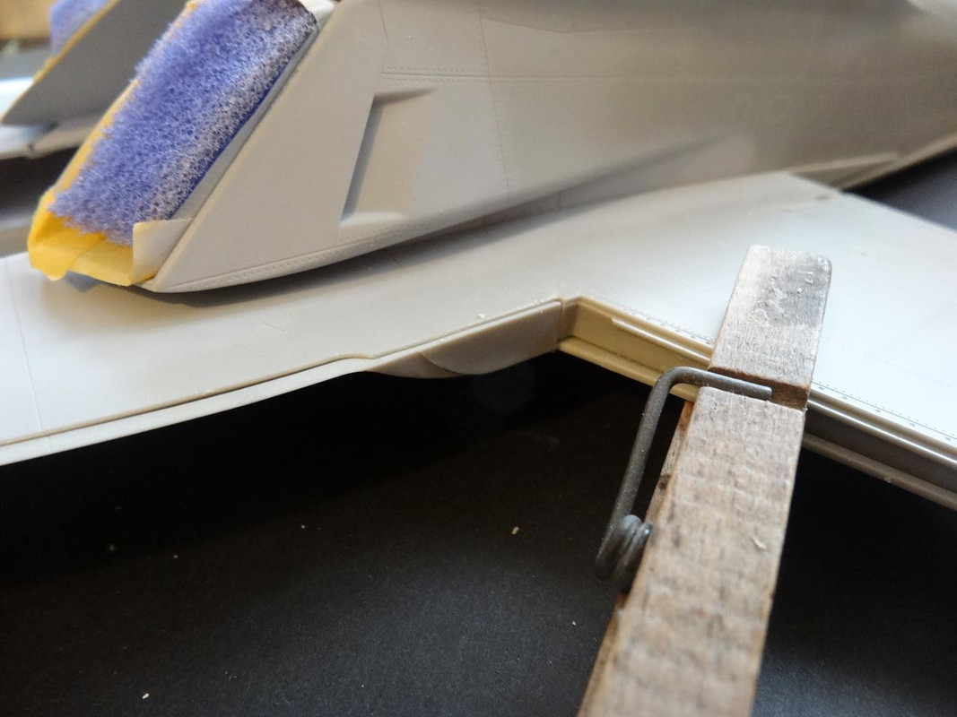

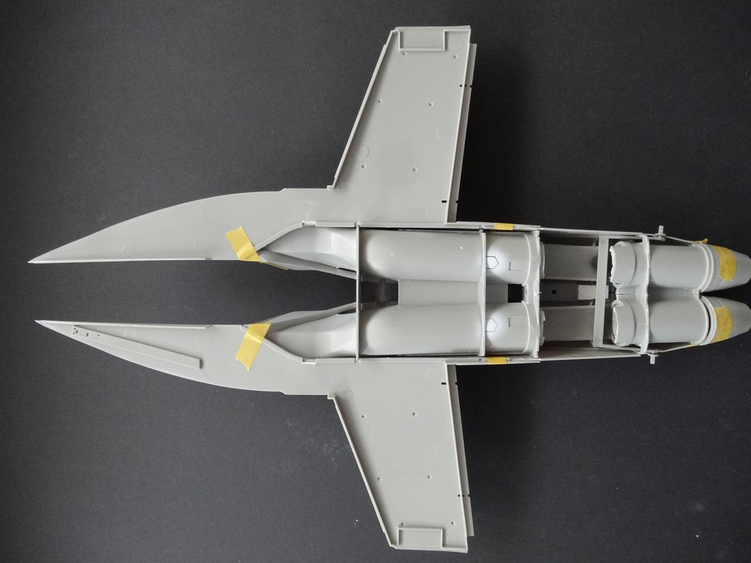

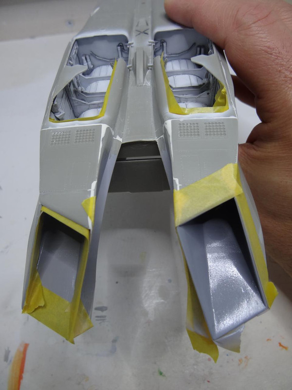

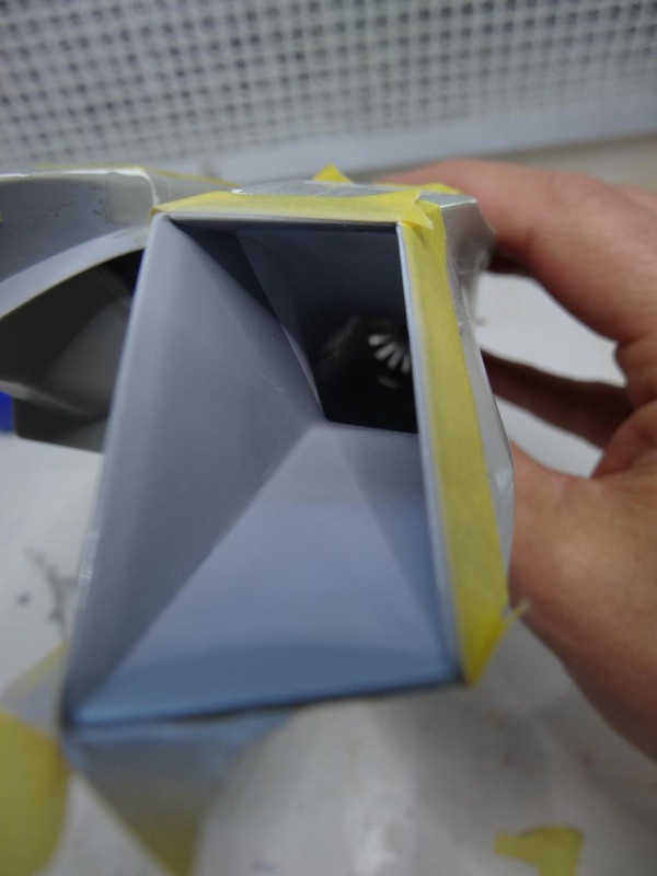

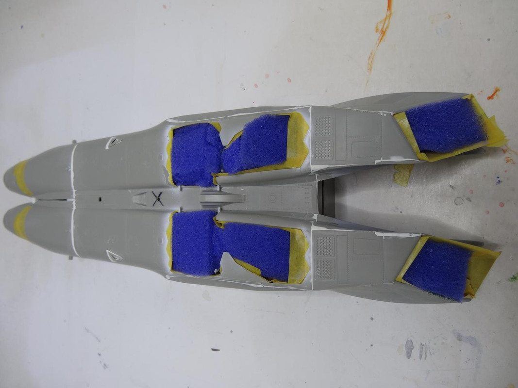

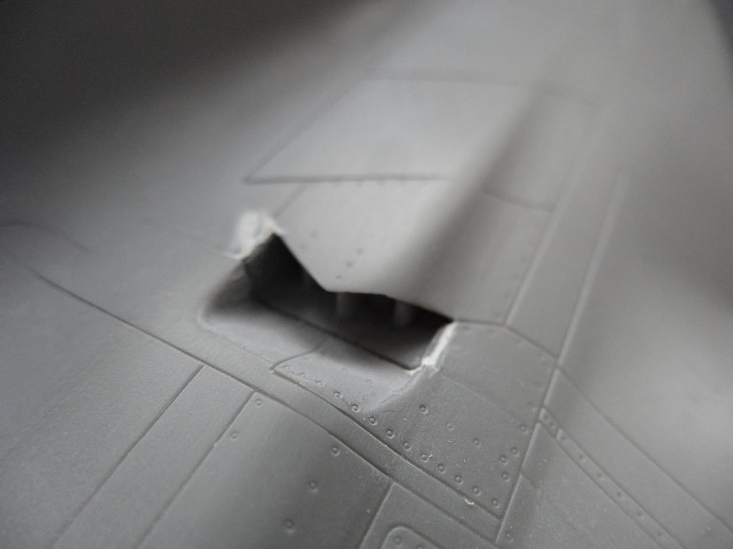

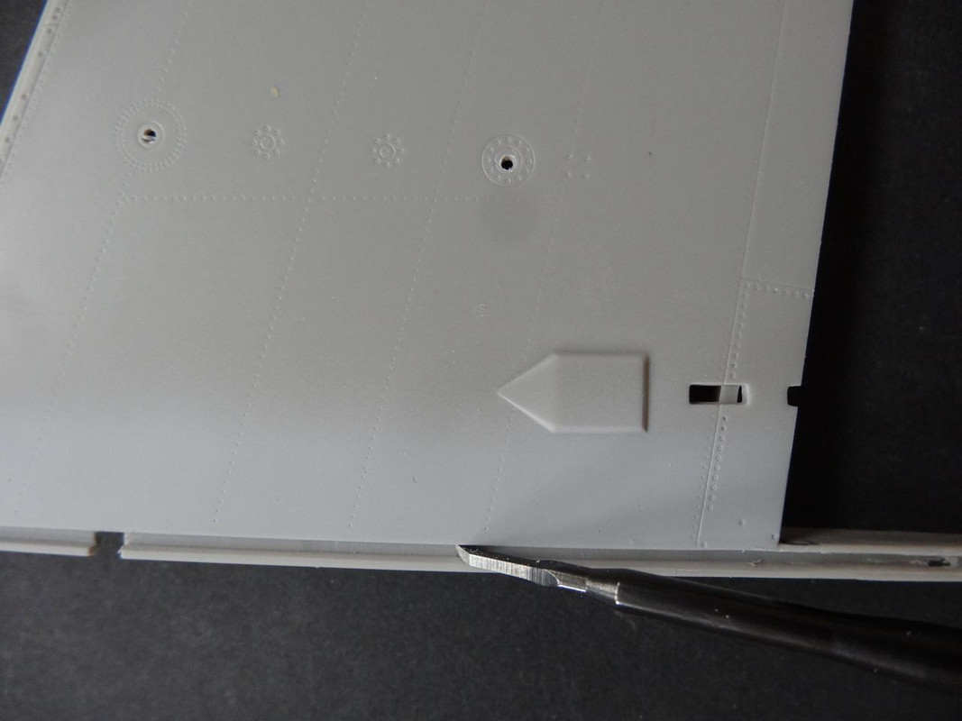

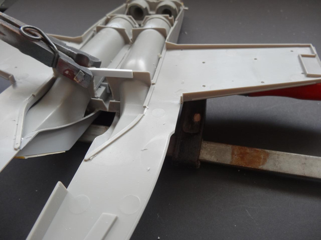

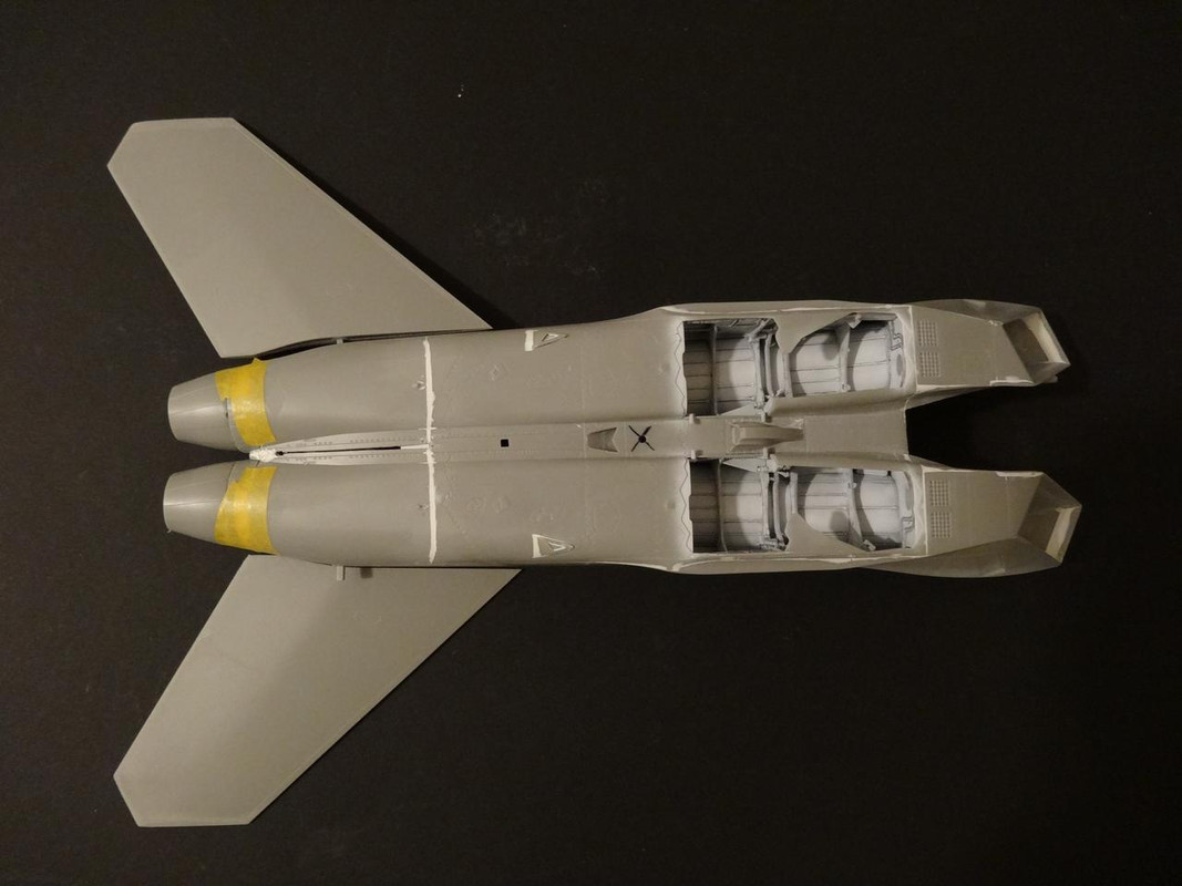

hpetiers Posted May 5, 2019 Author Posted May 5, 2019 today I completed a bit of a milestone: finished the intakes so that the fuselage can be built up further. I have no idea how one would be able to paint the intakes after they have been assembled. all seams filled! after the paint has dried, I masked the intakes and the wheel bays: like dmthamade already posted, also here I had to scrape the lower wing gutters wider with a chisel: so these are the parts that need to go together, I have primed the surfaces that will be closed in later: mounted the splitter plates of the LERX separately from the lower wing, this eases cleanup considerably: and then, with sweaty hands, mounted the lower wings to the fuselage: also here the parts need to lign up where the wings and the intakes meet: blackbetty, dmthamade, johncrow and 11 others 14

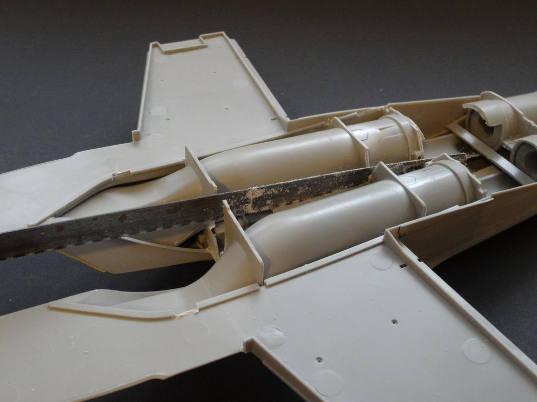

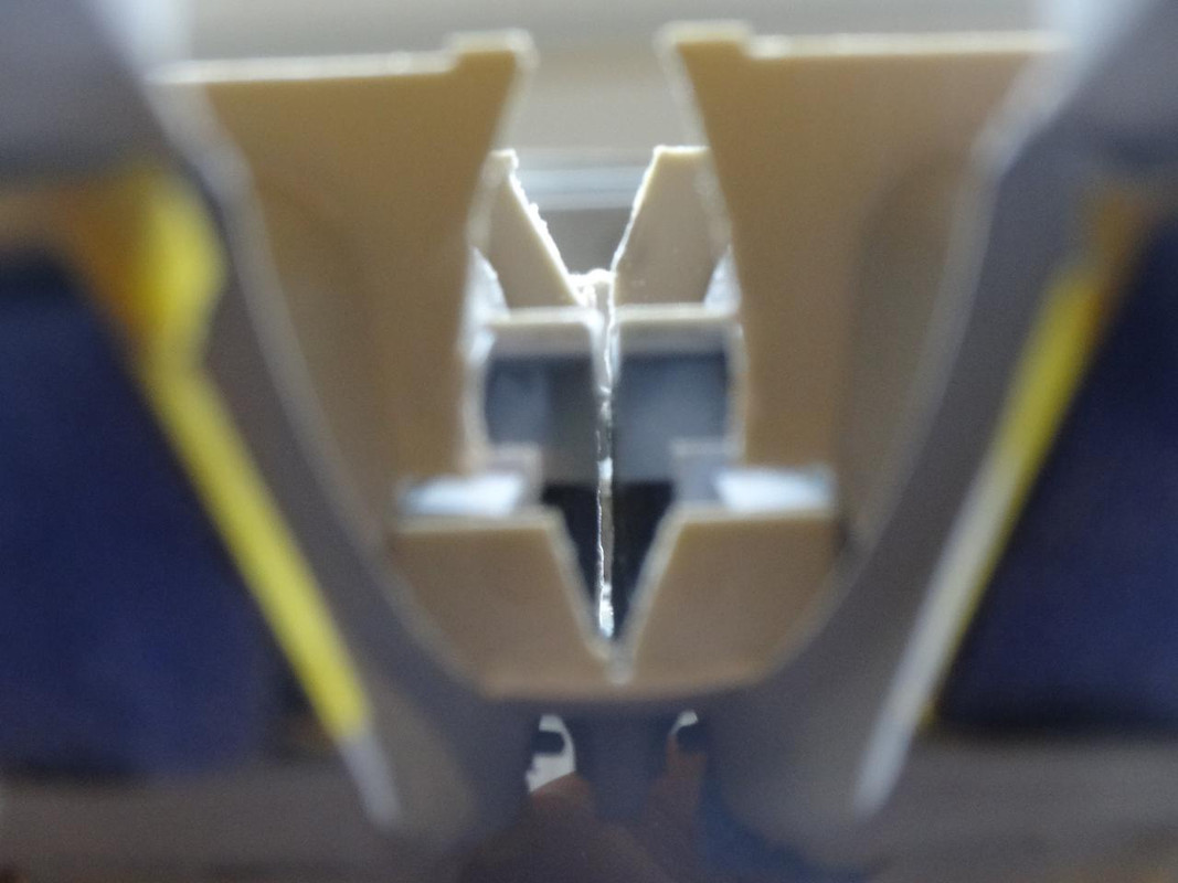

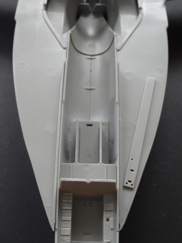

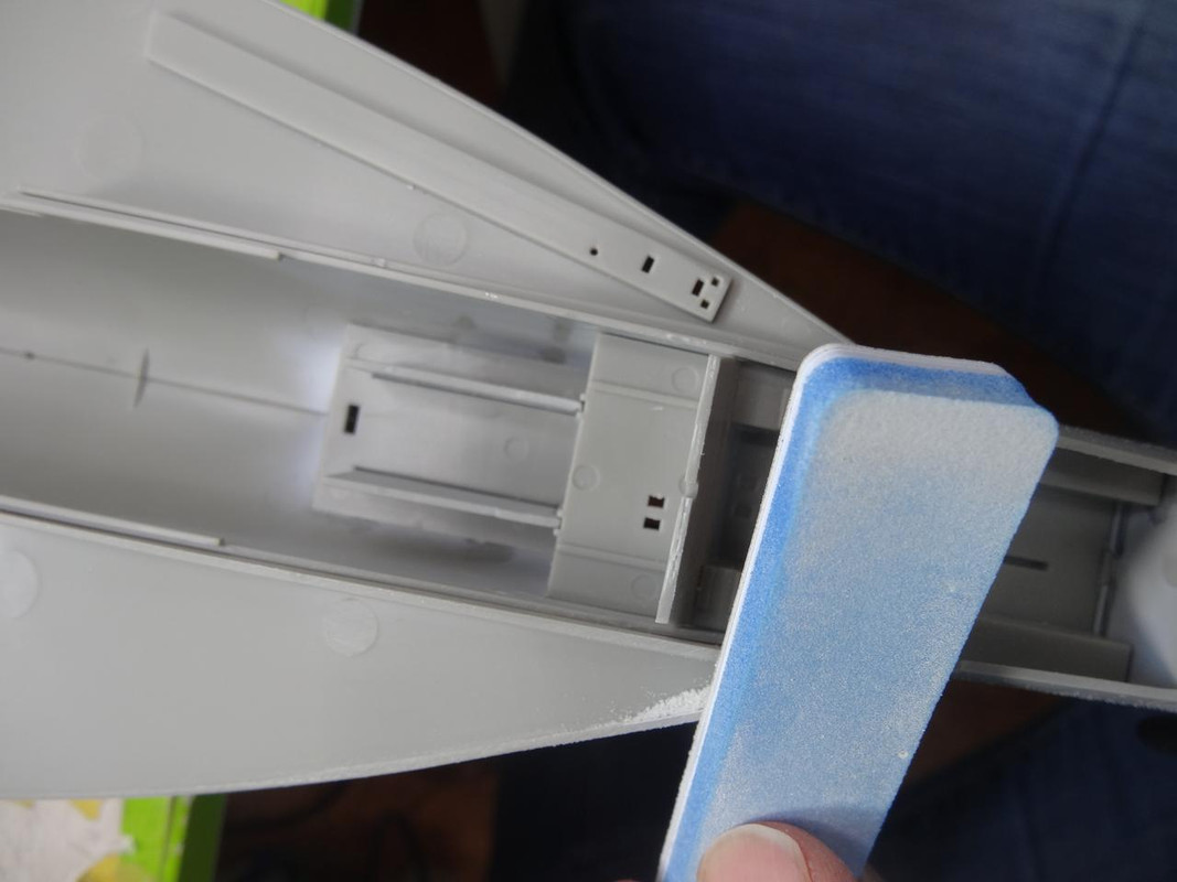

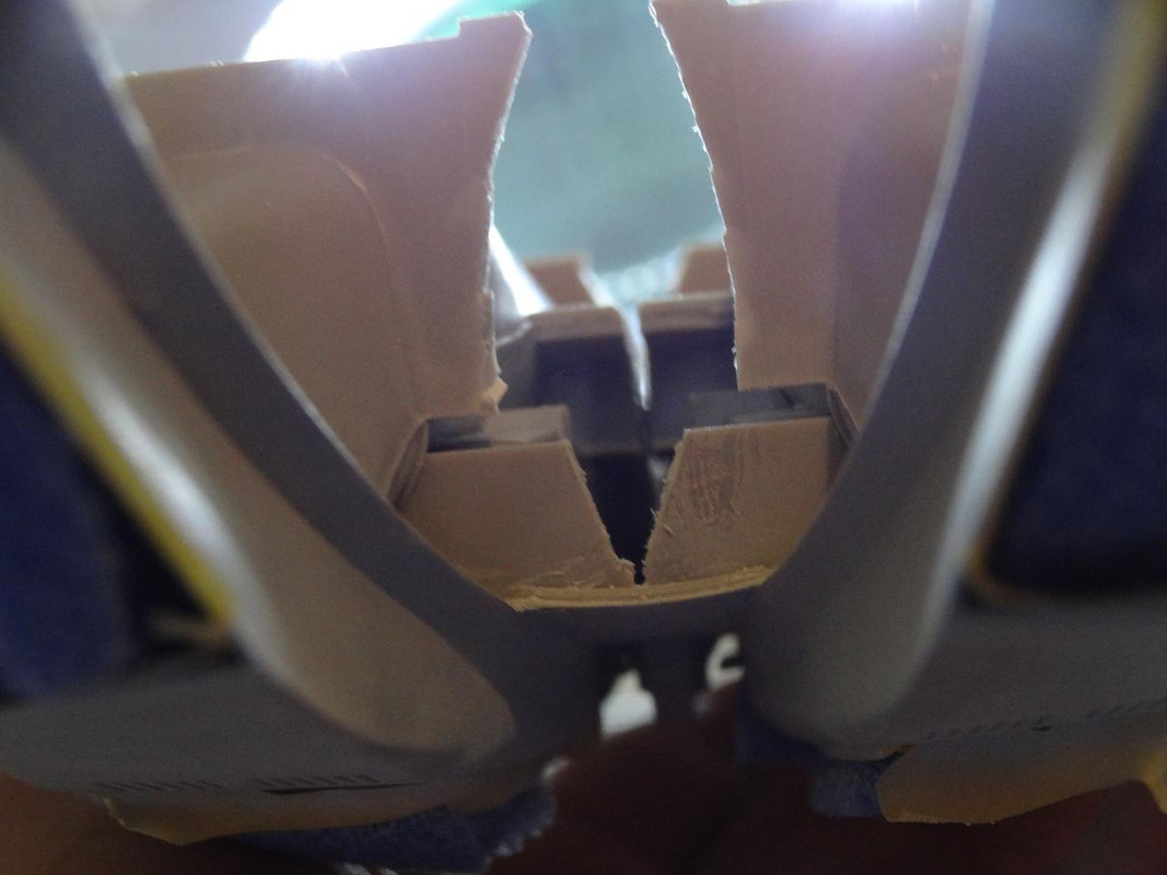

hpetiers Posted May 9, 2019 Author Posted May 9, 2019 (edited) hi Chris, that is why I think a forum like this is so useful: no need to go through the same learning curve if you can share tips. thanks for your encouragenemt! hi Don, I am not sure but like you (i think) I have the Afterburner Decals set for the Tomcatters and the Gunslingers. the Tomcatters were a nobrainer until I realized that there is no decals for the lining on the fuel tank. Luckily I can still go on for a while until I need to make up my mind. I am quite sure you also experienced some fit issues for the forward and upper fuselage. If you fit the upper part on the lower one, and try to align 1 wing root... ...then you end up with an upper fuselage around 2 mm too narrow: of course you can pull the upper part outward, but then the part gets quite a bit distorted. On top of that you will note that between the forward fuselage and the LERX extensions there will be quite a gap. I came to the conclusion that the lower fuselage is 2 mm too wide...Now what? You guessed it: out comes the saw again! basically cut the whole inner structure in half to make the assembly flexible enough to push inward. then after pushing the top inwards, I strengthened the whole with a styrene strip: after which I decided to mount the forward fuselage. see here no gap! no gap between the inlets anymore: also strengthened the rest and added a hole for my stand: after a considerable amount of sanding the lower LERX part to make it fit: now the upper and lower parts fit without stress: and can be glued together make sure that the LERX lower surface lines up with the upper surface of the lower fuselage: now the upper fuselage can be mounted....thought for some time I might not get away with this, but it looks like I did! Edited May 21, 2019 by hpetiers LSP_Kevin, Derek B, blackbetty and 7 others 10
