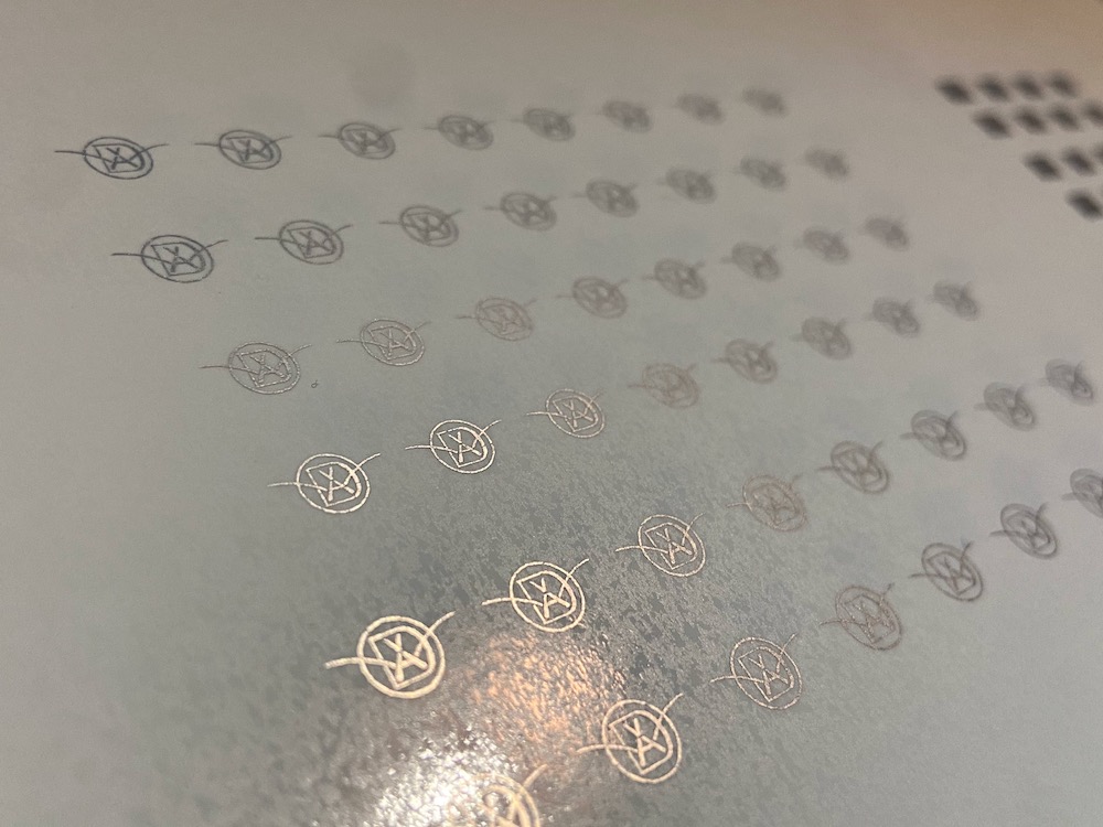

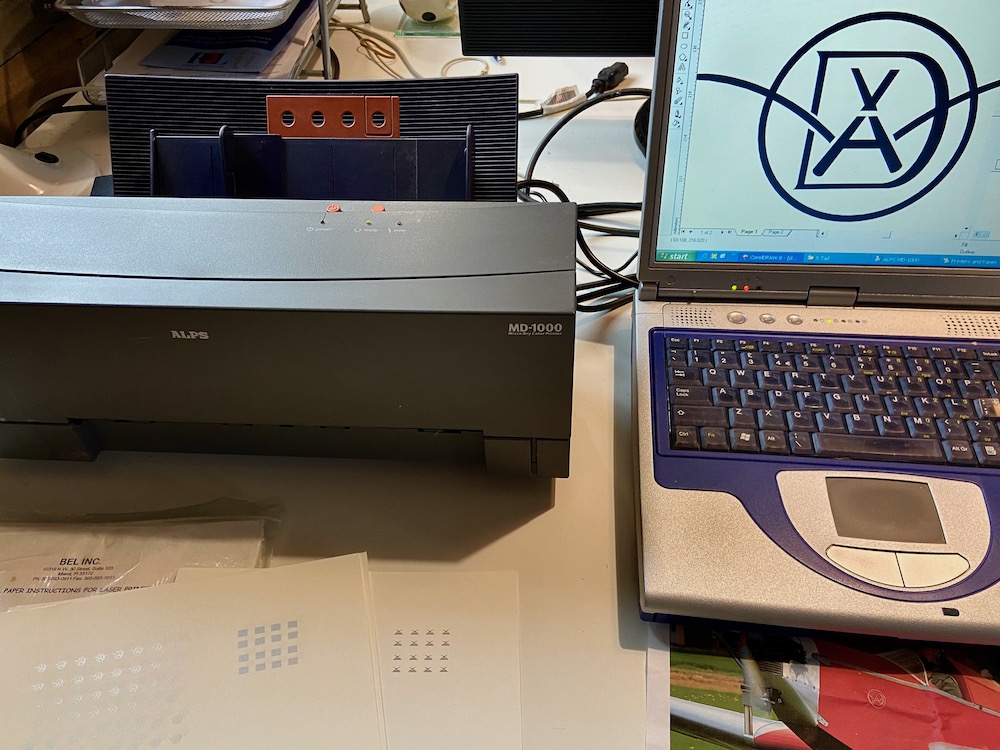

Iain Posted March 25, 2024 Author Posted March 25, 2024 Time for some 'sticker' design... Needed to create the Dart Aircraft Company logo - in silver - to go either side of the nose as a decal. This would have been too fine for a stencil. A suitable oblique image of the logo was dragged into CorelDRAW and used to draw up the logo as a piece of vector art. This was then transferred to the positively ancient laptop (20 years old?) running Windows XP - anything newer is not supported by the ALPS Printer software! The ALPS MD-1000 I've had for a long time. For those that haven't come across them, they are a thermal wax printer that can print directly onto decal paper. But the *real* plus is that they can print white, gold and, in this case, silver! Being so old it's a bit of a lottery - and a bit fiddly to get everything working together - but at lunch time today I managed to run off the following - both the Dart Logos - and some 'Air League of the British Empire' stickers for the rudder: So - next up a coat of Gloss over the airframe and we can add them. Back soon! Iain denders, MikeC, thierry laurent and 8 others 11
