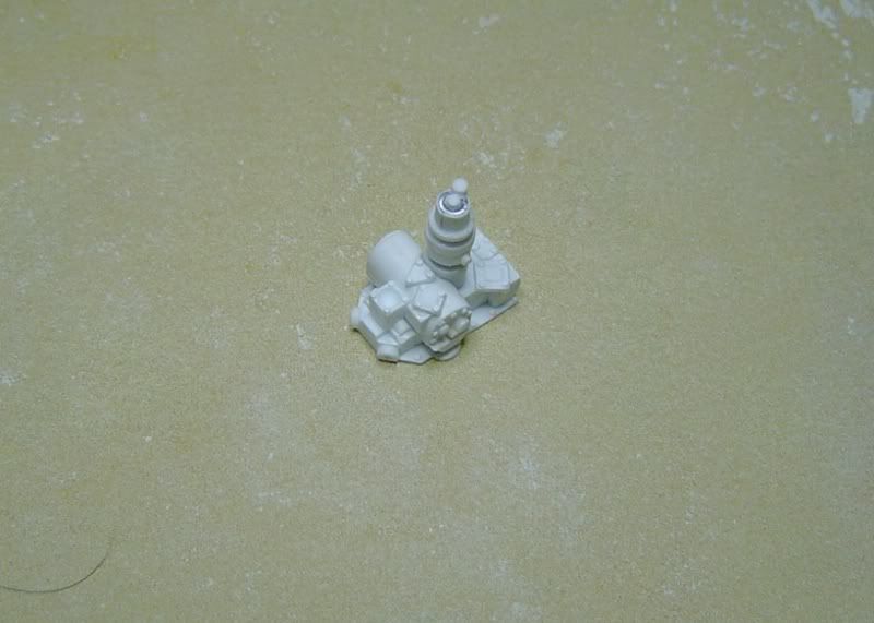

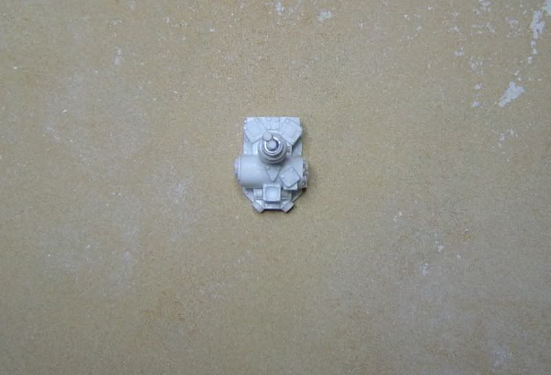

Here are 2 pic I purpusly shot.
It is not a good idea to have 2 prints into a single piece of paste but that was just to show you guys.
If you can see any small problem here, they will definatly show on the casted parts.
If you see nothing, you have a chance that it will be OK but the Play-doh paste is much more forgiving than the silicon...
This is the end for today, talk to you soon!
