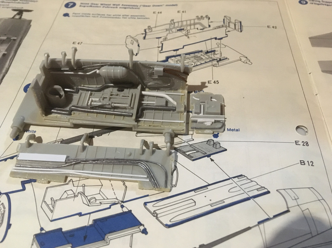

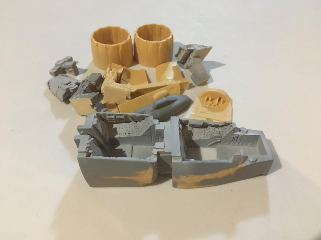

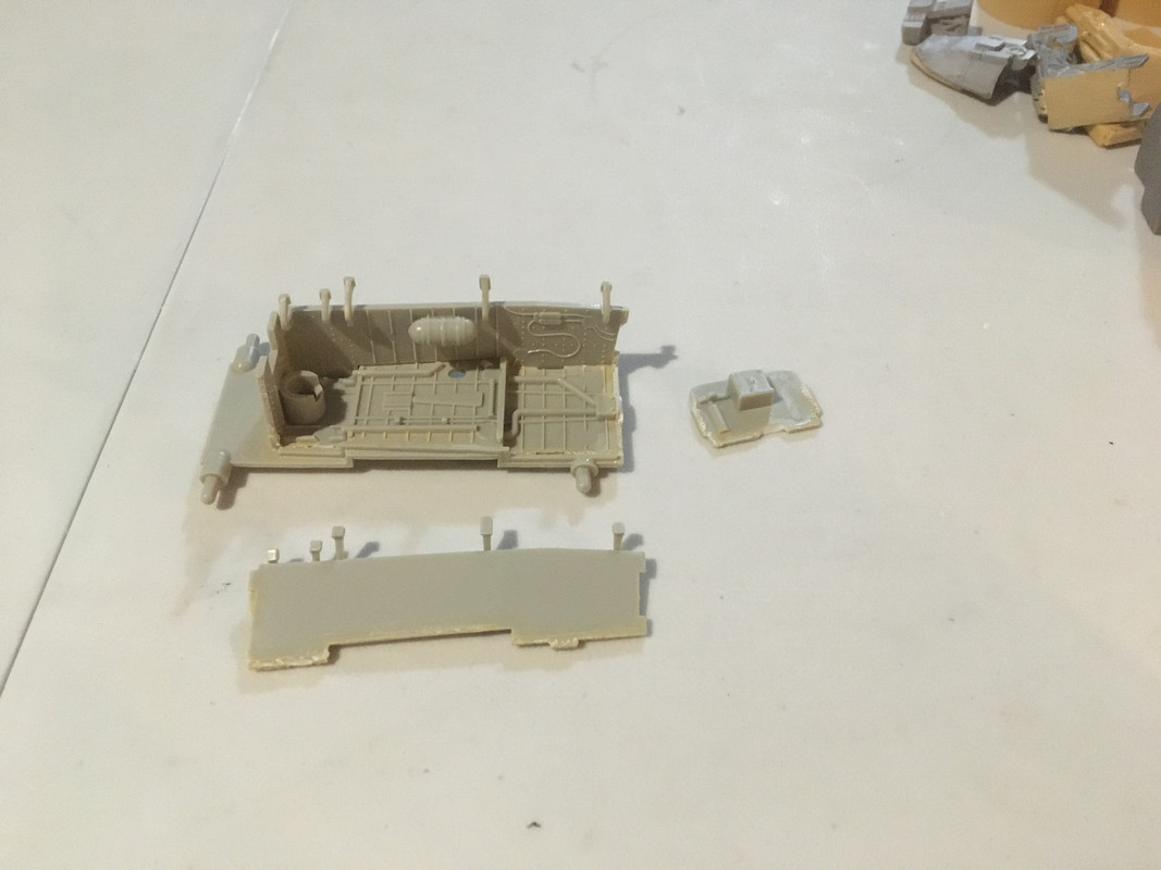

Cheetah11 Posted September 25, 2023 Author Posted September 25, 2023 Thanks for the interest gents. I intended to build an F-14D from this kit and was given an old D conversion by a fellow modeler. To do this I has to build the forward wheel bay as the conversion cockpit was not a drop in fit. Time now to de-construct the wheel bay and later in the week onto the cockpit. As you can see the Tamiya kit wheel bay is sparsely detailed and many pipes and tubes are not round. To improve the look and make it a bit more interesting I replaced some details. Unfortunately my only reference on this, the Squadron Signal Walk Around only has 4 pages on this, but at least better than nothing. More next week Nick Landrotten Highlander, themongoose, Loic and 11 others 14

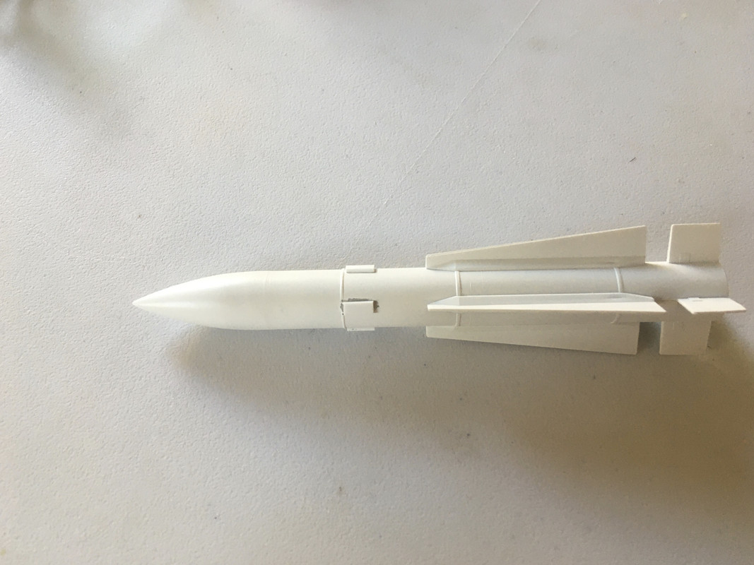

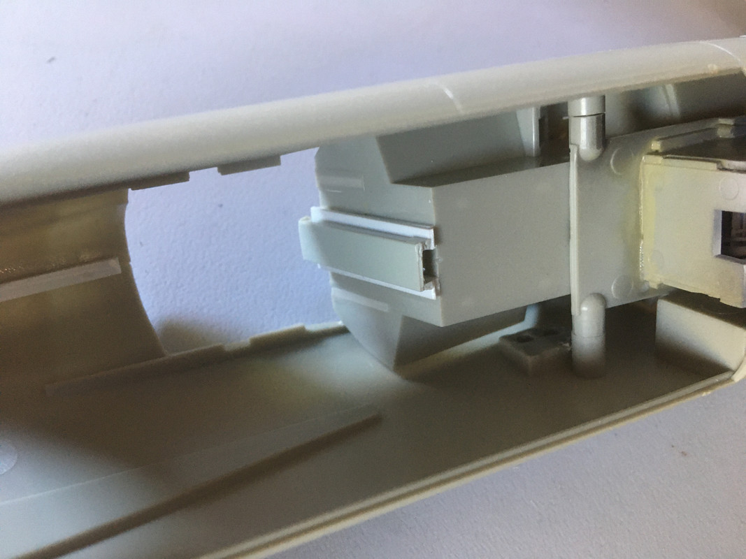

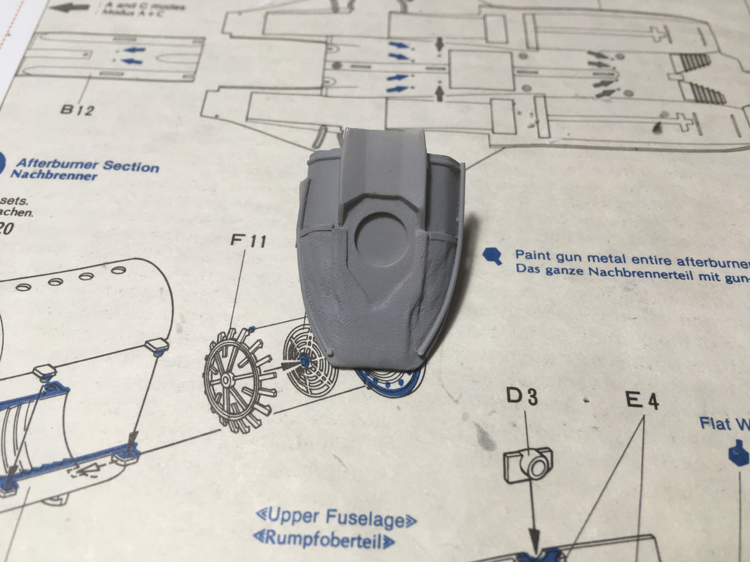

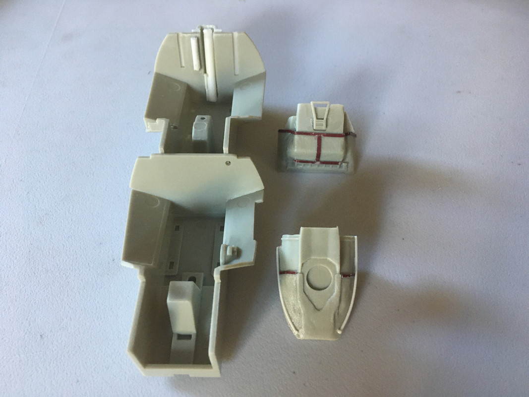

Cheetah11 Posted October 1, 2023 Author Posted October 1, 2023 (edited) Not too much done over the week. The "Honey Do" list was quite long. I did manage some cockpit work and looked at the armament. A hydraulic jack for opening the canopy was added to the rear bulkhead. I also added some detail to the instrument panel covers. The Iranian aircraft seem to keep the original config as depicted in the Tamiya kit, so not much addition was needed. I also found this at the LHS. AIM-9J missiles were impossible to find in any kit prior to Eduard and Reskit released them. The LAU-7 launchers in the kit are a little short and not detailed at all. I will replace them with ones from the Trumpeter F-8. I will use the AIM-54A from the kit but will add the radar fuses to the sides. This is before final sanding down. Trouble in Paradise. I was reflecting on the near perfect fit of this old kit when I noticed the gap between the sides of the rear cockpit and the fuselage sides, I will see which is the best way to fix this. Till next week. Cheers Nick Edited October 1, 2023 by Cheetah11 Telepatu, R Palimaka, Martinnfb and 12 others 15

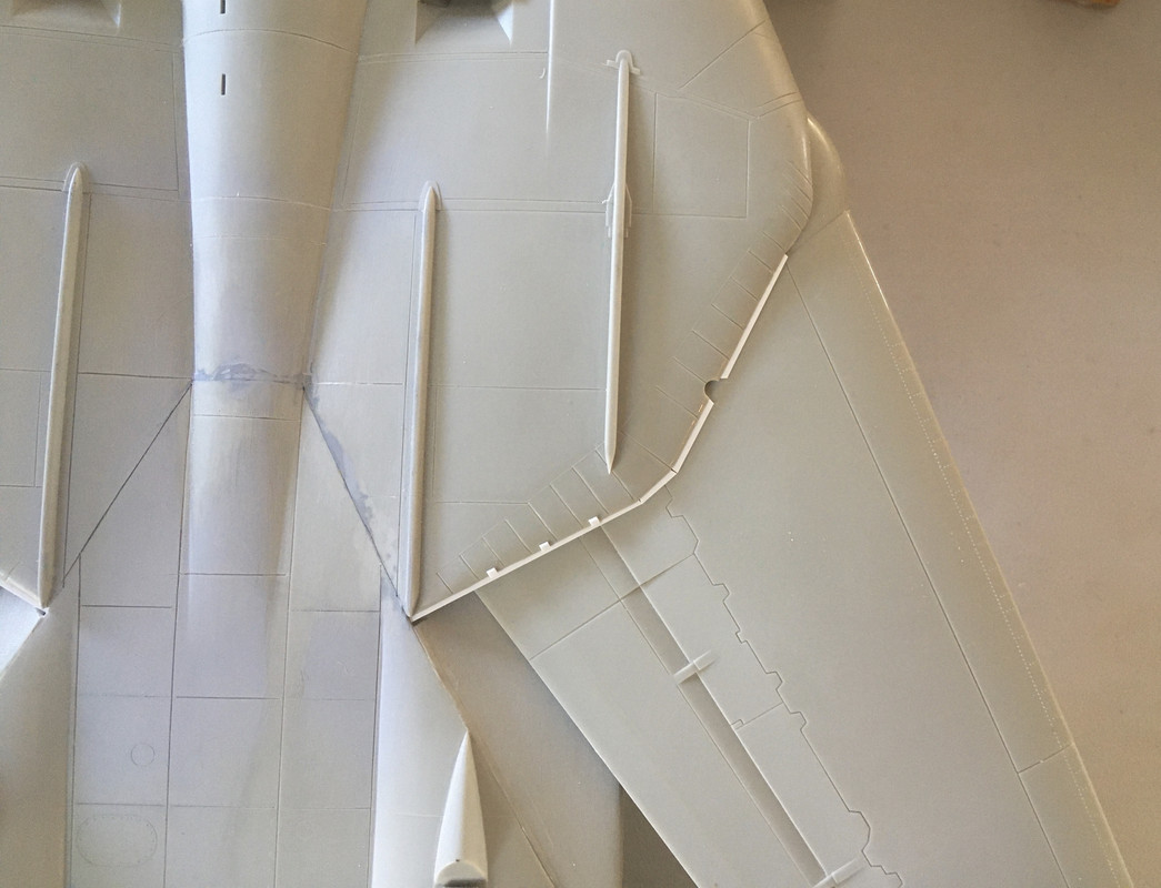

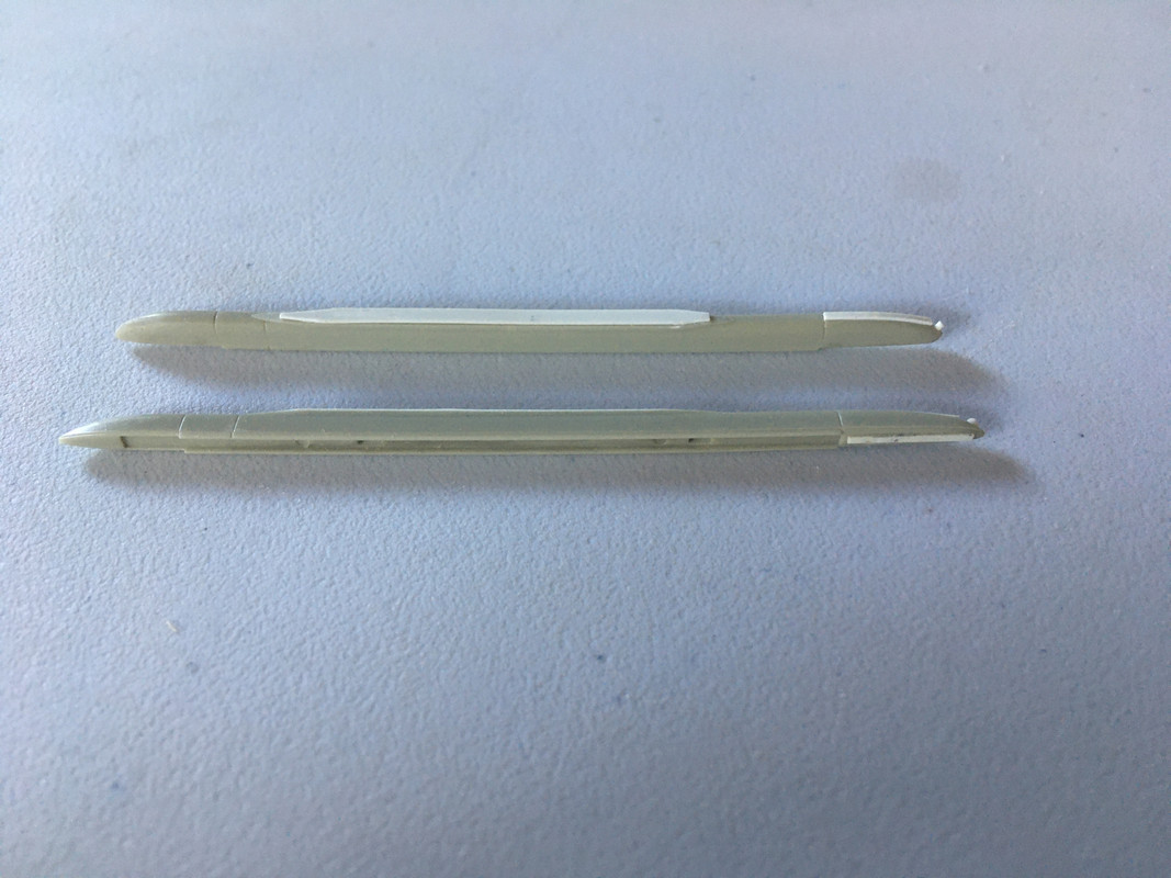

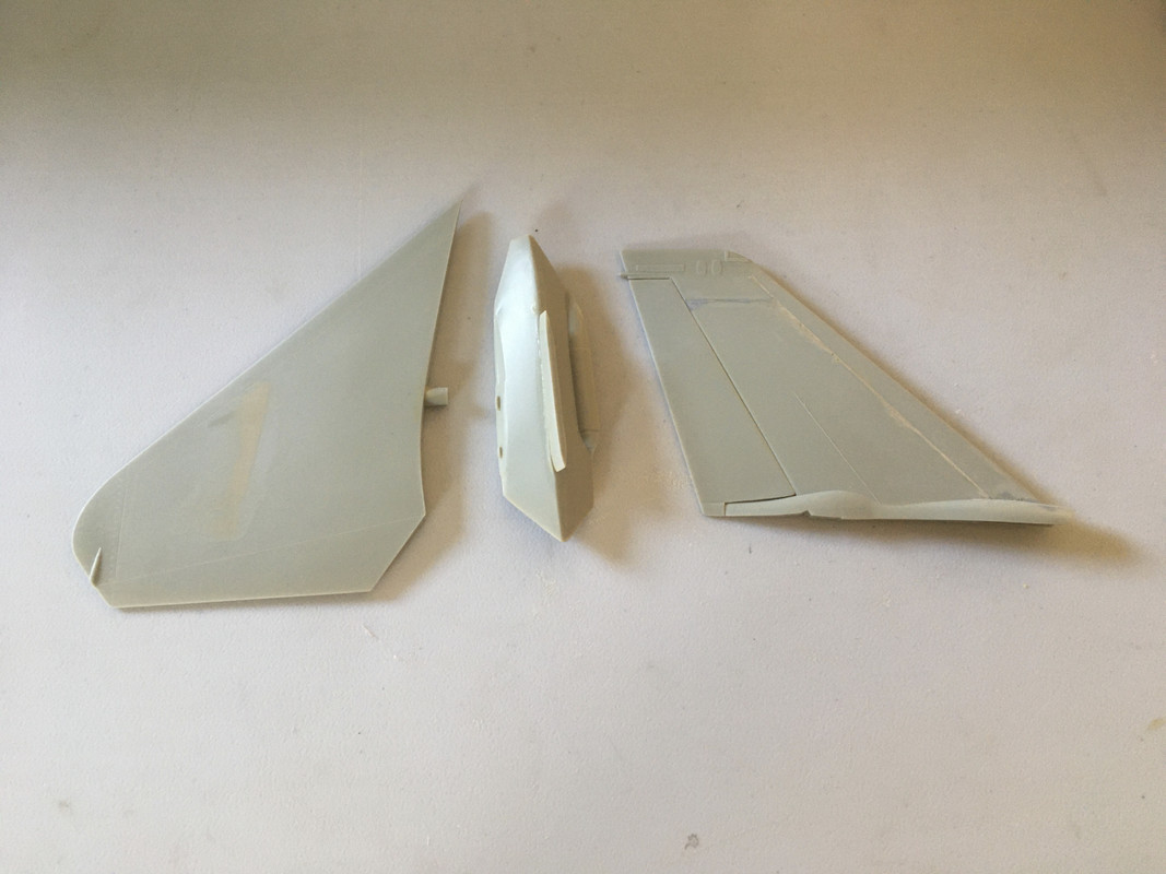

Cheetah11 Posted October 6, 2023 Author Posted October 6, 2023 A bit of basic improvement to the kit. The glove seals are a bit basic and needed attention. I also added a bit of detail to the cockpit sides as well as cut the opening for the refuelling probe The last thing this week was work on the stab and fins. Mostly fixing sink marks and filling the deep panel lines on the fin. Both the stab and fin have smooth surfaces in real life, so minimal scribing required. Priming and final sanding next week. Cheers Nick. Telepatu, BradG, Loic and 6 others 9
alain11 Posted October 6, 2023 Posted October 6, 2023 Hi NIck I could be wrong , but is there not something like a .. "stiffener" on top of the vertical fin.... ? Alain someting like that ( photo from Prime Portal ) Panzerwomble, Martinnfb and Out2gtcha 3
Cheetah11 Posted October 7, 2023 Author Posted October 7, 2023 10 hours ago, alain11 said: Hi NIck I could be wrong , but is there not something like a .. "stiffener" on top of the vertical fin.... ? Alain Hi Alain you are right about the stiffeners on the tail. There are also two on the back of the fuselage. I think they were fitted later in the life of the Tomcat as I could not see any on photos of Iranian Tomcats. Cheers Nick Martinnfb 1

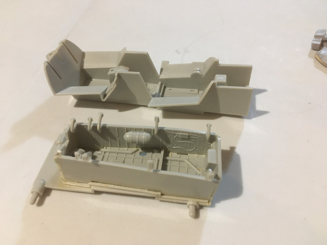

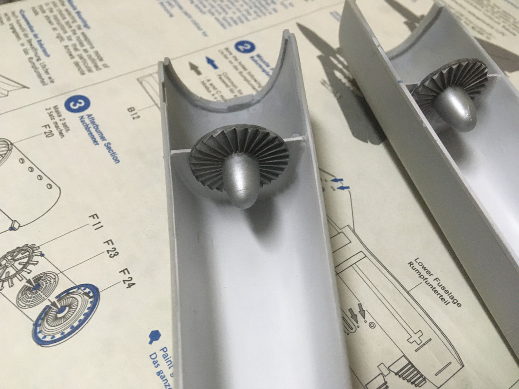

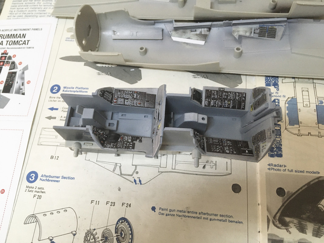

Cheetah11 Posted October 17, 2023 Author Posted October 17, 2023 A lot of distraction kept me away from this build over the last week. I did manage to paint the intake trunks and do the cockpit. I needed a bit of plastic card to fill the gaps next to the side consoles. Not the fault of Red Fox. Just an old kit. One piece I could not get information on is the HUD. The earlier Tomcats projected the HUD picture onto the windscreen but Tamiya does not provide colour callouts or even a clear piece of plastic to cover this. Any photos will be appreciated. Cheers Nick Loic, dutik, MikeMaben and 6 others 9
