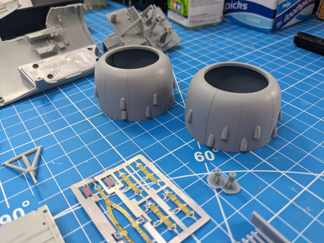

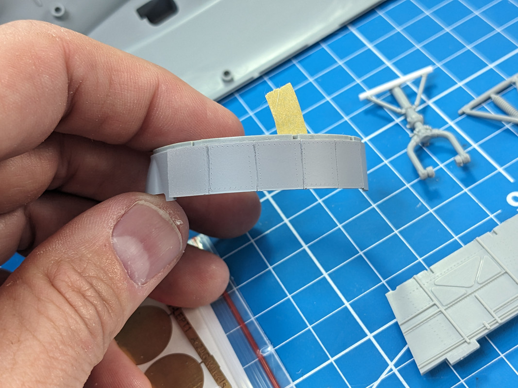

Uncarina Posted September 12, 2023 Posted September 12, 2023 (edited) I love HK Models for their subject choices, daring innovative designs (one piece fuselage, one piece wings for example), response to feedback, and overall great fit. Their Havoc is no exception, and the surface detail has to be seen to be believed. I am working on multiple subjects already, but I was immediately drawn to the kit. You can build a wonderful kit out of the box. But I tend to be drawn to modeling challenges, and with this kit I identified three (well, one has nothing to do with the kit design really): 1) strengthening the nose gear; 2) moving the instrument panel closer to the pilot's seat so it can be more visible and aligned with period photos; 3) postdating the aircraft to later than Block 30. After trial and mainly error I've managed to address these. In reverse order, I will share the postdating project first. The most obvious difference between the A-20G post Block 30 and earlier Blocks is that the engine exhausts are not routed to the cowling flaps but emerge individually from around the cowling: Block 30 and earlier, as depicted by the kit: Post Block 30: And my version: To do this I used the kit exhaust fairings, sliced off the cowling flaps and trimmed to size. I then replicated the cowling flaps with styrene sheet. To be continued! Cheers, Tom Edited June 16, 2024 by Uncarina easixpedro, themongoose, Brett M and 19 others 22
