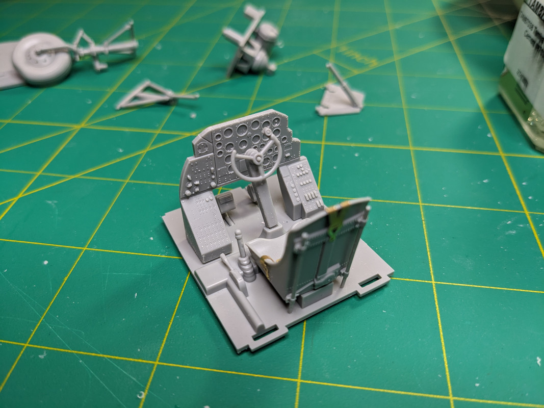

ChuckD Posted June 14, 2023 Author Posted June 14, 2023 11 hours ago, denders said: I'm thinking that I want the Airscale set when it's available. But I'll watch and see how yours turns out. Yes, that's the one! The name escaped me last night and I was too tired to go poking around to find it. I've still got a ways to go before I pass the point of no return for the IP, so we will see how things play out. My concern is that the recessed for the gauges in the kit IP are very deep and getting any decal to sit properly will be... problematic at best. So, my other option is to punch out and place dials individually - something I've also had mixed luck with. I may order the airscale part and try for the best with the kit pieces and see what happens.

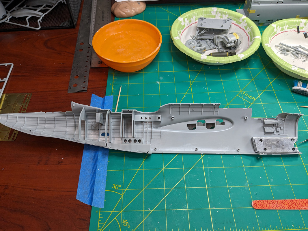

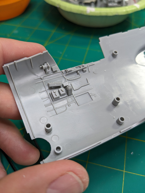

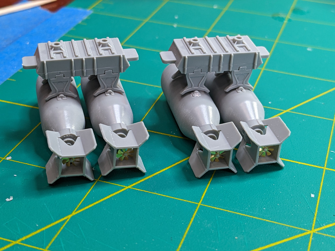

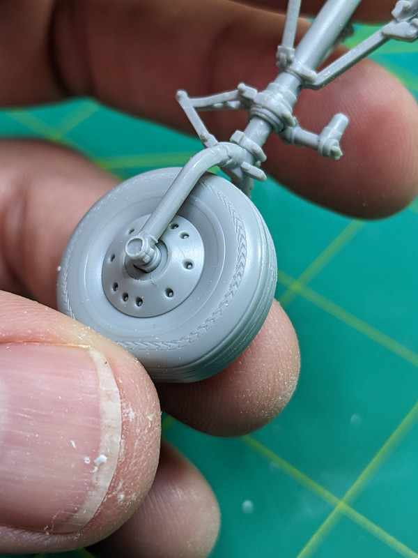

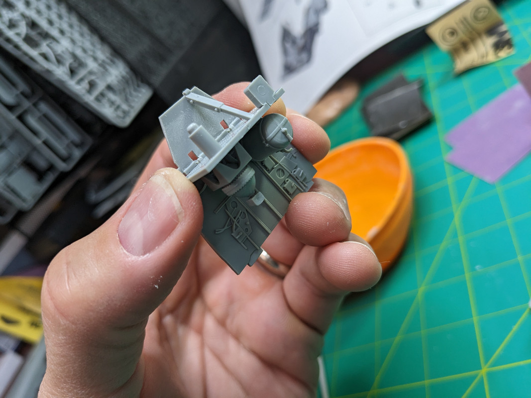

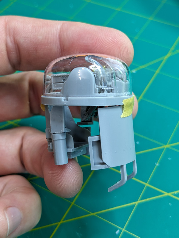

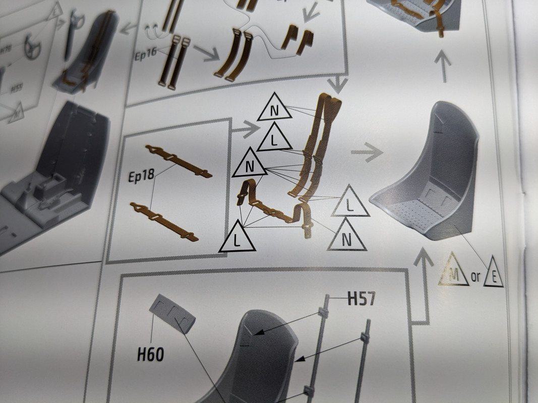

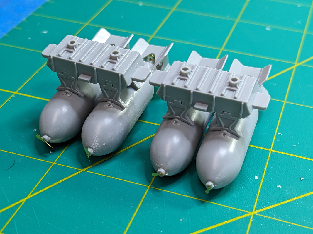

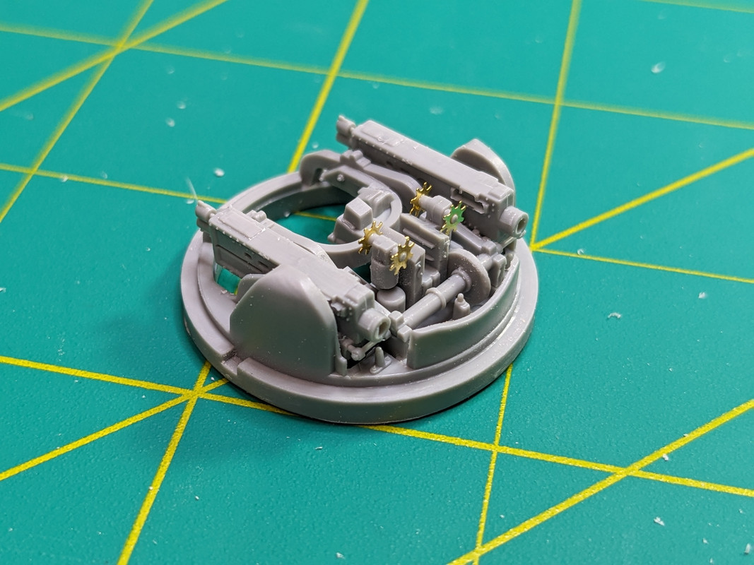

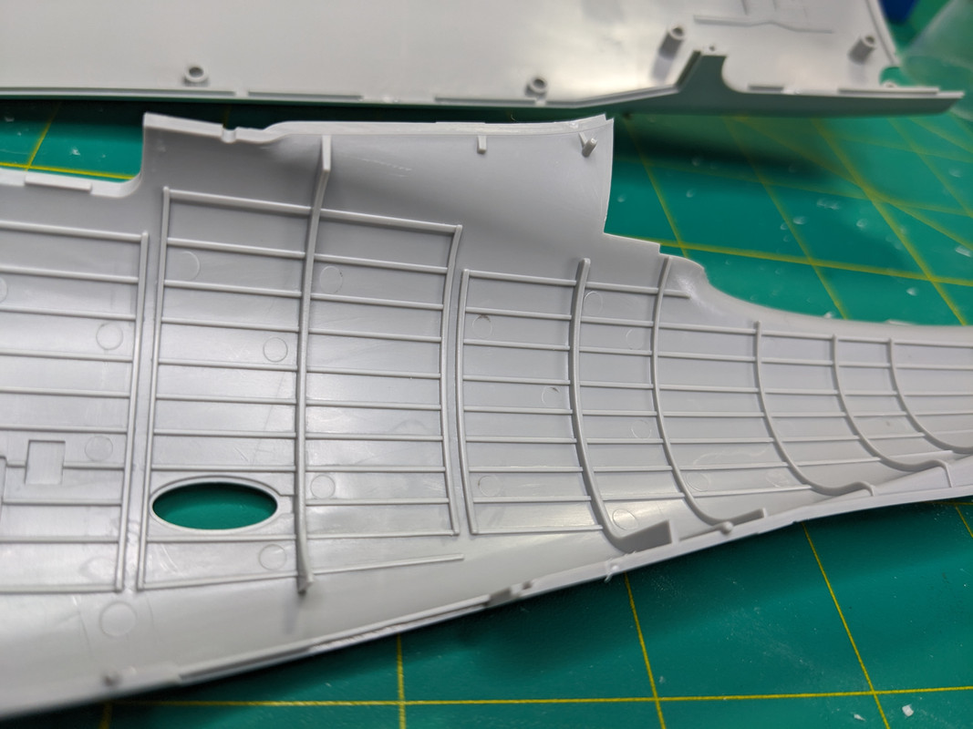

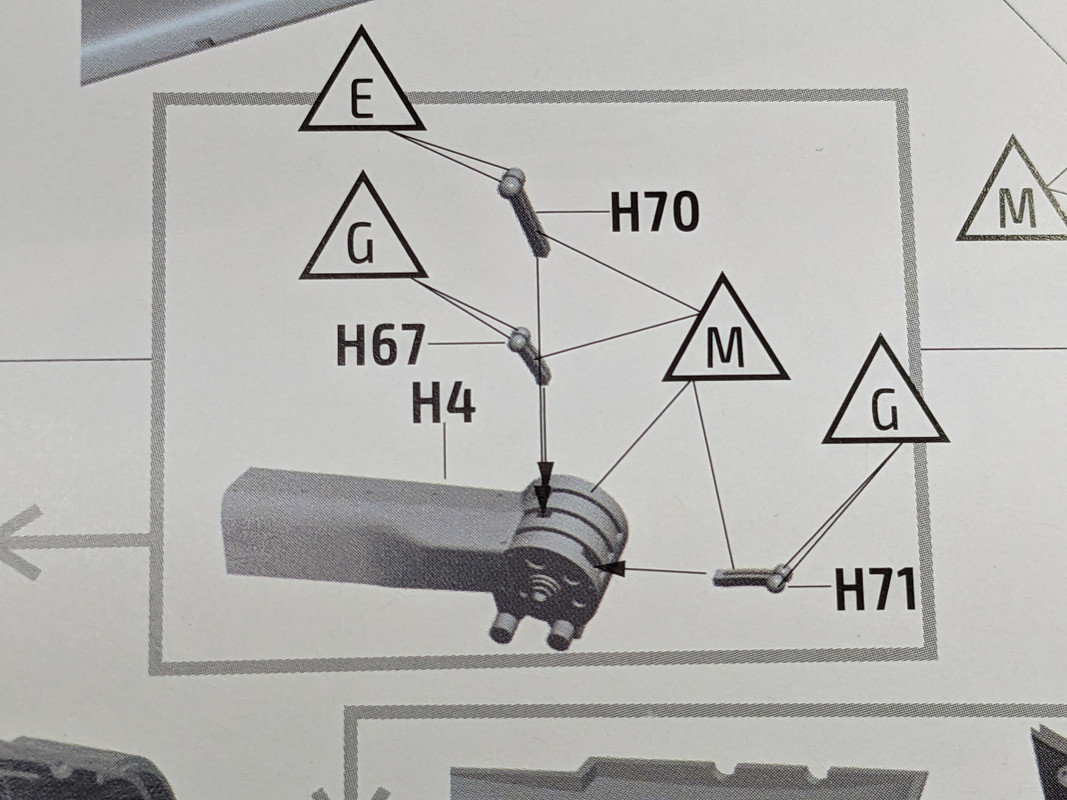

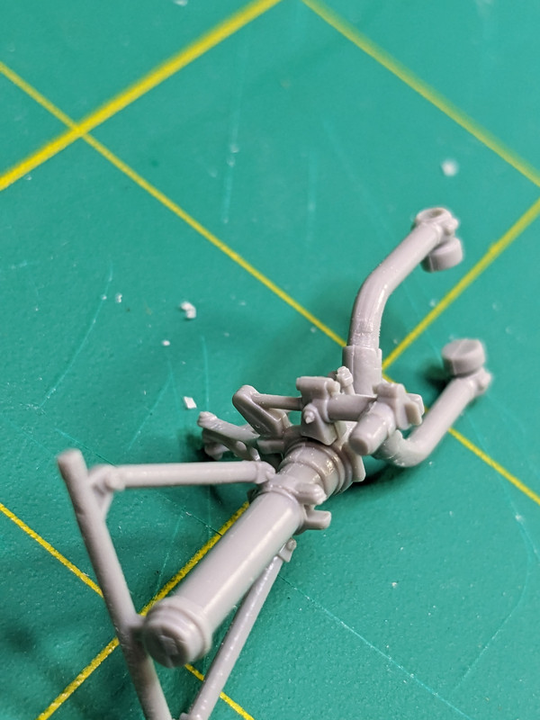

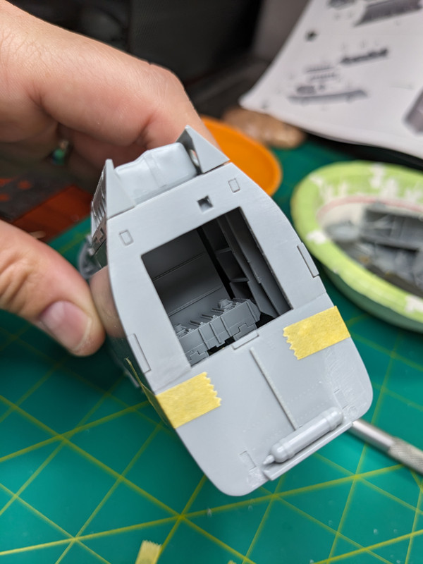

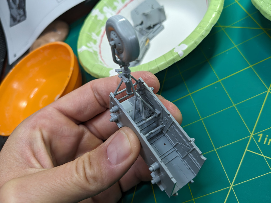

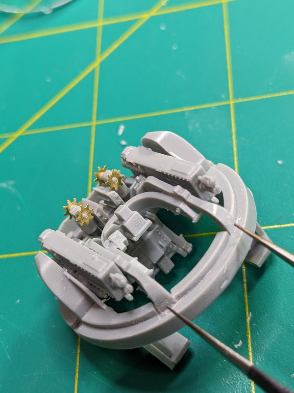

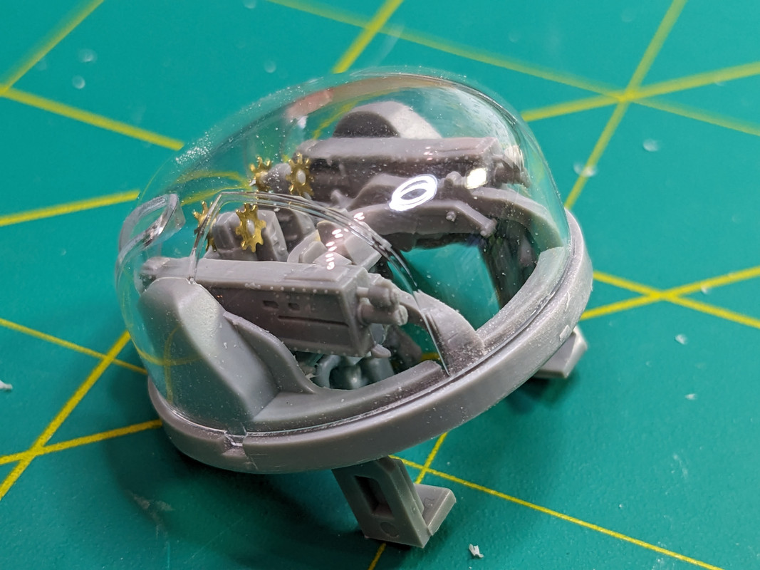

ChuckD Posted June 16, 2023 Author Posted June 16, 2023 Hello, and welcome back! Happy to report that there has been significant progress since the last update. I am super happy with this kit so far. I desperately hoping I'm not jinxing things, but so far, it's going together with Tamiya-like quality. The only issues I've encountered so far have more or less been of my own doing. My only complaints - very minor though they are - are that sometimes the instructions are so small, it's hard to see how parts go together. Again, very small complaint (pun fully intended). After completing the nose gear, you move on to the nose gear well. I've only glued a few pieces together here. Again, dry fit. This, however, allowed me to glue the supporting strut on the nose gear now that I was able to fully establish the proper angle. Once the nose gear bay is done, the instructions have you install the cockpit section on top of it. I held off for now to ease painting. After that, you move on to the upper turret. This went together nicely and without any major surprises. I did find that when I tried to install the turret glass, it wouldn't fit. With the forward portion positioned properly, there was interference that precented the rear portion from dropping onto the turret ring. Sanding the two frame arms here and a little on the front of the turret ring allowed the glass to pop into place perfectly. Perfection. The rest of the turret went together flawlessly. Instructions have you install the gun barrels at the end of the turret build. This is, so far, the one place I can say I'm disappointed with the kit. HKM has had a history of underwhelming detail on their MG barrels and this kit is no exception as you'll see later. Suffice to say, I placed an order from Sprue Brothers today for the Quickboos B-17 .50 cal barrel kit. Once the turret is done, you move on to building the bombs and racks. The PE here is nice and in the pics below the bombs are dry fit to the racks. Again, everything went together very very nicely. From there, you move on to the bomb bay. The build itself is straight forward, but getting the left and right halves together is very challenging due to the number of attachment points. My recommendation here is to fit all the parts onto one side piece, fit an end piece, fit the other side piece (aligning all the locating pins carefully), then doing the other end and top piece. Once you get everything lined up, it more or less snaps into place. With the bombs in place. This is always a fun part of any a/c build - cutting the fuse halves off and getting them around. As some reviews have noted, there are a decent number of ejector pins throughout. This is to be expected for pieces this big and for those of you triggered by EP marks, you may want to skip this thread for a while. I'm not going to address most of these as they'll be completely invisible once the final assembly is done. I included these photos for those of you who will address them and want to be prepared for what you'll be up against. Most of the pin marks up front are obscured or covered by other parts, as you'll see. On to the build... The cockpit is nicely detailed and the fit is flawless. Pretty much everything has a unique pin or recess that marks its location. After completing the sidewall build, you move onto the rear fuselage. Instructions aren't super clear on where to install the framing for the turret (the holed piece in the top left of this photo), so I ended up installing it incorrectly. There are also three ejector pins that interfere with the fit of the sidewall piece, so I scraped them off and... ... viola! The sidewall piece is now installed correctly. And here, I've fixed the turret framing. Make sure it sits directly on top of the three vertical ribs as shown below. With the right fuse done, we move onto the left. Some of the instructional drawings could use a revision as - at 1:1 scale - some of the lines overlap to the point of being very unclear. Just for the record H70 goes in the middle slot, H67 goes on the outboard slot. Here's the left side of the fuse fully detailed and with included nose weight installed. Moving onto the rear fuse, you repeat the turret framing and the and the lower side pieces. You add a few bulkheads and ancillary bits, then you're pretty much done. Most everything here is dry fit to aid in painting. The last step before gluing the two fuse halves together is to build the lower gun. Again, this is one place where HKM is a bit underwhelming. You can see here the .50 for the belly and its barrel. If you're super concerned about details here, you might want to look into an aftermarket .50 and barrel. This will likely be invisible once the kit is fully realized, so I will settle for replacing the barrel with the QB set I ordered. But yeah... not HKM's finest work. That said, the main fuse is complete and will be moved to the paint booth. I've pointed out a few week spots and negative points here and there, but I can't stress how nice this build has been so far. Everything fits cleanly and with a solid, positive, nearly click-together fit. The typical problem areas like wing roots, fuse halves, and cowlings are still on the horizon, so I'll reserve final judgment until I tackle those areas, but I'm cautiously optimistic. Bottom line, if you're on the fence about this kit, just snag one. It's pretty phenomenal. HB252, patricksparks, TimW and 16 others 19
