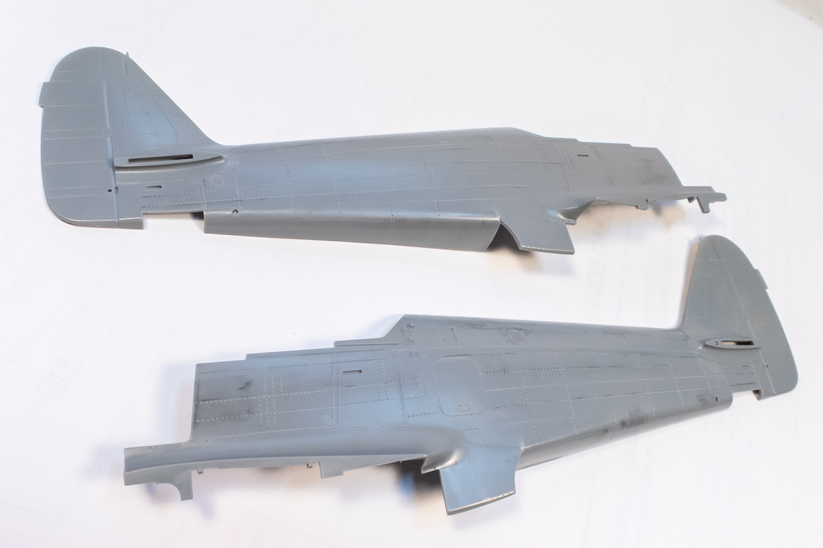

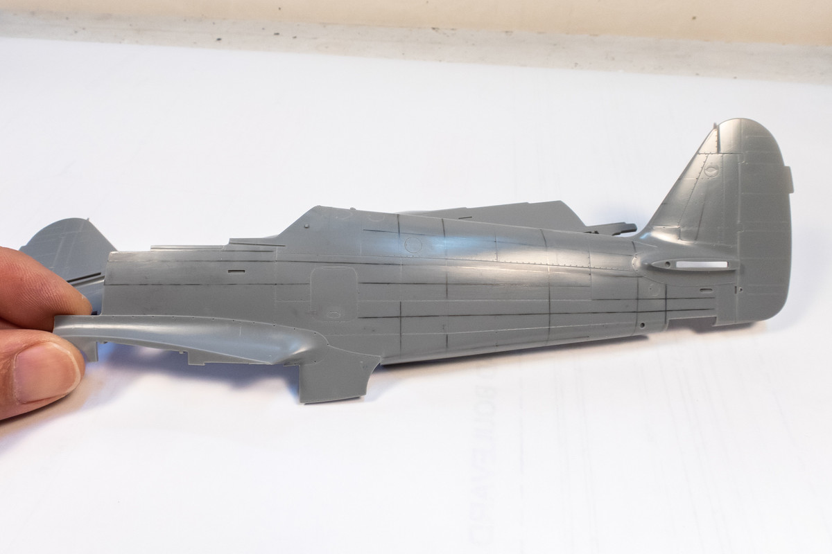

Ahhh... now I remember.  The resin cockpit has been completed but before I glue the fuselage halves together, I wanted to apply rivets to the fuselage parts.  I got as far as drawing some lines on the port fuselage.

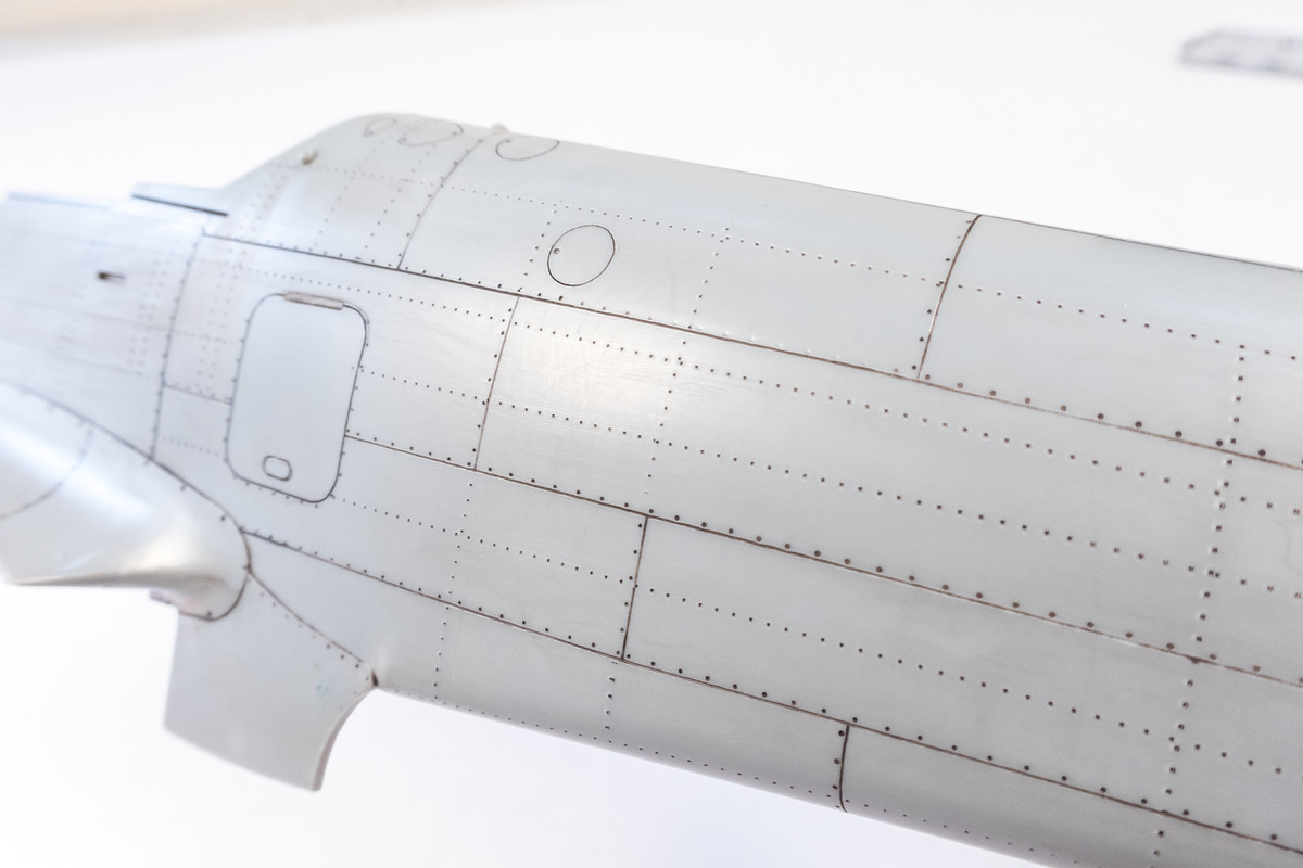

I finished sketching the rivet lines on both fuselage parts using a soft leaded pencil.  I didn't have the patience to capture all of the rivet lines but put enough to add some needed surface detail to the model.

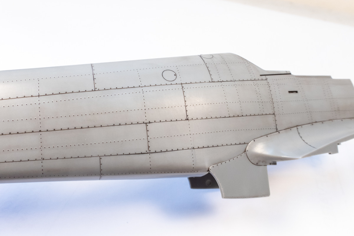

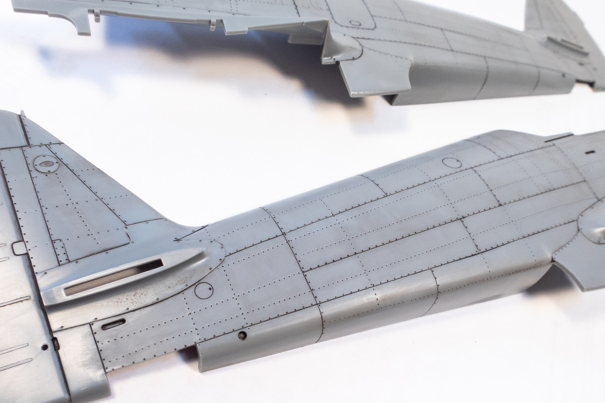

The rivets were made using a Galaxy Tools riveter in the 1.00mm size.  Hard to see but this right after the rivets have been applied and the pencil markings washed off.
Using 600# sandpaper, I rubbed down the rivet lines to remove the raised plastic around each hole.  I then applied a temporary brown wash to check the surface detail.  Any rivets or panel lines that aren't holding the wash can be touched up now.
Here are the fuselage parts after the rivet job.  After the touch-ups are complete, I'll scrub the wash off prior to gluing the fuselage halves together.

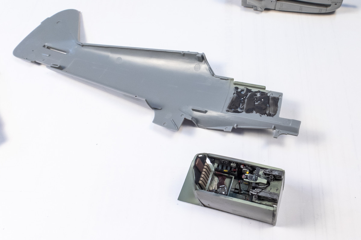

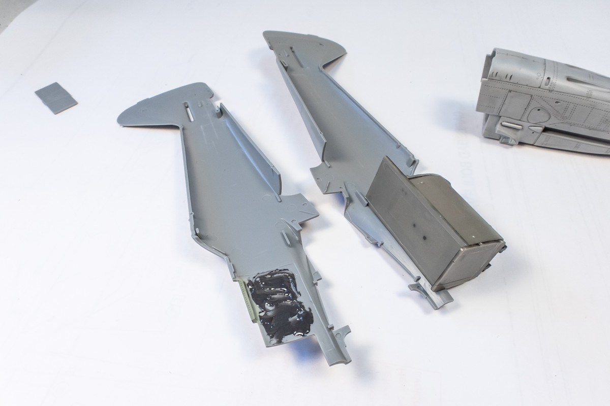

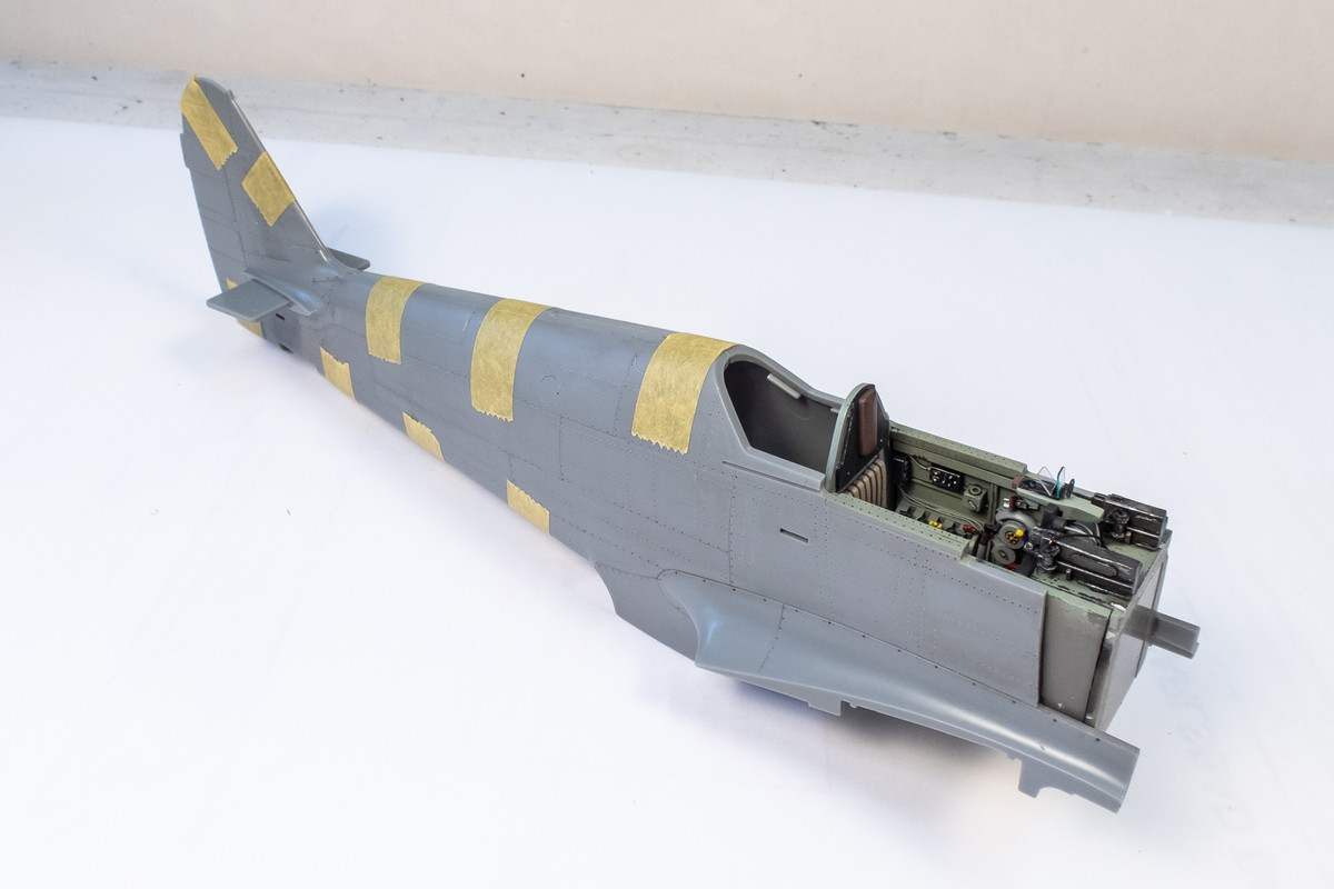

Since the fuselage riveting is finished, I can now insert the resin cockpit tub and glue the fuselage sides together.  I am using JB KwikWeld two-part epoxy to attach the resin sidewalls to the fuselage interior. It cures in about five minutes, giving me time to push the cockpit tub into the correct position.  Note the small rectangular piece in the upper left... it is an insert for the horizontal tailplanes that needs to be sandwiched between the fuselage sides.
Once the cockpit tub is secured in place, I used Tamiya Extra Thin to cement the fuselage parts together.

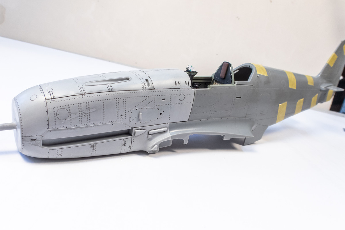

A pre-fit of the Wolfpack resin nose...

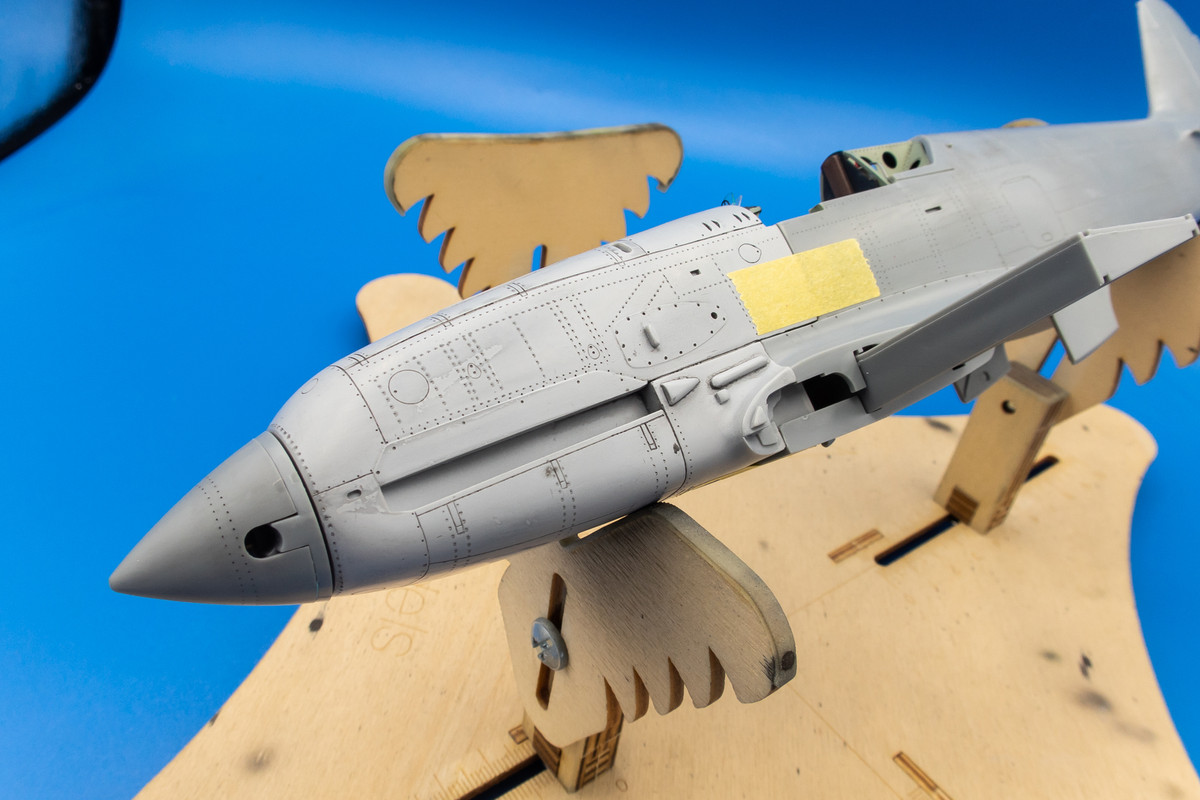

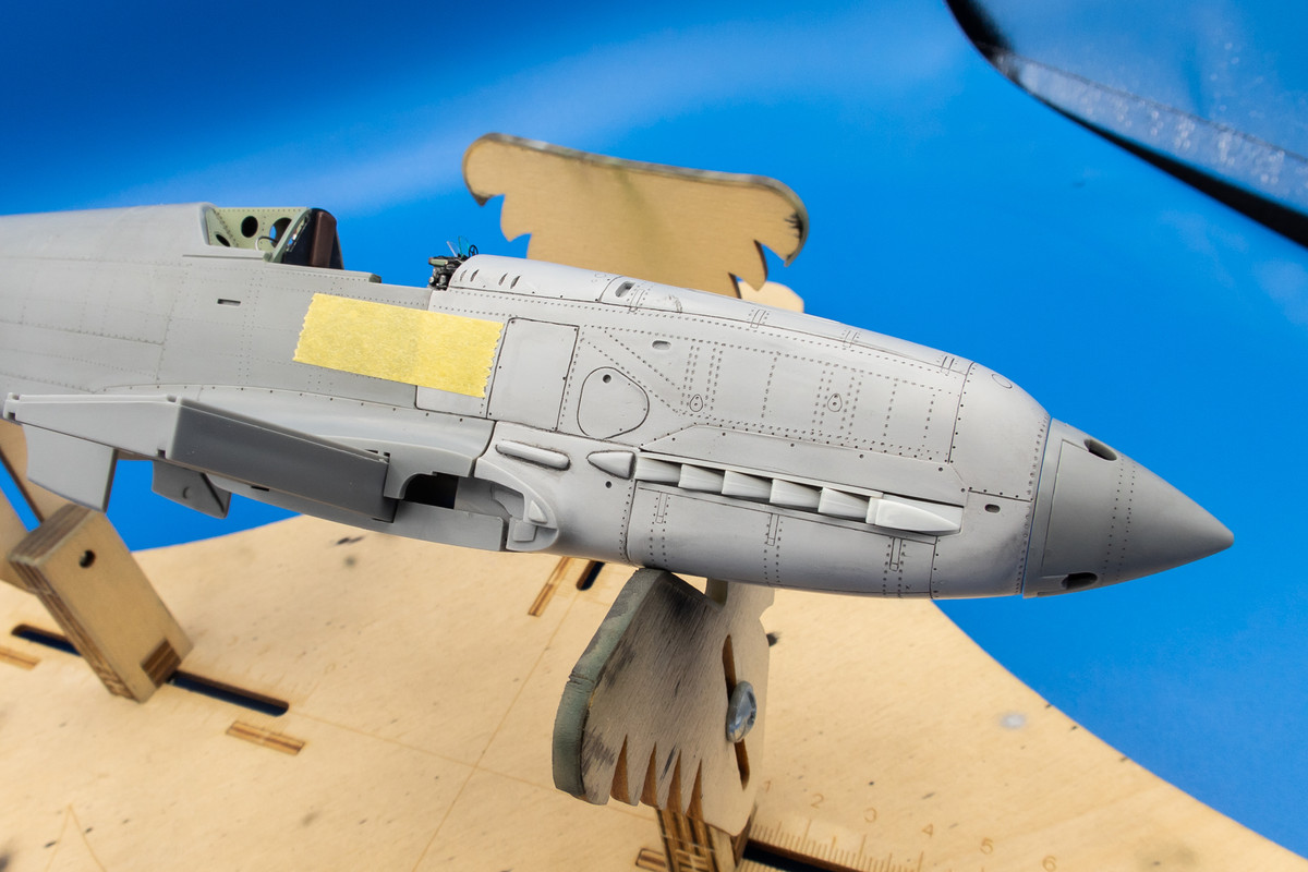

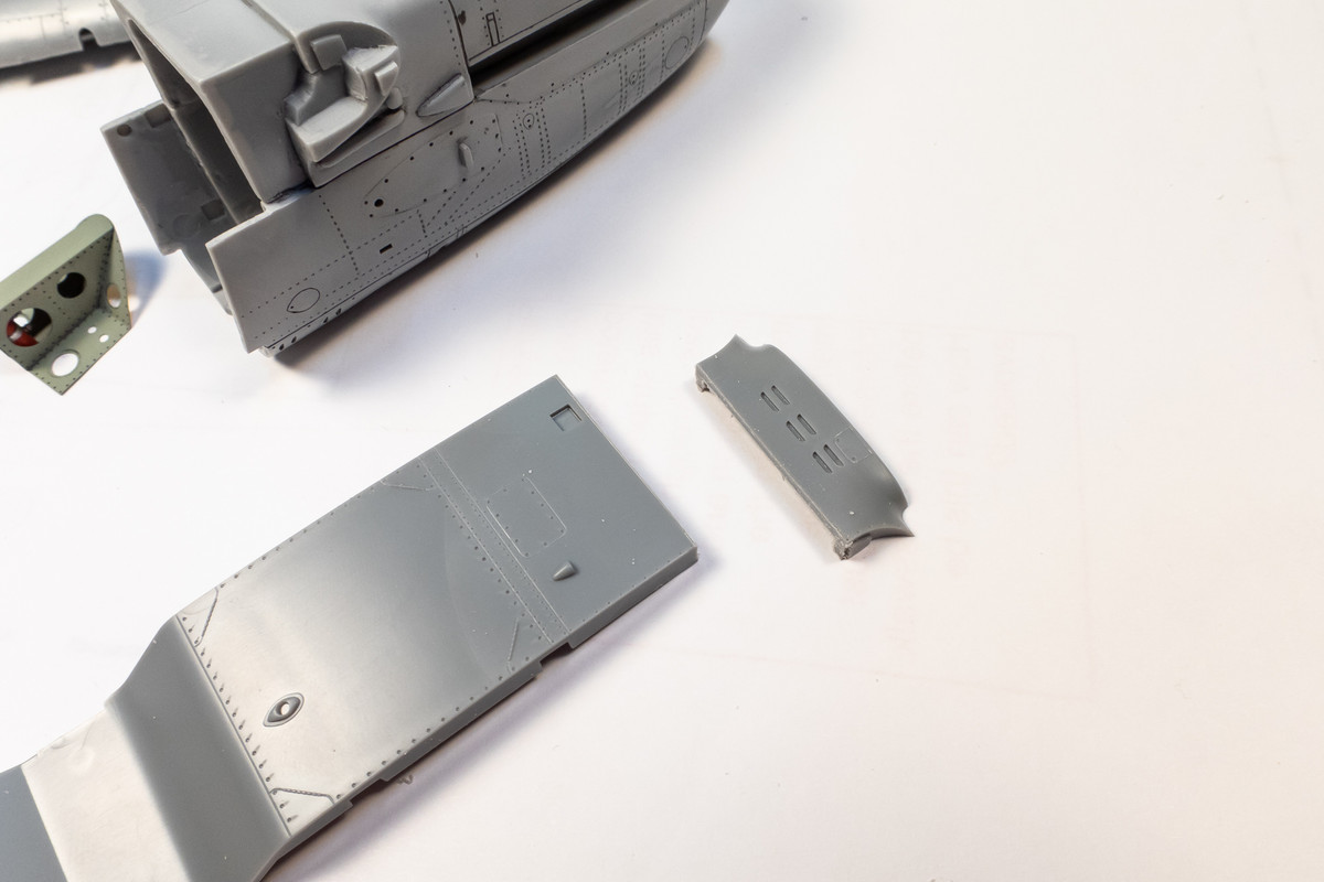

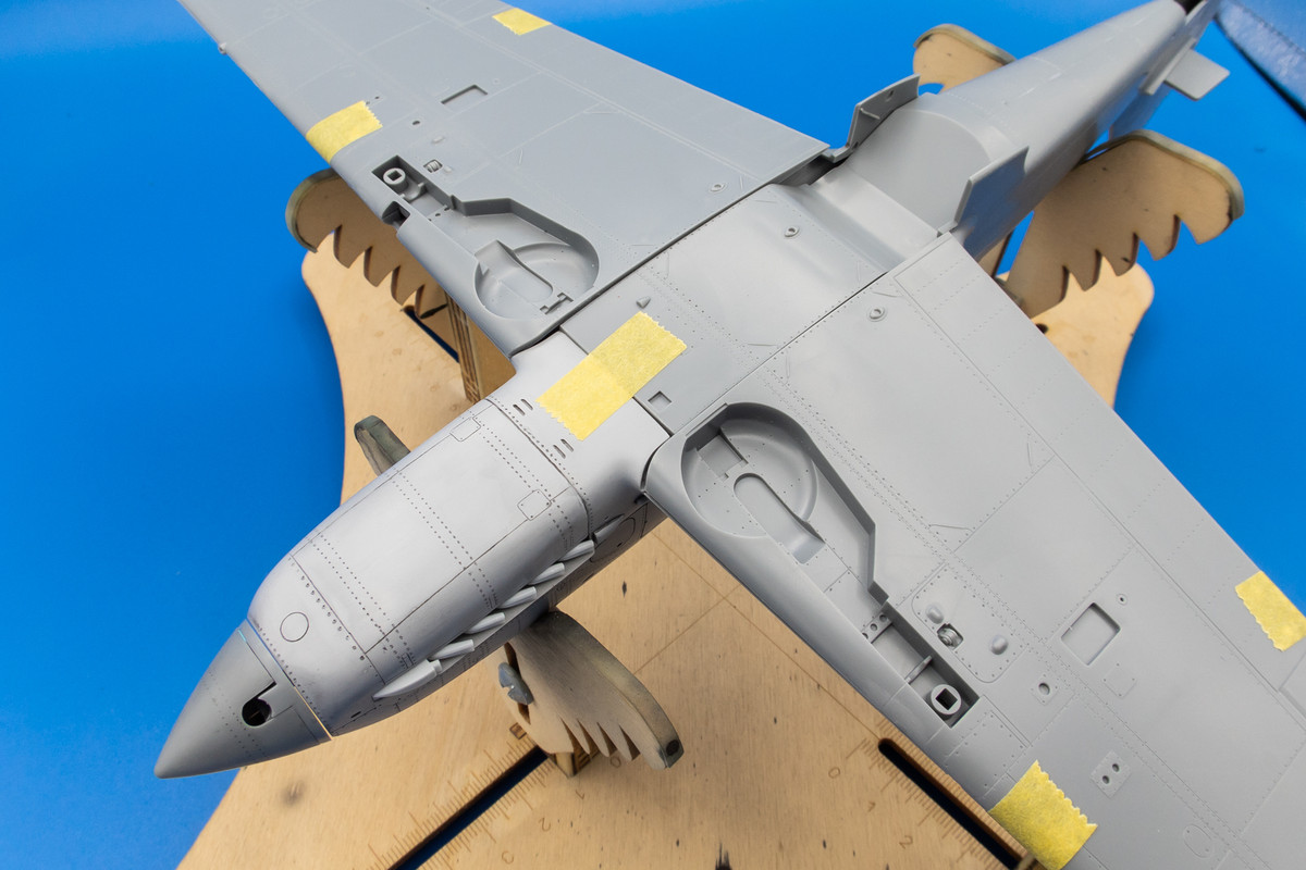

Playing with the parts revealed something that isn't explained in the Wolf Pak resin instructions... there is a little bit of overlap between the kit fuselage bottom and the resin nose.
The front end of the fuselage bottom needs to be trimmed off.  Luckily, the trim point is right at the panel line, which makes for an easy cut.
Another round of dry-fitting with the fuselage bottom part in place...

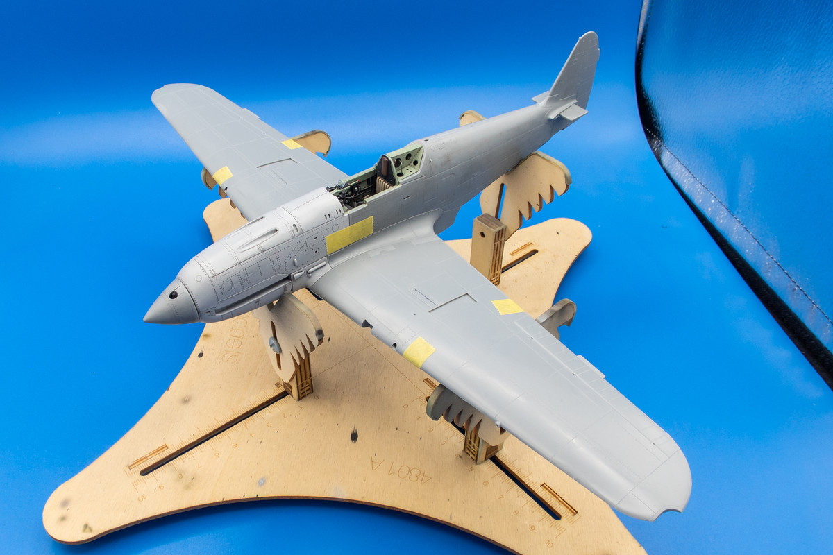

This is a good time to make a preliminary check of the wing fit...
Yes, there are gaps but I'm hopeful that these can be minimized.  I'll also look at alternative ways to attach the wings like perhaps gluing the wing tops on first.
