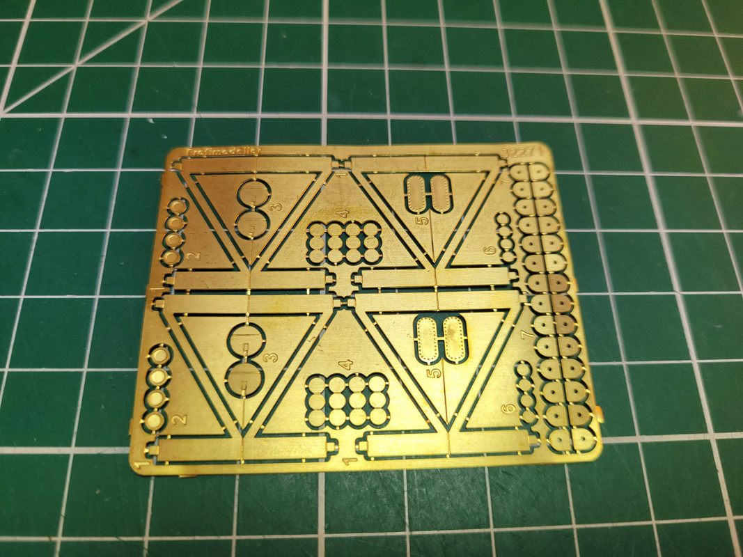

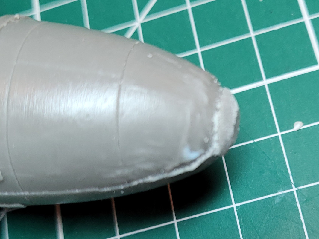

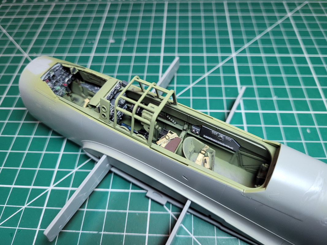

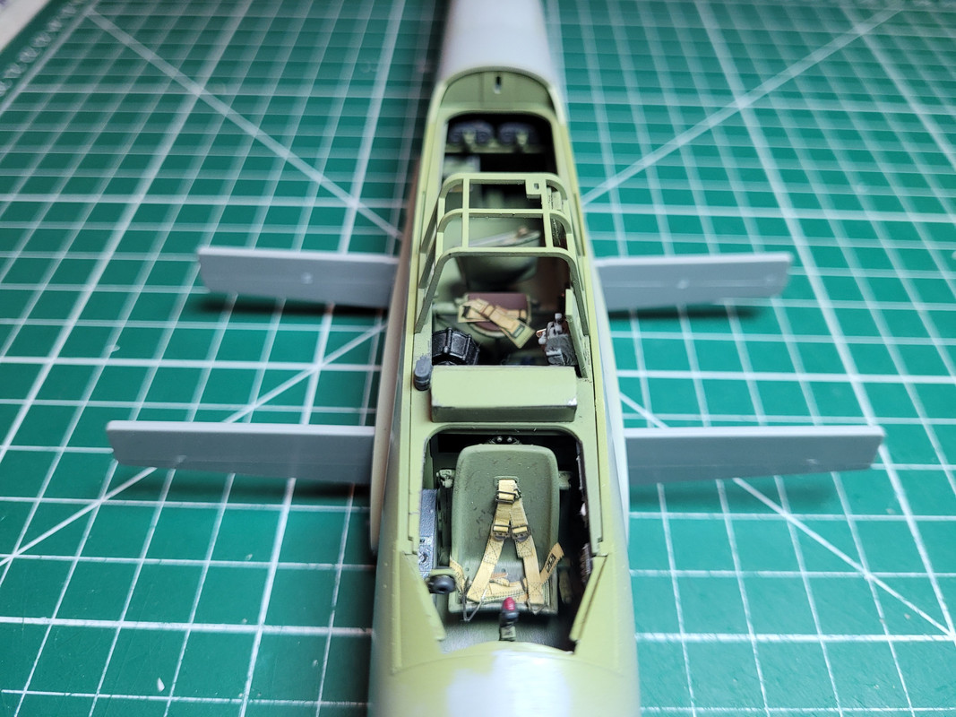

monthebiff Posted May 16, 2022 Author Posted May 16, 2022 Some more progress over the weekend, first up I've fitted the upper cockpit panel. Also have both wings completed over the weekend And with the wings complete I turned my attention back to the 900litre drop tanks. I touched on these earlier in the build but put them to one side til the wings where sorted. I have the Profimodeller set as the Dragon supplied items are wrongly shaped in many ways but the Profimodeller set has its own problems as well. The first problem is a big rough casting plug and lots of clean up needed around it The rough nose section was cleaned up and then HpH 2 part resin was used as filler and then the nose was sanded smooth. I then replaced the straps around the tank with plastic stock and then added brass wire with plastic card wrapped around for the pylons as,I felt the Profimodeller etched set was a little 2D and not really close to the images I have of these tanks Followed by a test fit to the wing Happy so far and just need to finish the details and add the tail fin and the its one down and one to go! Regards. Andy LSP_Kevin, MikeMaben, scvrobeson and 9 others 12
IainM Posted May 17, 2022 Posted May 17, 2022 That great work on those support braces! Def WAY better than the brass offerings!!! Looks a treat! monthebiff 1
