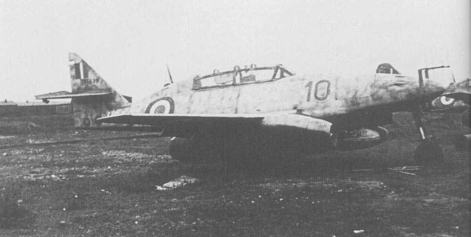

Guest Vincent Posted December 29, 2020 Posted December 29, 2020 (edited) Yes, it had the enclosed tail light, you are correct on that. It is not an isolated case, for example single seater WkNr. 500443 is also having this early style of rudder : My theory is that a small batch of them got produced just at the start of production and then it was quickly decided to switch to the cabochon style. And of course each and everyone of these rudders got installed Another example : To make things even murkier, there are pictures of both of these a/c with normal production rudders as well and pictures of the nightfighters in captured markings without a rudder on. So could it be that these rudders got installed by the british and american to fix broken production ones (?) For ex, T-2-4012 with the same livery in the USA but with normal production rudder : And then we have the in flight picture of white 10 with the enclosed light as well : Edited December 29, 2020 by Vincent
Guest Vincent Posted December 29, 2020 Posted December 29, 2020 Hey, look what i just found : No more guessing
Thunnus Posted December 29, 2020 Author Posted December 29, 2020 Thanks for the valuable insights, Vincent! That is a great photo of Red 10 that you just posted. It is the enclosed tail light right? The relative darkness of it is confusing me.
jeroen_R90S Posted December 29, 2020 Posted December 29, 2020 Great looking build so far -I see only one problem with it, like many other of those great builds here I had zero interest in the Me262 and this makes me want to build one -I especially like that last one, look at those roundels.... Neat stuff! Jeroen Thunnus 1
Guest Vincent Posted December 29, 2020 Posted December 29, 2020 (edited) 2 hours ago, Thunnus said: Thanks for the valuable insights, Vincent! That is a great photo of Red 10 that you just posted. It is the enclosed tail light right? The relative darkness of it is confusing me. Enclosed light indeed And regarding the rivets, they are usually still visible on most of the surfaces on the 262. Usually the issue was more the panel junctions more than the rivets and it is important to remember that there was 2 distincts build phases for the 262. The latter phase in dispersed facilities by slave workers were the one heavily puttied but the earlier airframes were quite OK and did not require that much putty For ex, here i clearly see rivets : Edited December 29, 2020 by Vincent
Thunnus Posted December 29, 2020 Author Posted December 29, 2020 What is interesting is that the aircraft next to Red 10 seems to have a rudder from another aircraft with a scheme similar to other nightfighters. 3 hours ago, Vincent said: Hey, look what i just found : No more guessing And here is a photo of Red 10 with the rudder removed. Opening the possibility that the rudder shown mounted on Red 10 may or may not have originally belonged to Red 10. Paul in Napier 1
Guest Vincent Posted December 29, 2020 Posted December 29, 2020 (edited) I have a theory for why the rudders are moving around so much on a given a/c with captured markings When the May 8th surrender took place, the Luftwaffe was given an order to render all aircraft non flyable, presumably to avoid any rogue pilot or high ranking nazi escape. The instructions given to the ground crews called for a easily visible way to verify that On piston engined aircraft, it was done primarily by removing the propellers but how do you achieve that result on a Me262 ? You remove the rudder, it's easy (4 bolts if i recall correctly) and the a/c is not damaged. I have no proof but the amount of pictures of Me 262 post 8th May 1945 with mismatched rudders is too high to be a coincidence But when it comes to Red 10, the rudder with enclosed light seems to match pretty well the rest of the camo so I think you are safe going with that one Edited December 29, 2020 by Vincent

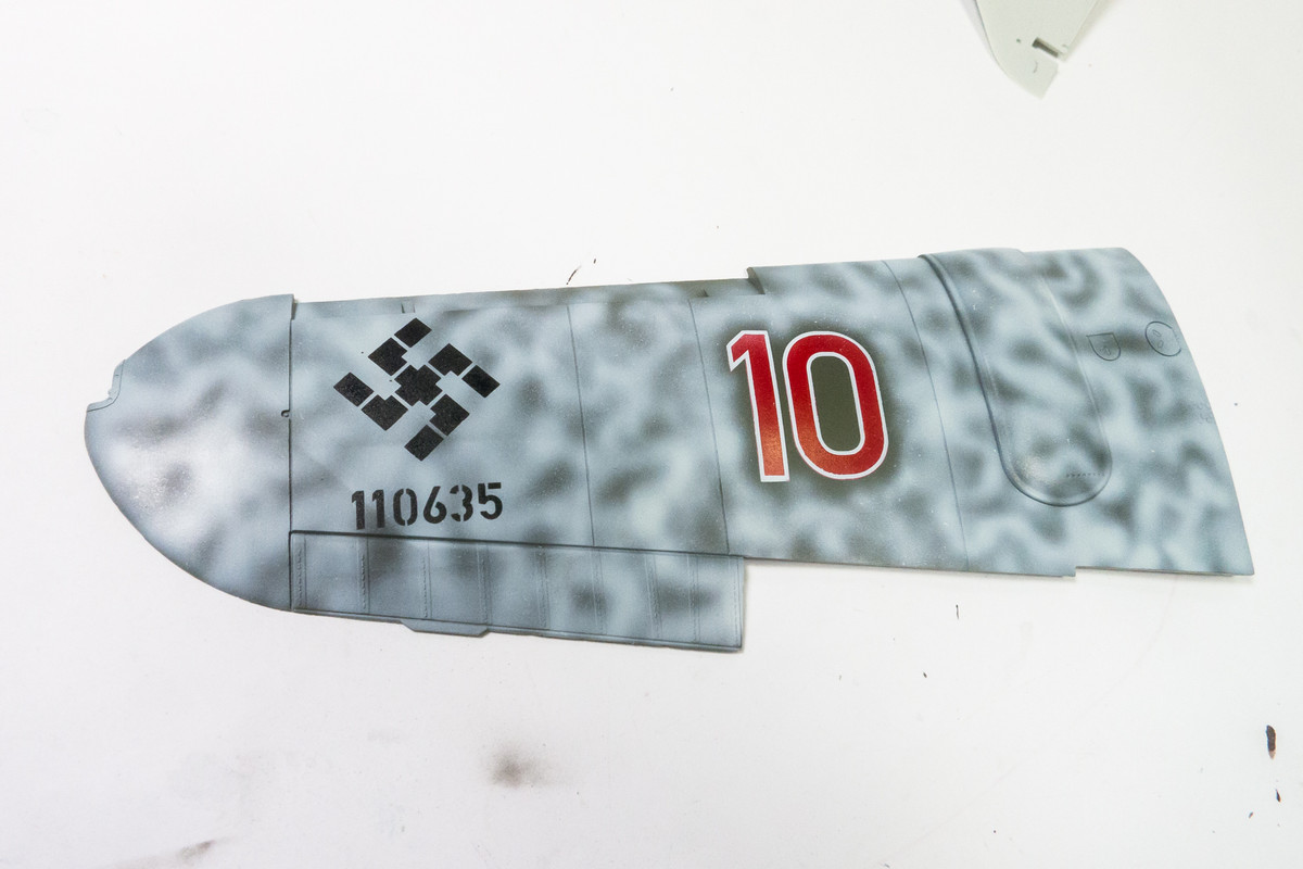

alaninaustria Posted December 31, 2020 Posted December 31, 2020 Hi John, she really is coming along nicely! Are you going for Red 10? I had masks cut for this bird at DN Models, here you can see how they worked out for me: If you are interested, I am sure Nushi and Mitko at DN Models could get you sorted with a set. Hope that helps! Cheers Alan Thunnus 1
Thunnus Posted December 31, 2020 Author Posted December 31, 2020 Thanks guys! I really enjoy the conversations! On 12/29/2020 at 1:38 PM, Vincent said: I have a theory for why the rudders are moving around so much on a given a/c with captured markings When the May 8th surrender took place, the Luftwaffe was given an order to render all aircraft non flyable, presumably to avoid any rogue pilot or high ranking nazi escape. The instructions given to the ground crews called for a easily visible way to verify that On piston engined aircraft, it was done primarily by removing the propellers but how do you achieve that result on a Me262 ? You remove the rudder, it's easy (4 bolts if i recall correctly) and the a/c is not damaged. I have no proof but the amount of pictures of Me 262 post 8th May 1945 with mismatched rudders is too high to be a coincidence But when it comes to Red 10, the rudder with enclosed light seems to match pretty well the rest of the camo so I think you are safe going with that one Thanks Vincent! That makes total sense to me! 18 hours ago, turbo said: Just catching up on this build John - up to your usual standards and attention to detail. I particularly love the detail in the wheel well - exceptionally well done! Thanks Kirby! References are key and I was lucky to have had lots of references thrown my way during this build! 3 hours ago, alaninaustria said: Hi John, she really is coming along nicely! Are you going for Red 10? I had masks cut for this bird at DN Models, here you can see how they worked out for me: If you are interested, I am sure Nushi and Mitko at DN Models could get you sorted with a set. Hope that helps! Cheers Alan Thanks Alan! I love your rendition of Red 10! Since I have a Silhouette Portrait, I make my own masks. I've already designed a set for this build and have tested them out on my paint mule when I was trying a light-on-dark mottle technique. Brett M, J.J., MikeMaben and 8 others 11
alaninaustria Posted December 31, 2020 Posted December 31, 2020 Awesome stuff mate! Those masks look great! Cheers Alan Thunnus 1

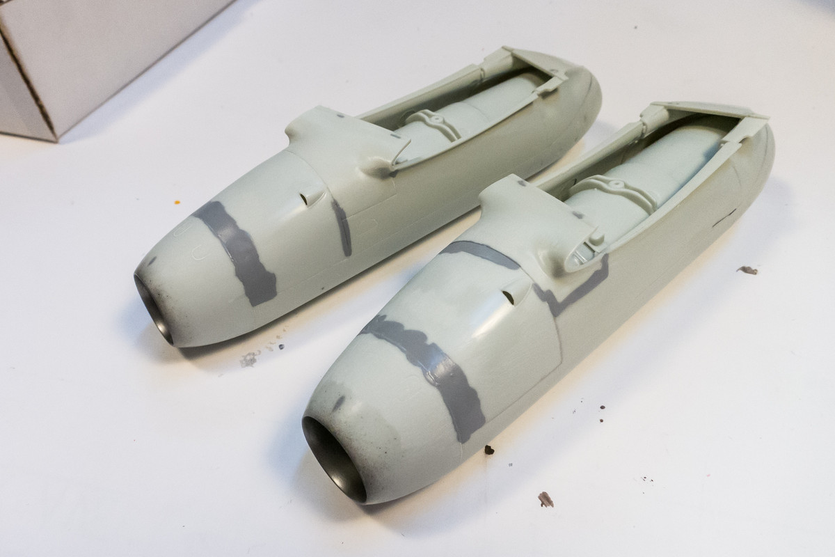

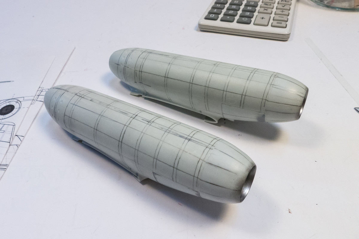

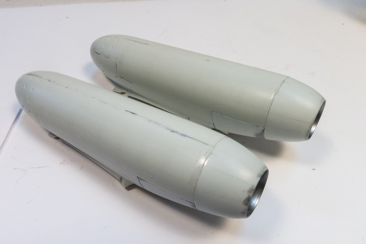

Thunnus Posted January 1, 2021 Author Posted January 1, 2021 I've been working to smooth out the glue joints on the engine nacelles this week. It's been a tedious process and honestly, I've been staying out of the hobby room because of it. But slowly, the layers of Mr Surfacer 1000 have been leveling off and I've gotten to a point where I could start re-scribing. Riveting was next. The rivet lines were sketched on using flexible white Tamiya tape. During the riveting, I could hear many a seam pop and crack. :headbang: I felt I had no choice but to seep some Tamiya Extra Thin cement into the seams to re-establish some structural integrity to the nacelles. So the primer with the pastel wash routine to check the scribing and riveting work will have to wait. Landrotten Highlander, XOPCT, D.B. Andrus and 11 others 14
