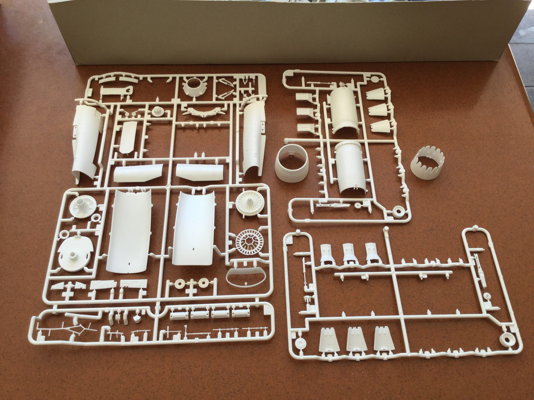

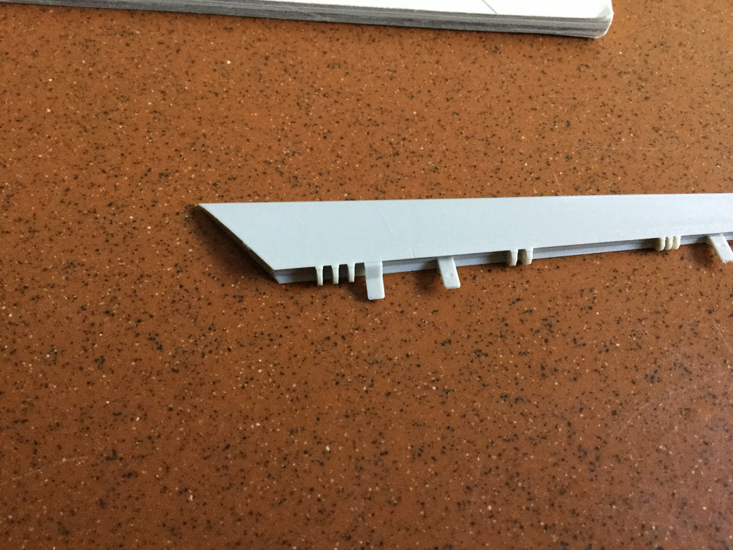

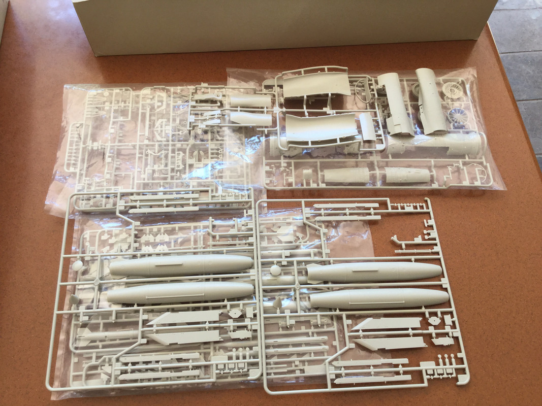

Cheetah11 Posted November 6, 2019 Author Posted November 6, 2019 Thanks for the comments Alain and Sean, It does seem a bit much to do the kit in a week but I won’t do the engine and dolly or any stores except Sidewinders and the belly tank. Here are the parts not used. Some of the parts needing modification to an A are the slats. The only poor reference I could find shows the inboard hinge of the three should be removed but I need a bit more certainty. Anyone know for sure? Thanks Nick LSP_Kevin, Out2gtcha and Coneheadff 3

Marcel111 Posted November 6, 2019 Posted November 6, 2019 Nice! The A has two hinge fingers instead of three on that inside hinge. What will you do about the tail? Pity you are in such a rush, KASL produces a great PW exhaust and also A tail (which you would likely need to modify depending on the version you are building). Cheers, Marcel Cheetah11 1

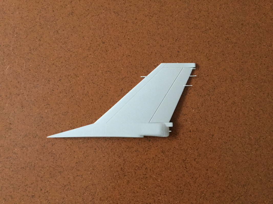

periklis_sale Posted November 7, 2019 Posted November 7, 2019 What will you do about the tail fin? Cheetah11 1

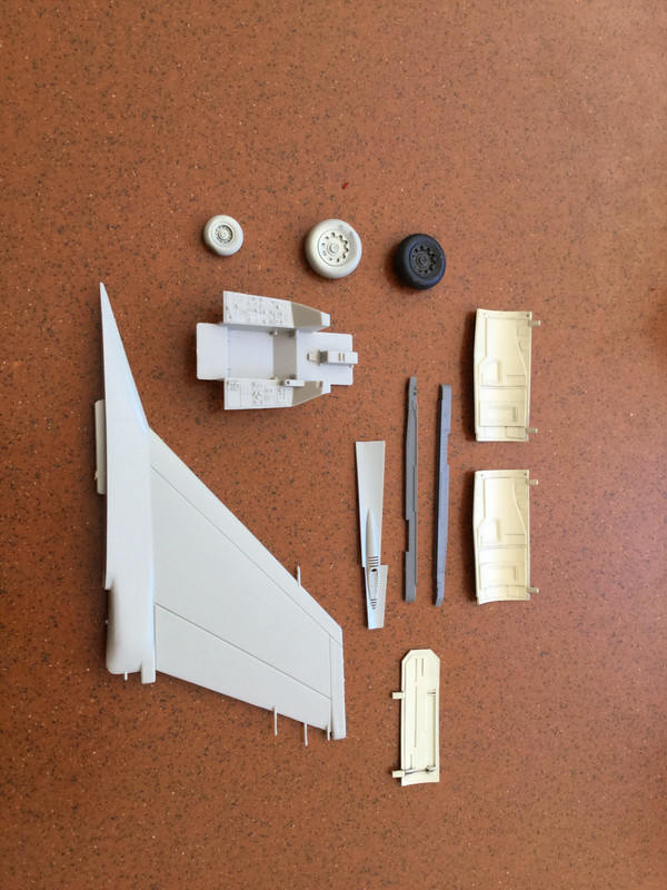

Cheetah11 Posted November 7, 2019 Author Posted November 7, 2019 14 hours ago, Out2gtcha said: Great start! Interesting to work on models away from your own bench These are the traveling tools. Yes Brian, a bit different but at least I can see all the tools on the workbench The other difficulty is doing everything from the IPad. Hi Marcel The question on the tailfin. When the Tamiya kit was released a modeling friend gave me a box with two Hasegawa kits in spares. I will use some of these part except the gear doors. The tailpipe parts for the Thunderbird kit are great and fit very well. AM products are difficult for us. I have been waiting since March for books from Belgium. Cheers Nick LSP_Kevin, Coneheadff and Marcel111 3
Marcel111 Posted November 7, 2019 Posted November 7, 2019 Looks like you have things covered. Pay close attention to the wheels, Block 15 OCU aircraft have the Block 30/32 wheels you get with the Thunderbirds kit. Cheers, Marcel
Cheetah11 Posted November 7, 2019 Author Posted November 7, 2019 25 minutes ago, Marcel111 said: Looks like you have things covered. Pay close attention to the wheels, Block 15 OCU aircraft have the Block 30/32 wheels you get with the Thunderbirds kit. Cheers, Marcel Hi Marcel I am doing an early Block 15 around 1984/85 so the Hasegawa wheels will do. The markings will be a surprise. BTW I used the wheels of this kit on a Sufa converted to a Block 60. Cheers Nick Marcel111 and stusbke 2

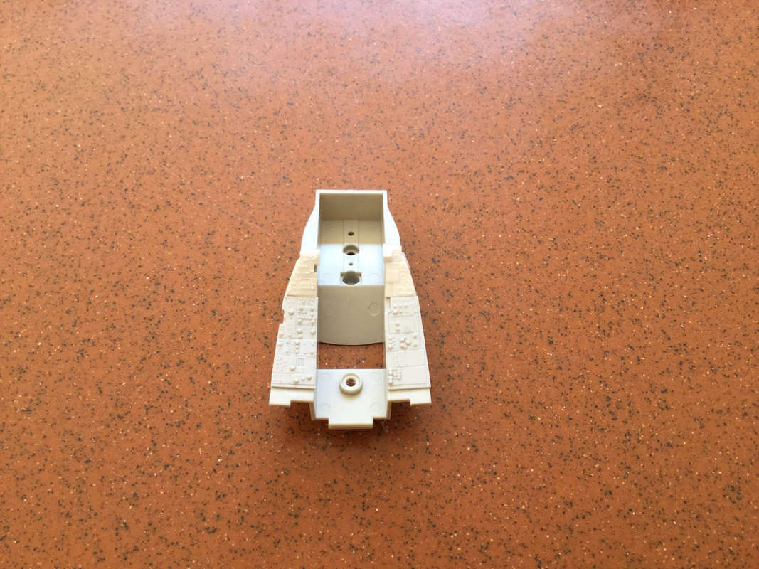

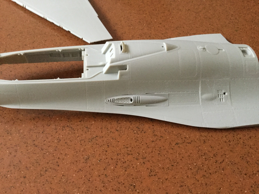

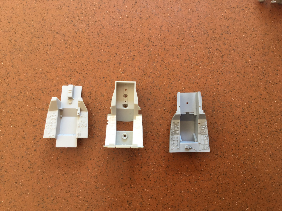

Cheetah11 Posted November 8, 2019 Author Posted November 8, 2019 (edited) A bit more work on the cockpit. I am loving this modeling vacation as I am doing in a week that would normally take a month. The best diagram I could find for an early F -16 was this one. These are the options I have. The single seat cockpit from the Sufa kit, the Tamiya block 25 and the Hasegawa kit cockpit. The latter was the only one even close. I never realized there was such a difference in the layout of the various blocks. The easiest route for a fairly accurate and still one fitting well was to cut the Hasegawa sills and glue them onto the kit cockpit tub. Worked surprisingly well. I also started preparing the rear top fuselage fir the fin. I have done this in 1/48 as well and the 1/32 conversion needs a lot less plastic card to fill. Enjoy Nick Edited November 8, 2019 by Cheetah11 Spelling Marcel111, Alain Gadbois, Dany Boy and 8 others 11

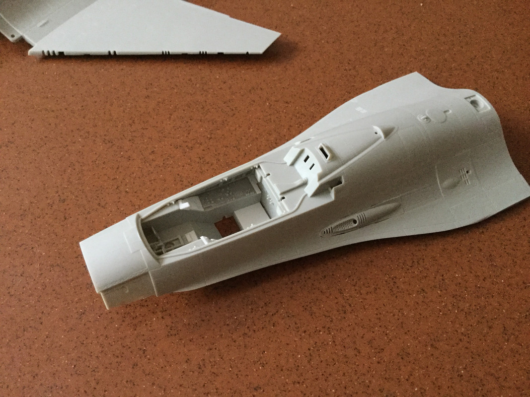

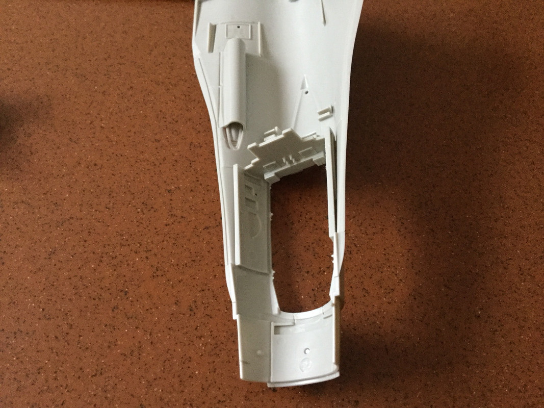

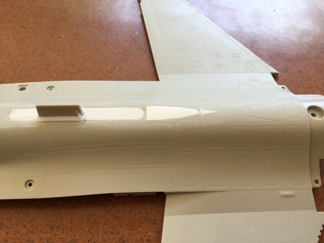

Cheetah11 Posted November 8, 2019 Author Posted November 8, 2019 Almost done with the modifications. An extra layer of thin plastic card completed the upper fuselage . Sometimes Tamiya is difficult to understand. At the kit design stage an extra spruce would have given us the F-16 A ,B and D variants as well. The next thing to do was to fit the Hasegawa tail. At the same time I scribed the tail. A test fit. Fortunately the panel lines line up. Another small modification on the front fuselage was to build the Hasegawa blast deflected onto the Tamiya kit. The fit looks a little rough but should be OK with a bit of filler. The modified cockpit tub and assembly sequence fortunately fit without a pain. Enjoy Doctorgaz, Alain Gadbois, daveculp and 7 others 10

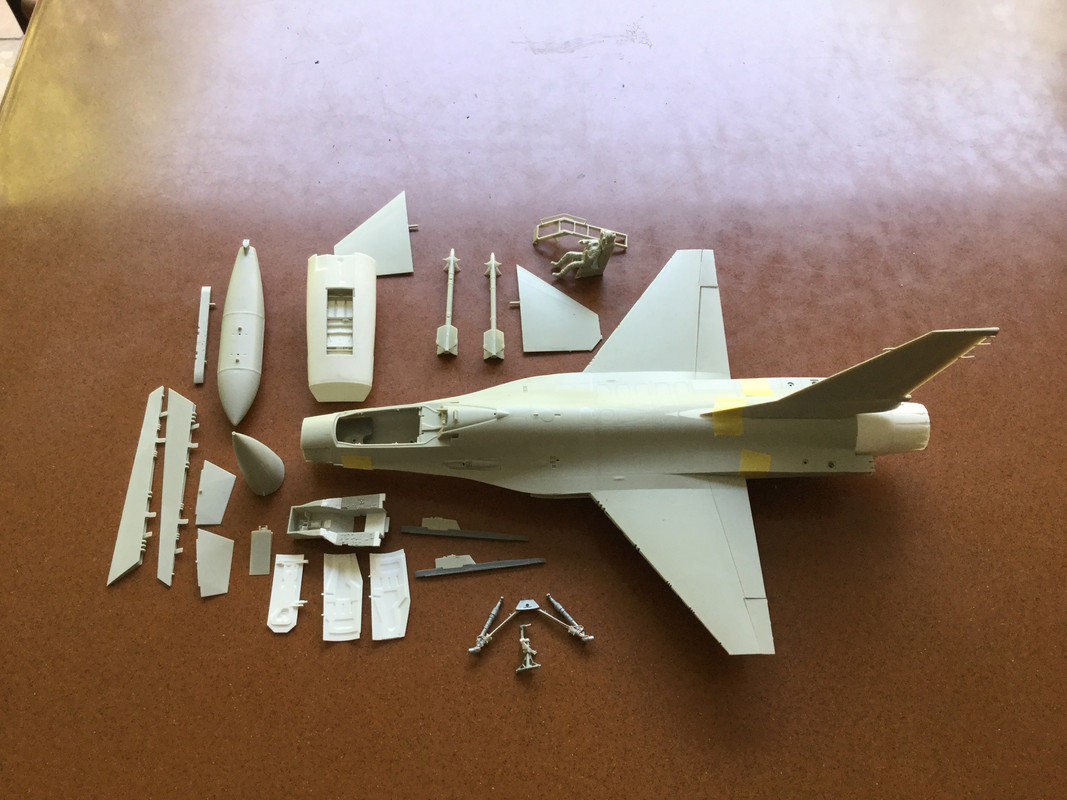

Cheetah11 Posted November 9, 2019 Author Posted November 9, 2019 20 hours ago, alain11 said: hi Nick years ago , I built the F 16 N from the old Hasegawa kit ( Tamiya kit wasn't still available)( a lot of engraving work)sure ,your way will save time .... I think the N version was closed to the A , I displayed her "in flight " because I was a bit lazy , I had chosen the grey / green splinter camo scheme , a very attractive one Alain Hi Alain, I am showing my age but remember the Hasegawa F-16 well. I built three of them and repainted one twice in different markings when they became scarce . At the time of the Hasegawa F-16 and F-18 releases they were the state of the art 1/32 jets and much sought after. The earlier jet available at the time was the old F-4 and Mirage from Revell. The Revell F-4E with weapons was met with great enthusiasm in the day. I still have the Hasegawa F-18 converted to the C with the Paragon set. Now we are spoiled for choice and still criticize every release. I am now at the limit of my F-16 build without painting and priming. Hopefully I can continue next week if the ‘ Honey do list ‘ allows me some time. This is the point reached. Cheers Nick Model_Monkey, Coneheadff, Kagemusha and 6 others 9
