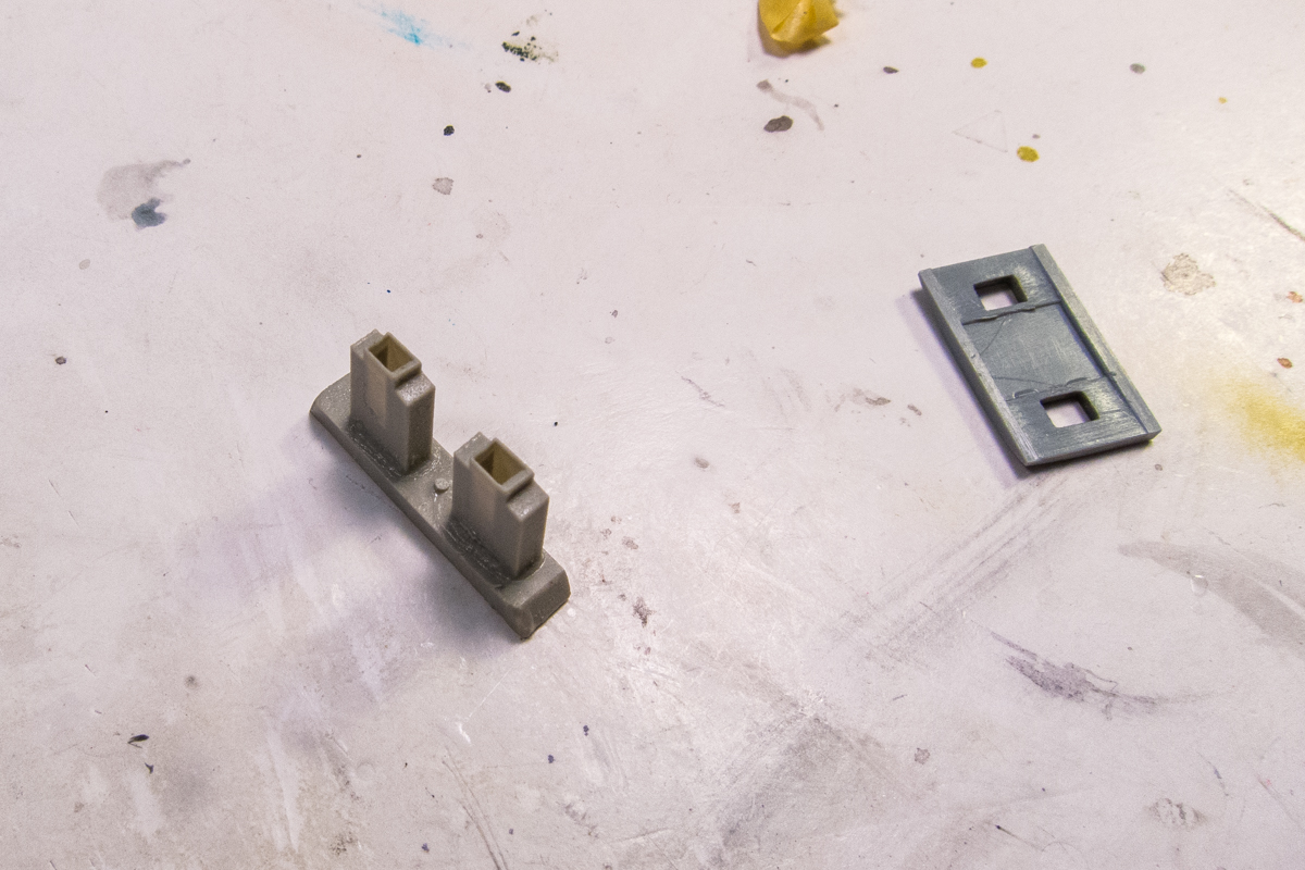

Thunnus Posted May 11, 2019 Author Posted May 11, 2019 (edited) Thanks for the great comments and the additional info about the G-10 breather placement! And thanks to the generosity of an LSP member, I've received MDC resin exhaust chutes so I don't have to make my own. Thanks Damian! These have a curved surface on the downwind edge of the chute that would've been hard to replicate. I've performed some corrections to the central belly portion based on an excellent article by Vince K. These include filling in the vent in the center, opening up the Mk 108 chute and putting in some breather outlets for the engine. Some questions were asked along the way regarding components of the correction and Vince himself was kind enough to elaborate on the reasoning behind these changes. As you can see, the Mk108 chute needs to be blocked off since the wing spar part is visible. The exhaust tips have been previously hollowed out. There exhaust deflectors supplied as separate parts in this kit but they are on the thick side. Instead of trying to thin them, I thought it would be easier to replace them with brass sheeting. The port side deflector has a bend to deflect the hot exhausts away from the supercharger intake. Much better in-scale representation, I think! Edited May 11, 2019 by Thunnus daHeld, Fvdm, TAG and 11 others 14

Thunnus Posted May 11, 2019 Author Posted May 11, 2019 3 minutes ago, Vincent/MDC said: Glorious work Notice the hole behind the right side exhaust stack ? It's the blast discharger for the Mk 108 so don't fill it ! In case it's not too late, i found a spare sheet of the k4 stencils i did for mdc. If you want one, drop me your adress via PM. The circuit breaker labels are quite handy and you also get the top wing root Mk108 air filler stencil (on the k4, the 2 compressed air bottles needed to operate the canon were stored in what used to be the 20mm ammo box on the G version. The 30mm rounds were stored in a bin above the canon Ahhh... I was wondering about that hole so it is good to know that it is supposed to be there! Thanks for the offer... I will PM you right away! Thank you so much Vincent! I love LSP!

Gazzas Posted May 12, 2019 Posted May 12, 2019 Nice work, John! I've been guilty of accepting the thickness of the heat deflectors in the past. I thin you've inspired me to replace them in the future. Gaz Thunnus 1
MikeMaben Posted May 12, 2019 Posted May 12, 2019 For the detail oriented , the shields went up over the lip as seen below ... HTH nmayhew, Gazzas, Fanes and 7 others 8 2

Thunnus Posted May 13, 2019 Author Posted May 13, 2019 Thank you for that engine shot and further details on the port exhaust shield. No engine or open cowling on my build! MikeMaben 1
Fencer-1 Posted May 13, 2019 Posted May 13, 2019 (edited) Regarding the MK108 shell ejection port. There is Kurfurst part catalogue (Ersatzteil-Liste) where the all removable panels presents. The panel we interested marked by #15 and it is Recht (Right), so the shell ejection port was on the right side of the plane. MK108 itself was "laying" on the right side and shells was extracted direct downward, so wasn't difference where to guide ejection chute. The right side was more convinient for shell ejection due to fuel tank shift to the left. Two more illustration from "Messerschmitt Bf 109 Einsatzmaschinen" book. There are some interesting details. Additional photo from manual shows ejection chute going to the right side and two filters installed on the left. Edited May 13, 2019 by Fencer-1 StefanGebhardt, Greg W, MikeMaben and 5 others 3 5
