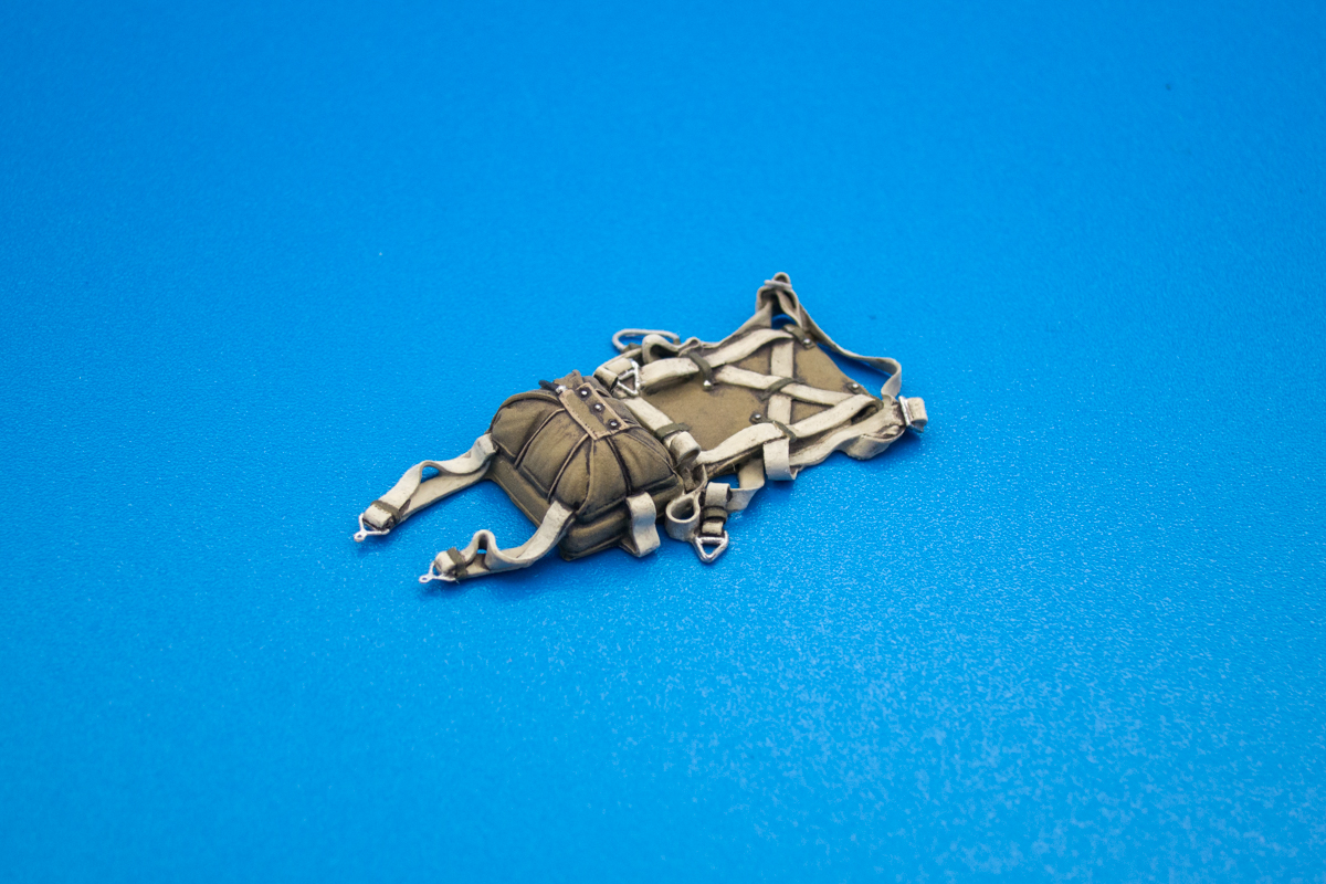

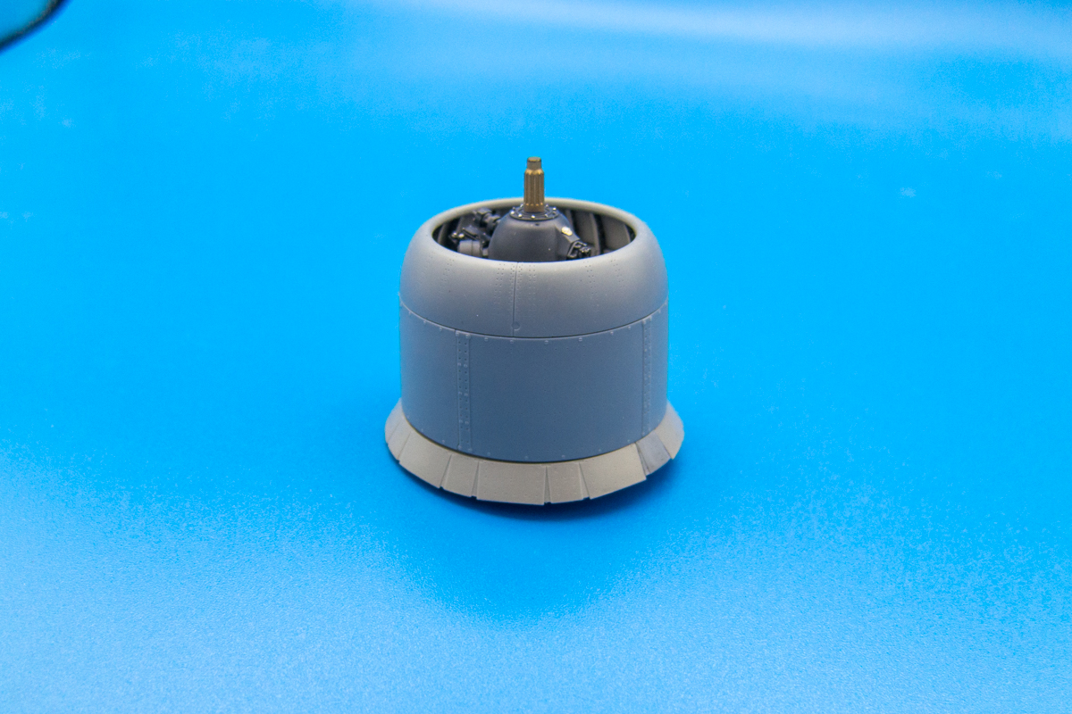

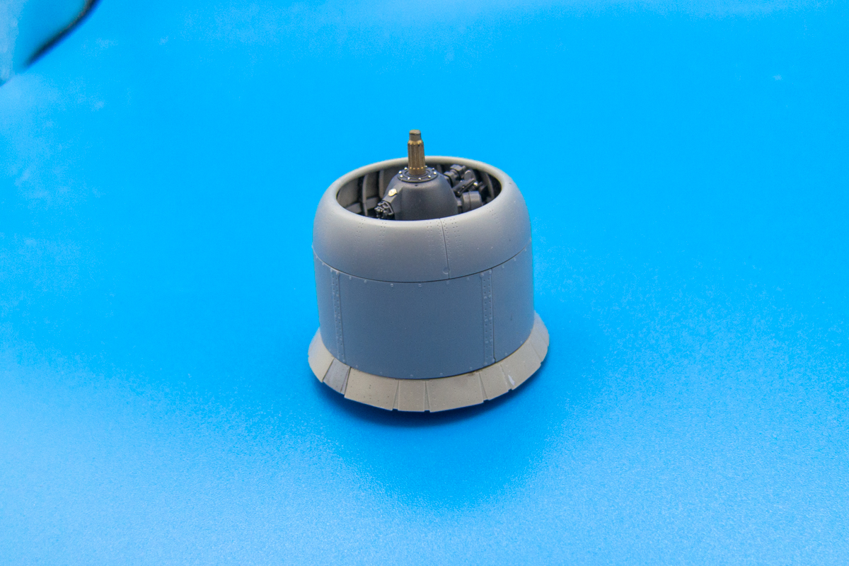

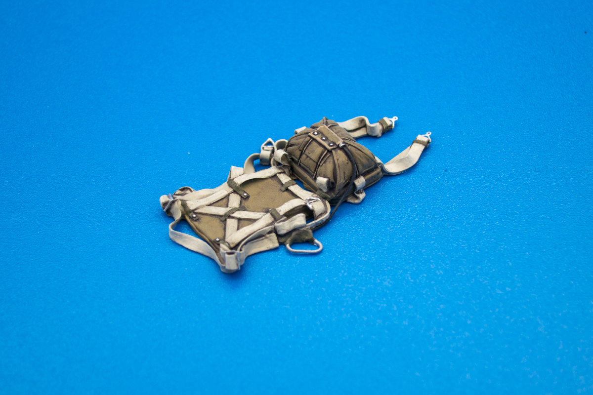

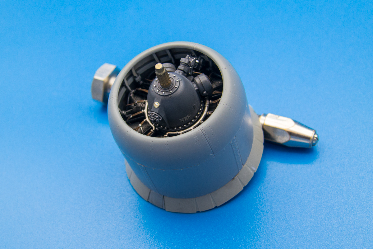

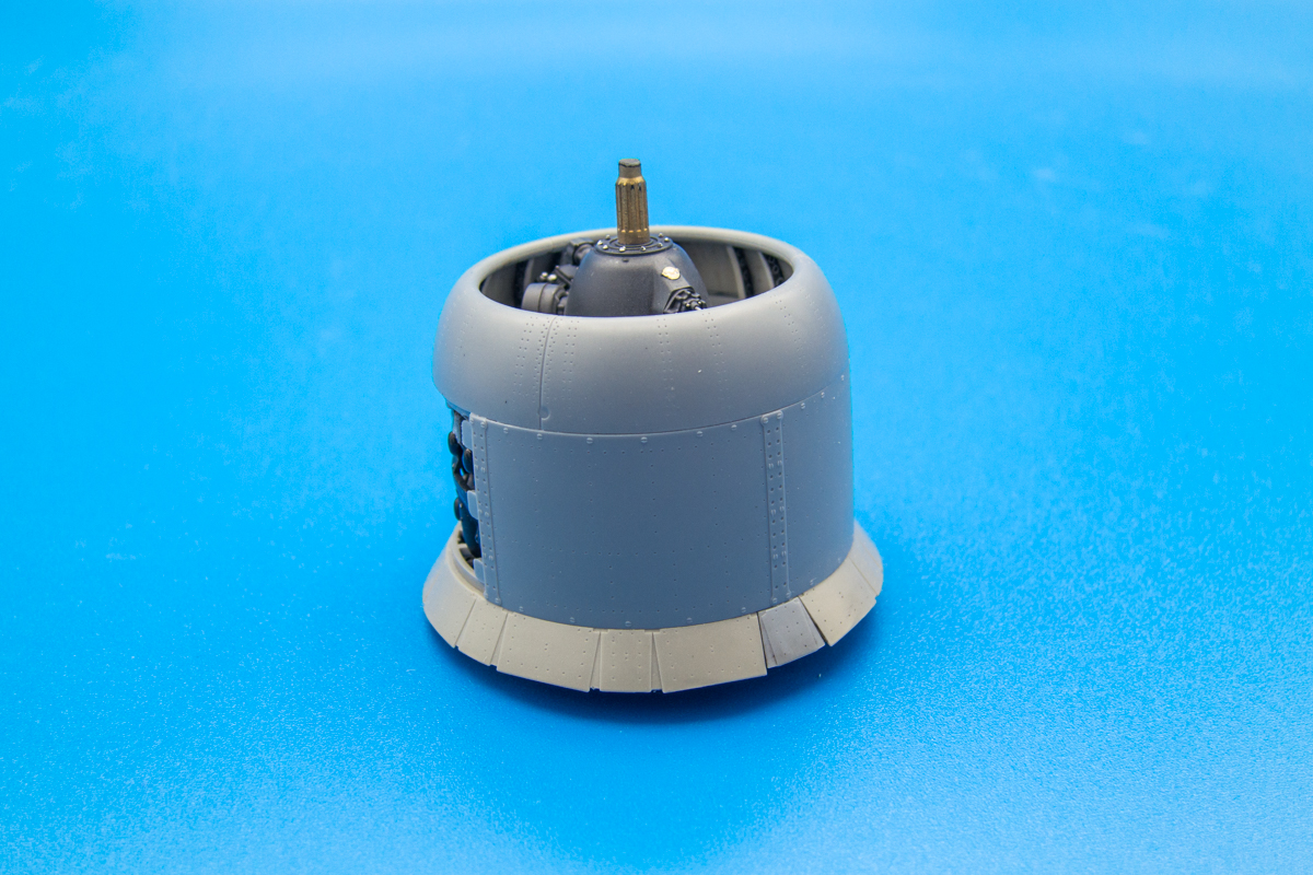

Thunnus Posted April 14, 2019 Author Posted April 14, 2019 On 4/9/2019 at 10:08 PM, LSP_Ray said: Absolutely beautiful work, Thunnus! Thanks Ray! Please call me John! Trying to get back on track after a busy week. I'm trying to figure out the engine cowling area. Right now I've just dry-fit the cowling around the engine after gluing the Vector resin cowling flaps to the back of the engine. Because of flex of the resin, it's difficult to get a tight joint. Although Tamiya intended to have the engine cowling removable, I may have to glue them in to order to avoid the gaps. Here's the view of the engine from the outside. Do you notice the now-corrected Pratt & Whitney logo that I had erroneously installed upside down? It's been corrected due to the generosity of another LSP modeler who graciously sent me some replacement decals. Thank you Damian! During the week, when I had some periods of available time, I painted the True Details resin parachute. Martinnfb, kkarlsen, LSP_Kevin and 18 others 21
LSP_Ray Posted April 14, 2019 Posted April 14, 2019 You have a very nice painting touch, John, that parachute looks amazing! Thunnus and Martinnfb 2
Gazzas Posted April 14, 2019 Posted April 14, 2019 Love that chute, John! Engine looks great, too. Gaz Thunnus and Martinnfb 2
Fvdm Posted April 14, 2019 Posted April 14, 2019 That parachute looks great! Wonderfull paintjob. Martinnfb and Thunnus 2
John1 Posted April 14, 2019 Posted April 14, 2019 Awesome job on the Vector cowl flaps. Definitely take your time on fitting the access panels, I ended up with a larger than desired gap. I wonder if I messed up the installation, I glued the cowl flaps to the fuselage first and then the engine afterwards? That may have contributed to the problem. Regardless, keep up the good work, this is truly a fantastic build! Thunnus and Martinnfb 2

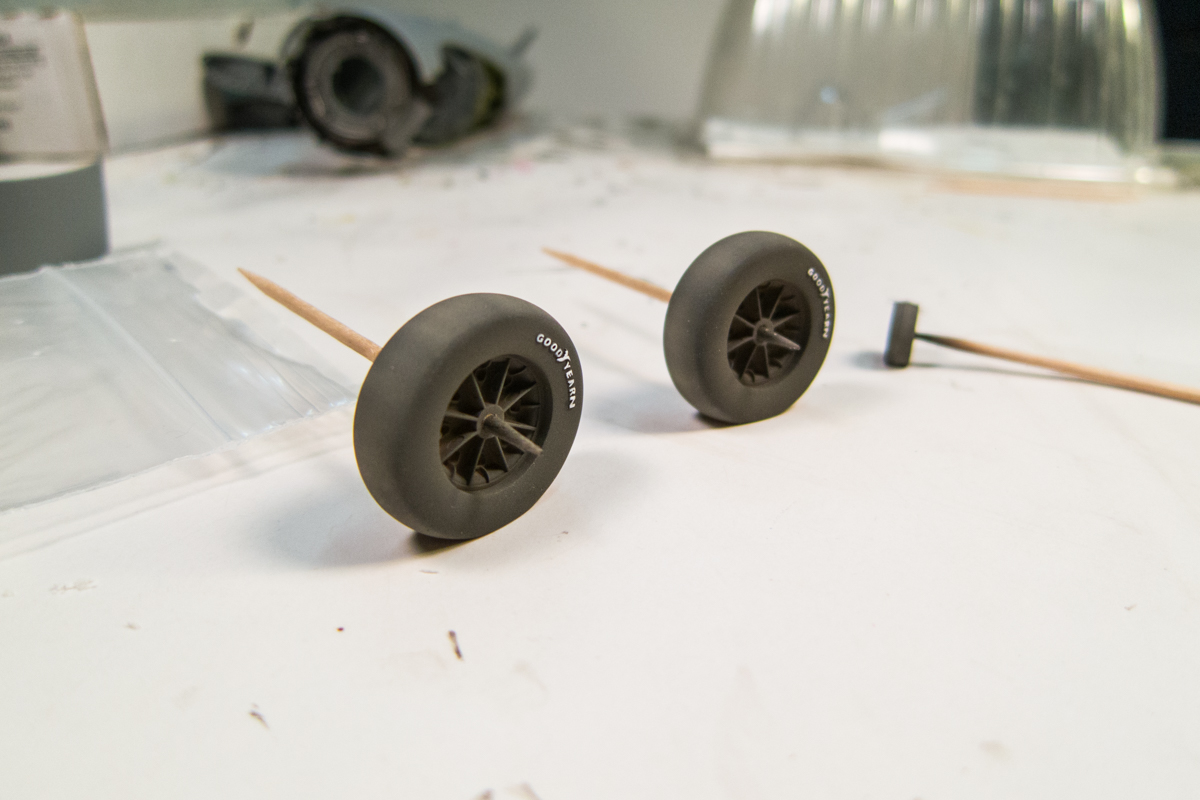

Thunnus Posted April 15, 2019 Author Posted April 15, 2019 Thanks guys! On 4/14/2019 at 6:44 AM, John1 said: Awesome job on the Vector cowl flaps. Definitely take your time on fitting the access panels, I ended up with a larger than desired gap. I wonder if I messed up the installation, I glued the cowl flaps to the fuselage first and then the engine afterwards? That may have contributed to the problem. Regardless, keep up the good work, this is truly a fantastic build! Thanks for the tips! I've tried to really examine the cowling area to see how I could minimize gaps AND have the engine panels removable but I don't think it will be possible due to the lack of rigidity of the resin cowl flap piece. The most positive attachment point for the cowl flaps are the four small tabs on the rear of engine so I secured that connection first. I then glued the bottom engine cover into place making sure that that the cover is snug against the cowling flaps. And finally, I glued the nose ring into place. The top engine cover isn't a snug fit at this point but I'll wait until later to see if I need to glue it into place or I can have it as a removable panel. I've started painting the Barracuda resin wheels. F-4Phanwell, LSP_Kevin, Greg W and 5 others 8

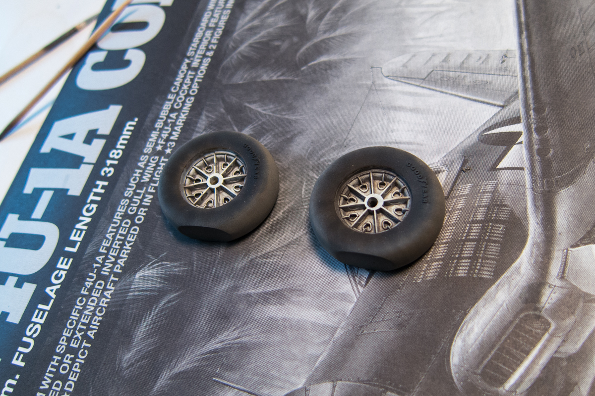

Gazzas Posted April 16, 2019 Posted April 16, 2019 Those tires look great, John. I'm a it confused: Good Yearn? Gaz Martinnfb and Thunnus 2

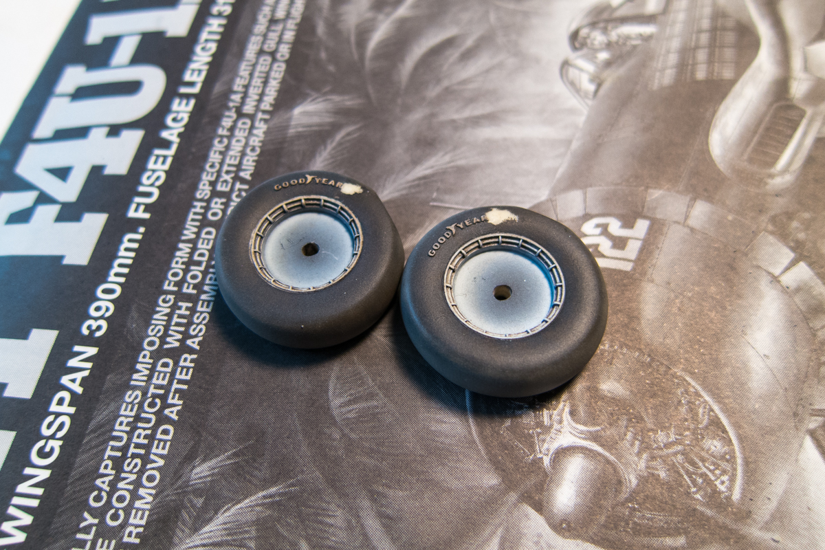

Thunnus Posted April 16, 2019 Author Posted April 16, 2019 20 minutes ago, Gazzas said: Those tires look great, John. I'm a it confused: Good Yearn? Gaz I dunno... I was thinking Goodyear N. Maybe it's modern day copyright issues? Maybe I'll just paint over the "N". Or paint over the letters all together. Martinnfb and Gazzas 2
LSP_Ray Posted April 16, 2019 Posted April 16, 2019 I think the N was to avoid trademark issues and you are supposed to chisel off the N. I am not sure the letters were white either, which is too bad because it sure looks good! Martinnfb, Thunnus and Gazzas 3
Gazzas Posted April 16, 2019 Posted April 16, 2019 I would hate to see them go too... but if you must... Gaz Martinnfb and Thunnus 2

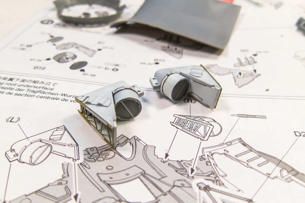

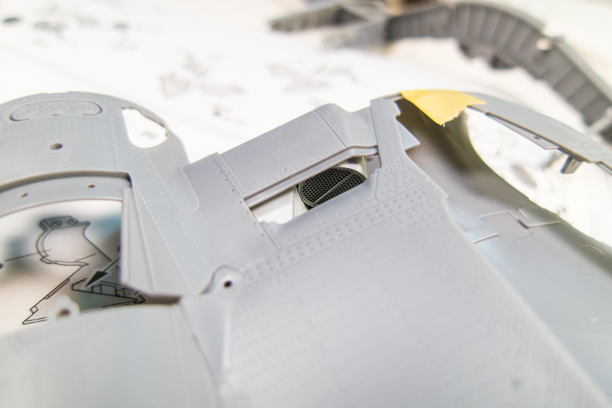

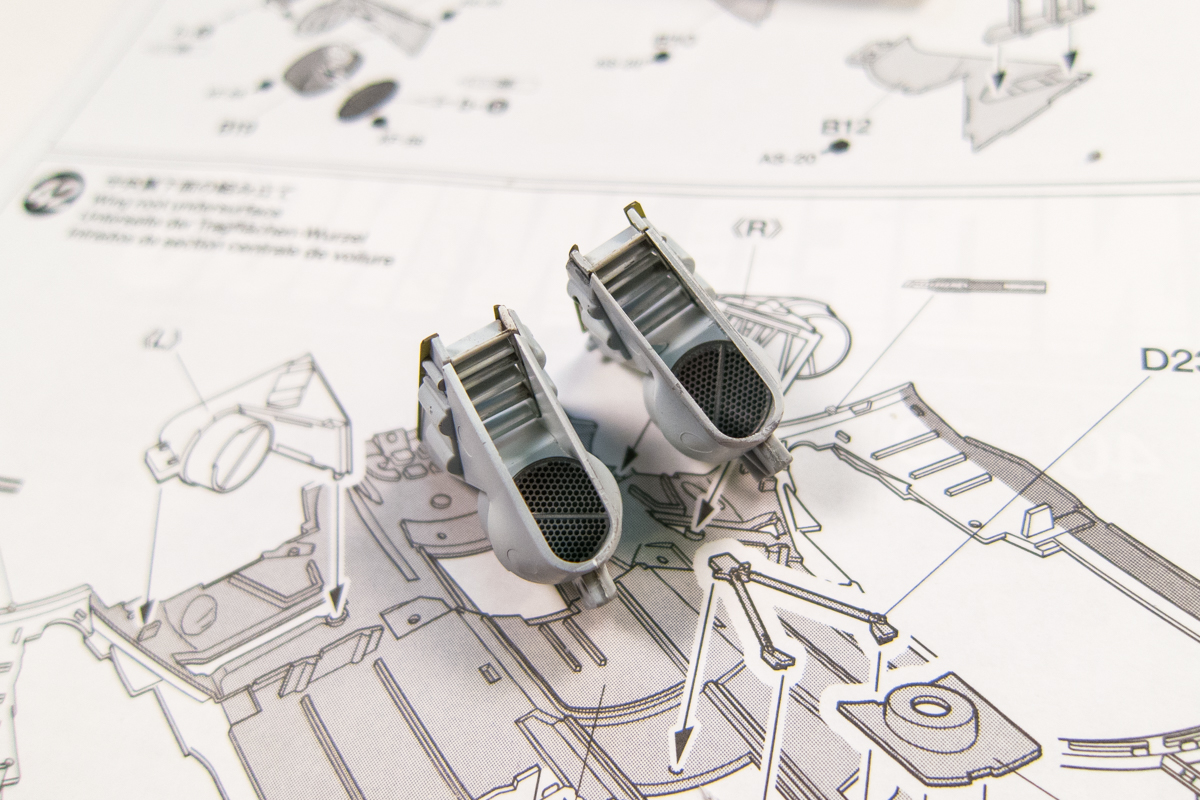

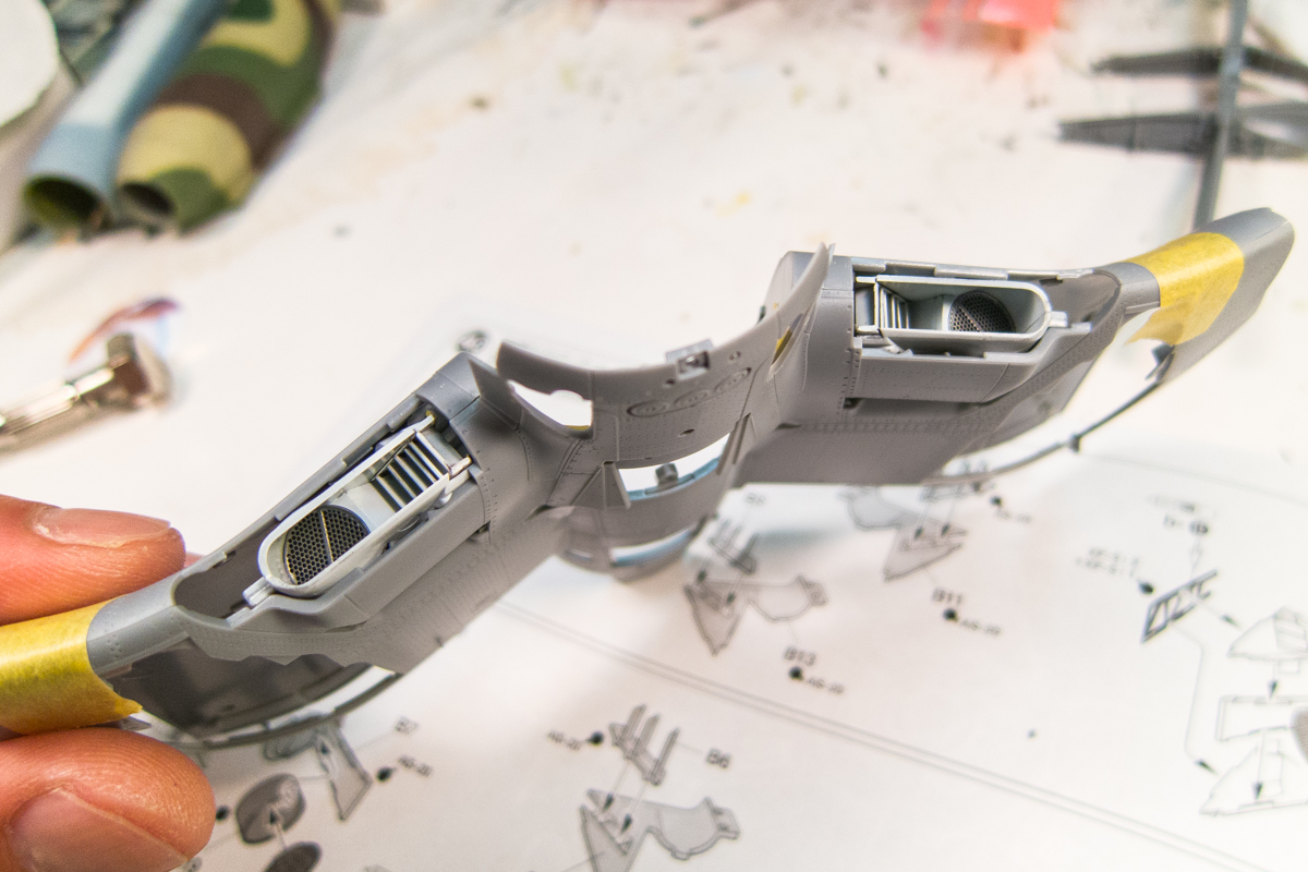

Thunnus Posted April 17, 2019 Author Posted April 17, 2019 I've scraped off the offending "N" from the tires. And then shot the sidewalls with another coat of brown/black, covering the white lettering. The spoked wheels haven't been glued on yet... who knows if there is another round of unexpected changes to come. I've started work on the complicated inner wing assembly. The oil coolers are first. These come with nice photoetched grills, front and back. It's hard to figure out what will and what won't be seen. It looks like the backsides of the coolers will be visible but I think this opening gets covered up at least partially. scvrobeson, AlbertD, Martinnfb and 3 others 6
