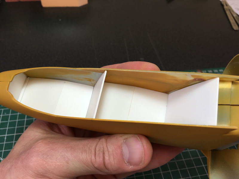

Spencer Pollard Posted July 6, 2016 Author Posted July 6, 2016 Hey everyone! I've completed some more work on my 1:24 Harrier T.4 conversion, today seeing me spend over 6 hours creating the structure on which the cockpit with be created. I knew it would be frustrating, but it took longer than I thought, but at least it's done and I can now start work on the detailing! The pile of bits next to the nose gives you some idea of how many attempts I needed to get the parts the correct size and shape... https://thekitbox.wordpress.com/2016/07/06/harrier-t-4-conversion-part-3/ Kirk, Out2gtcha, Iain and 2 others 5

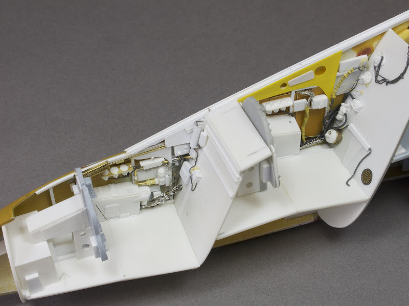

Spencer Pollard Posted July 12, 2016 Author Posted July 12, 2016 Hey everyone! Well, the plan this week was to spend at least two days on the cockpit of the Harrier T.4 and try and get the starboard walls, instrument panels and half of each rear bulkhead complete, and that's pretty much what I've done. Though it's not absolutely perfect (I've had a nightmare trying to work out where some of the cabling goes!), I'm happy that the interior captures the look of the images that I have to work from and that the major items are in place and complete. One thing that I have learned though is that scratchbuilding is around 50% construction and then 50% ripping out what you have completed because you are not entirely happy with your work! Honestly, there is at least one other perfectly serviceable 1:24 T.4 cockpit in the bin...I'll be posting a Youtube video and Blog update on this tomorrow, but in the meantime, I hope you like what I've done so far.Have a nice evening! F`s are my favs, TorbenD, Menelaos and 1 other 4
