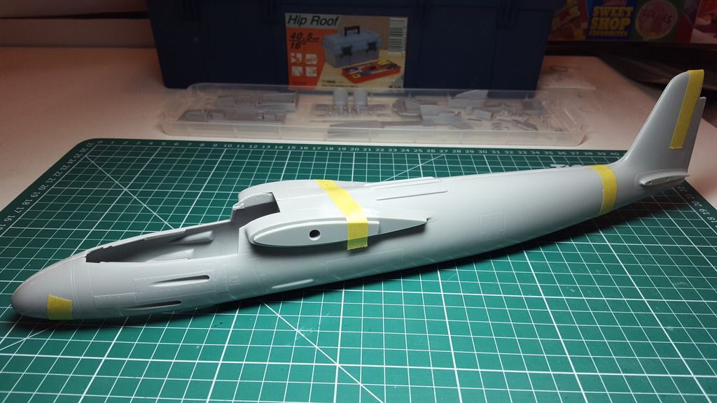

monthebiff Posted March 19, 2016 Author Posted March 19, 2016 After looking through the instructions its pretty clear that you need to be thinking several steps ahead to avoid any nasty little surprises so with that in mind I've cleaned up the fuselage halves this morning so I can start test fitting the main cockpit tub structure prior to any glue or paint going any where near, Very impressed with the castings which cleaned up nice and easily........... As you can see alignment is very very good indeed. Regards. Andy Zero77, mywifehatesmodels, Radders and 2 others 5
