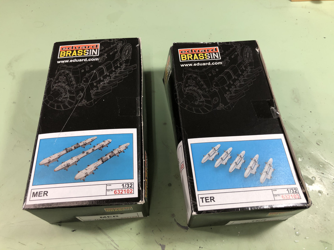

AlbertD Posted August 6, 2020 Posted August 6, 2020 (edited) This will be my first build log. This will by far be the biggest and most involved build I have ever done. There will be a lot of firsts for me and probably plenty of mistakes. I will probably asking a lot of questions. Maybe my questions will help others too. I will be adding a bunch of aftermarket goodies and using the loadout guide from the AOA decals website for guidance. I can't find a photo of my proposed loadout but I trust AOA has done good research and it's accurate. I just finished a 1/48 Hobby Boss A-6E for the sole purpose of trying black basing under the light gull grey scheme and was not all that happy with the results. For this I think I'll use tried and true pre-shading for the basic painting. So far all I've done is remove the raised panels on the fuselage. Re-scribing and riveting will be one of those firsts I was talking about. Please feel free to comment, poke fun or criticize. Thanks for taking a look. Here are the obligatory pictures. Edited November 18, 2020 by AlbertD Brett M, Squizzy 78, Landrotten Highlander and 12 others 15
Squizzy 78 Posted August 6, 2020 Posted August 6, 2020 That’s a mountain of aftermarket gear for a great looking jet! I’ll be following this build for sure AlbertD 1
AlbertD Posted August 6, 2020 Author Posted August 6, 2020 1 hour ago, Squizzy said: That’s a mountain of aftermarket gear for a great looking jet! I’ll be following this build for sure I've been picking up stuff here and there for the last few months for this build. I didn't realize how much I had until I got it all on the bench this morning. I hope I can do it justice.

Finn Posted August 7, 2020 Posted August 7, 2020 Some useful info may be found in these manuals: http://aviationarchives.blogspot.com/2017/07/f-4bj-plane-captains-handbook.html http://aviationarchives.blogspot.com/2017/07/f-4bj-ordnancemans-handbook.html also it has been noted that the Eduard MERs are about 1 scale foot too short, so short that you can't put all the Eduard Snakeyes on them without adding a spacer to the MER. Jari AlbertD, haveblue and Anthony in NZ 3
AlbertD Posted August 7, 2020 Author Posted August 7, 2020 35 minutes ago, Finn said: Some useful info may be found in these manuals: http://aviationarchives.blogspot.com/2017/07/f-4bj-plane-captains-handbook.html http://aviationarchives.blogspot.com/2017/07/f-4bj-ordnancemans-handbook.html also it has been noted that the Eduard MERs are about 1 scale foot too short, so short that you can't put all the Eduard Snakeyes on them without adding a spacer to the MER. Jari Just started downloading the references you linked. Thank you. I didn't know about the short Eduard MER's. Good thing the set comes with 3 and I only need 2. Should be pretty easy to splice in a scale foot.

AlbertD Posted August 8, 2020 Author Posted August 8, 2020 (edited) 21 hours ago, Finn said: also it has been noted that the Eduard MERs are about 1 scale foot too short, so short that you can't put all the Eduard Snakeyes on them without adding a spacer to the MER. Jari Jari, You are right about the length. Here is a picture with the scale and the Mk. 82's to show how they look. I can't really find a reliable length. One thing I found said they are just over 12 feet long and that's what the Eduard ones measure too. I'm confused. Please let me know if I'm seeing it wrong. By the way the manuals are fantastic. They show some amazing detail and have great information. Thanks, Al Edited August 8, 2020 by AlbertD Anthony in NZ and scvrobeson 2

Finn Posted August 8, 2020 Posted August 8, 2020 According to Dave Roof, who worked on the real ones, said the MERS are 13' long. Here is a pic of a empty MER about to be loaded on an A-6E: Jari Greg W, AlbertD and Anthony in NZ 3
AlbertD Posted August 8, 2020 Author Posted August 8, 2020 2 minutes ago, Finn said: According to Dave Roof, who worked on the real ones, said the MERS are 13' long. Here is a pic of a empty MER about to be loaded on an A-6E: Jari Thank you sir. Your information is a huge help. I hope it helps others too. Anthony in NZ 1
