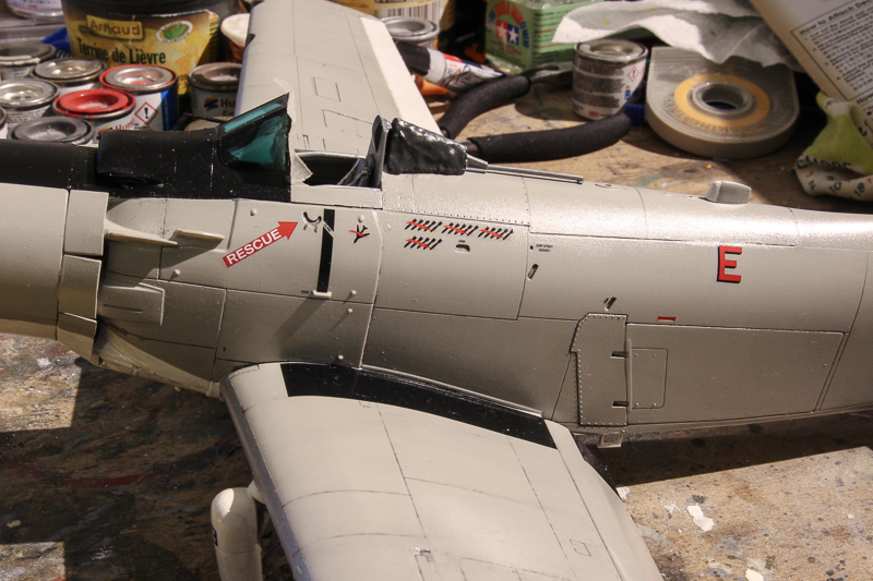

discus Posted November 18, 2018 Author Posted November 18, 2018 Progress from the weekend: Panel lines marking and start of the decals Pfuf, Coneheadff, LSP_Kevin and 2 others 5
discus Posted November 22, 2018 Author Posted November 22, 2018 Main decals are installed. I just need to finish few things before I can finish the decals on the rudder. johncrow, MikeMaben, Out2gtcha and 2 others 5

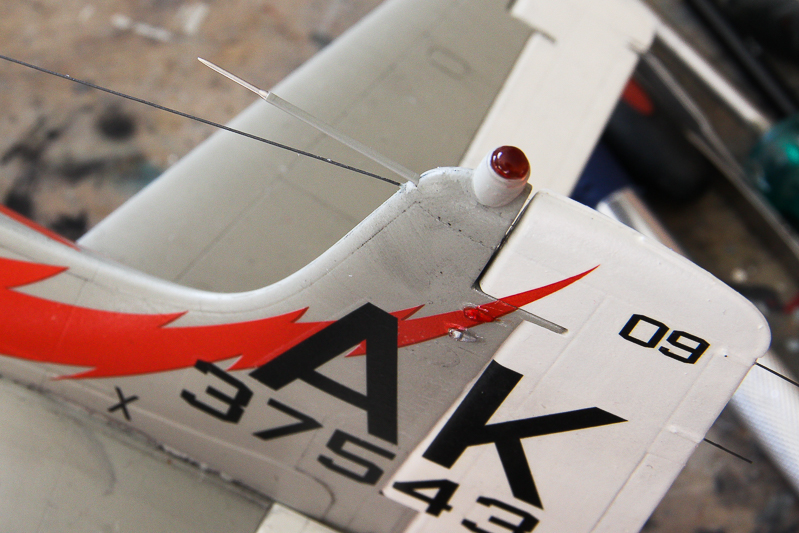

discus Posted November 24, 2018 Author Posted November 24, 2018 Hello I'm almost done with the beast. I'll try to take picts of the finish models during the weekend. Latest progress: I replaced the original static dischargers. they looked to big to me. I used tooth brush hairs. Metalic pitot tube from Master is a nice replacement for the original one. Wired antenna is fish wire 0.20 mm covered with metal cote 27003. Prop blades repainted to replace the too short decals. LSP_Kevin and Coneheadff 2
