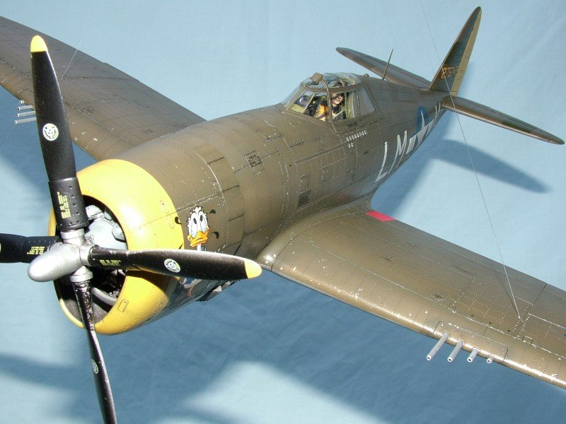

Koala Posted January 17, 2010 Posted January 17, 2010 Ditto to all the above plus a small word of caution. Remember that while there is a wierd satisfaction in Modelling for God, that alot of the work in wiring up an engine barely visible at the end of the day. For example, a reference photo of a jug engine can look like this...

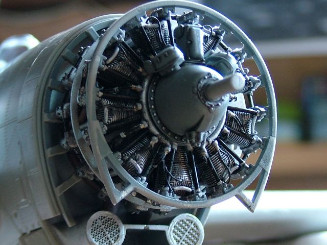

Koala Posted January 17, 2010 Posted January 17, 2010 Then you can get your model looking something similar....
Koala Posted January 17, 2010 Posted January 17, 2010 Then not have alot to see at the end of the day... Good luck anyway. BTW - if using copper wire, anneal it. Heat it up cherry red and it becomes much softer and easy to form to shape (edit - when cool that is).
