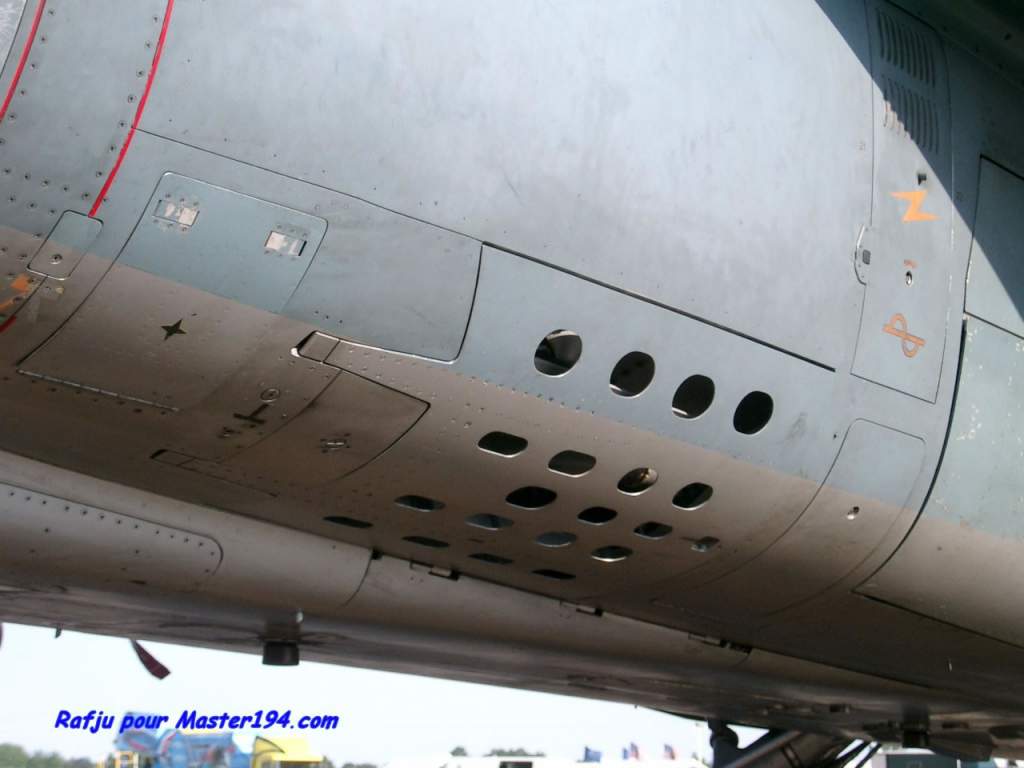

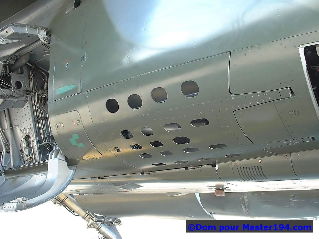

Posted
9 hours ago, rafju said:
Wow John, nice job, i like !
at this stage of the project, that's all I can do to help
Thanks,  and also for the photos.
Cheers,
John
