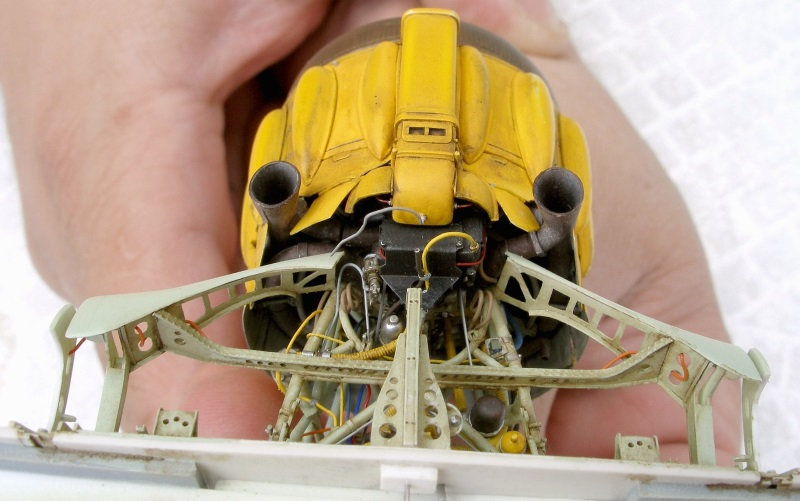

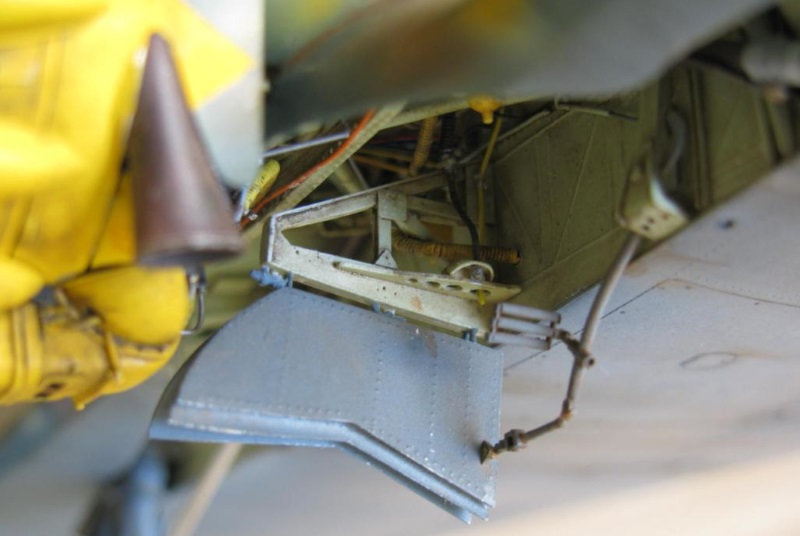

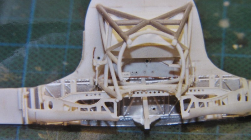

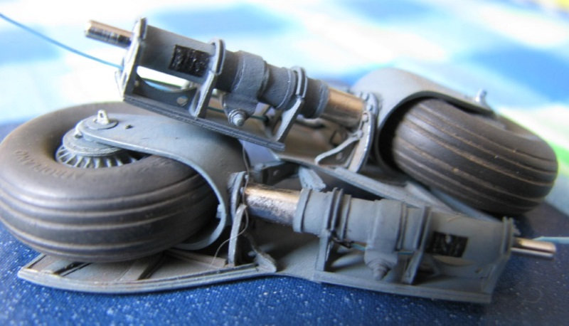

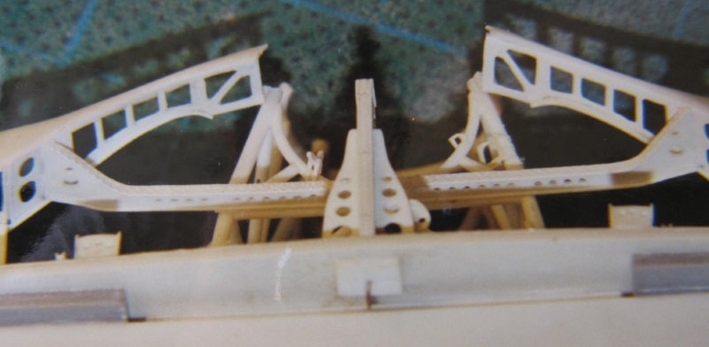

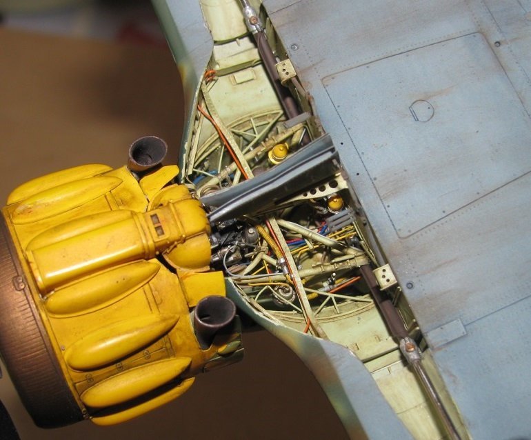

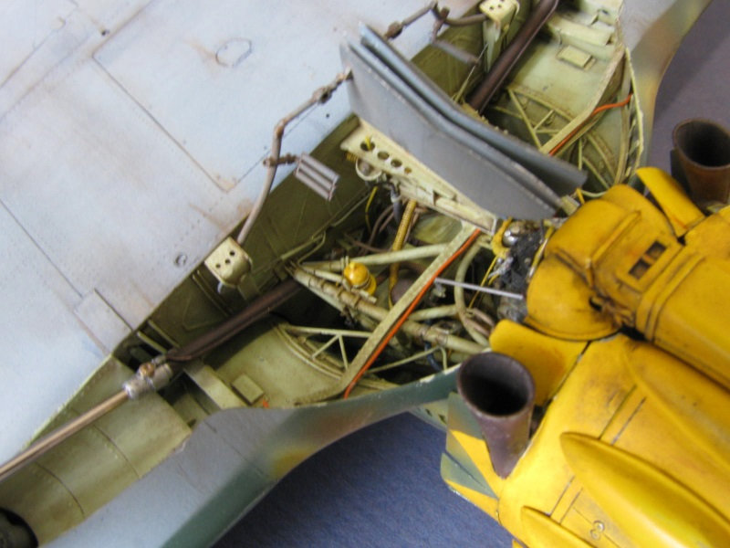

baffozac Posted April 24, 2019 Author Posted April 24, 2019 Many thanks for yours messages ! And now, ladies and gentlemen, the wheel bay : The only part I used from the kit is the upper frame for the motor, anything else is scratchbuilt. AceofClubs, Gazzas, Kagemusha and 6 others 7 2

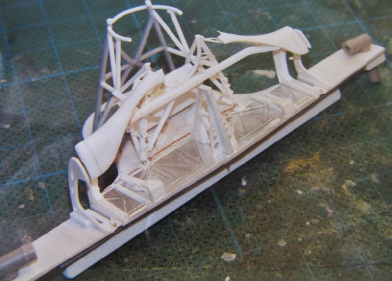

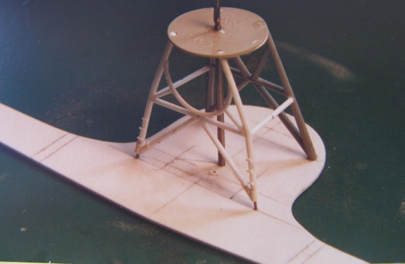

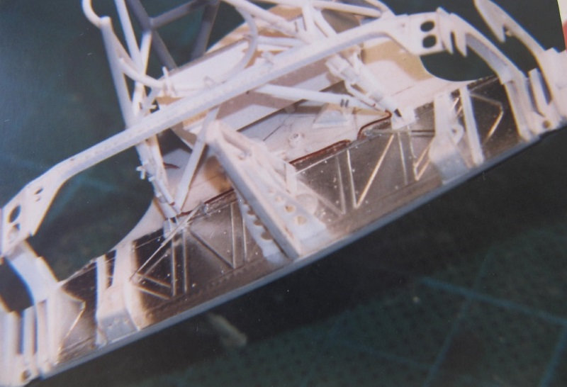

baffozac Posted April 27, 2019 Author Posted April 27, 2019 Hi Torben and others, some pics : tomaszhajzler, TorbenD, AceofClubs and 5 others 7 1

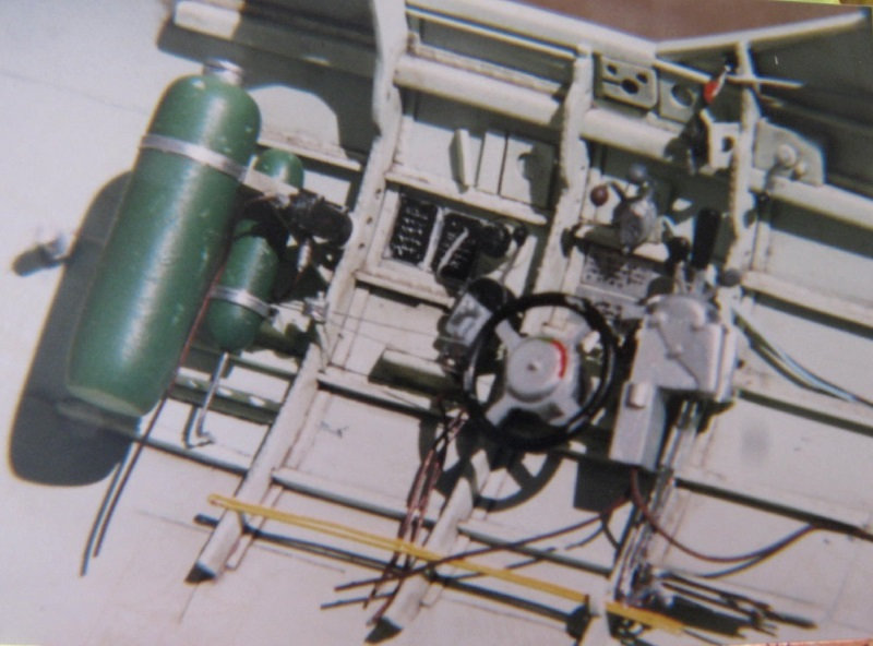

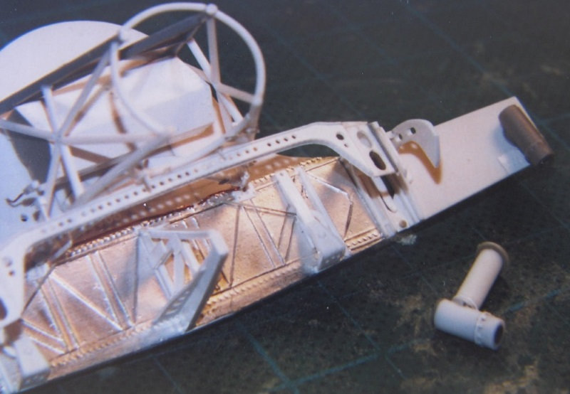

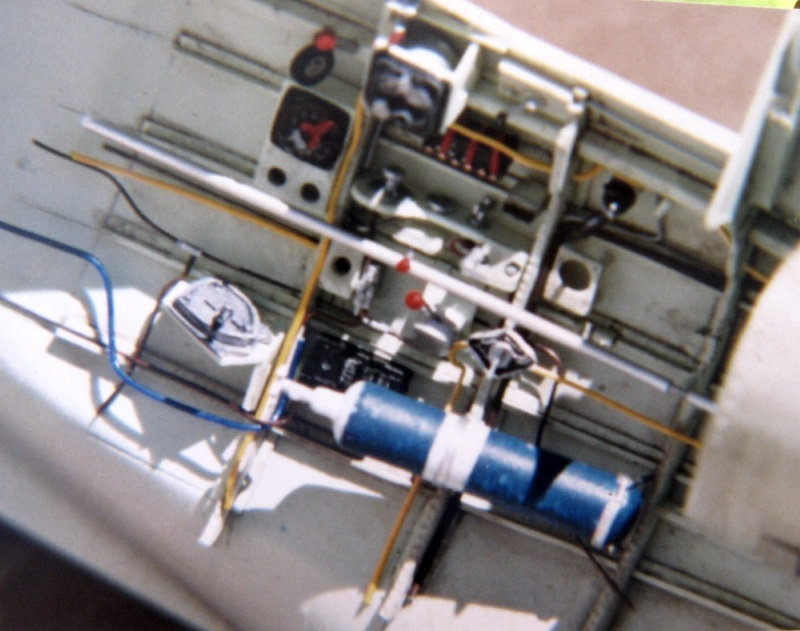

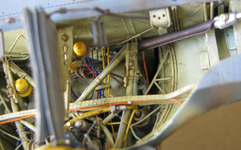

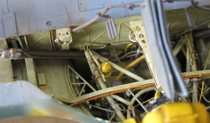

baffozac Posted May 3, 2019 Author Posted May 3, 2019 I have found others pics on a flash drive: And for the wheels bay, because I'm crazy about wheels bay, is it serious doctor ? Good day to you ! Alain AceofClubs, Tnarg, Seversky and 9 others 10 2

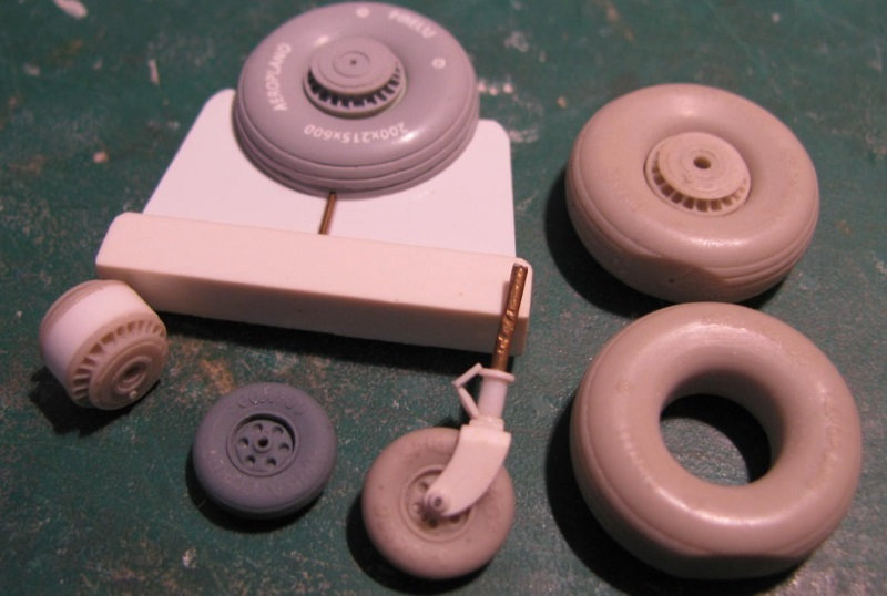

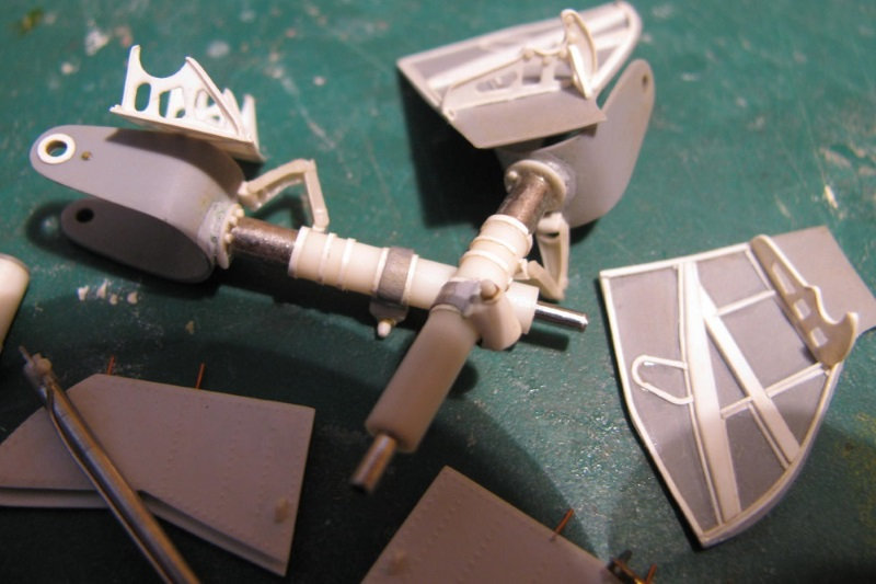

baffozac Posted May 14, 2019 Author Posted May 14, 2019 The landing gear: From the kit, I kept only the fork and the bottom of the doors with some modifications, for the rest, thank you Mr Evergreen ! Main and tail wheels don't have the right dimensions although it is indicated on the tires. For the markings on the sidewalls, thanks to my friend Georges Olivereau who made dry transfers I use on the masters. The rims not having the characteristic details are also redone. With a little paint and a cat hair ........ Have a nice day ! TorbenD, Out2gtcha, AceofClubs and 5 others 7 1

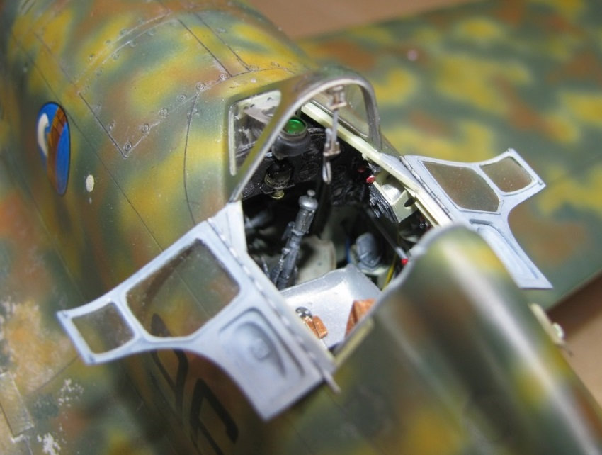

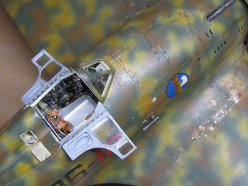

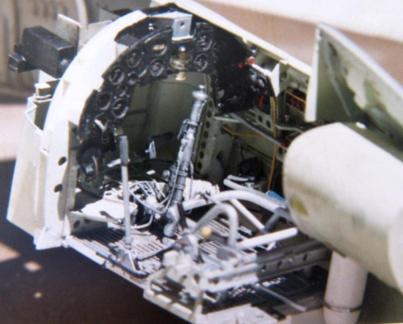

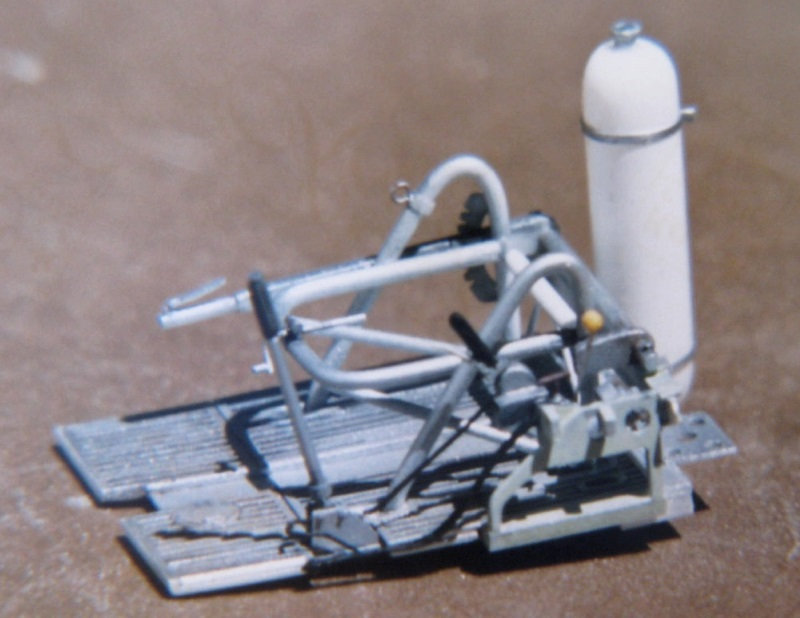

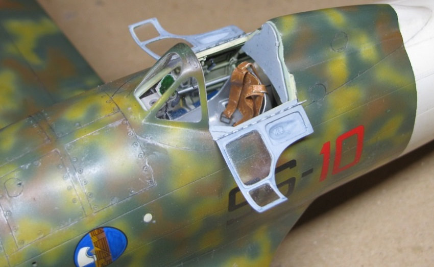

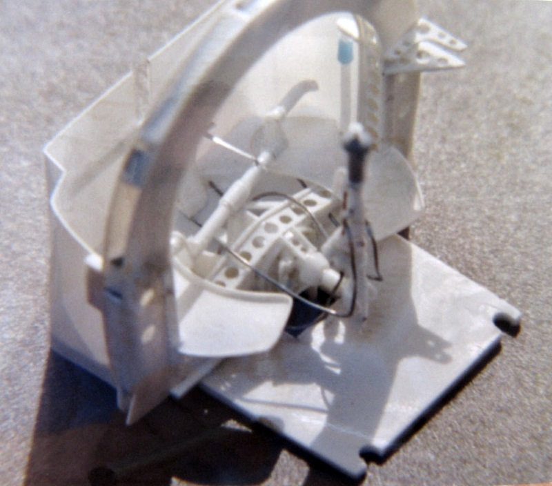

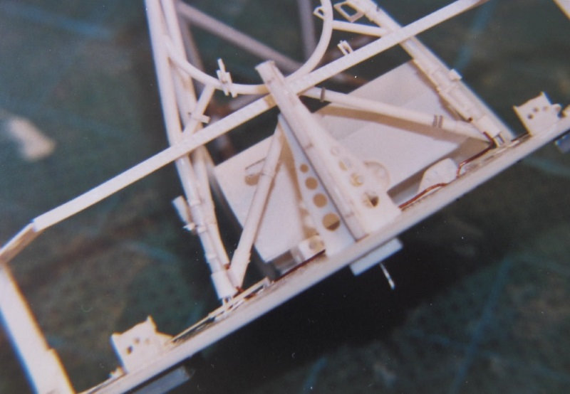

baffozac Posted May 21, 2019 Author Posted May 21, 2019 The cockpit. The only part I used from the kit is the instrument panel with some changes. The rest is scratch built. Kagemusha, Seversky, red baron and 5 others 6 2

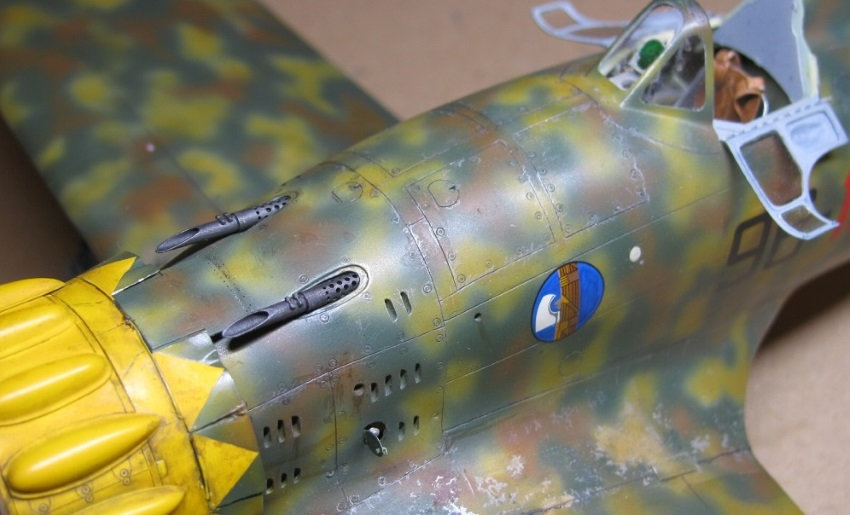

baffozac Posted May 31, 2019 Author Posted May 31, 2019 The clear parts Thanks to my friend Jean Bodson, famous french modeler, who made me these parts, using thien plexiglass softened in hot oil. it's as thin as vacuform and clear and strong like parts in the best standard kits and can be glued with plastic cement. Whe have corrected the front glass of the windshield because in the kit this part is too square at the top. Frames added using thin card and layers of Mr Surfacer. For the machines guns, Jacques Druel made me photoetched parts as 12,7 mm Safat have a ring of small holes at the front. Hatches of the guns were reengraved as the majority of the hatches of the plane. All the numerous louvres were carved. For all these works I used the pictures from the real plane and drawings of the Aero Detail 15 which are the best for me. Bill Cross, Tnarg, sandokan and 3 others 4 2
